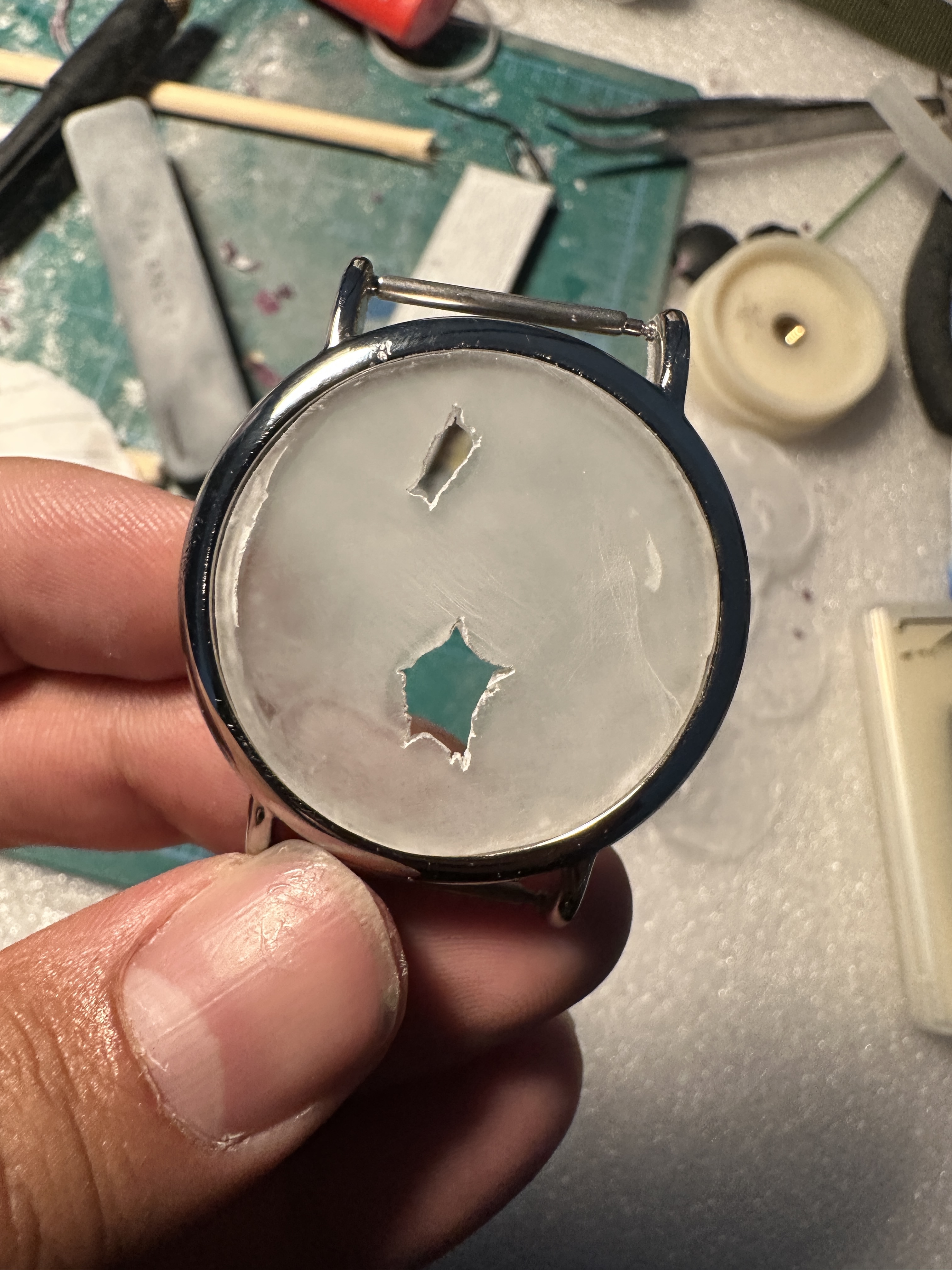

So I attempted to do the crack for the watch, using mineral glass, a hammer, and a nail punch, but the impact from the blows just destroyed it.
Went through 5 of them. I did find that doing a few small sized drilled holes, then using the nail punch helps.
But if anyone has found another solution, let me know :lol:. I might do a full drill hole and start there. I have like 20 more mineral glass replacements.
I also ordered some resin, and I might use that to fill in the holes so I have a safe "wearable" broken face version.

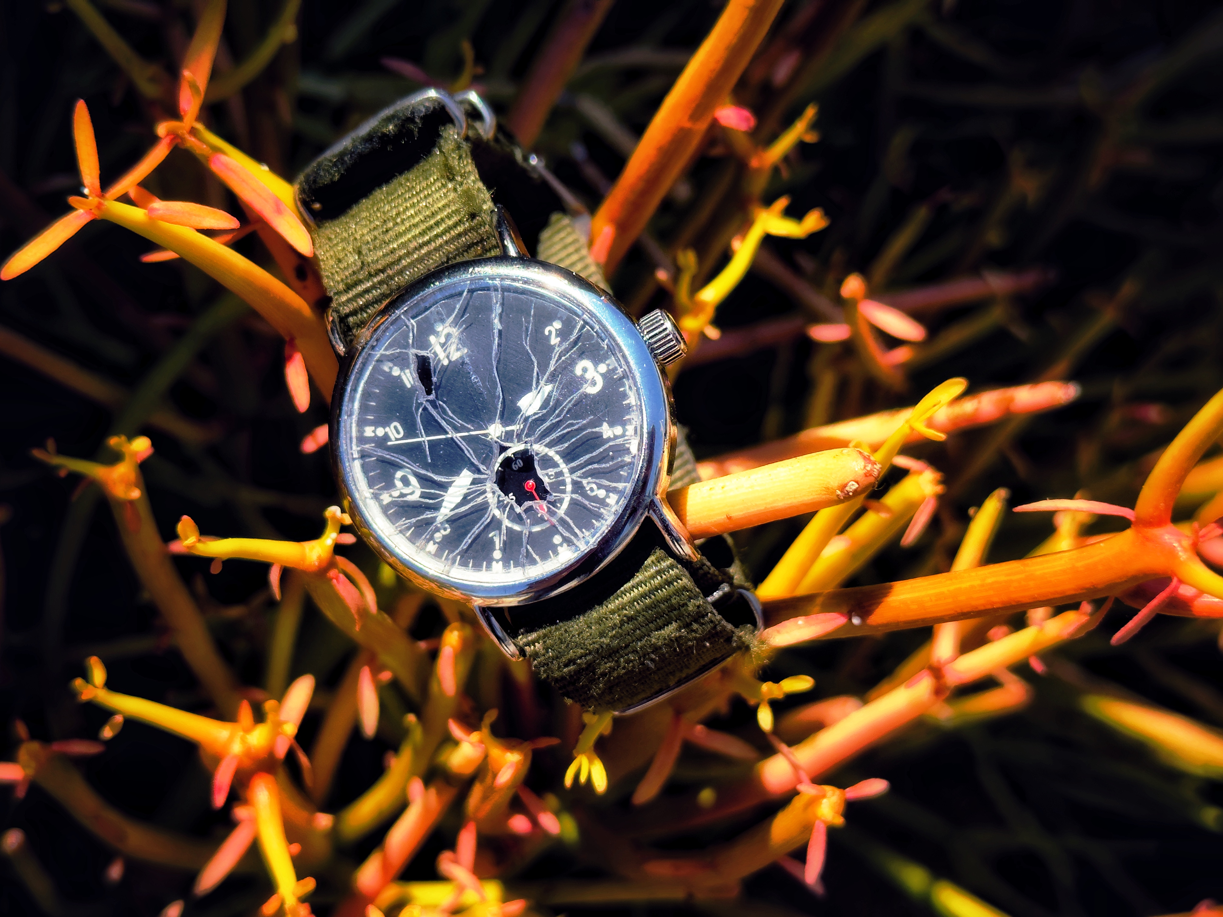

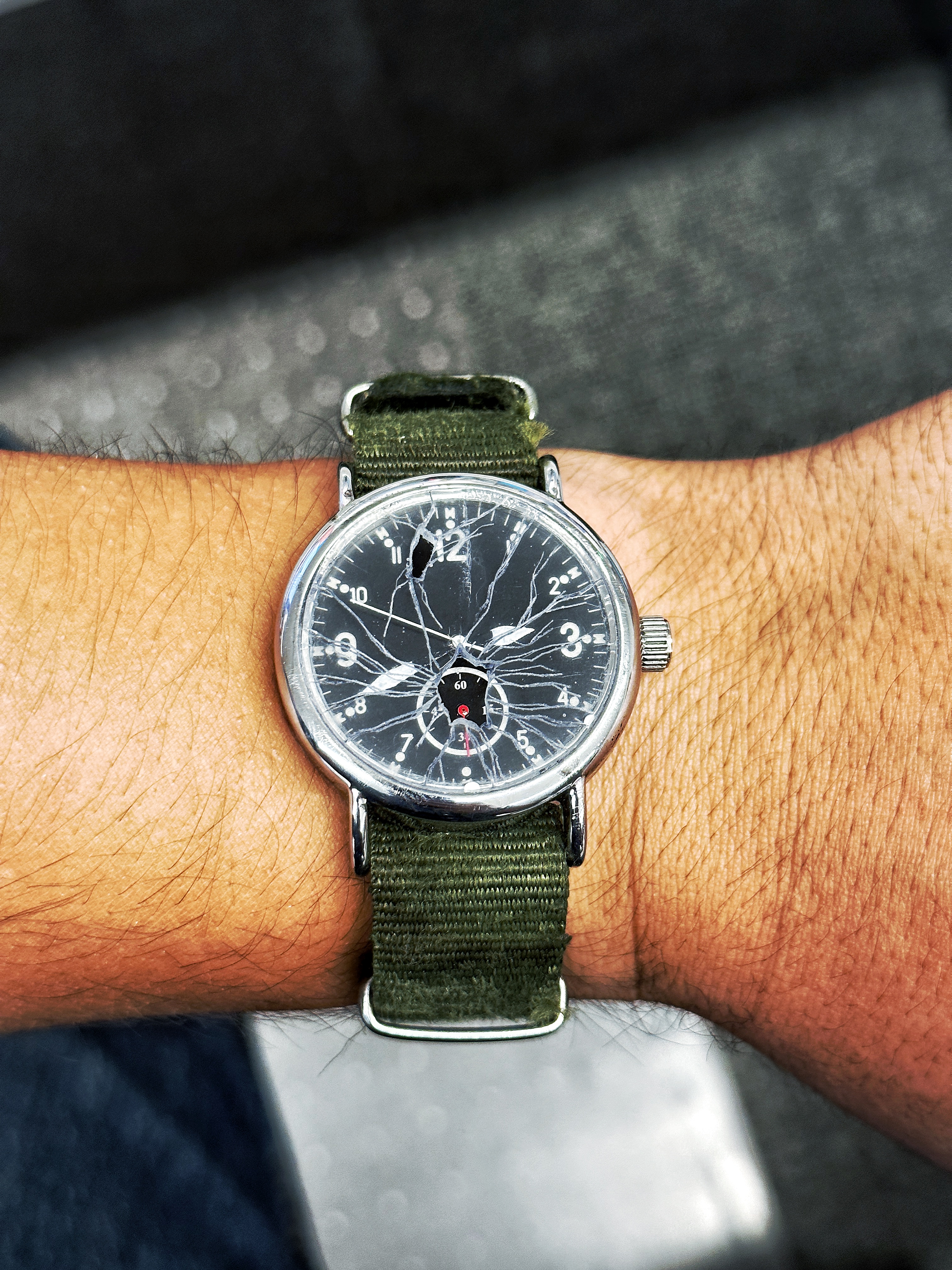

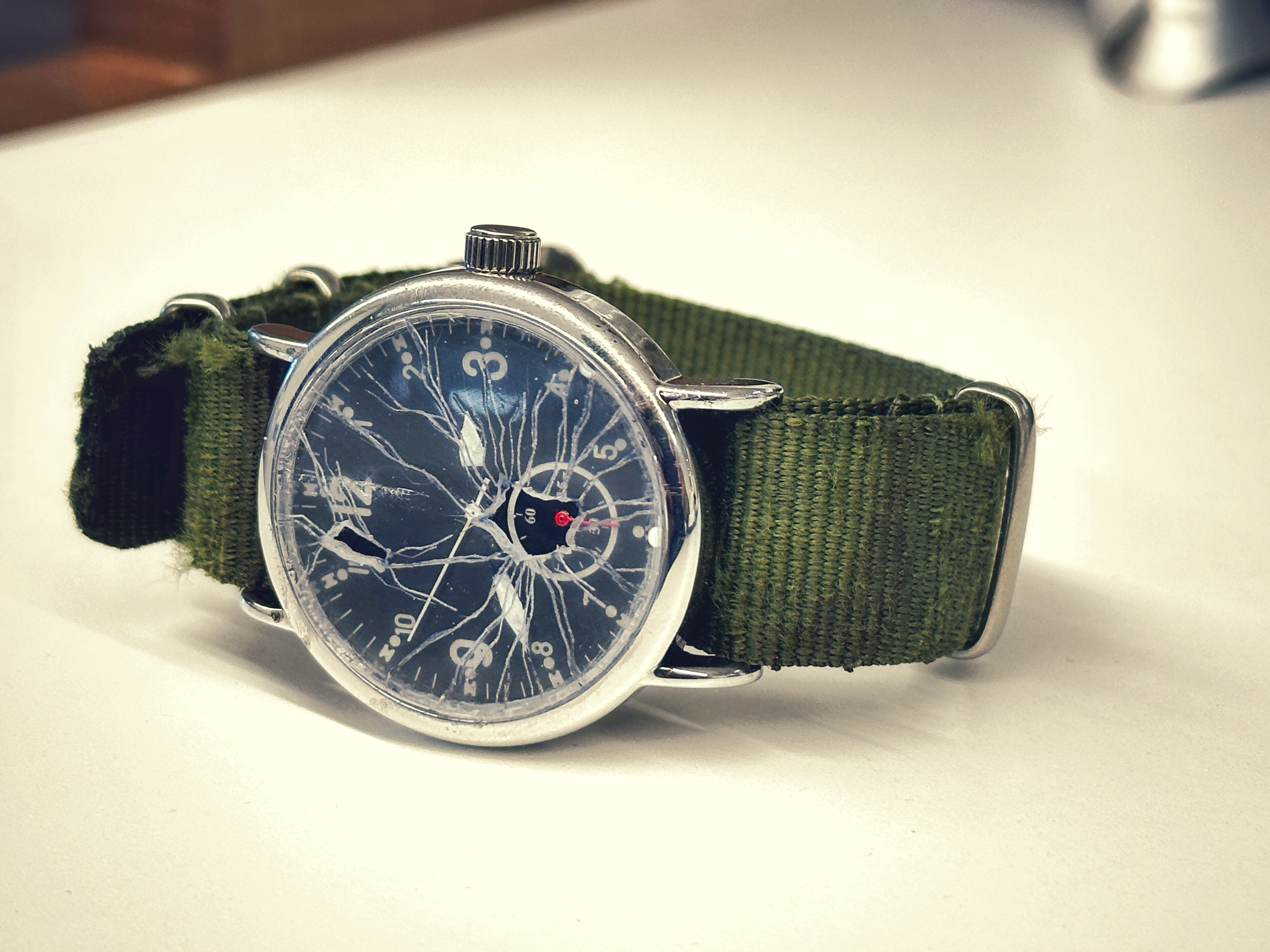

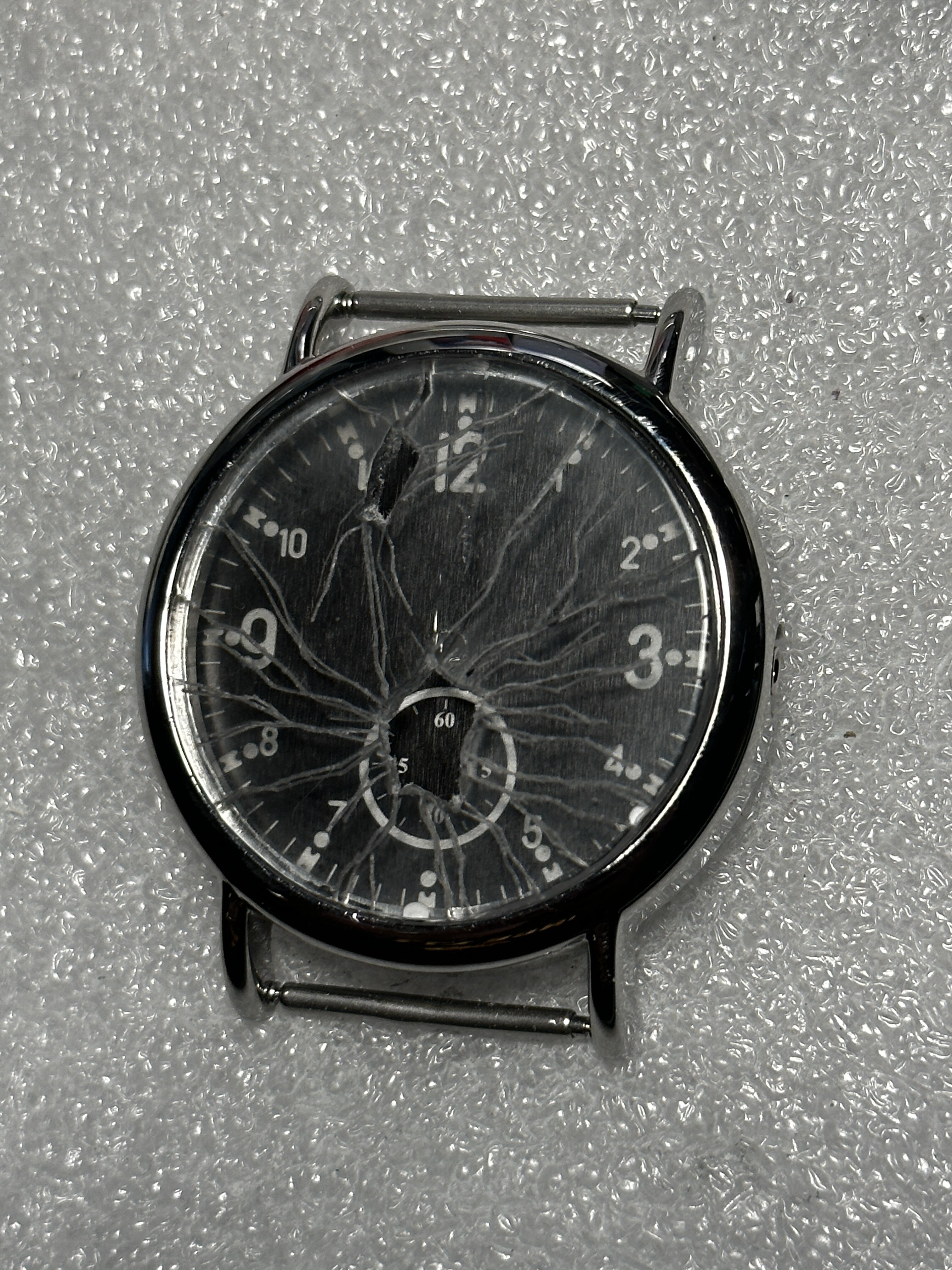

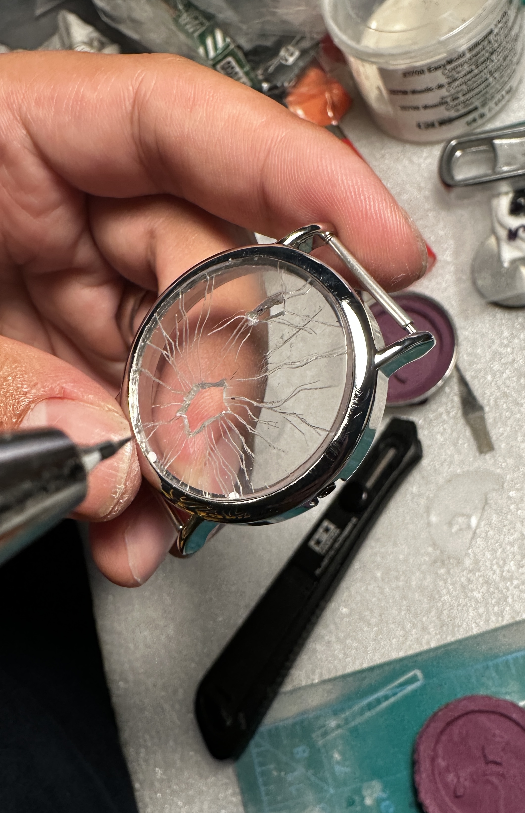

Watch update. After 2 weeks of trying to find a solution, I found it in UV resin. Using patterns provided by a member here, I managed to use silicone molds, casted resin pucks with the holes design in them, and then sanded the crap out of these things to polish them clearly.
I used a scribing tool used for Gunpla to get my cracks and scratches. Then used panel liner (Tamiya black) to get some depth to the cracks.
I also scribed the underside to give depth.
To complete the polish on the “glass” I used Polywatch and buffered the crap out of them.
To set the “glass” into the case, I used G-S Hypo Cement that is used to actually put mineral glass into the case (rather than super glue, to not fog up the resin).
I also got the movement holders in the mail, and will be making silicone and UV resin casts of these babies too so I have the molds (if anyone wants them here, so you don’t have to spend over $100 lol).
Next, I have to paint and set the hands, along with the movement, and the stem and crown. Weather the case, the strap, and then boom. We’re done!

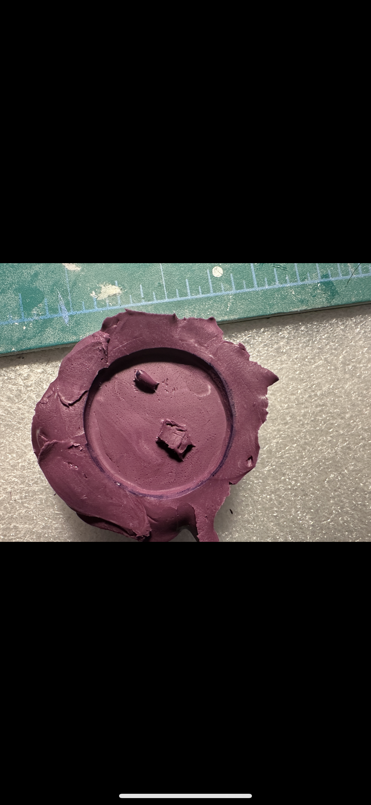

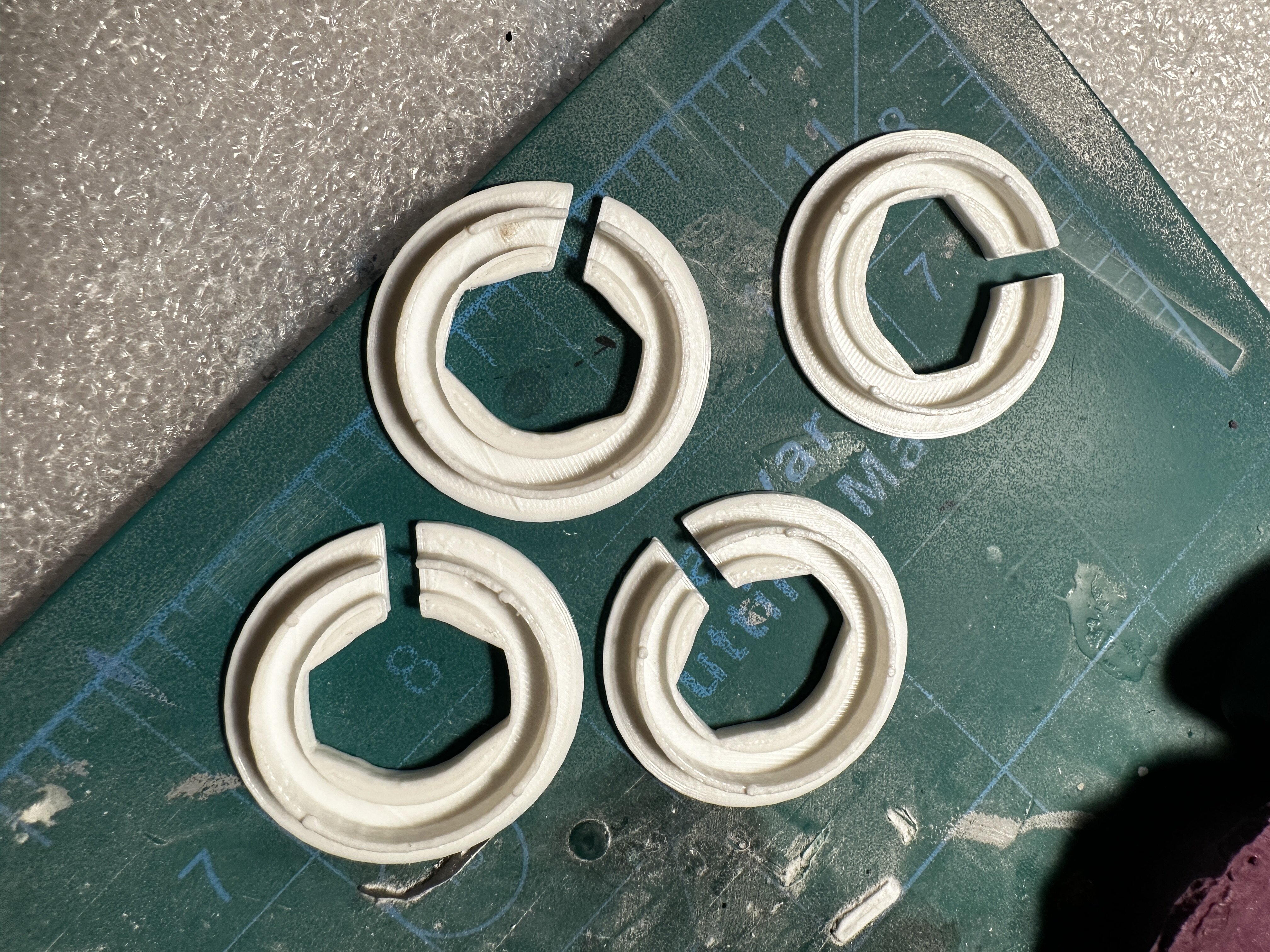

In a surprise twist, I thought “what if I put the movement holder in silicone, make a mold, and then use resin to make a new holder?” and behold, I’ve made a cost efficient movement holder for the Timex 38 mm.
Last thing I need to find a workaround for is the dial!
