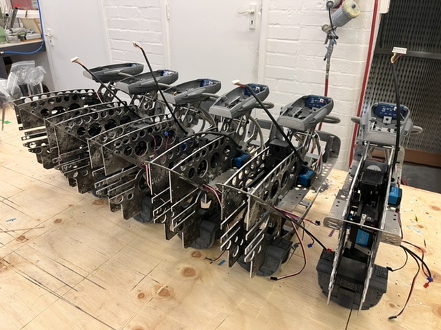

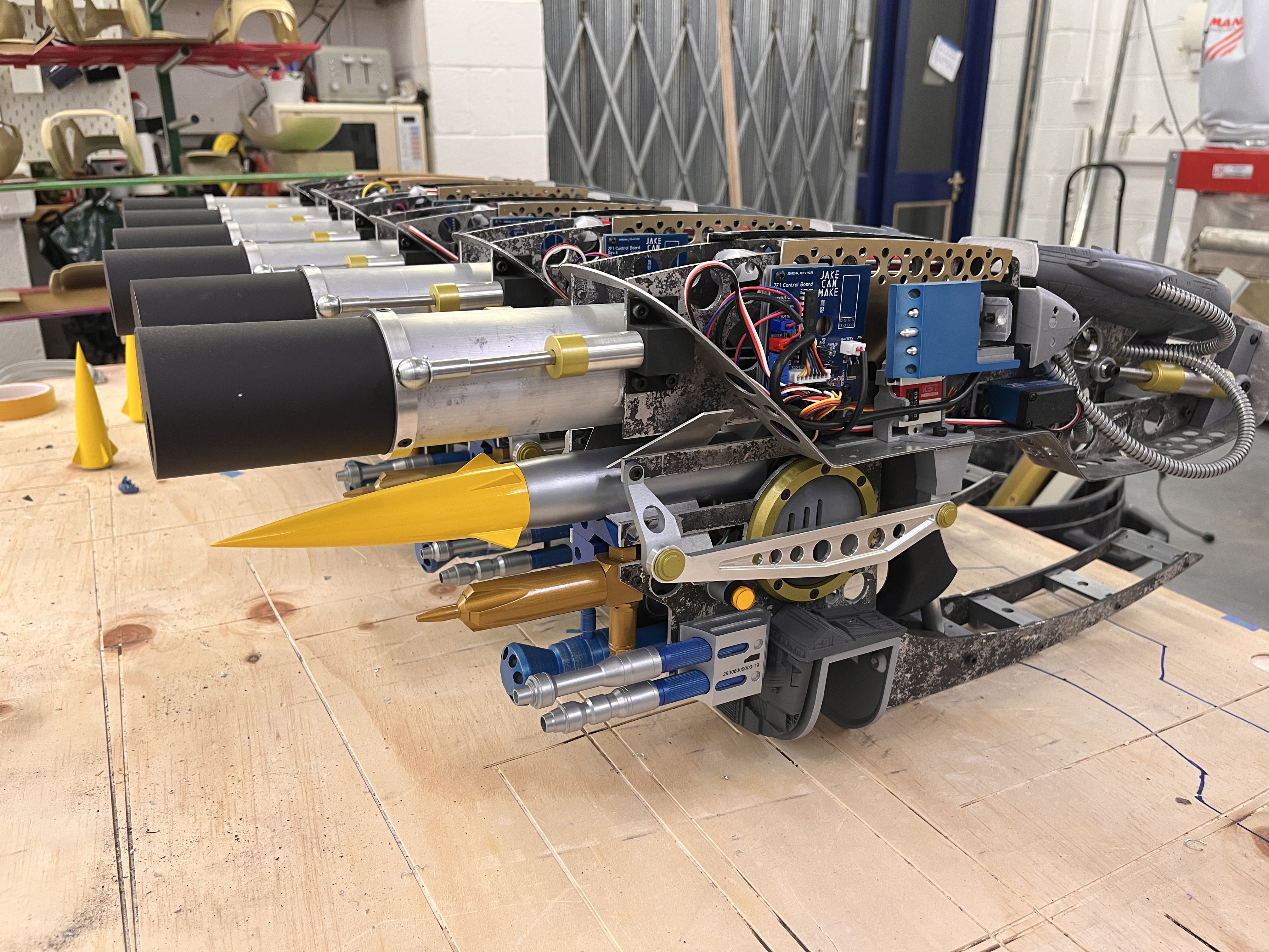

Here are a couple of pictures for the assembled ZF1 buyers. Lots of progress this week, with these things going together extremely nicely.

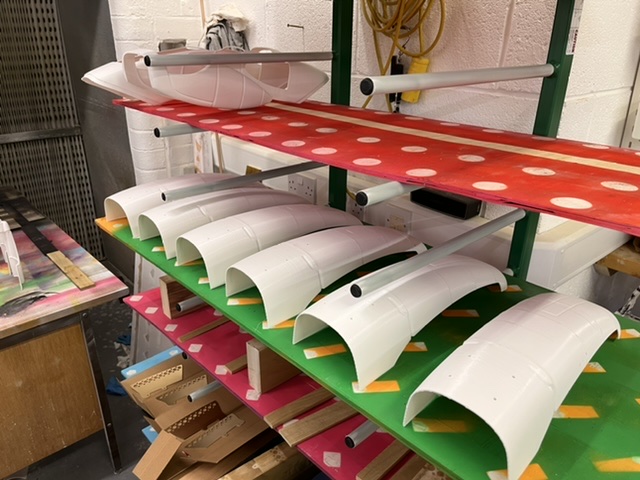

We have also started on the shells, the most labour intensive part of the build.

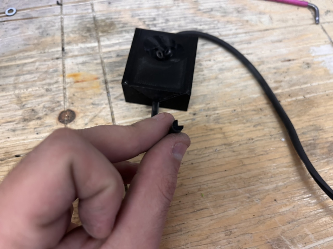

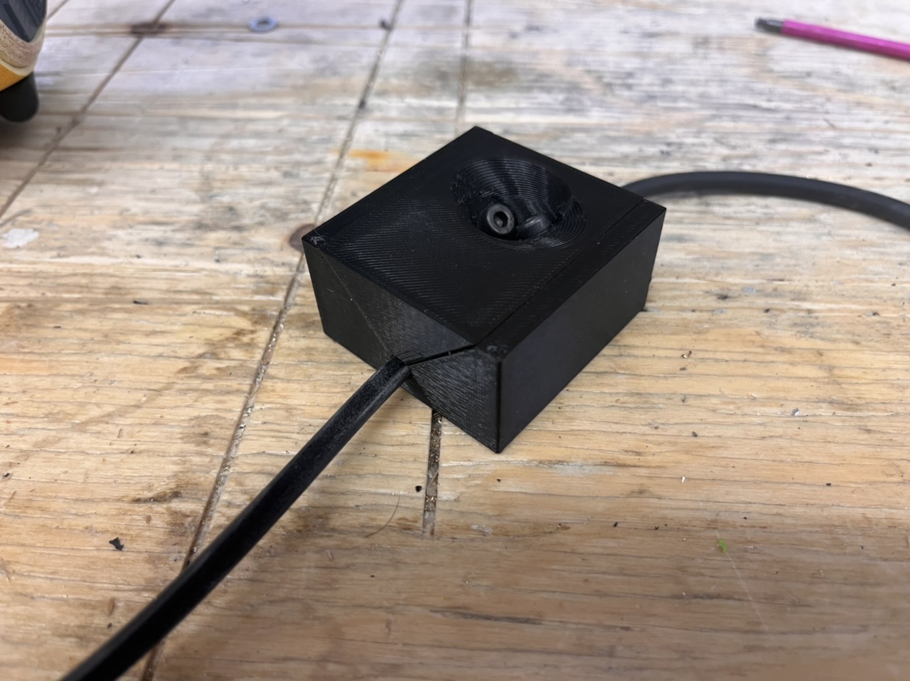

Just a quick message to the remaining ZF1 buyers, I will be getting deliveries booked tomorrow. I have been adding a final touch to your models - the neoprene foam cord that goes around the edges of the lower shell and upper shell.
This really adds the final touch.
For anyone who has already bought a complete replica, or a ZF1 kit, I will be uploading the tool necessary to make these cords to thingiverse, or I can send you the .stl file to print yourself.
It’s a small box shaped bit of plastic that holds two sharp scalpel blades. You pull some 5mm diameter neoprene cord through it and it removes a quarter of the cord (the cross section looks like a Pac-Man)
You use this to glue the cord along the edges of the ZF-1 that requires it, and allows a great gluing surface and a very close result to the film used props.
