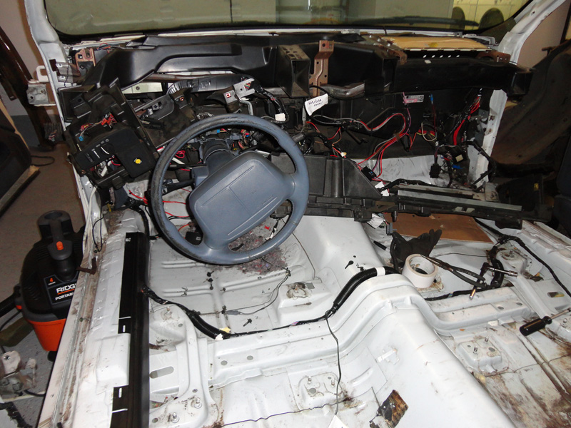

In other news, here's the latest photo. I'm still pulling apart the dash, and stripping the electrical stuff.
I'm Really enjoying this build,especially since you update regularly. I say get Lamm to make some shirts with your title but have the M designed like the Bat logo. Could help fund the project.
Those glued in windows can be a bear. The way i do them is i get a thin awl or screwdriver and try to make a channel in the window sealant so i can get a piano wire or thin guitar wire from the inside of the car to the outside on the edge of the glass. Then i twist each end around a couple wrenchs and saw the sealant all the way around, once you go around the windsheild it will come out. I will say the toughest i have seen are the early 911's They crack if you look at them wrong. The other way is to use a sawzall and just cut the whole roof off. This sound like the most fun way to do it.
