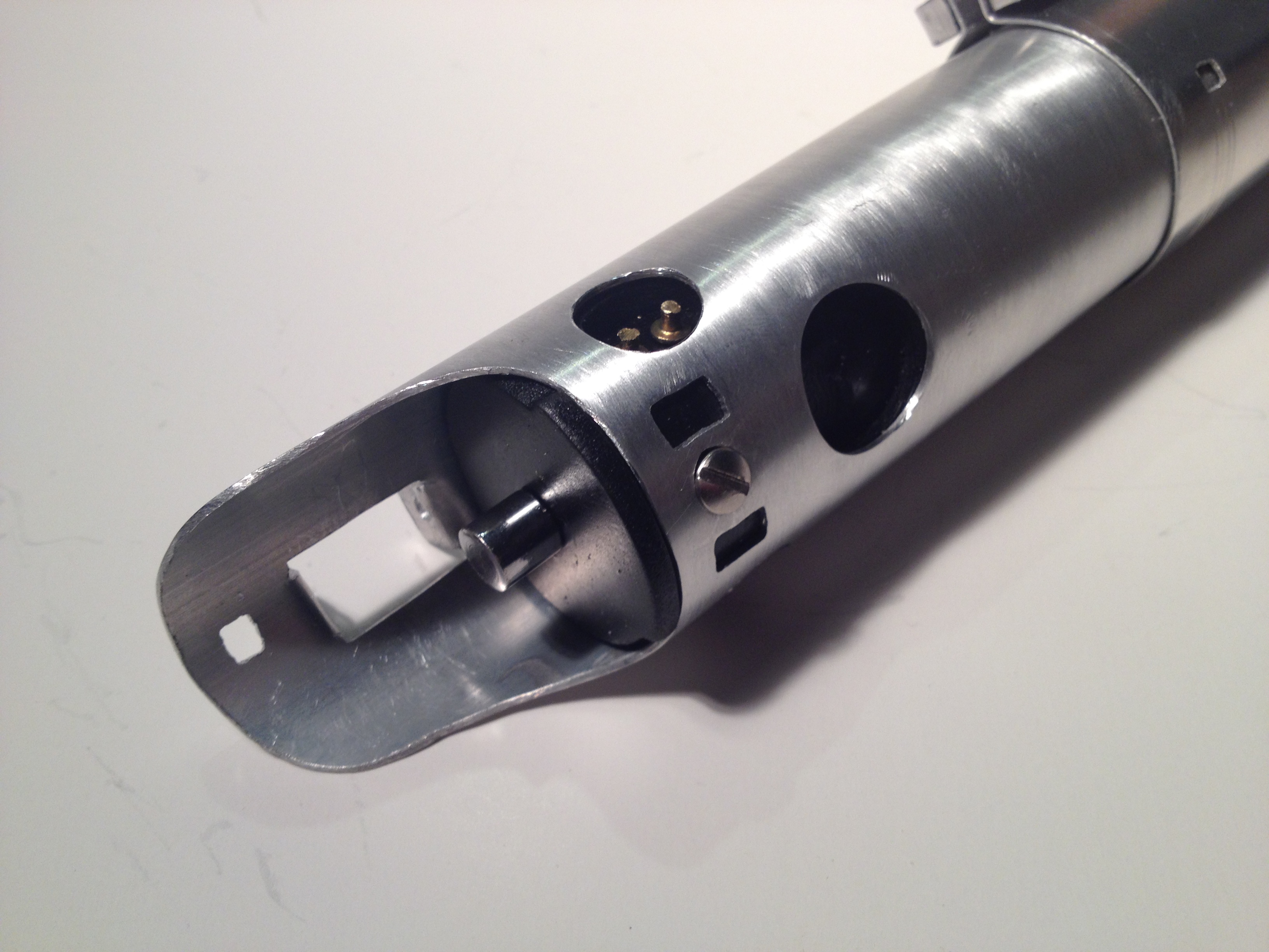

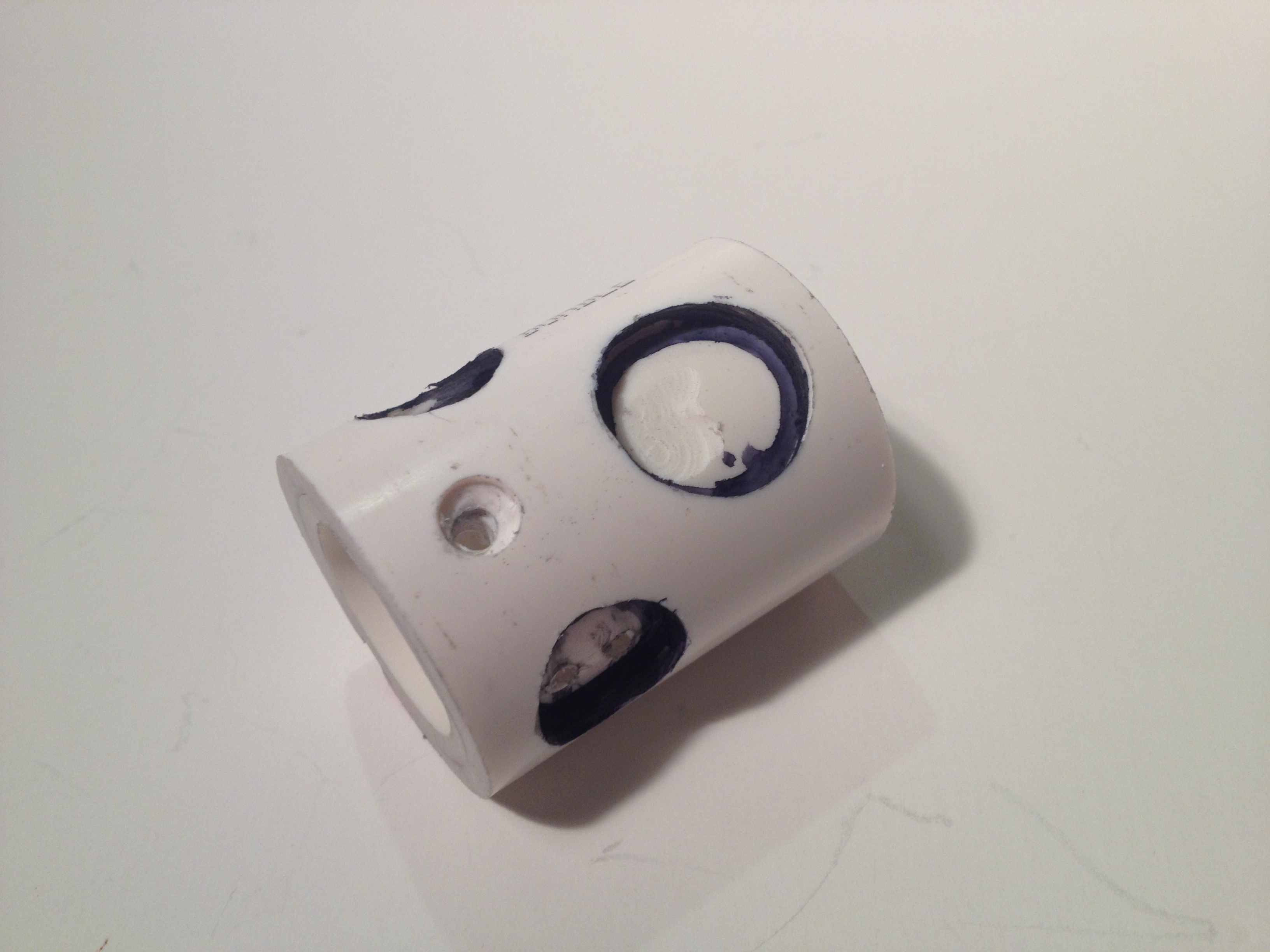

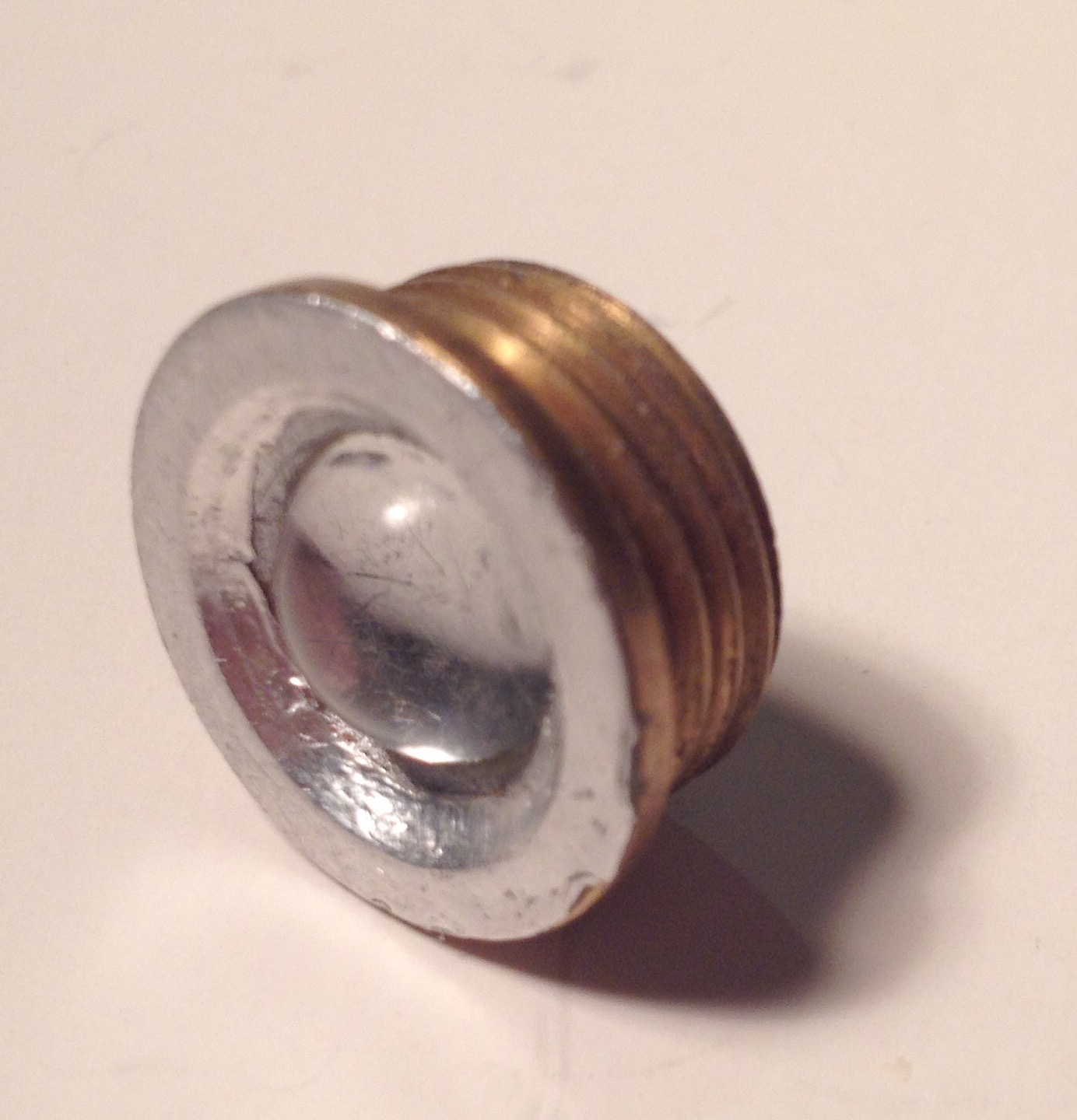

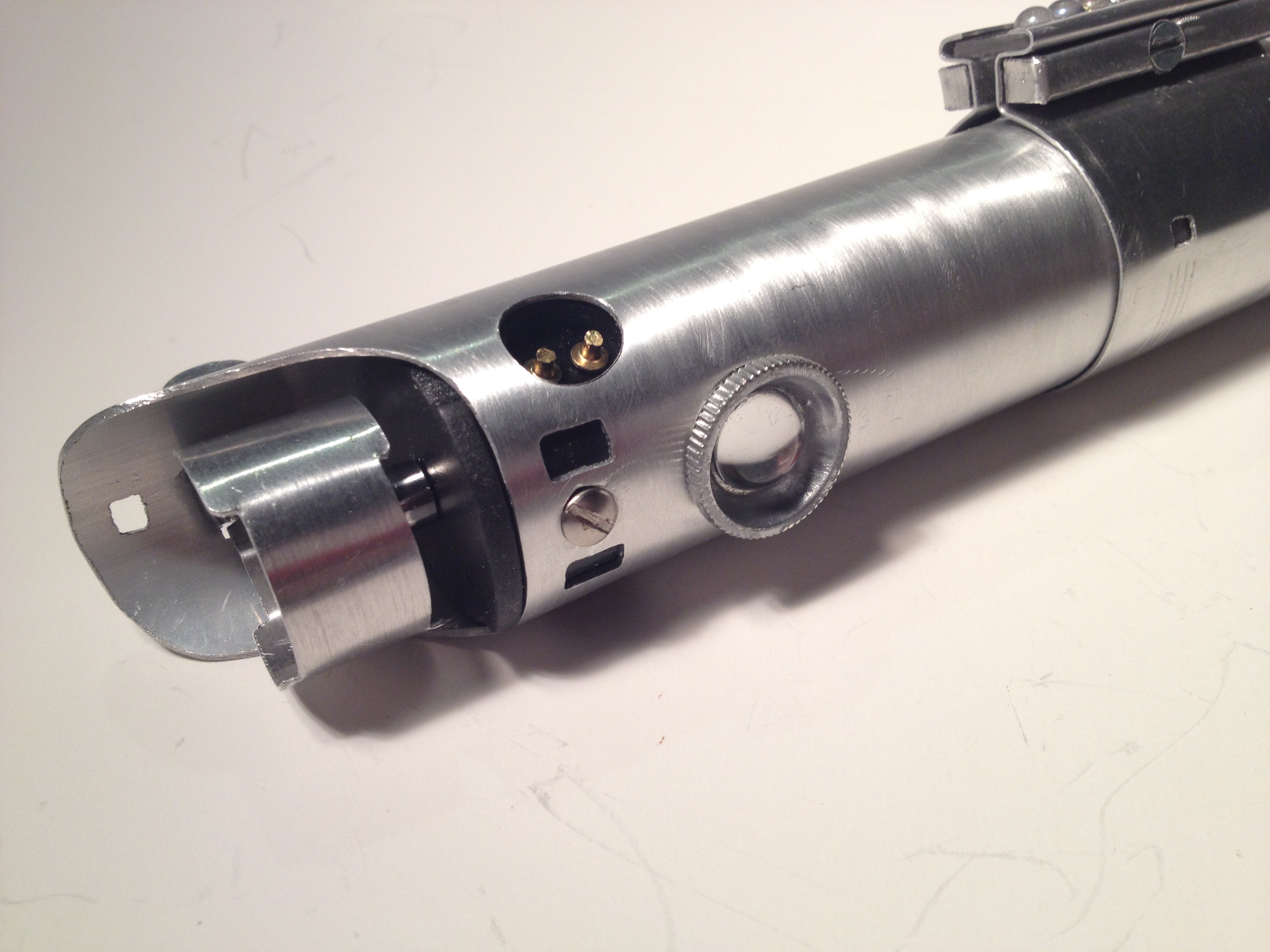

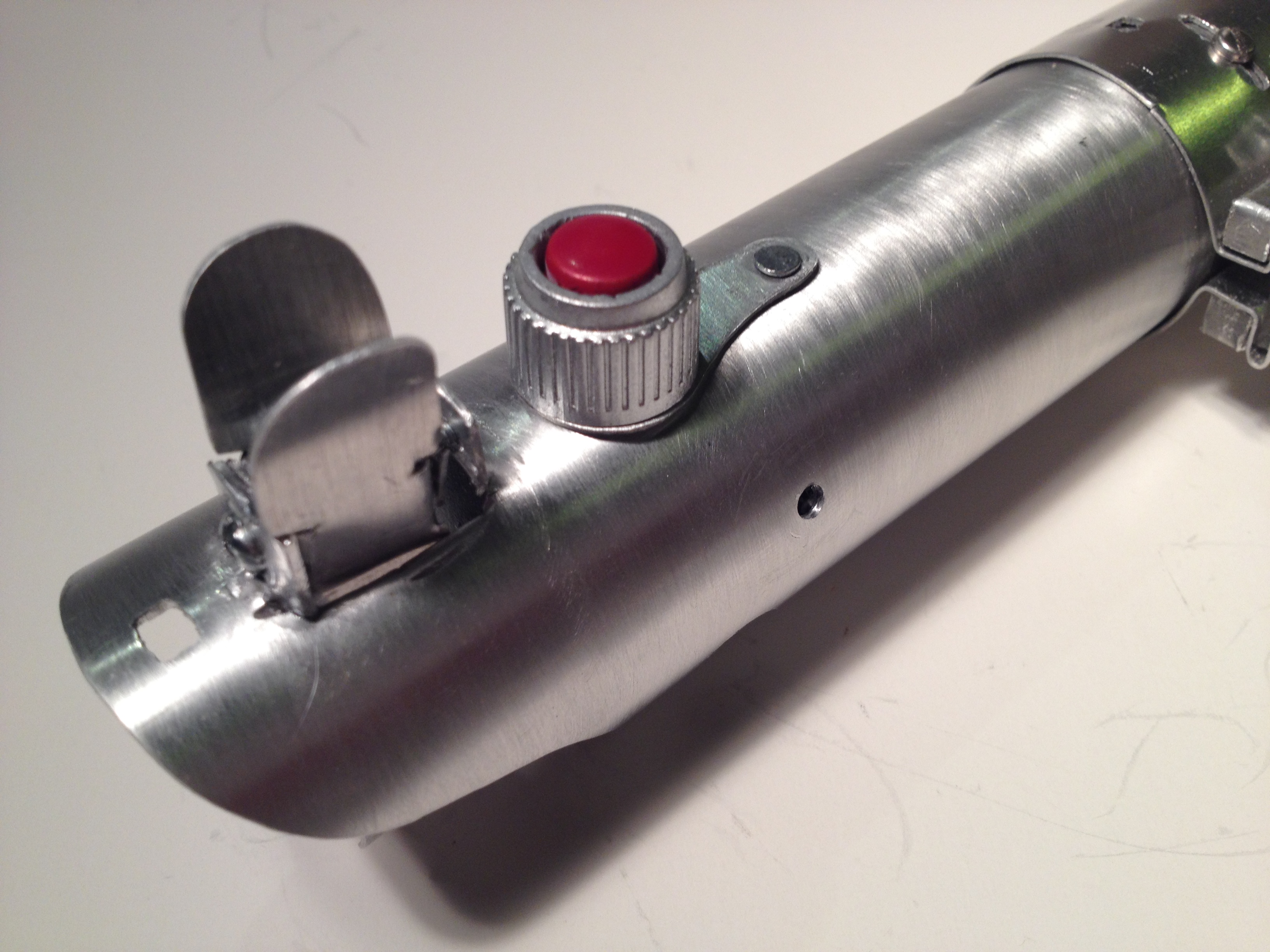

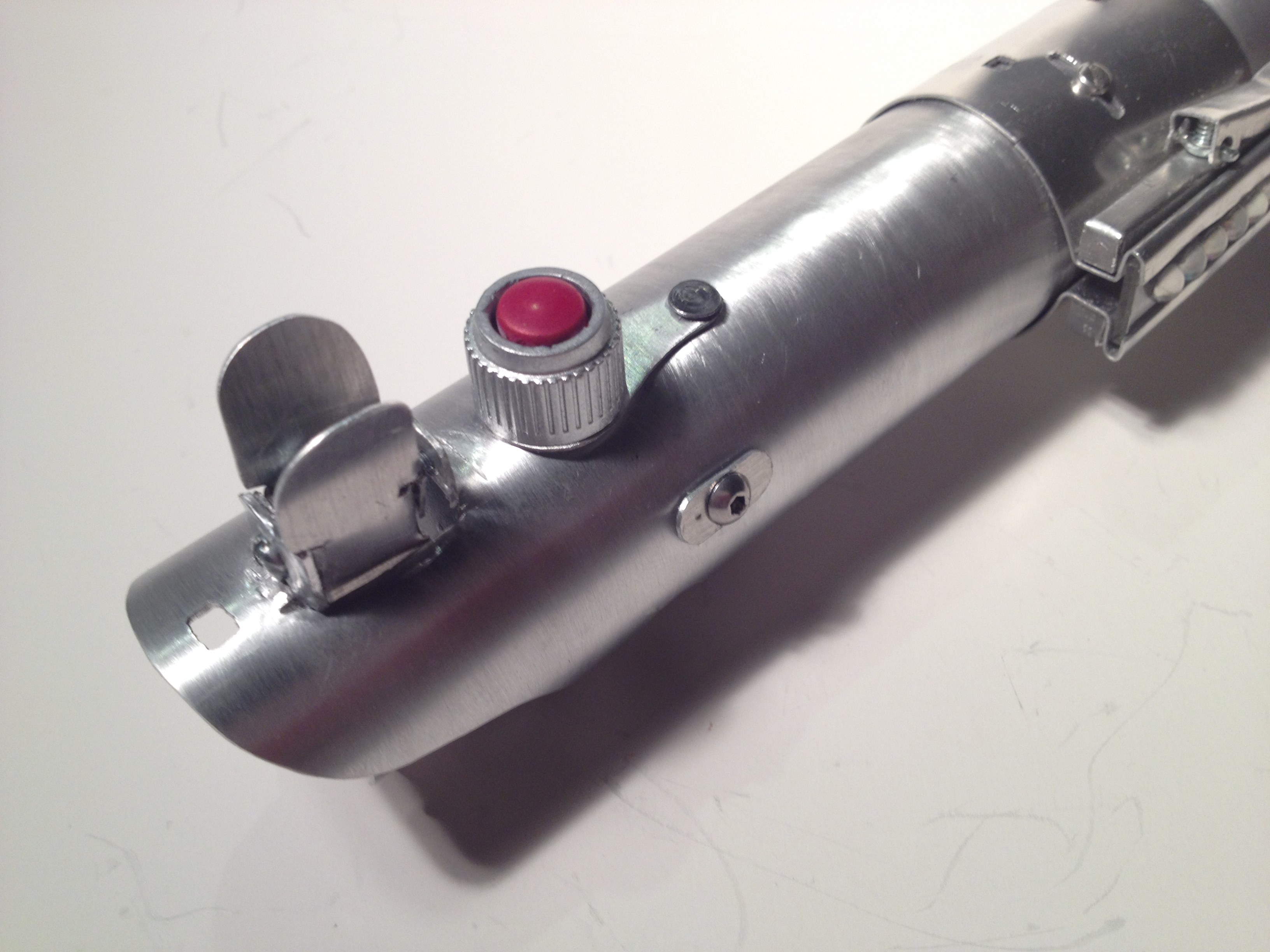

Awesome stuff, how did you get gge bottoms of the holes on the insert flat bottomed? What did you used for the large silver bulb socked pin? And the beer tab?
The bottoms of the holes are still rounded, the pin is a piece of a lighting fixture that got thrown away at work, and the beer tab is aluminum sheet and a nail.
I'll pop in and say a forstner bit in a hobby or bench drill press will get you good flat holes, maybe with a dimple in the center because of the forstner point
Great work, that socket really passes!

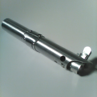

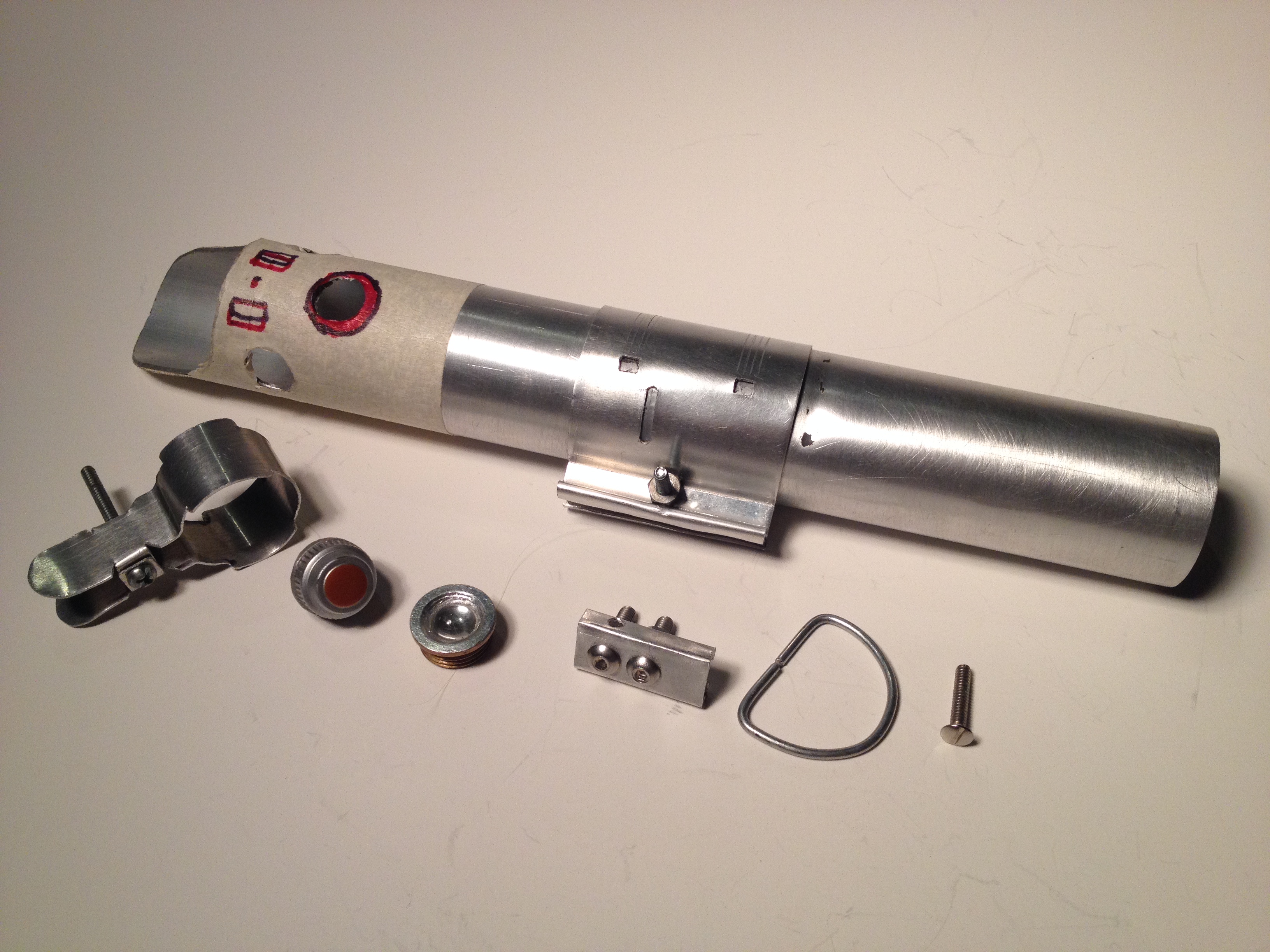

Tan Djarka, which fixing system did you use for the clamp lever ?
This is the most beautiful hardware graflex I have ever seen !
Thanks. If you look at some of the earlier pics, you'll see the bar on the opposite has a 6/32 slotted flat head screw which goes through to hold the swivel attachment from a molly bolt, onto which the lever is mounted. I hope that makes sense.
Yes, your description make sense. Thank you !

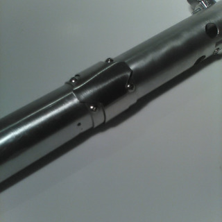

I decided to thin out my collection of saber parts and discovered that instead of the one extra aluminum tube I thought I had, there was actually three! So the one above, which is a little dinged up will be repurposed for a TROS Graflex, replacing the lamp tube already desinated for that project. The TFA/TLJ above will receive an entirely new tube, and maybe one of the remaining tubes will become an MOM Vader.
