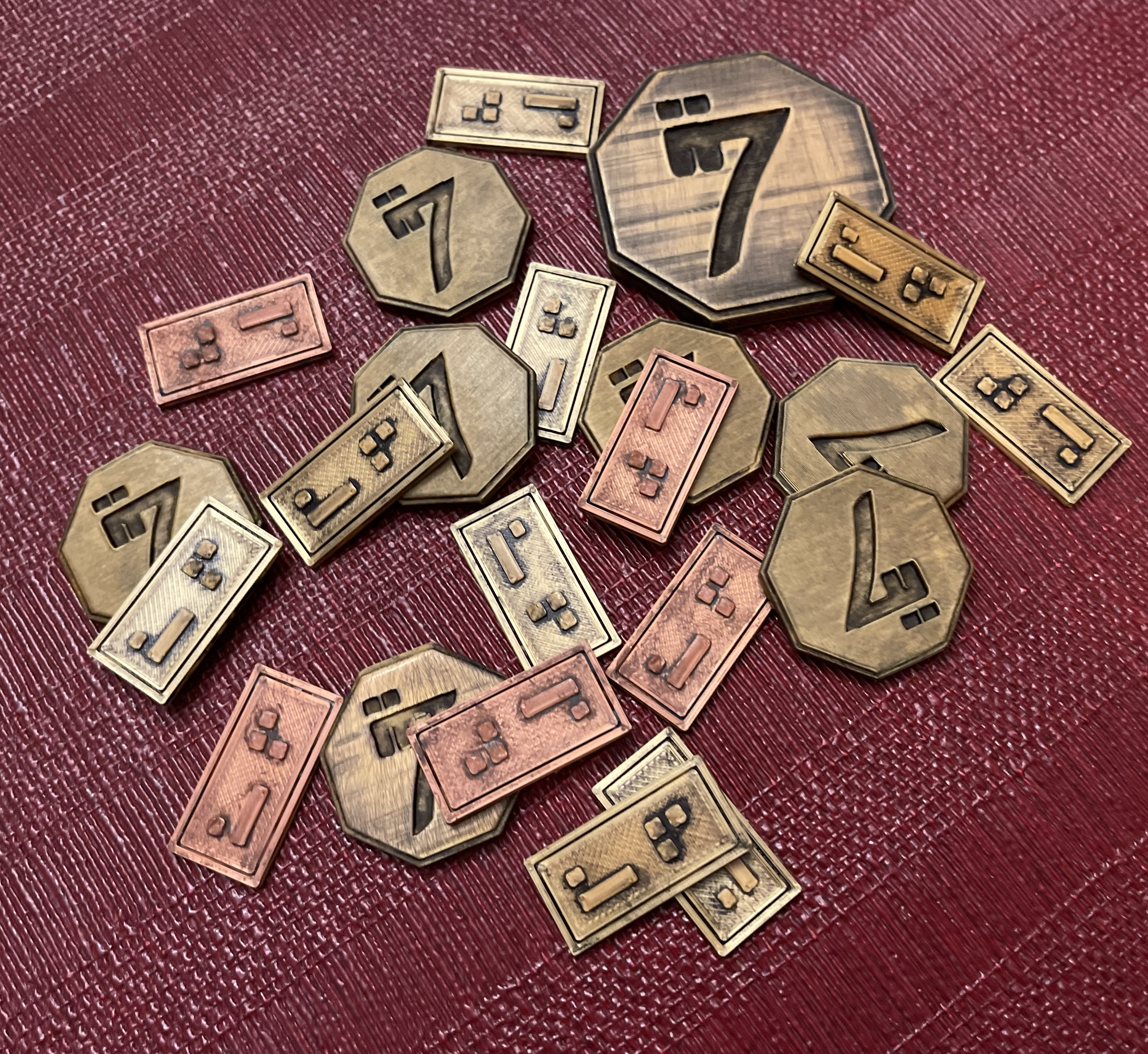

Here's my version of *all four* types of "The Book of Boba Fett" credits seen in Chapter 5:"Return of the Mandalorian" (2:30 into the episode) on the table in the butcher shop where Mando goes to get his target of the bounty he's pursuing (Photo 1).
I've tried to match what's seen in the show as far as size, color, and lettering/symbols as closely as I can with the information available.
They are double-sided and 3d printed in solid-color gold, gunmetal, silver, and copper PLA plastic.
They have embedded steel weights (that's why they're thicker than the show versions) to give them some heft, increasing the realism without making them too heavy (photo 2):

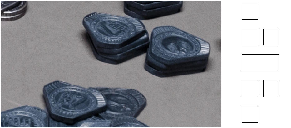

The color of what I'm calling the tri-corner credit was tricky to match. It's a gunmetal color, but with lots of blue in it. It all depends on the lighting and the background.
Photo 5 is a side-by-side picture of the credits on the table in the butcher shop scene with my credits. The butcher shop is more brightly lit than the shot where Cara Dune picks them up off the table in "The Mandalorian". In that scene they are very gray looking. There's also a couple of them seen in Boba's helmet. In that lighting they look almost black. Because the butcher shop scene is brightly lit, I used that color for my credits.
I've been able to get a relatively clear look at the back of the tri-coin and here is what I believe the pattern of squares next to the credit sign to be.
It looks to me like the "tricorner" might be pewter? That has a similar blue-silver colour, and would be pretty easy for the prop department to cast a whole schwack-load of.
Also, it looks to me like the details on the screen-used coins are embossed, whilst yours are mostly debossed. I'm curious - genuinely curious, this isn't a backhanded criticism - as to why you opted for debossing.
As far as the color, I'm making mine with a 3D printer so I have to find a filament color that matches.
The ones I looked at that were labeled "gunmetal" or "pewter" looked too much like the filament I'm using for the silver tear-dropped shaped coin.
So I decided to emphasize the blue a little more. The filament I used has some aluminum particles in it for highlights and to provide some gray so it more closely matches the color in the well-lighted scene at the butcher shop.

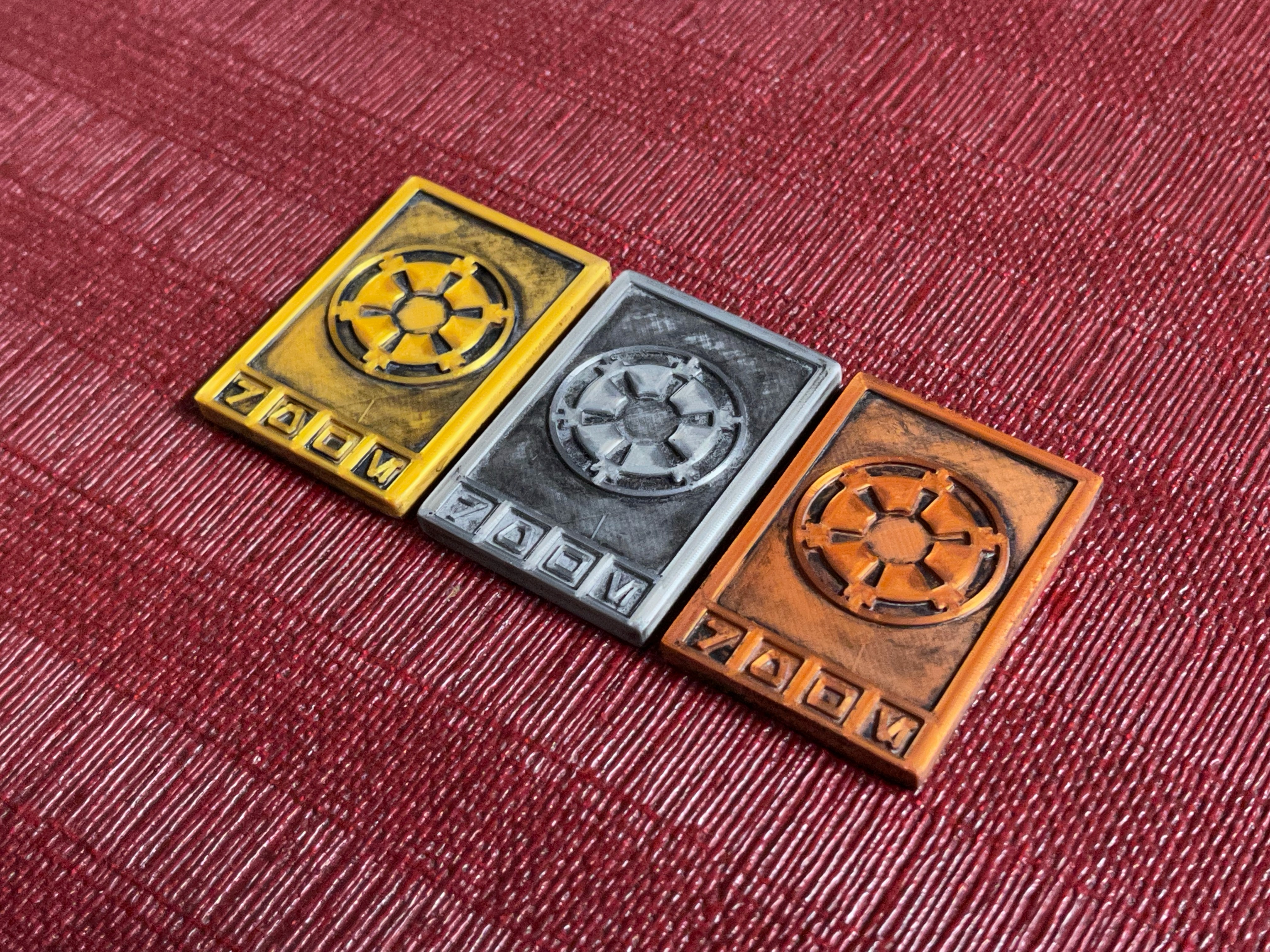

Here's a couple of photos of my replica of the Batuu Spira "gift cards" found at Galaxy's Edge. I took some liberties to make a multi-denominational set of credits (I think, so far, there are only gold & silver versions). On the top, the lettering and other details are large enough that embossing them was okay and can withstand handling.
The gift cards have wording on the back (legalease rather than something in-universe) so I decided to engrave the denomination along with a border on the bottom to make them look more interesting. Engraving these details on the bottom of the print works a lot better.
My $100 value credit's color is most similar to the original $100 gift card:
