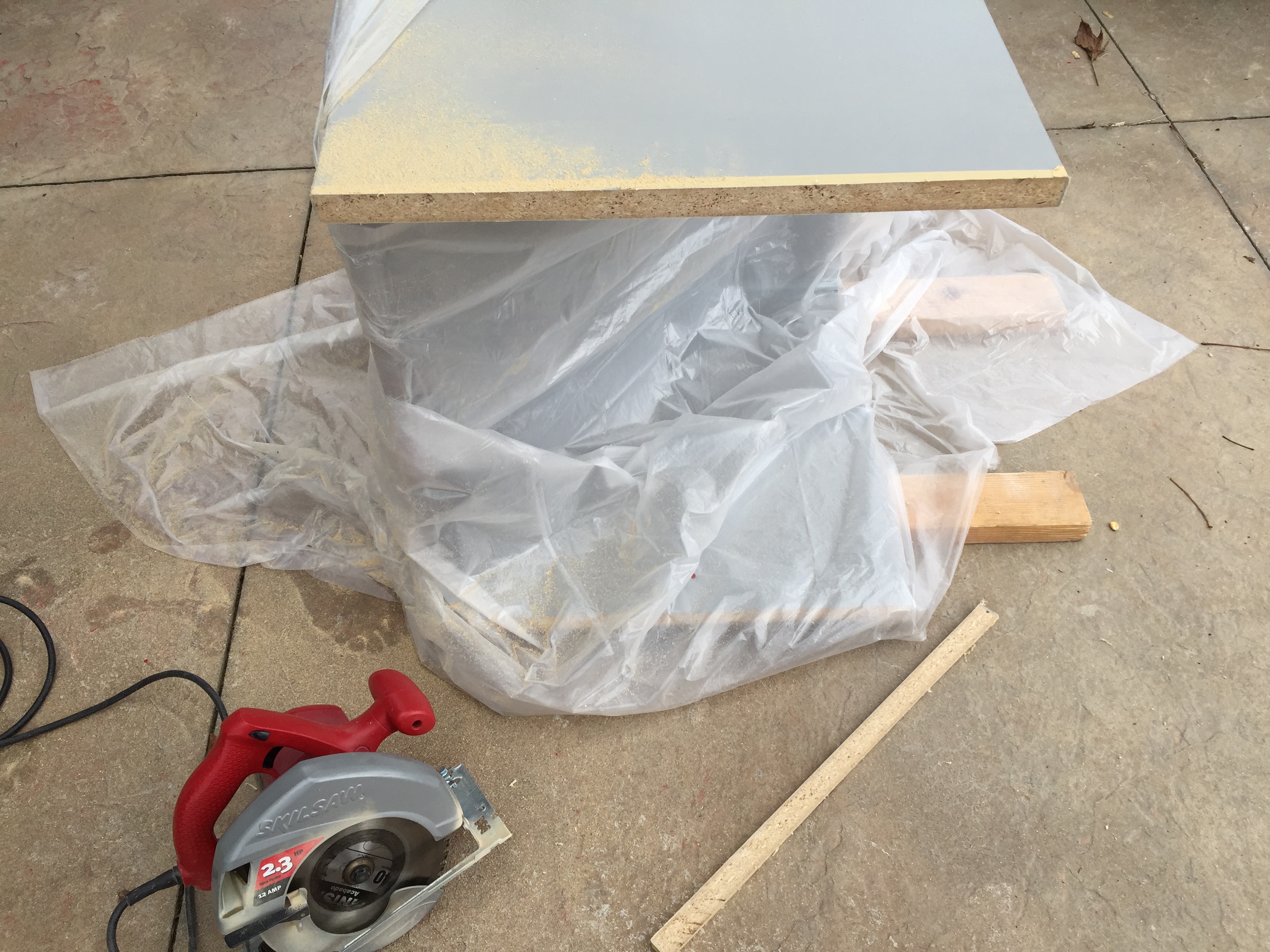

Wrapped in plastic to keep as much sawdust off as possible, especially the roller bearings, and taped to deter laminate chipping:
Just as clean as a phaser cut:
A whole 1/4" had to be removed (that's well outside of manufacturing error tolerance) but it now fits properly under the desk:

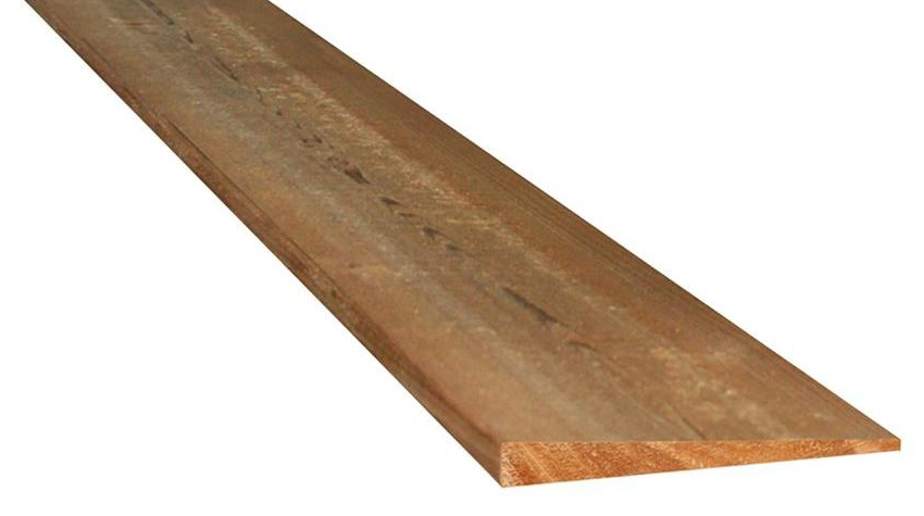

I got the molding ordered for the tackboard frame - the best match I could find is SeaTeak Bulkhead Cap Molding (aka teak cap molding) and I'll simply reduce its height. The last material for me to source is still the red alert panel frame. Does anybody have ideas/suggestions on where to find this frame material in 1" width? It's not flat, there is a slight bevel to it.

That molding you're looking for looks like picture frame stock installed fat side in rather than out. Try your local custom frame store.
I know, right? You'd think it would be that easy. Picture frames are all too ornamental (nothing plain like that) and much too thick. I have found something else that might work, though...

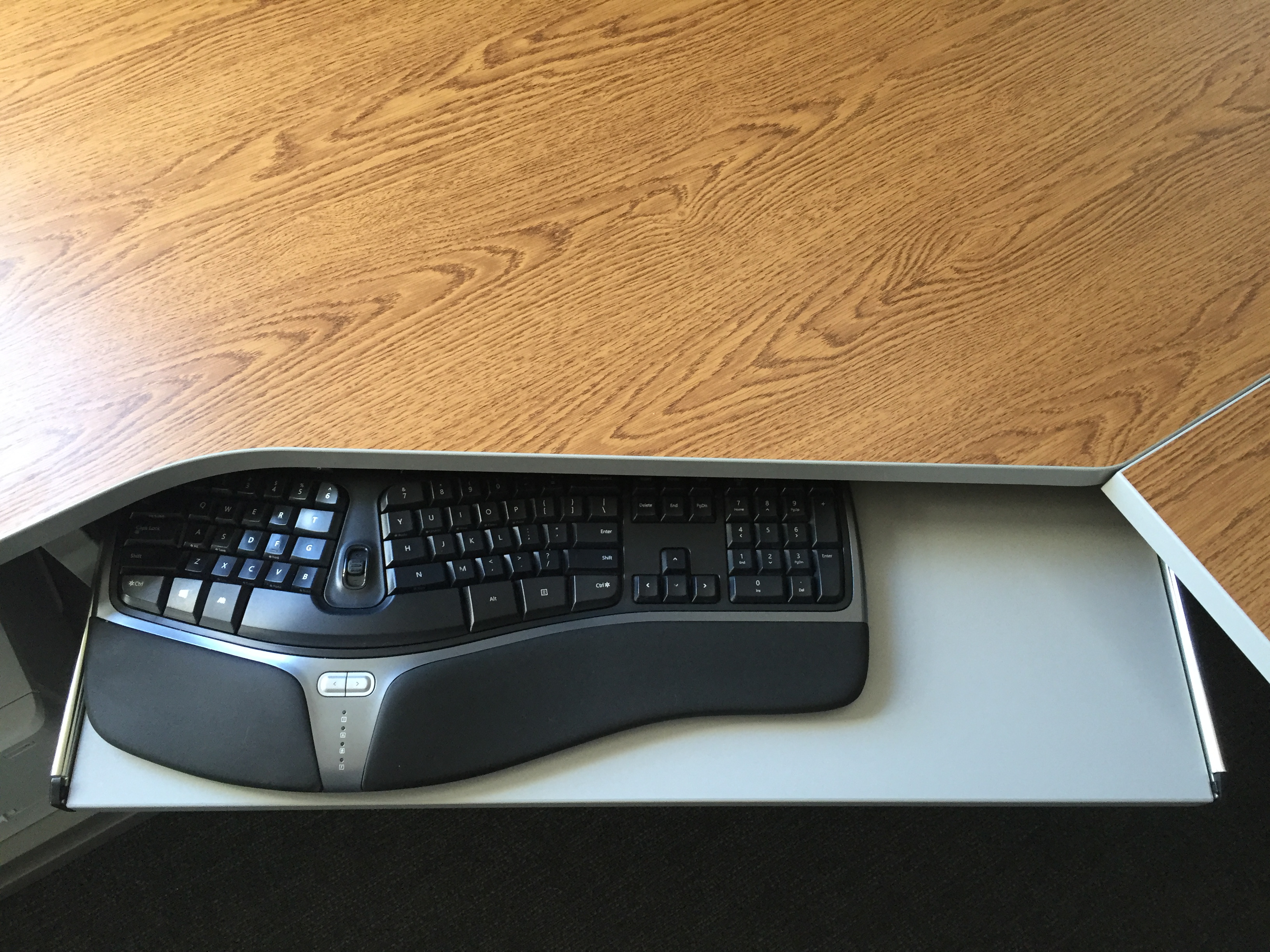

Alright, some significant progress made today. First on the agenda was installing the oversized keyboard tray. You'd think Maverick would have had this all worked out, since I bought the desk and keyboard tray at the same time - obviously I intended to use the larger tray in place of the standard one. But my cardboard template for the bracket locations revealed a big problem:
In the tray's optimal location one of the desk's metal brackets for connecting the right side interferes with one of the tray's brackets. Dang it. Since there was no way I was drilling two holes through 1/8" hardened steel the only workable solution was push the tray back:
The bad news about this is now the tray doesn't extend as far as it's meant to:
For what this desk cost, the expectations were a lot higher than the shoddy manufacturing I'm seeing. Luckily my ergo-keyboard is large enough that I can just pull it back while working, but really - at $3,500 I shouldn't have to be doing that.

Here's why I wanted an oversized keyboard tray (the TRON mousepad probably isn't Starfleet regulation):

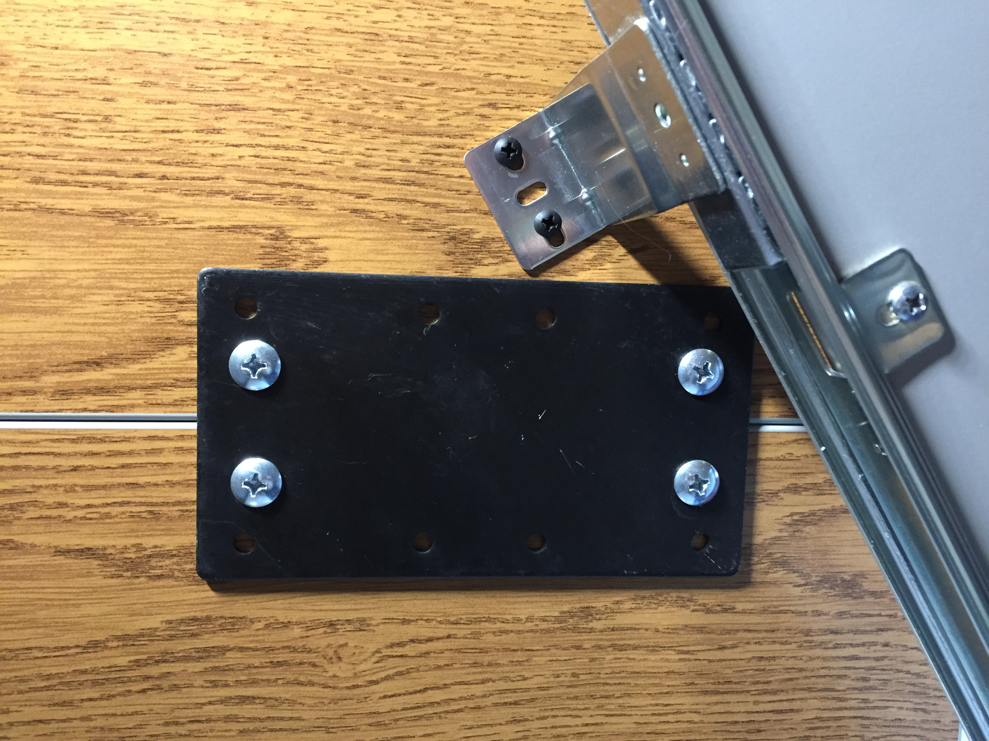

Being a programmer, it really bothered me not having practical access to the full keyboard, so I examined the offending metal bracket to assess relocating it. As it turns out, the metal bolt sockets have hex heads and threaded sides rather than being hammered in - so I was able to remove them and drill new holes:
I also shifted the tray to the right so the keyboard is more in-line with the monitors. Now the mouse pad is partially obstructed by the return but I can live with that since I use the keyboard more than the mouse, and its new location enables the left-side drawer to be opened while the keyboard tray is extended.

I've also sourced molding for the tackboard frame. It's called "SeaTeak Cap Molding" and its 7/8" width is close enough to the 1" target, especially with the smaller size of my tackboard. It's scheduled to arrive today and I'll simply cut off its bottom half and then screw it on from the backside.
