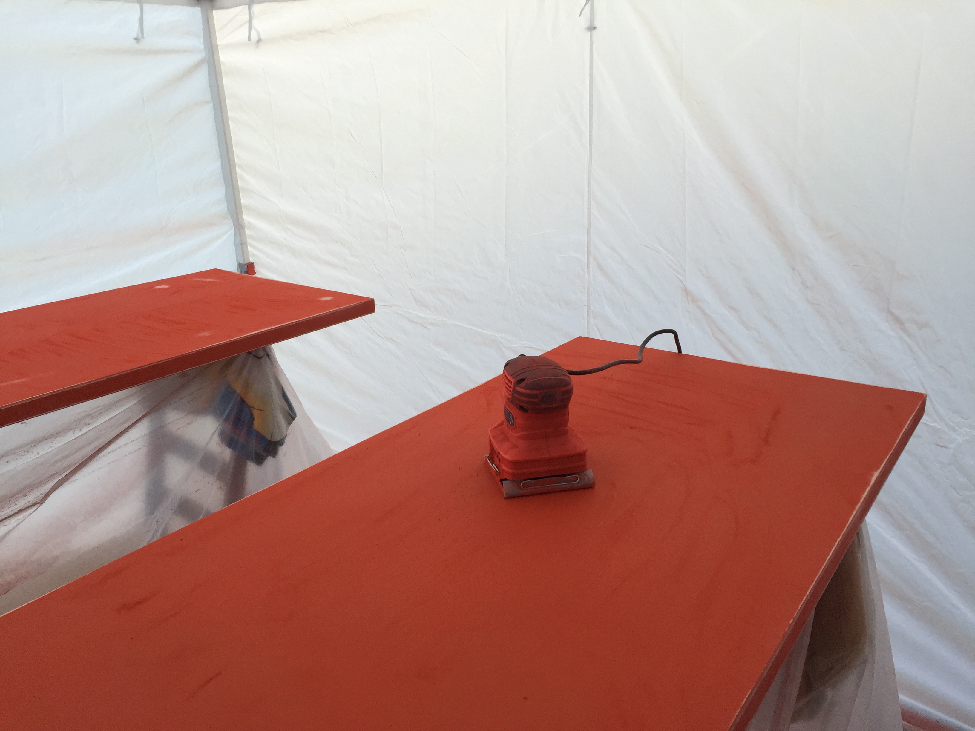

All the white areas were high spots on the doors, so in a way I'm glad about taking a sander to them - they will be much smoother than if the original plan had worked out of just taking them home and painting them.
And this is why you wear face protection:
Yep, I had quite a "Total Recall" Mars landscape thing going on with lots of red powder. Both doors are now ready for paint but ran out of daylight again by the time sanding was done.
You should invest in cartridge filter mask.
Just saying.
A respirator? I've got one - use it mostly for chemical vapors. But for dry particulates like sanding dust a regular dust mask does the job. Yes, a respirator would be better, but considering there was no red powder anywhere on my face where the mask and goggles were I'd say they did their job adequately.

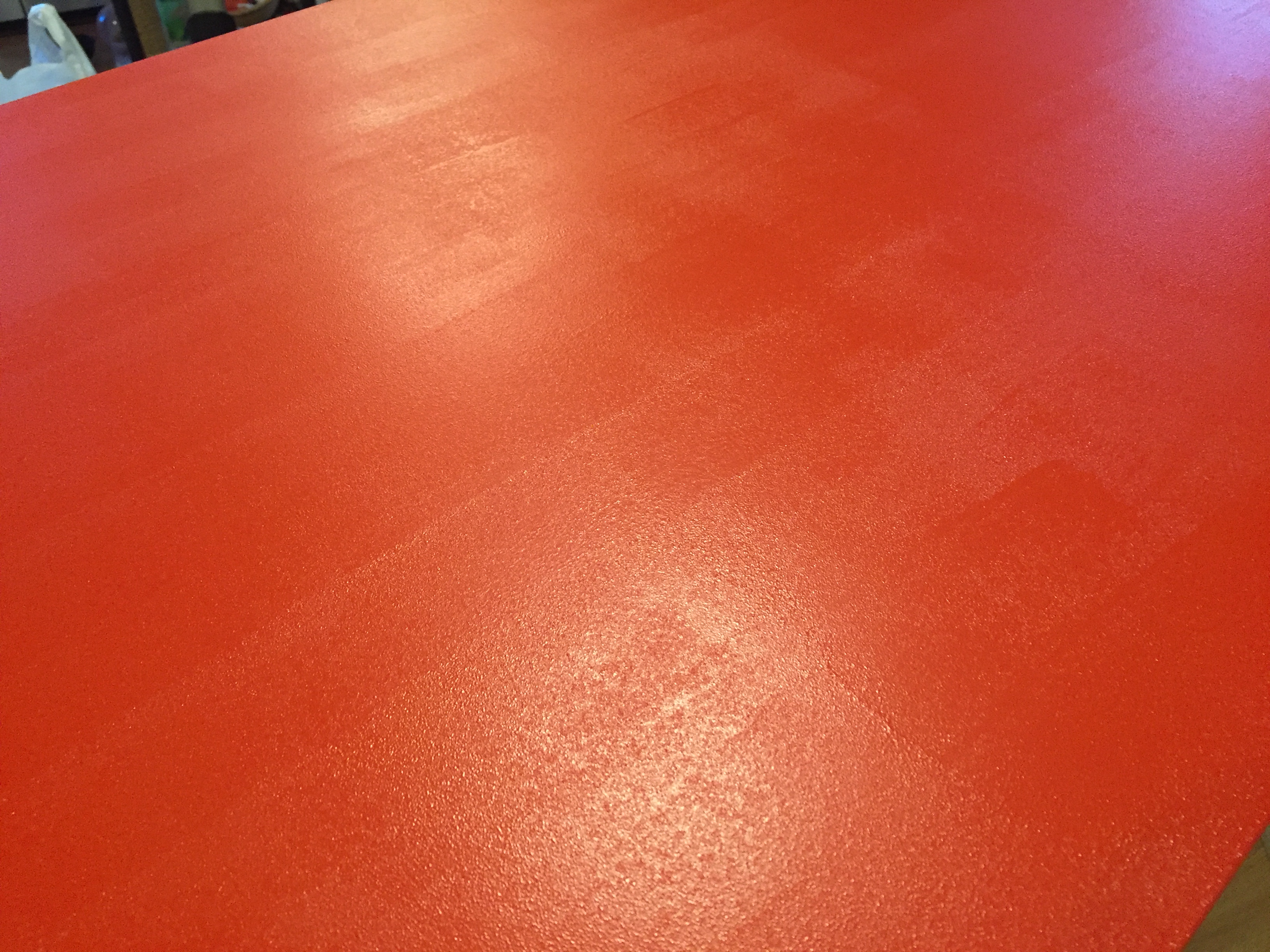

No photos to show yet, but here is what's been going on. Spray painting the red doors is a no-go. Although the Krylon Pimento is a good color, rattle cans seem to be 90% propellant and 10% paint. The little bit of paint which does come out is so transparent that after 3 cans on just one side of one door it's still not coated. So, it's been sanded off. (That whole "experiment" was a waste of time and money.) Next I drove over to Sherwin-Williams with the "Fire Cracker" paint to see about getting some Pro Classic. Nope - they cannot reproduce the color in Pro Classic (base isn't dark enough), and in fact....they could not reproduce the color at all after 45 minutes of trying. I told them to just give up and I'll stick with the Home Depot paint. The more I compare the "Fire Cracker" color to screencaps the more I like how the paint looks. The backsides of the doors have been painted with a foam roller and are curing now. When I flip them for painting the more-important side I'll need to roll slower to not introduce air bubbles into the paint (which end up not popping during settling because of how thick the damned Marquee paint is). These doors are cursed.

Still getting roller marks with a foam roller, and yeah I do know how to paint. The Behr Marquee, most expensive paint in the store, is absolutely horrible.
At this point I give up, and a professional painter is scheduled to come over tomorrow for sanding the doors back down and spray them.
