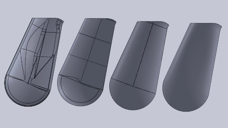

I’ve thought about the grips a lot. I think they’re just lathed slightly conical cylinders, cut in half. Then you just have to figure out the little cuts at the top, they’re a bit wacko! I might be wrong as always, I haven’t done anything to confirm this, just imagining how I might make them.

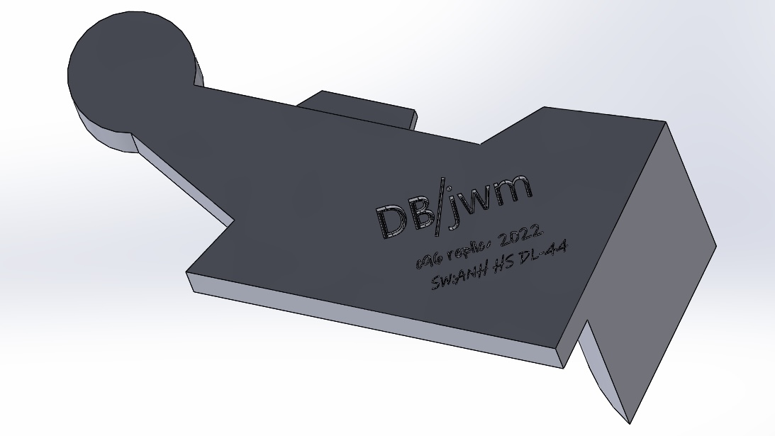

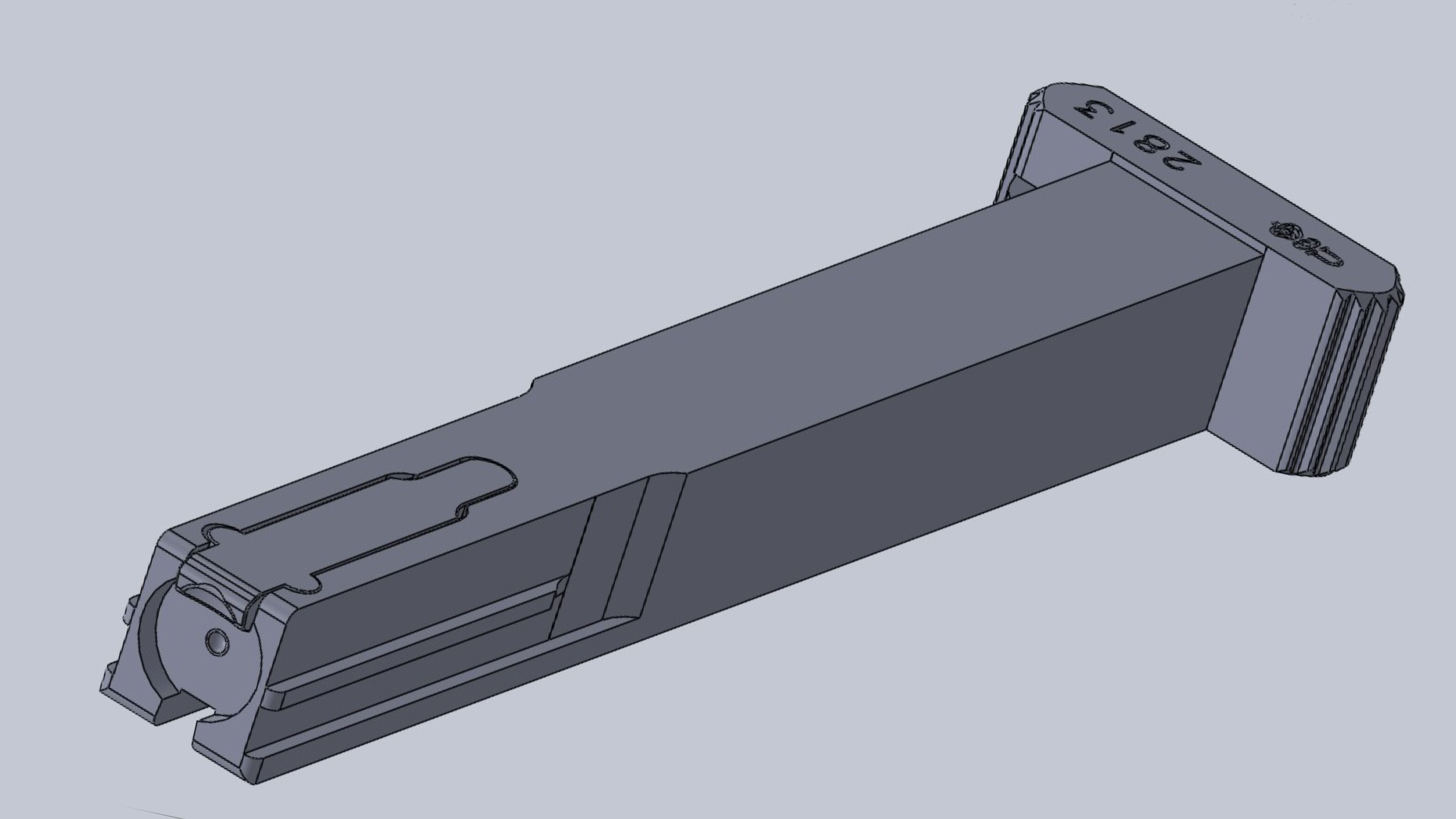

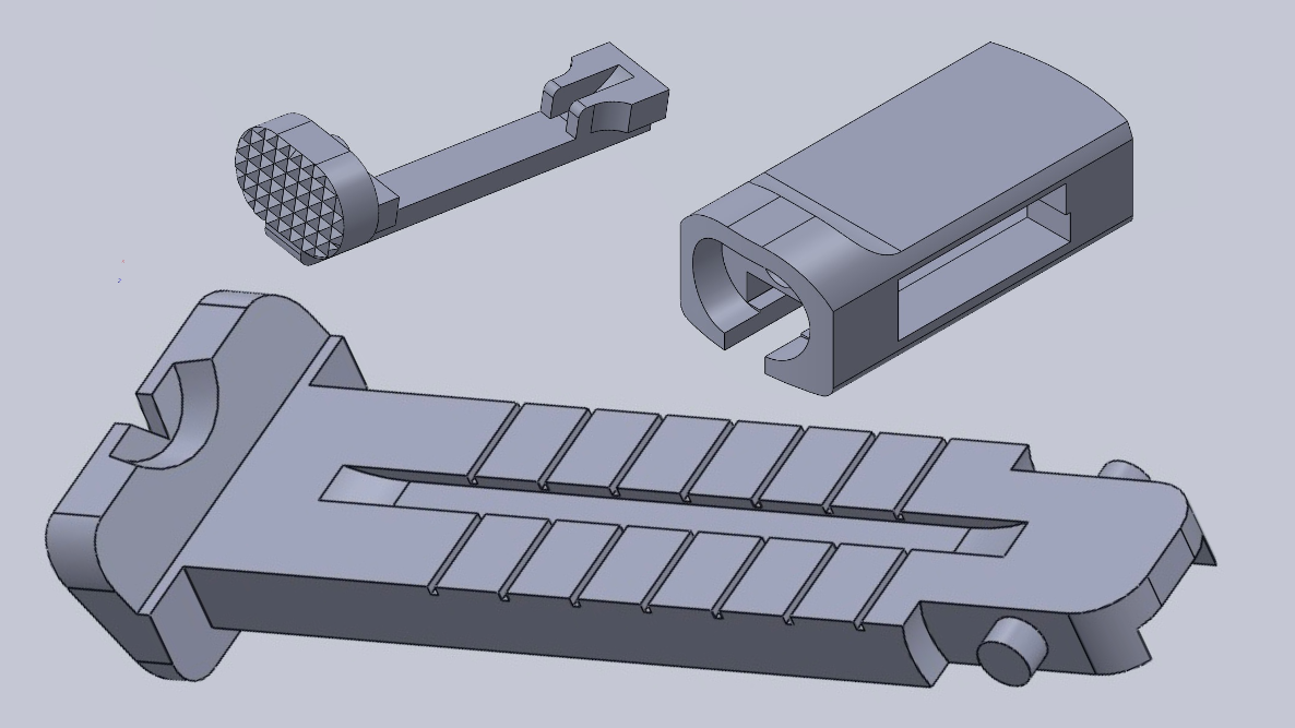

Here’s a few assembly pictures of the bolt and extractor..
Looking good, buddy!

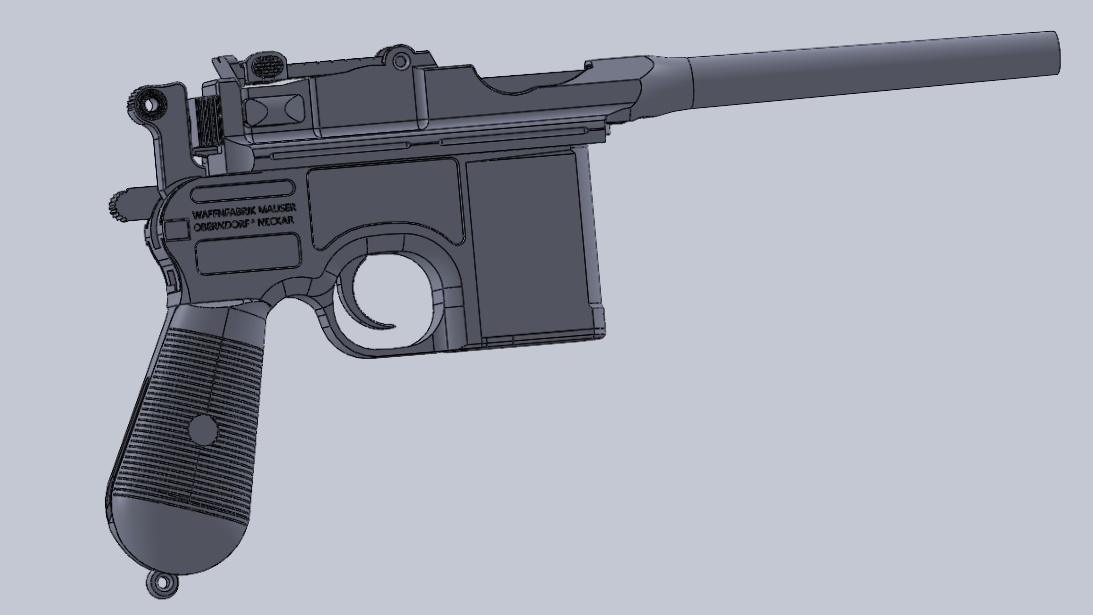

Ya I’m getting close to having all the parts reverse engendered. How that Lockframe works exactly is pretty interesting and I’m going to have to study some Videos to see how it all “works”. That V shape part you mentioned will be a real test for Nylon printing. I had to thicken it up a bit in hopes that it will still work as intended. Should be definitely interesting.
This Mauser is truly a thing of beauty and being able to break it all down really enhances just how amazingly detailed it really is. Such a fun project!
Here is the sight which I’ll add some numbers to as well in the near future..

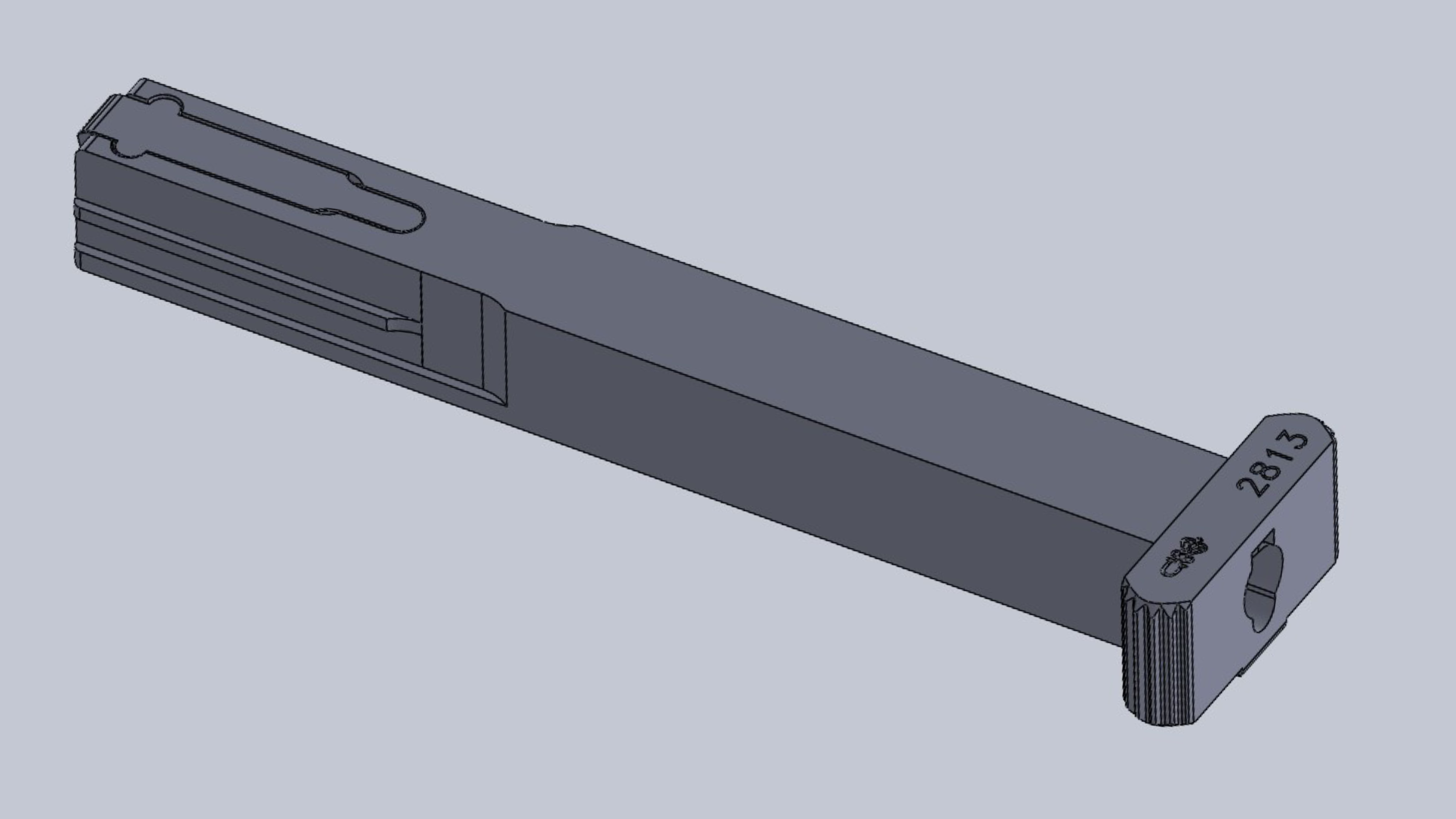

This is the last part I believe. I think I have all the needed parts recreated. Now it’s onto the next step of making sure everything is correctly spaced for printing, then creating authentic sized/styled letters, numbers and stamping marks. Lastly.. assembling it all together :)
Sorry I should say I’ve reverse engendered all the parts that where graciously shared with me. Forgot I still need to do the grips (and probably a few other small things here and there) but still very much well on my way!

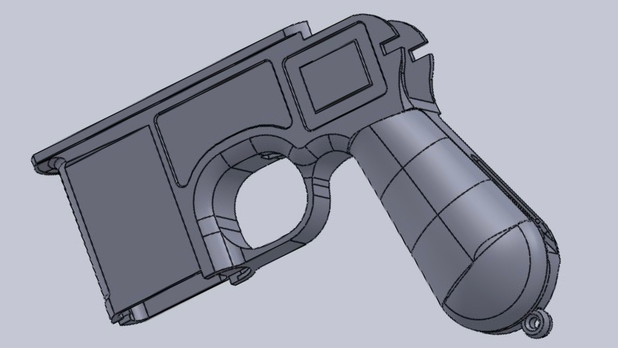

These grips are a trip. Not sure the best way to go about recreating them and had to go down some rabbit holes on YouTube but they are slowing taking shape.
DEC Dave realized that the grips were actually turned on a lathe first for the curves & grooves, then the hand work afterwards. I had trouble modeling those too, but Dave figured it out!
The revolve axis is well below the bottom/flat side of the grips, creating the seemingly difficult to model shape they have. But if you find the correct axis point below the radius' of the grips that's all there is to it as it turned out. It completely went over my head when modeling them myself. Dave used a fixture to do two grips at a time, which seems likely that Mauser did too to save on wasting walnut.

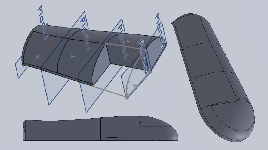

Finding a low axis point fully makes sense. Thanks for sharing that info. This here is my 2nd attempt and much cleaner.. worst case scenario they will get the job done I believe but using the info you mention above I’m going to try and redo them one more time. See if I can get the surface with one simple cut.. probably two though. The bottom I think will still have to be done with a revolve .. ?

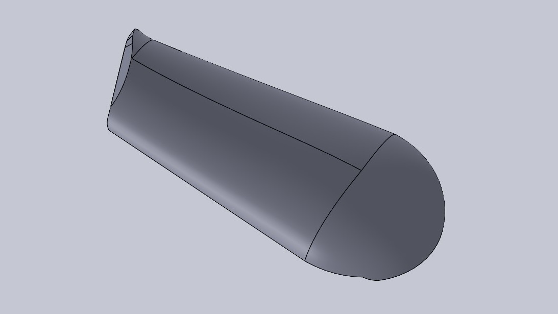

Finally got the grips to be seamless as desired . 4 attempts and many hours but they are most definitely now smooth!
From left to right you can see the progress (and learning cure) to get there. The first attempt took the longest and used many fillets, 2nd much less fillets, 3rd was still leaving behind the build lines but at least no fillets needed. Almost stopped here but figured one more attempt should do it.
4th = no build lines or fillers needed :)
I was positive it could be done, just needed some time to figure it out..

Ya I think ur right on all accounts. Most definitely always room for improvements.. I’m still trying to do just that on these grips actually. I noticed that the back and fronts are somewhat flat but the bottom is not so I’m presently adding new planes for guide cuts. It’s a bit tail chasing but I do have a very specific end goal in my mind. I can see what I want.. just trying to bring it into reality..
