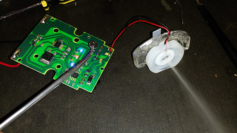

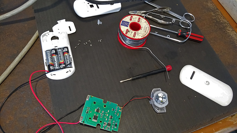

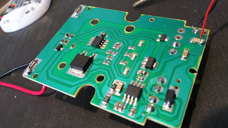

Started dismantling the nano spray unit today to extend all the bits and fit them into the suit and gauntlet. I'll have to find some thin rubber hose to extend the water reservoir away from the gauntlet and into the arm, but very happy I worked out how the thing is activated with a reed switch and magnet.

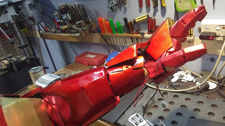

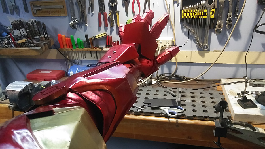

Worked until 2am this morning in the back shed, making use of the cool night air. Started fitting the gizmo into the arm and hand.
I found the perfect tubing at Bunnings for a little over $5 for a roll. Now I can put the reservoir up in the arm where it's easy to get at and refill, plus the repulsor bursts will last longer.

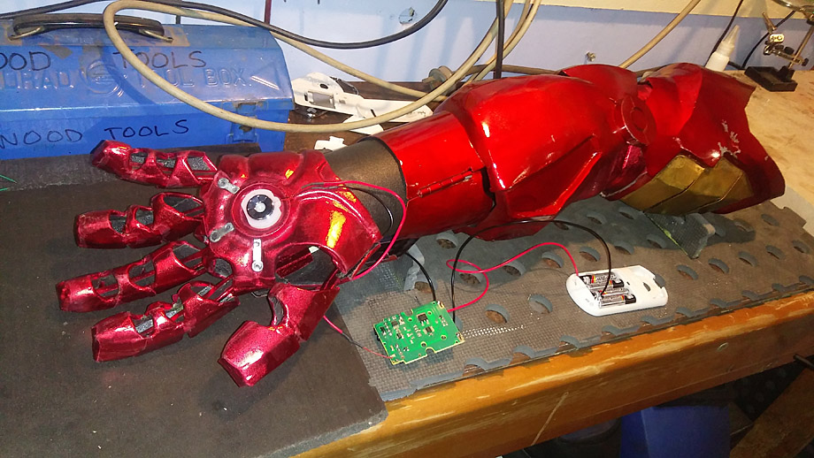

To replace the bulky plastic reservoir I melted the pin out of a plastic thumb tack, then dremelled a hollow in it, turning it into a custom-fit cap for the back of the nano unit. The small cap on the left is a snap cap off a shower screen screw that proved too small for the job.
Modded nano unit. Fuel for the repulsor now gets delivered by longer lasting reservoir up in the arm.
Repulsor control module installed.

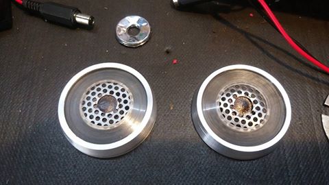

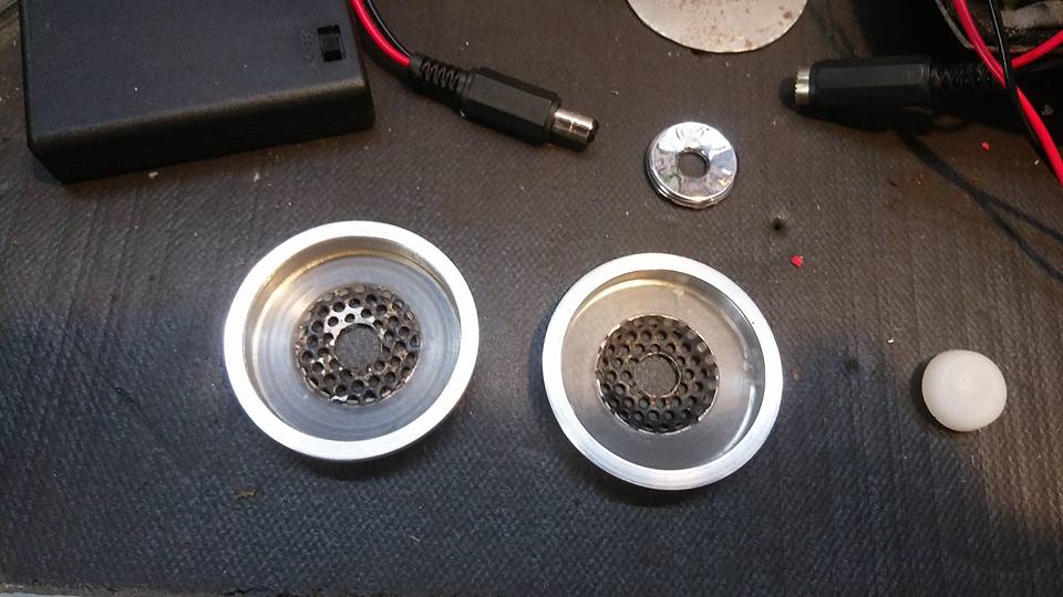

Turning and recessing a perspex lens with steel speaker mesh insert. The LED ring light goes underneath the perspex.
There's a flat steel plate underneath the unit, inside the glove that sandwiches the glove material in between it and the unit above, tidying up and securing the whole lot.
All I have left to do on it now is turn the aluminium outer housing.

Voice changer arrived. It sounds crap, but has one mode that sounds ok. Maybe I can find the pot if it has one and tweak it. Need to boost volume too. Time to rip it apart and see what makes it tick.
