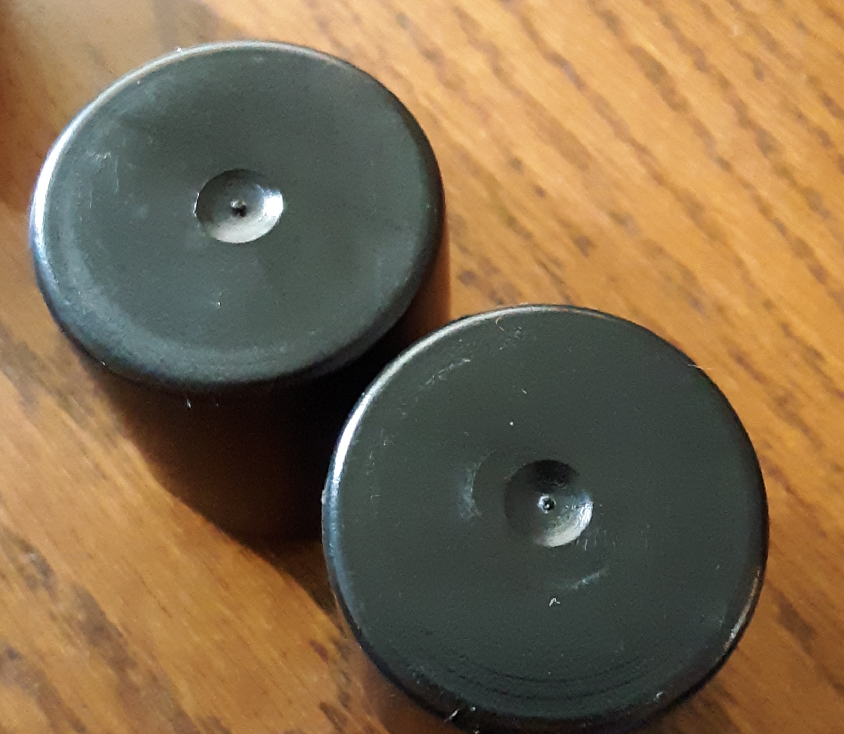

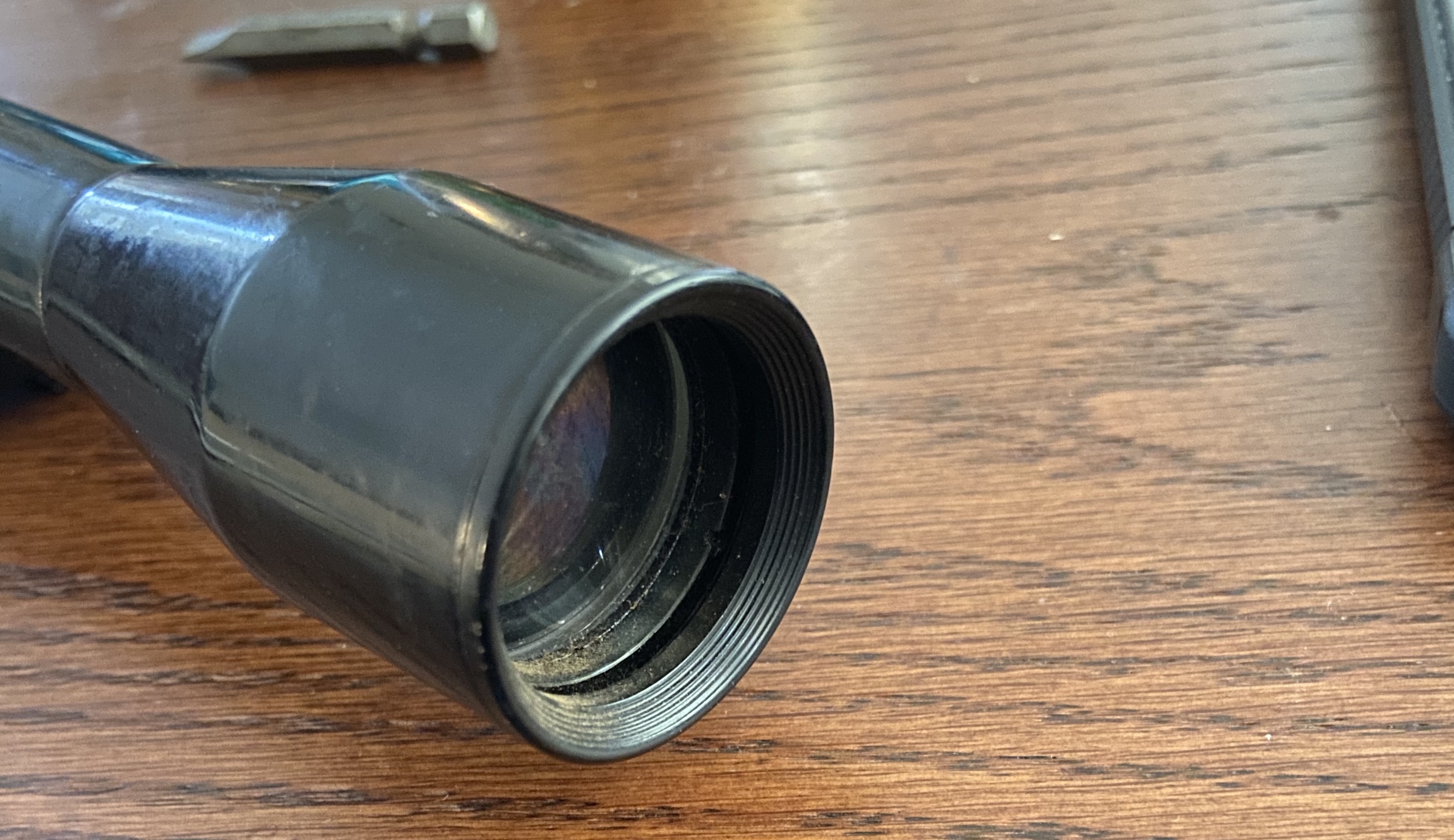

So, going by the one found part we know of (this is the only one I have and I molded it actually this year) I also am of the camp that film canisters were used. Modern ones are a HAIR smaller than the cap used in Return of the Jedi
The bottom edge is too round too. Anyway, Ive been digging through old brands and have only found 1 vintage one with a completely flat bottom and no dimple, and modern ones that are flat with a dimple but have rounded edges. They must have been cheap, think about all those stormtrooper extras
Anyway, the Field Marshall scope is a hair smaller as well, check out the scale of the knob
And that makes sense, its exactly the diameter of these modern kodak canisters that are also a hair smaller20210513_120400.jpg
Were talking 1 mm, maybe 2 to give you an idea of how small the difference is.

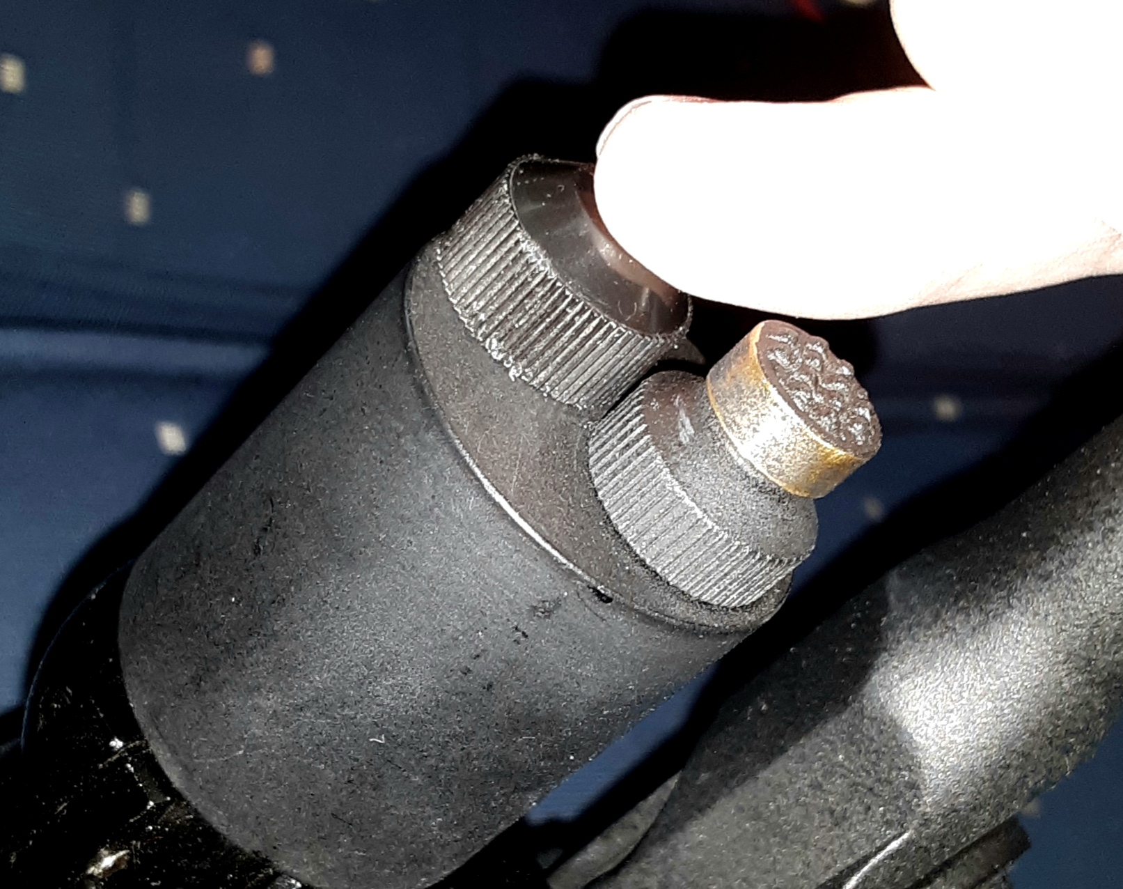

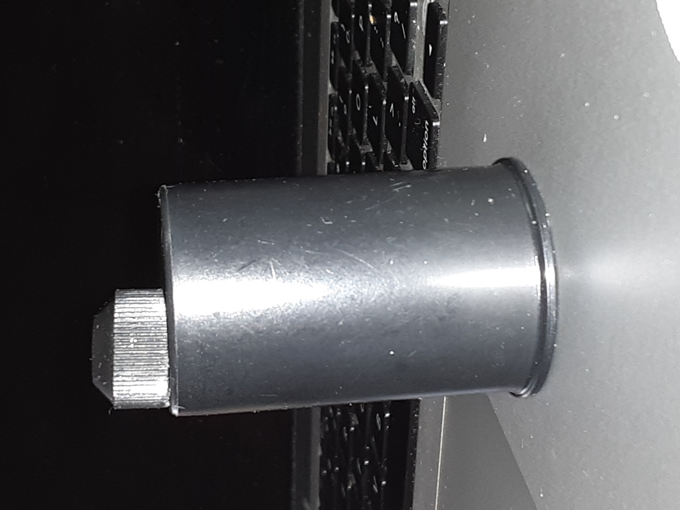

I tackled the front of the scope. I'd already sculpted 3-4 mystery chunks using a triangular file, so I figured this was something I could do. I used a crappy Chinese cutting disc (because of how thin they are) to make guidelines on some of my vintage screws. . They were enough to anchor some triangular files and I made all 5 cuts.
The plastic cap was easy to drill. I was very gentle, doing a 1/16 pilot hole and then a 5/16 (I think) which ended up being just the right size to tap the screw into the cap. That was a mistake but its much more secure.
I estimated the size of the screw face, and then from there, estimated how big the brass bit had to be. I did not have brass stock, so I scrounged up some of my cool old electronic parts. This was a push switch from the 50s (?) , and it had a riveted brass tube on it. The inner diameter of the tube was a little wider than I wanted, but it was the right outer diameter. Sliced some coins with a cut-off wheel, and filed them to level them. I had to use pliers to hold it for countersinking, all my vices are rather deep. I made a couple, so I locked them onto a bolt/nut like a sandwich and spun them in the drill press... hit them with a metal file together, and got the edges beveled too.
I think... I think I nailed this one

These film canisters seem to be just the right size, but theyre missing the manufacturing ring on the bottom. The edges are also a little more round than the props, so VERY close but no direct match.

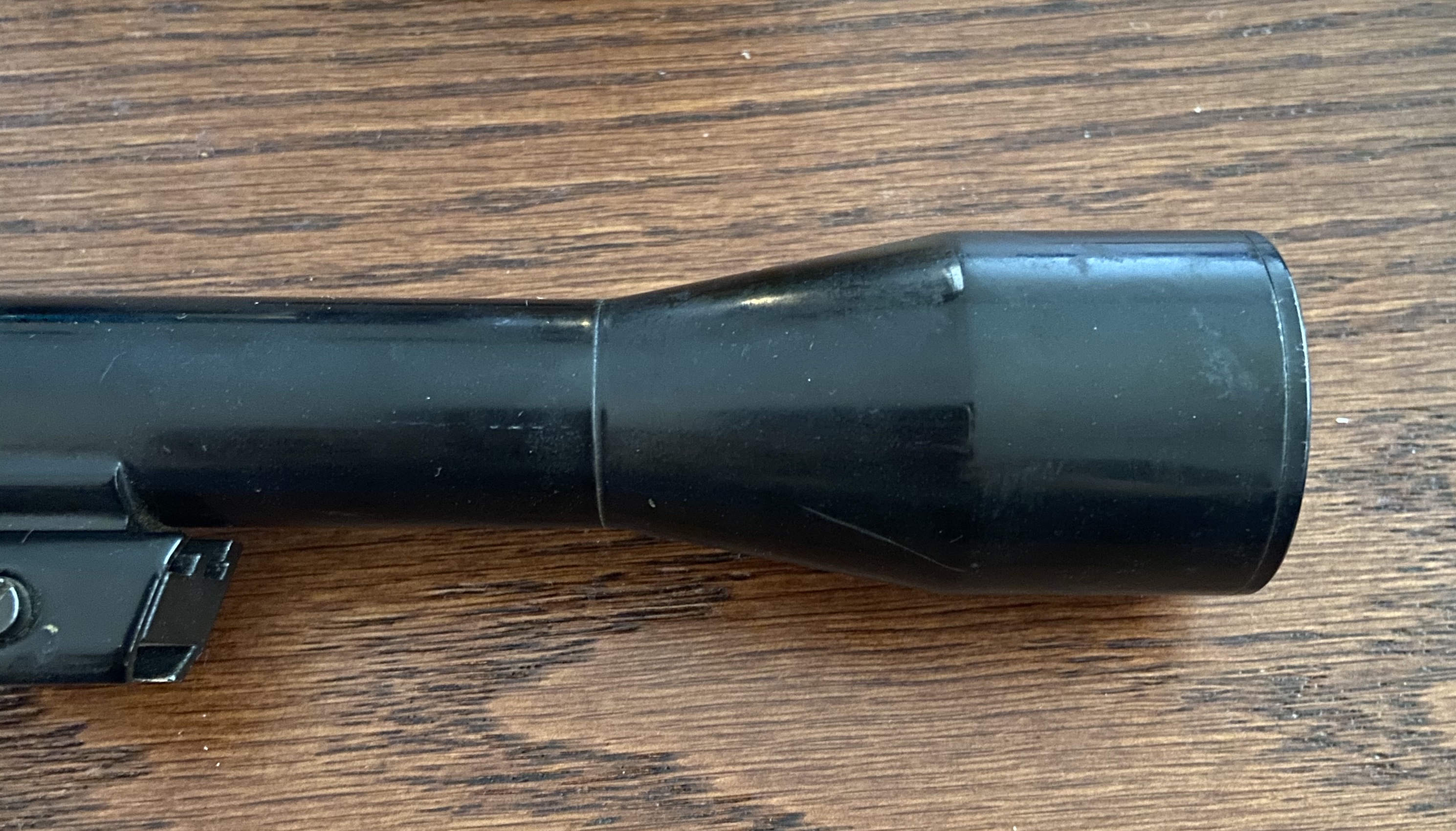

Also found a scope that is not an inch but has the right objective bell, with the retaining ring on the edge. Its listed as a 3/4 scope but the tube is a little thicker. Interestingly enough, the prop is a little larger than 3/4 too!
I mean, they're not exact matches, so I went ahead and used a utility knife to bore a hole. How did I find where to do it?
I used a ruler and accidentally made the exact same lines as on the prop.
And the wall is a little thicker than you'd think, so I ended up tapping the screw into the wall of the canister
Also, this scope has a joint right after the objective bell, just like the prop. However the retaining ring inside is grooved, and I don't remember seeing that. There is a glossy version of this scope that might be different

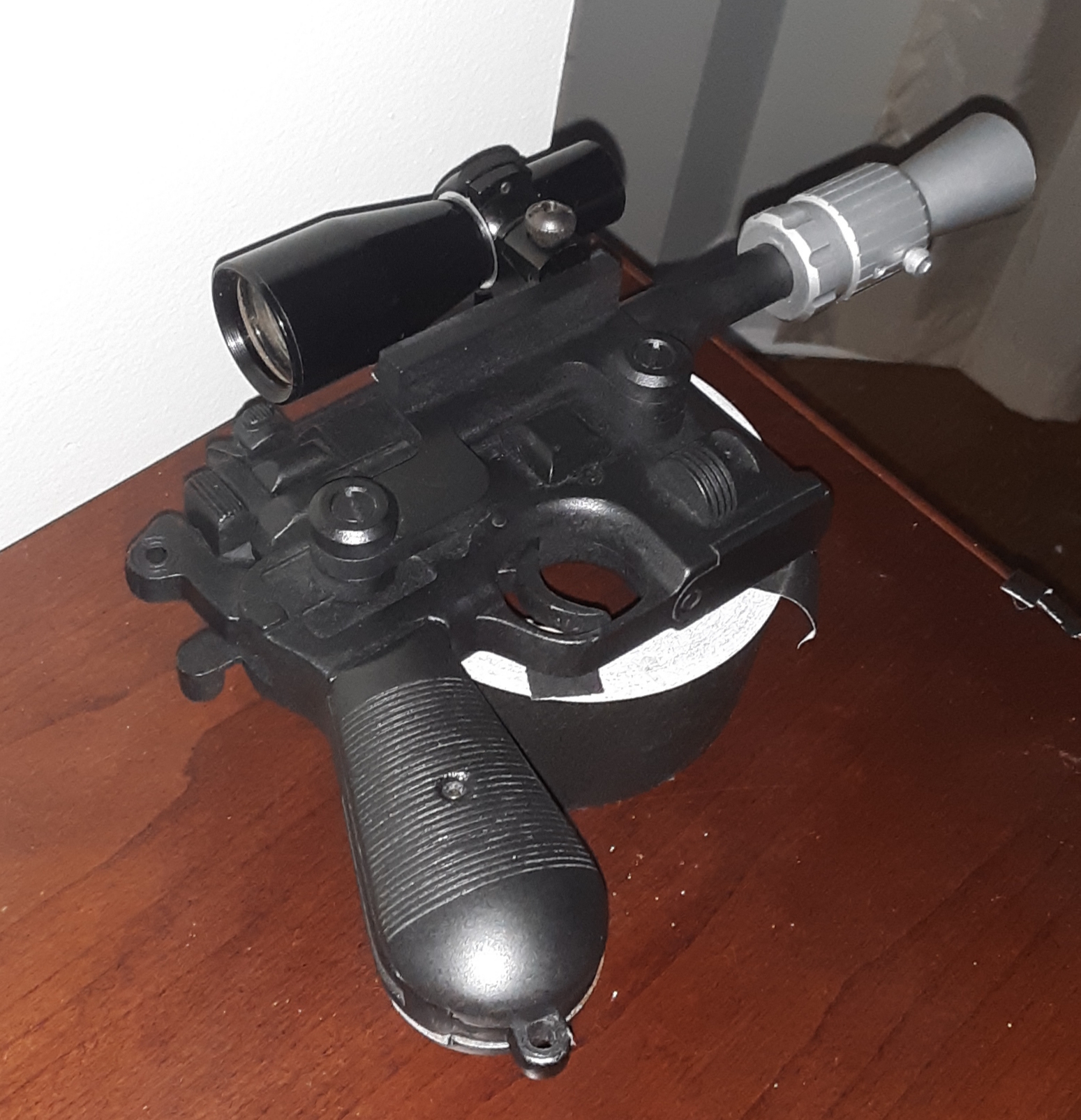

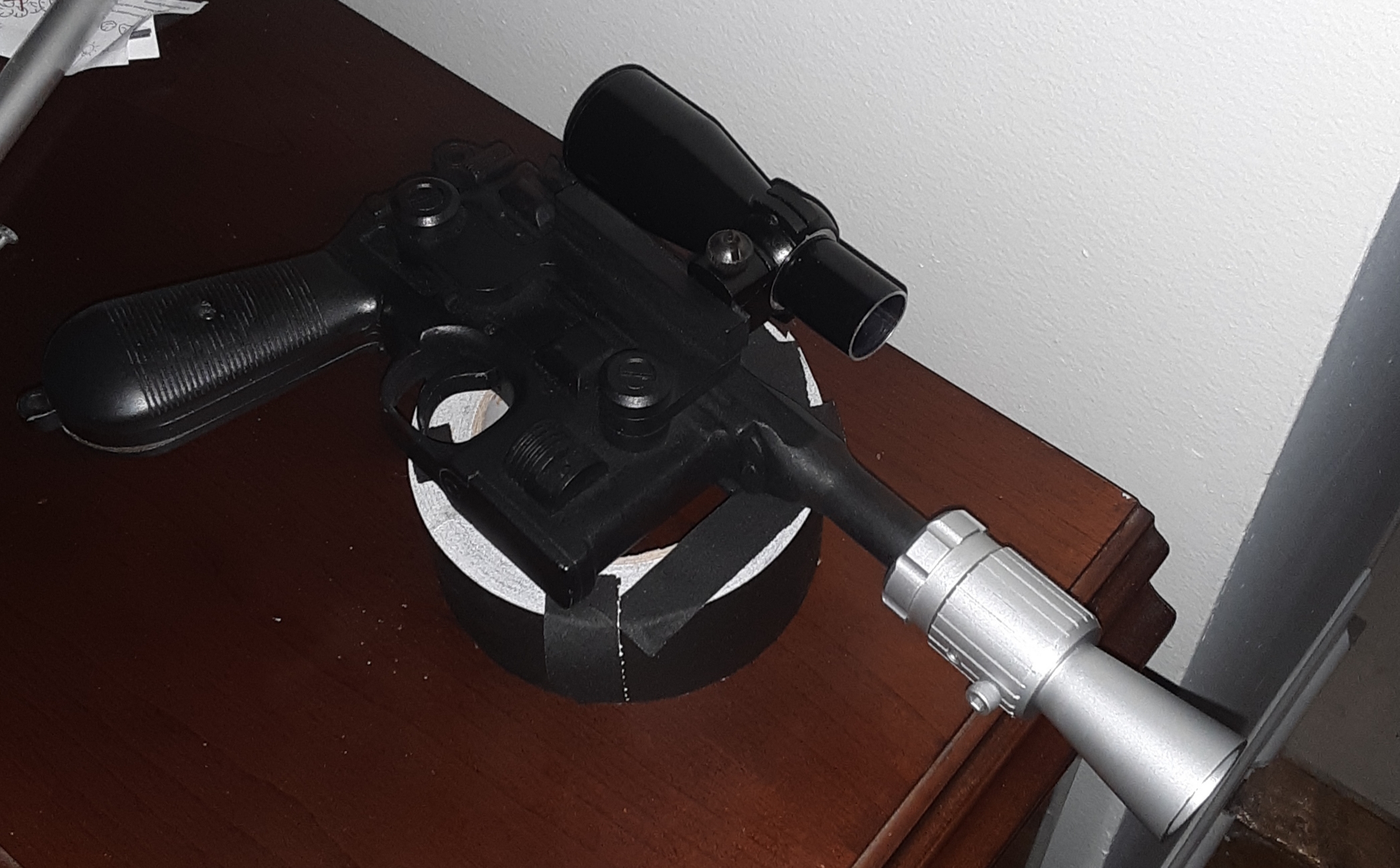

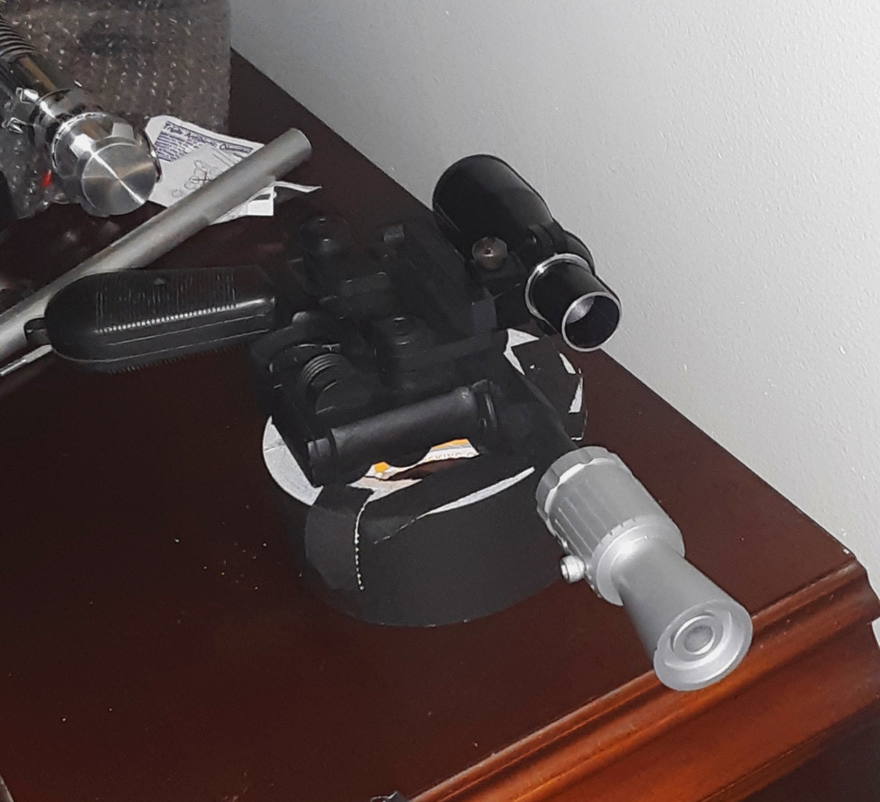

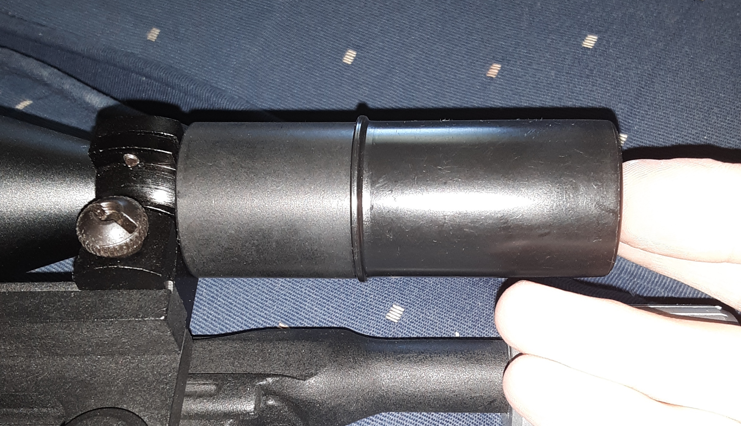

I tested this scope on my existing ROTJ blaster.
(My blaster needs more accurate paint maybe, it is an accurized denix and I learned more about the blaster after I made this)

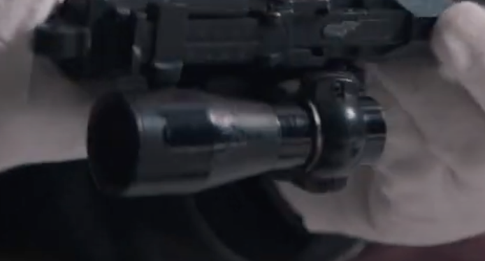

On the latest screenshots I posted, it was clear to me this was a 7/8 scope, which is what I guessed a few years ago.20210524_195815.jpg
I made a spacer thats too perfect, the real prop can slide deeper into the scope ring
Also the front cap (only on the blasters with real scope parts) must have had a washer in the rivet to raise it up to the level of the 1" ring.
