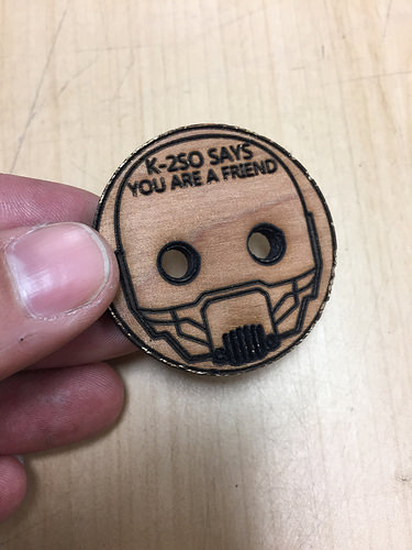

I took my first class as well, Laser 1. Made this little K-2SO coin.

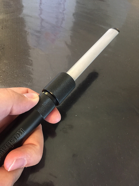

Also per the advice of Evil Ted I picked up a Kershaw sharpener to keep my blades sharp.

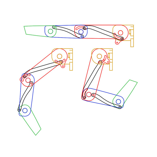

Doing vector work on the new linkage based hands. The best part of this is the pull line will have to move only around a centimeter to make the whole finger curl.
These will be cut out of mdf layers with the laser and fashioned together with Chicago screws. I need to make a prototype before finishing the other 4 fingers.

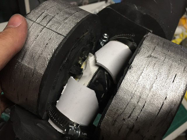

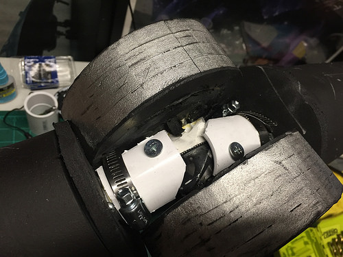

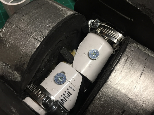

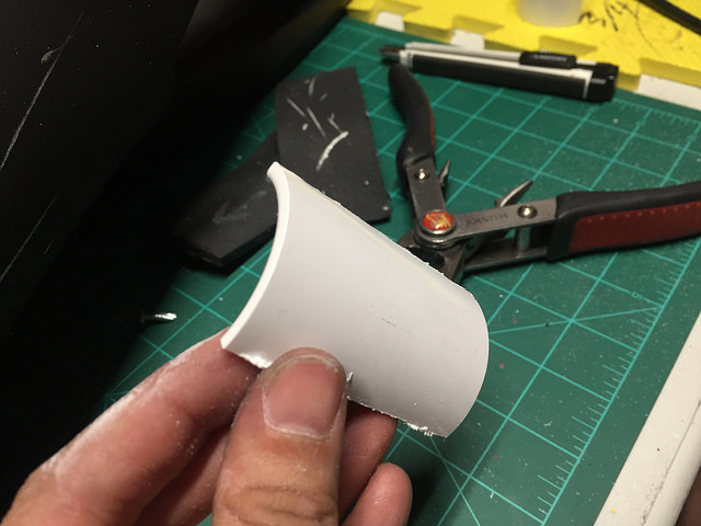

Another Home Depot run, this time for a 1-1/2" coupler for the improved knee joint.
First I carefully removed the outer two plates and any extra foam inside the knee.
Then I shaped down the coupler to about a third of the fitting, notching one of the corners.
These were held in place by two pipe clamps.
And secured with a wide head screw to keep them from accidentally overlapping.
Now the knees don't over extend they also will allow K2 to take his own weight while I am standing.
I glued the outer two plates back on the knees with super glue and put K-2SO on his new rolling cart. This will let me get him from my car to the changing space in one trip at future events. Still need to figure out a way to attach his stand without zip ties so it breaks down fully.

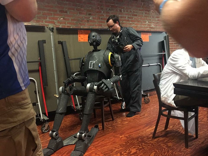

I did my first test walk after moving the harness around and with the new knee stops. He's walking great. The knee stops actually add some friction to those joints which helps his gait. Just a little touch of black on the harness is needed before Sunday. The rest of the K-2.0 upgrades will take place after the photo shoot.
He sits on his cart perfectly. This will really help in moving him around the photo shoot and at cons.

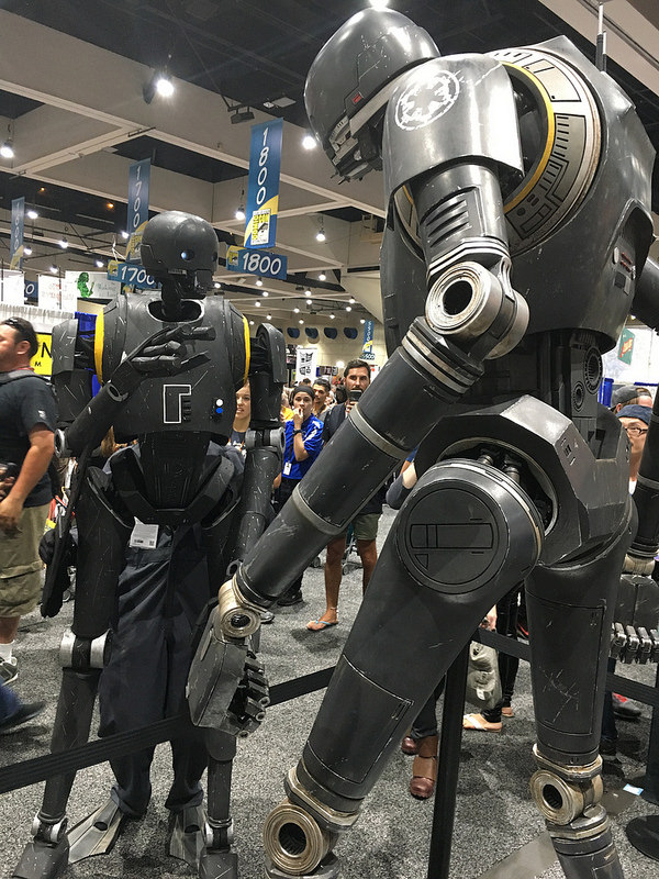

K-2SO made it down to San Diego Comic Con (SDCC) to see the K-2SO 1:1 statue by Sideshow! This was an impromptu trip but a lot of fun.
I made our way to my first stop, the Sideshow Collections booth. I had only 2 things on my list for the day and seeing the 1:1 scale K-2SO model was one of them. A man with a video camera seemed to be interviewing in front of the statue and was very surprised to see ANOTHER K-2SO standing behind him. I got some great shots with the model and pictures with some of the Sideshow booth staff.
This is my favorite picture of the two of them. Though it makes me a little sad. It looks like K2 is viewing a memorial made out to the members of Rogue One.

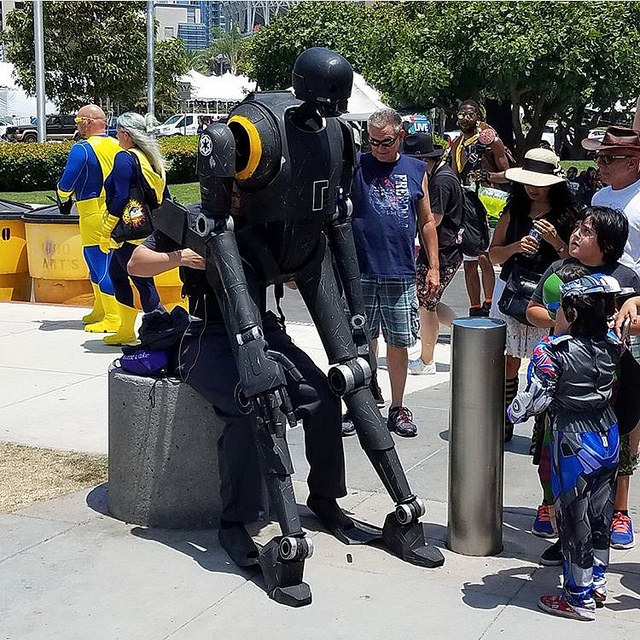

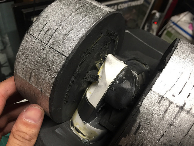

Major malfunction! After about 20 feet I felt a pop and the top connection bolt that held K2 to my chest harness broke. He started to pitch forward and I sat myself down on a short barricade pillar to conduct some emergency repairs. I couldn't remove K2 on my own so I shimmied out of the top of my gray coveralls and lengthened the straps of my harness to make a cross connection over the connection pipe, strapping it together for the time being. K2 made it inside but the modifications were extremely tight on my chest and I was sweating buckets from the humidity and exertion. I found a 501st Legion friend who helped me secure a chair to sit in for a moments rest and procured a handful of zip-ties from a nearby booth for more permanent repairs.
Joined several of my R2 and BB-8 builder friends for dinner a few blocks from the con. Taking K2 off after 8 hours felt amazing. He weathered the trip well.
I received many positive comments on K2 and the puppeteering behind him. Everyone seemed to get a kick out of the camera/monitor setup I had to see in front of me. I even had someone who worked on Rogue One tell me she loved the puppet and was going to share my picture with one of the editors.
K-2SO is a great character and everyone loved seeing him walking around the booth alleys. Though i'll need to put some shop time in fixing his harness system he performed very well under intense con conditions. Though it was quite a workout wearing him for almost 8 hours. I can't wait to complete his neck servo and hand upgrades for future events and conventions. Thank you San Diego, we had a blast!

Not planning on doing a whole lotta foam work in the near future, but this has convinced me that I need one for my band saw. Time to start digging through the internet. Thanks Darren!
