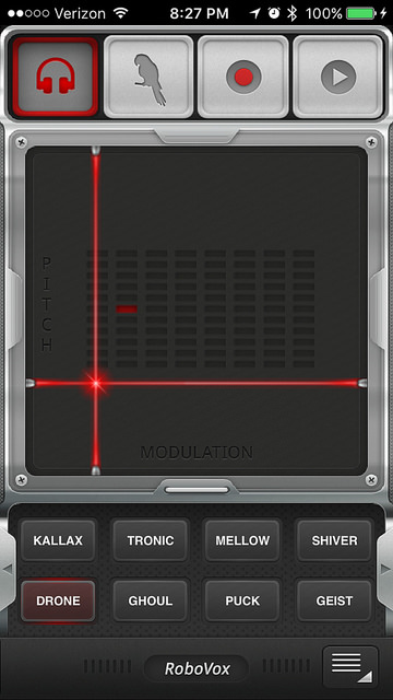

My over the ear mic goes through the input and the output passthrough ends up in the aker.
Setup 3 different voice options for K2. Will try them out once I start full puppet testing.

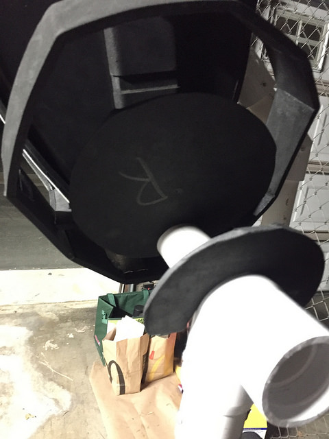

More work on the pelvis tonight. I traced the outer and inner plates before putting the V frame on the pipe. This part of K2 will need to be built on him instead of built then added at the end.
More of a sculpting type of piece.

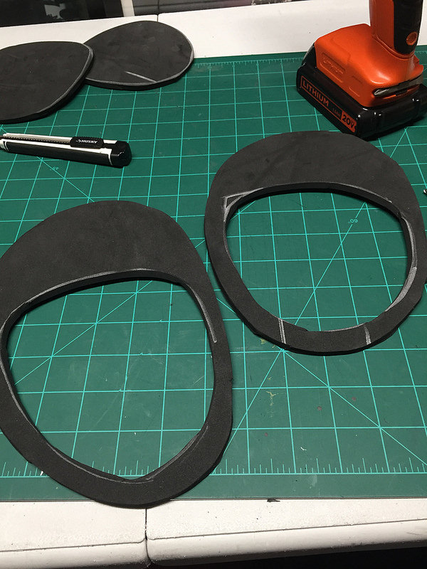

The side rings are too small and don't go up enough towards his upper torso. Cut a seam to add more material.
Making these rings about 10" wide.

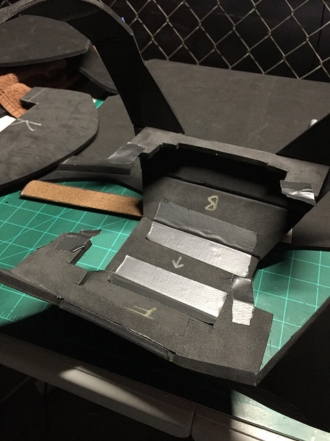

Added some notched pieces to support the pelvis on the front and the back.
Mocked up the shorts attachment rings.
Ready to cut the shorts attachment rings.

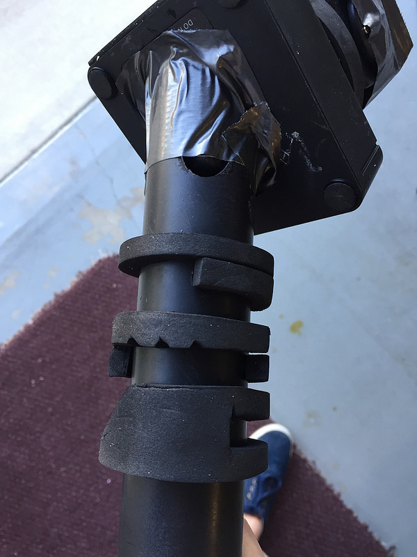

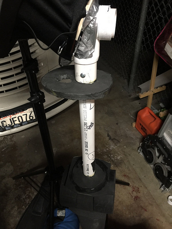

This uses the same technique as the shoulder sleeves. The large ring and the narrow small ring are permanently attached to the shorts fabric. They join to the fatter small ring to hide the hip PVC pipe once the legs are attached.
The pieces fit snugly to the pipe and slip ring.

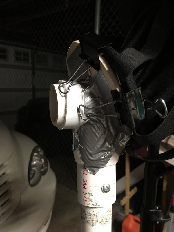

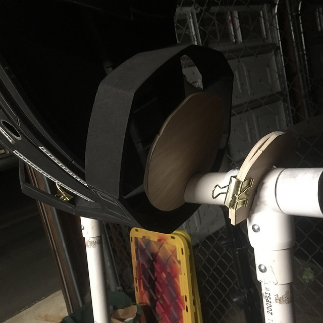

Binder clips will be used again. Accessed through the removable 5" disc on the outside of the upper legs.
Getting the dimensions down. The upper leg will be supported by 3 foam discs inside it.

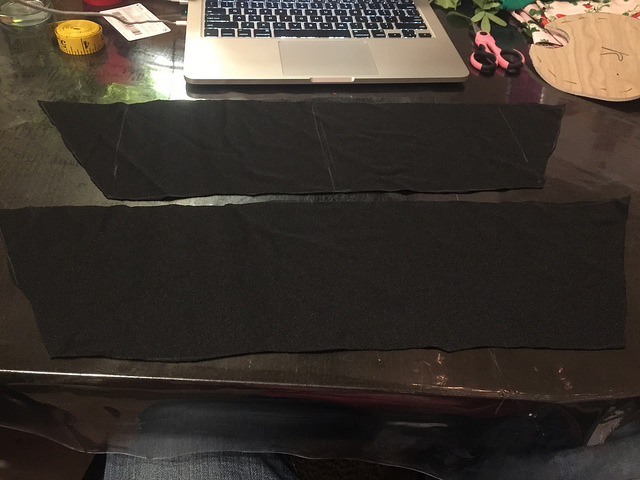

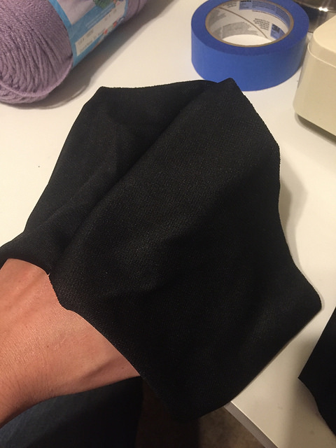

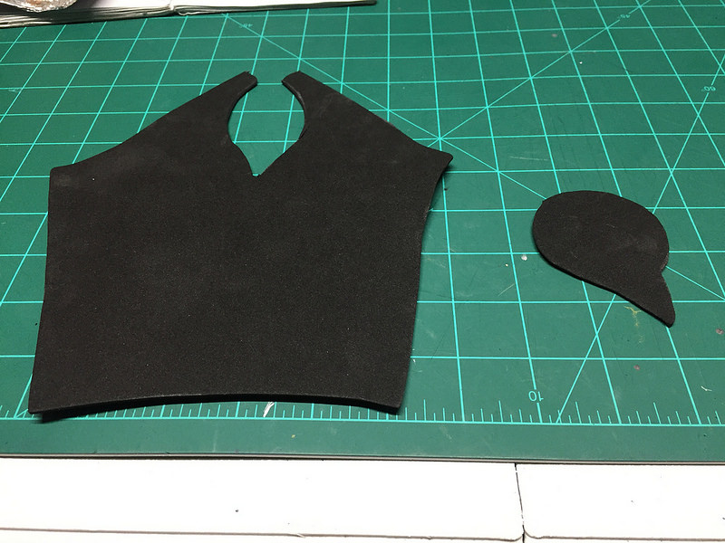

Cutting the shorts fabric.
Sewing the edge seam then turning inside out.
Sturdy.

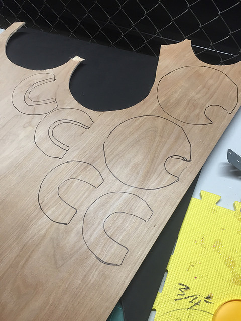

Stapled the shorts cloth to the inner wooden disk. Again using the same technique used in the shoulder sleeves.
Then stapled the narrow end of the the shorts cloth to the thin horseshoe.
Makes a nice little cone.

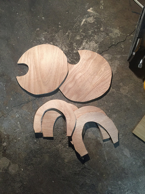

Glued and taped the thick horseshoe to the top of the hip slip ring. This surface will be clamped with binder clips to the shorts cloth.
Notched the side foam to fit the wooden large disc. Also glued down the front and back foam connections.
Added some spacers on the bottom glued between the foam and the PVC skeleton. This will help the pelvis keep shape and not shift around.

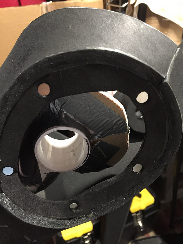

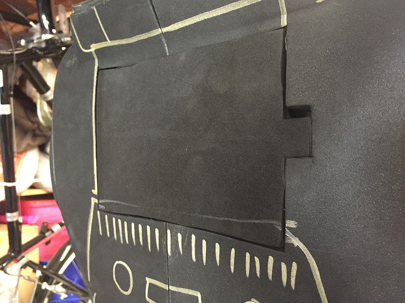

Remade the front panel. I've never been happy with the 2mm gap around the edges. Just needed to increase the size slightly. Cut off the original and traced around it. The pen width was about the increase I needed.
Glued up for the new front panel.
Old on the left, new on the right. I almost forgot to add the heat seared lines on the front before gluing it in.
I really like how the edges of the front panel turned out. I'll still add a little bit of filler but It's much smoother.

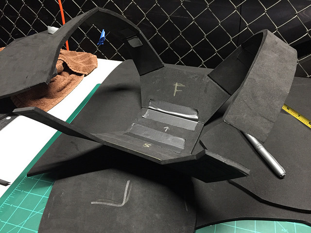

More pelvis work tonight.
What? 2 posts in the same night! I must be cranking.

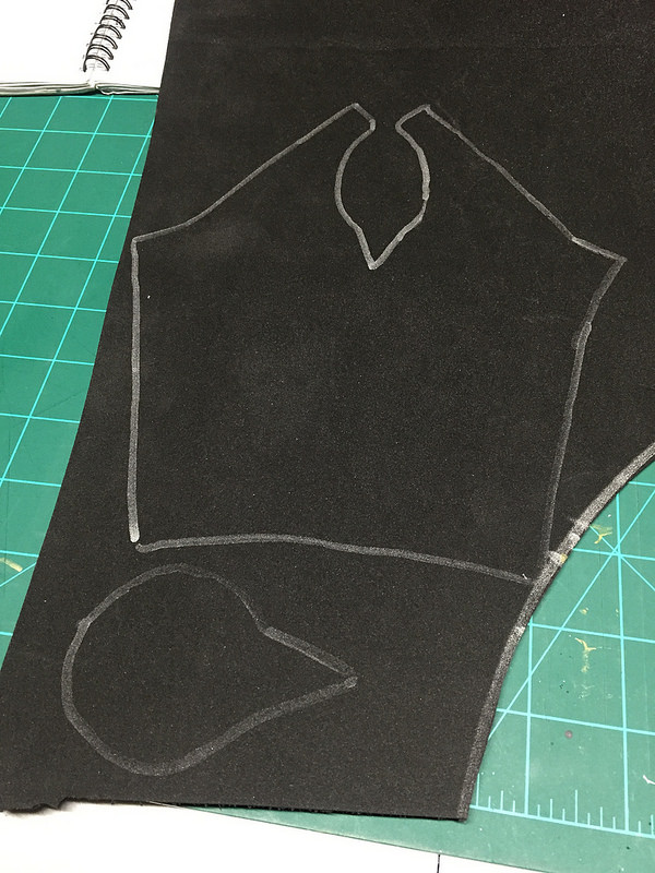

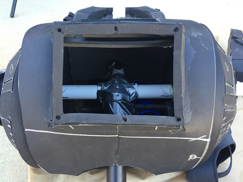

Templated out the inner pelvis pieces off of 2mm foam then transferred that to 6mm foam.
The insert fits around the center spine.
I decided to put the inner plate on the inside of the wing to keep the thickness down.
All glued in.
I'll touch up the seams a little but the removable front plate still fits in without pinching anything.
Reused that 2mm foam to template the outer plate.

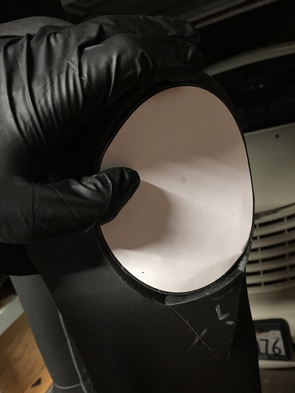

Cut out circle to funnel the shorts cloth. Similar to how the shoulders were funneled.
Glued and taped in the large wooden disc.
Glue primed on the outer plates. Made the funnel hole bigger to let as much of the fabric stretch as possible.

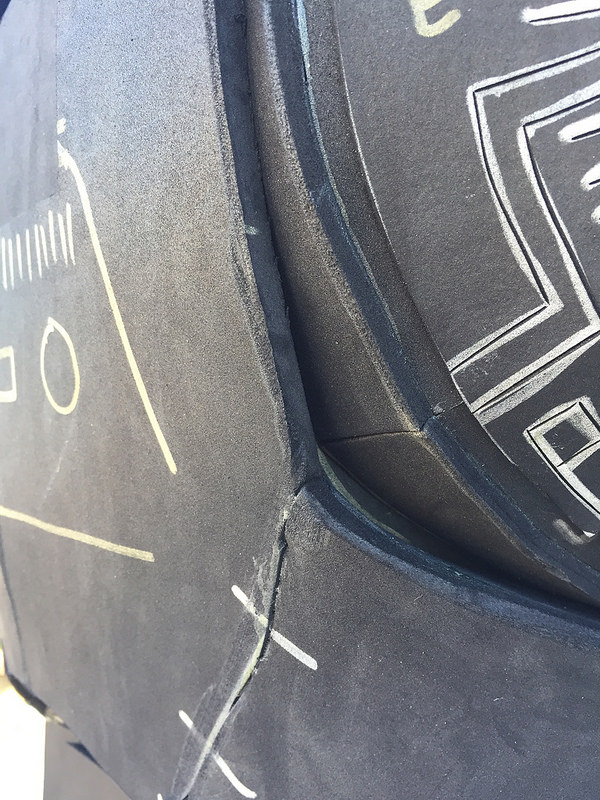

Moment of truth, sealing up the sides.
The outer plate goes on the outside edge of the pelvis wing. It lined up great and looks very smooth.
The small disc is clamped to the leg slip ring and the shorts fabric ring can stretch and twist as the leg moves.

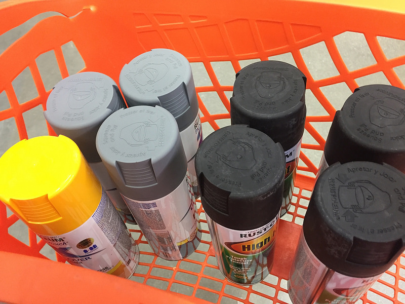

Another busy week. Picked up several cans of primer and paint and the yellow for the accent rings around the shoulders and hips.

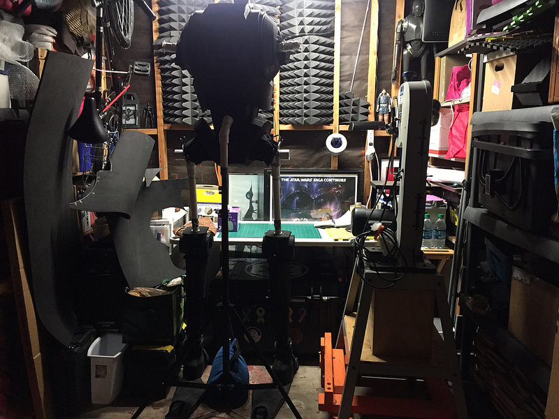

New garage setup. Purged the garage and moved against the back wall. Now my patient lovely and understanding wife can park her car in the garage. First time in 2 months.

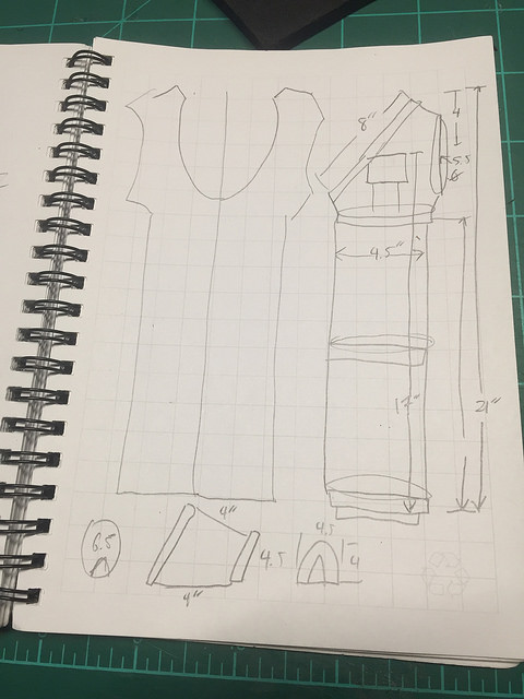

Time to finish the upper legs. This curve is just beyond my brain to turn inside out and flatten. Time to make a template. Sorry 31" big fig you're loosing your right leg.

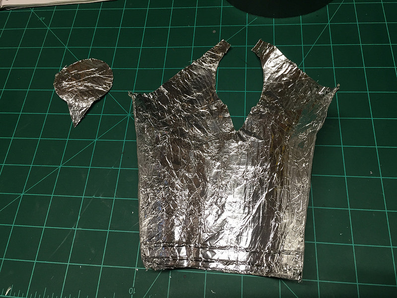

Opened up to remove the upper portion of the leg.
First cover in foil so the tape doesn't stick.
Then cover in tape and cut along seams.
Kept it only 2 pieces. Had to make a small notch below the outer circle so it all fits.
Decided to make a small scale test out of 2mm foam.
All cut out.
Turned out great, onward to full size.
I've seen this method used a lot by other builders but never used it until today.

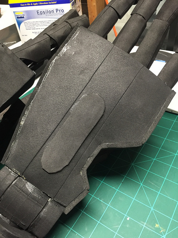

Finally finishing the detail oval on the back of the hands.
I'm always making 2 of everything on this build.
Detail in place.

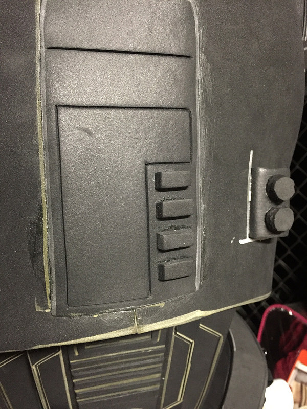

Also made the coin slot buttons for the front chest panel.
These look great. Another Star Wars part that we see on Vader's chest box and R2-D2's front.

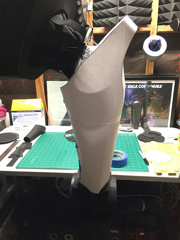

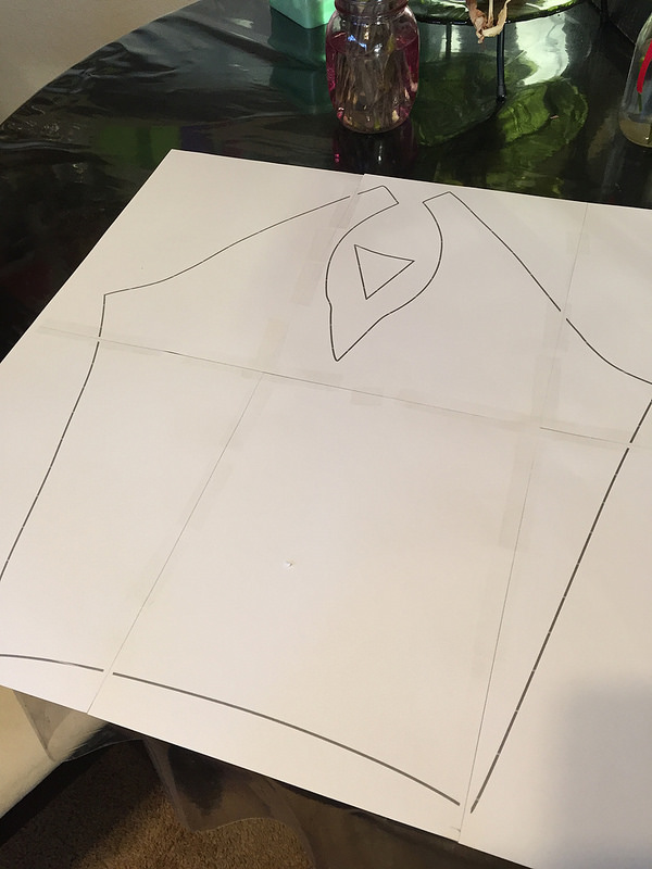

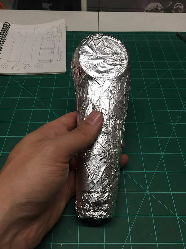

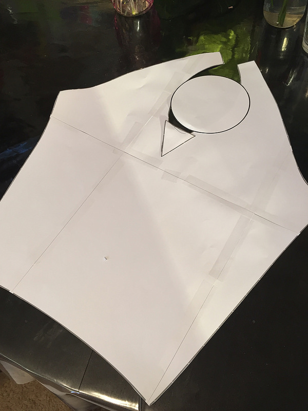

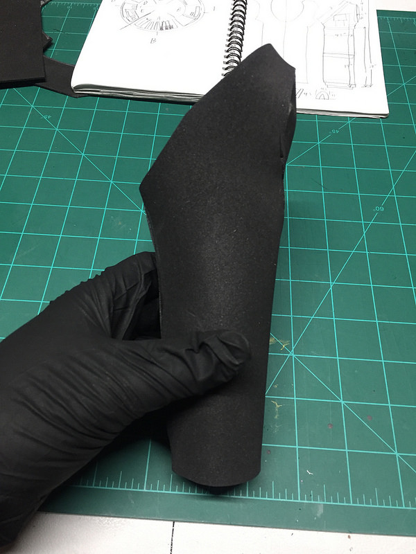

Scanned the template for the leg.
Upscaled to 21" high.
Printed out at full size over 6 sheets of paper.
Ready to transfer to foam.
But first a paper test. I'll need to use the inner support rings to have it hug the inside of the leg, and need to add 2" to the bottom but it looks good.
My Poly Latex 60 arrived for sealing all of this foam.

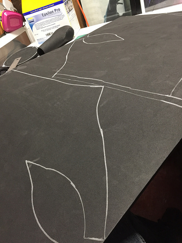

Marked up the two templates for the legs.
Added a little to the outer edge you can see here.
Determining how best to mount this.

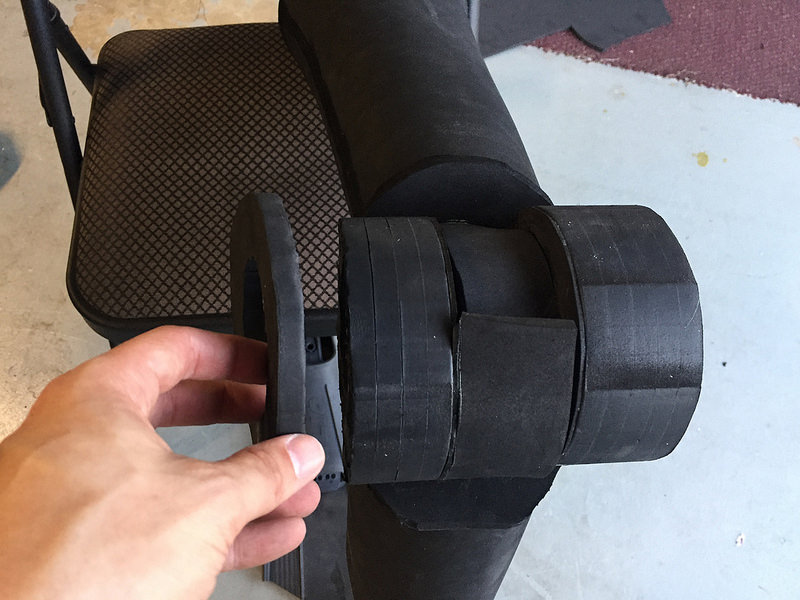

Made a custom support disc at the bottom of the leg (at the knee) and just below the side notch.
These will support the leg and keep it in place. I ended up moving the top placement hole, but why use more foam when the old one will be hidden.

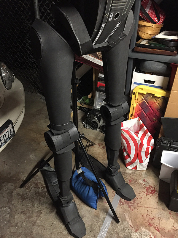

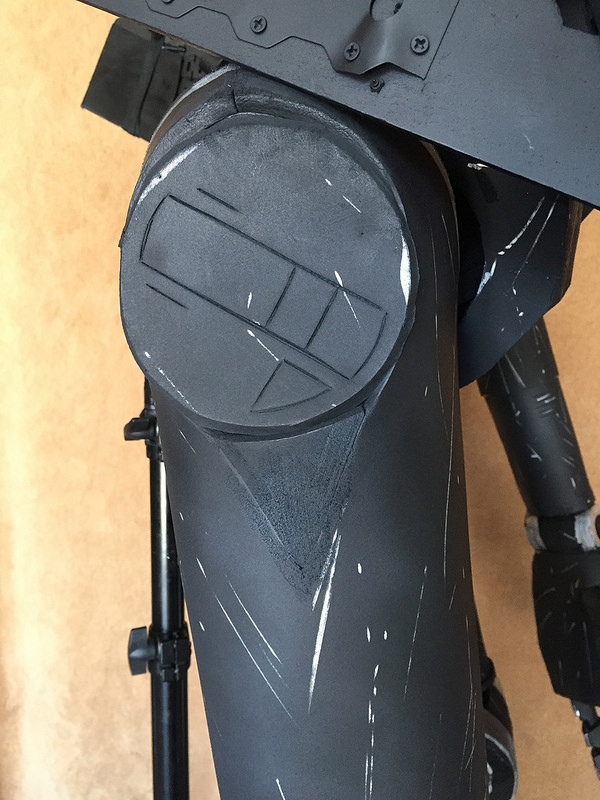

He's got a full leg!
Worked hard to make sure this placed where I wanted it so when K2 takes a step there is enough clearance for the leg to swing.
2 legs!
Cutting down some old circles of foam to make the cover caps.
Checking the circle size.
Readying some magnets, marking the polarity.
Counter sunk 5 magnets into the legs. This way the cover cap has an Up.
Matched up the magnets.
This access cap lets me reach in to secure the shorts cloth and attach the hip ring to keep the slip ring on.
Looks pretty good.
Cutting some foam to cap the top of the legs.
Leaving a lot of room for the shorts skirt.
Great set of legs.

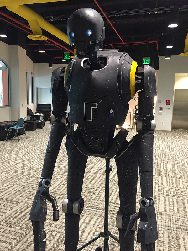

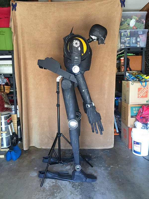

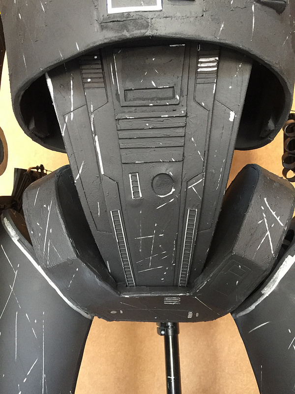

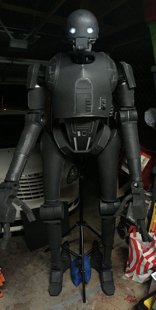

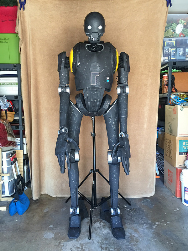

K-2SO, fully assembled the main components. Boy how far we've come.
Speaking of that, he was just a PVC skeleton in January. Sometimes you have to see past your current step to what will be.

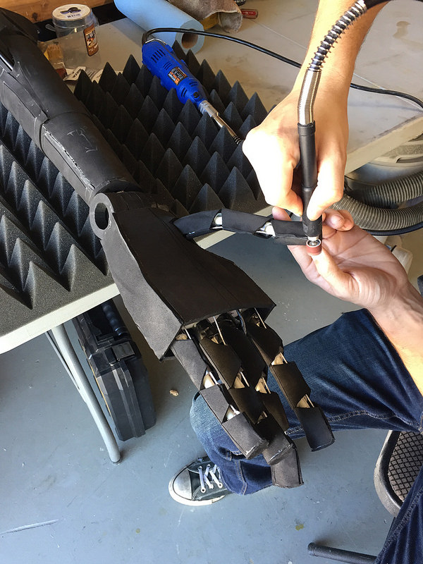

Had some help for the first time working on K2 parts. Dremeled the edges off most pieces. The fingers look much better now.

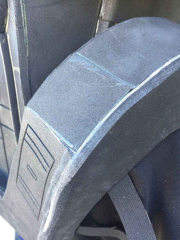

Added Kwik seal into many of the seams. Used @chinbeard video as my tutorial.

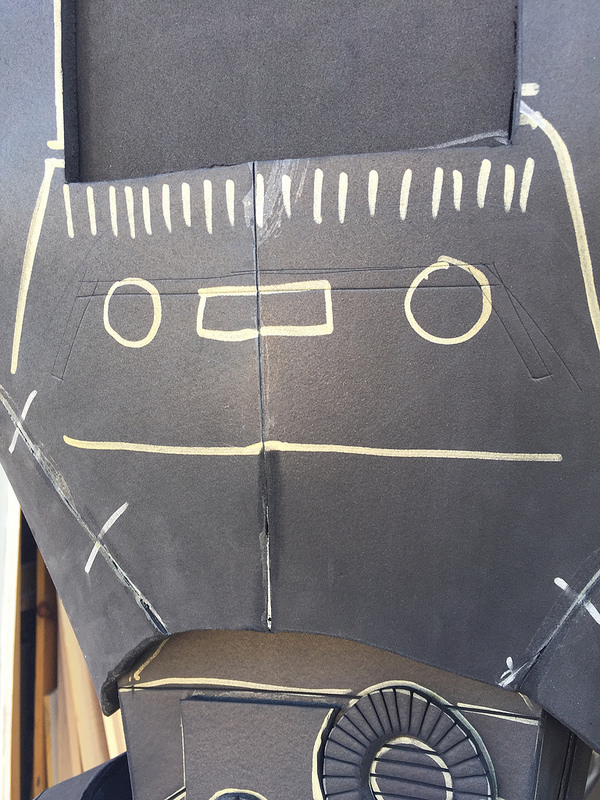

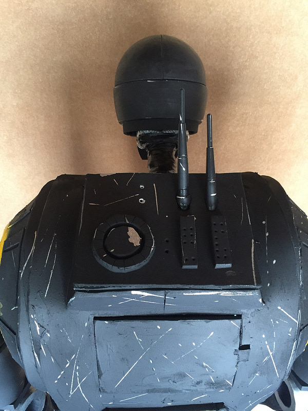

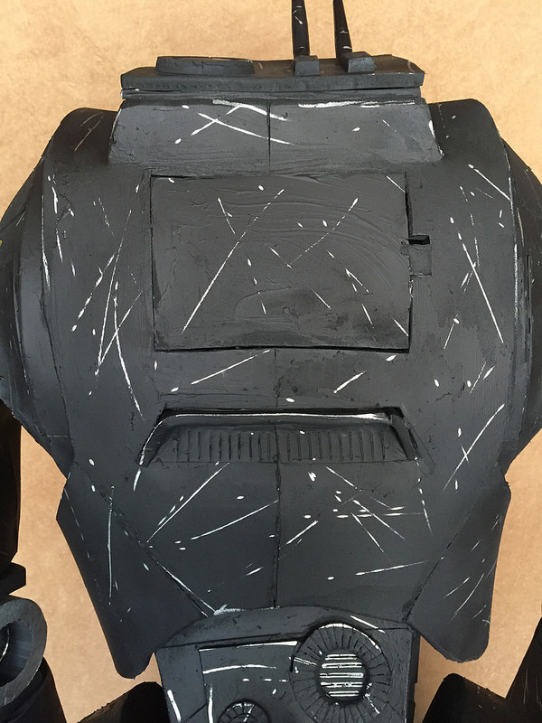

Adding this arch detail in the back.
Cut out a nice notch.
Taped in a piece of 8mm foam and heat scored the detail.

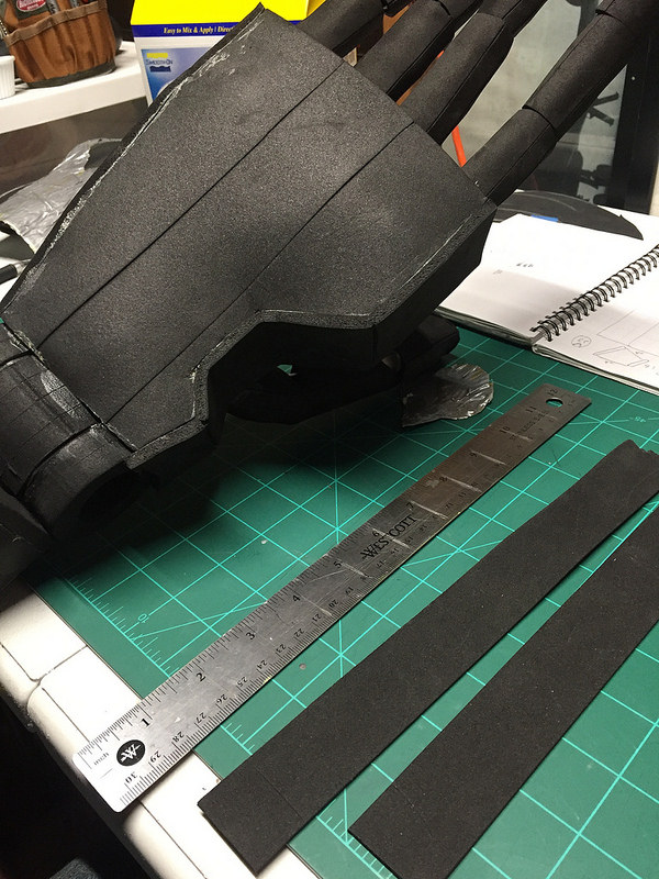

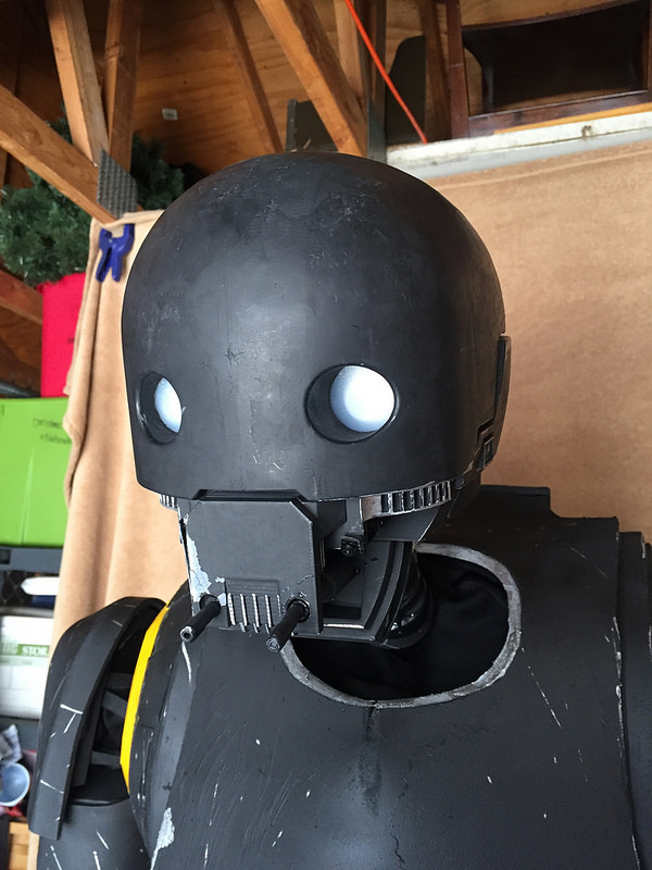

Prepping thin strips of foam for the neck detail.
These are glued on in no particular pattern but reflect what is on his neck.
I really like this little detail. But need to make some sort of cover for the bottom of the pan/tilt unit. At least before the neck servos are installed for head 2.0.

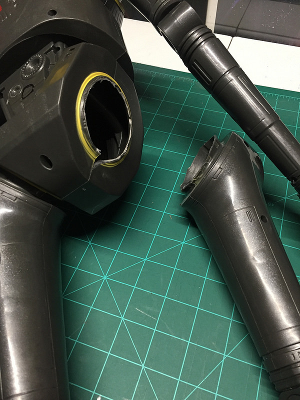

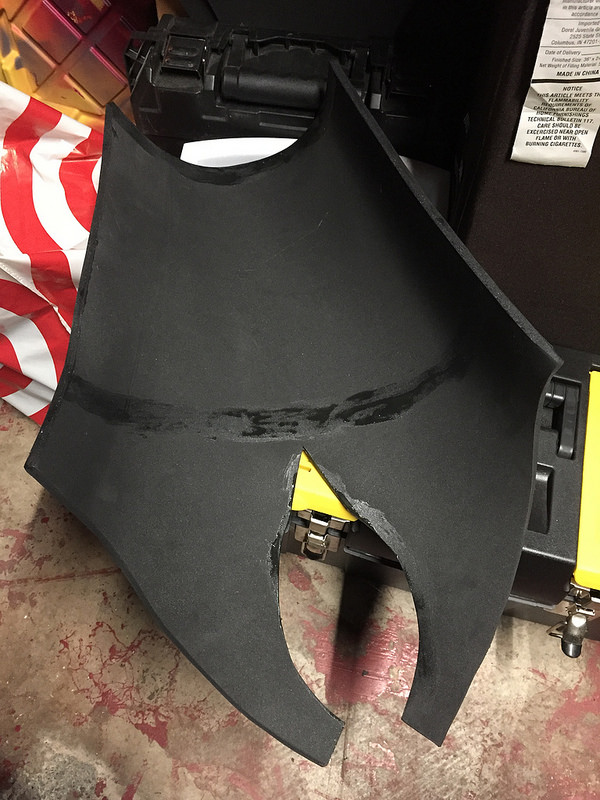

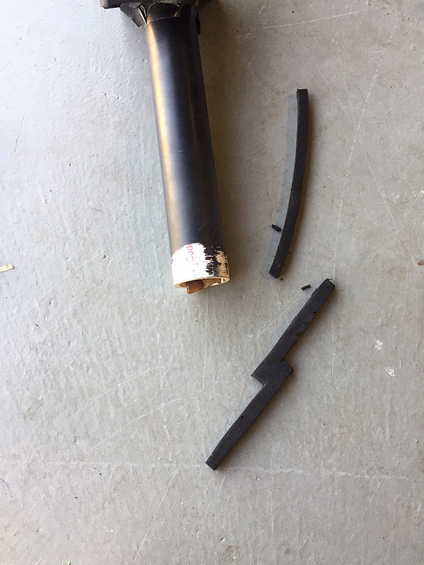

Also bit the bullet and trimmed off 1/5th of the knee joint puck. It split right along the glue line. This helps reduce the 3PO knee feel these have. I'll remove the other outer layers from both knees.

Looks f'n amazing!! I love the template making technique you used! Never thought of that! Great job so far and I can't wait to see more!

I finished taking the outer layers of 10mm foam off the knees. Now they look much more balance and less like C-3PO knees.

I did a single coat of Poly Latex 60 on the shoulder bells as a test. Spread on with first a chip brush then a sponge brush to remove the brush strokes.
So my small test worked fine so time for the rest right? Wrong. The Poly Latex 60 started curing too fast as I painted it on. It was almost like spreading suntan lotion.
It looks like a mess. Fortunately it's not permanent.
Though it dries clear it does have a lot of texture so I've started to peel it all off the torso. Fortunately I didn't go any further than that.

Did the detail lines on the leg hip covers.
Added a little disc of foam at the top of the arms to help hide more of the PVC.

A light coat of primer. I took my time making sure the paint didn't pool.
Went through 5 cans of primer.

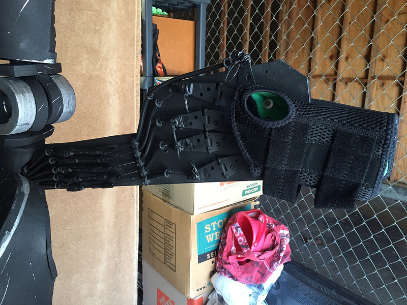

Finished wiring up the right hand fingers. Made the rest of the wire loops and reconnected the nylon line.

Ab plate.

I decided to pull apart his left knee and replace the stopping screws.
New screw in place to keep the knee locked.

Strike mark weathering on the torso.

I finished K-2SO at 3:30am the night before. Got 3 hours of sleep then packed him in the car and rolled out.
He's DONE! I packed up K-2SO after a few hours sleep and took him to the Star Wars Reads event in Rancho Cucamonga, California. It's our largest 501st event in the Inland Empire and so much fun. Enjoy the pictures!
Creator standing with creation. All assembled on the staging floor.
He's looking great.
Explaining his pieces to the gathered costumers.
Wearing my Imperial Officers uniform behind K2 at the Death Star Wall photo booth.
Another black and shiny friend.
K2 likes shadow scouts.
General Grievous makes for a good bookend.
C-3PO and K-2SO, but who's taller!
Searching for the Scarrif base.
Beautiful shot walking around.
Replacing C-3PO ;)
Posing with my wonderful family who has lived with K2 these past year.
General Grievous, my friend Jeremy https://www.instagram.com/stormtrooperbusiness/ So glad I got to see his costume in person finally. We need to hit up a con together.
Getting ready for the character parade, about 5 minutes before the neck failed and his head fell 7' 2" onto asphalt. Survived though!
Very popular at the Death Star wall.
One of my favorite pics of the day.
Photoshopped K2 into the U-Wing interior. He fits.

Upper back panel
Right puppet hand plate. This one is strapped to my hand for better control.
Left puppet hand plate. This one I can slip in and out of so I still have a free hand when needed.

Re: ROGUE ONE K-2SO Puppet Build - Finished (Pictures)
Congratulations on a fantastic build !
Great problem solving, documentation and photography. Such a fun build to see come to life !
