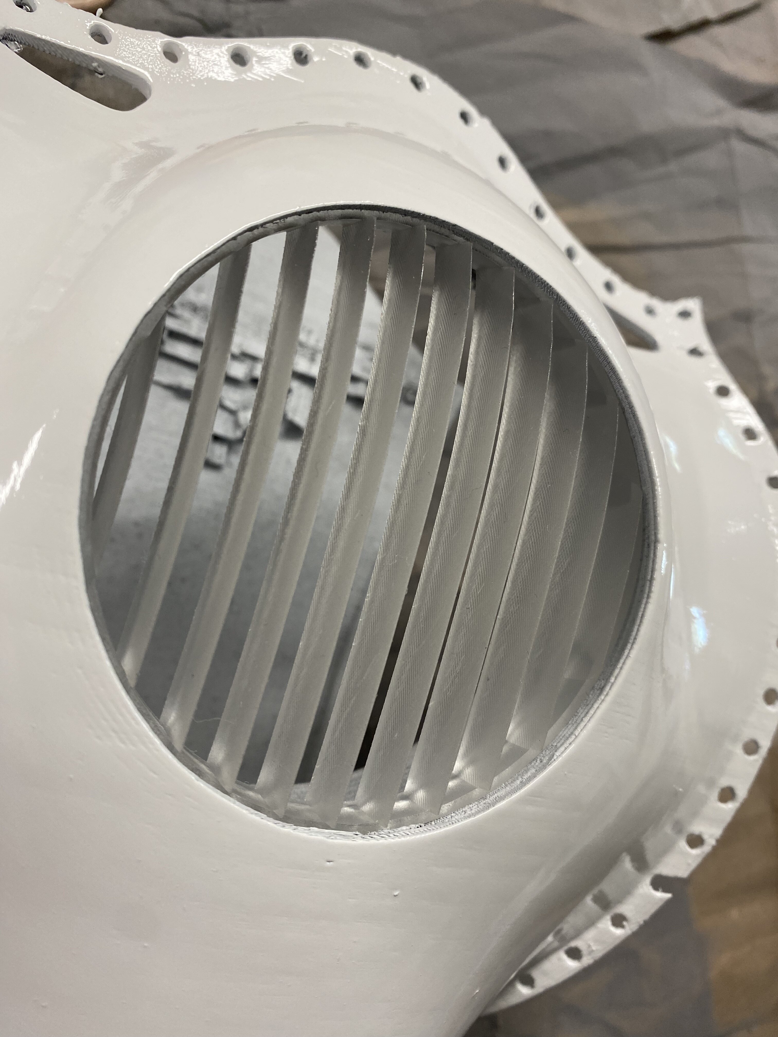

Hey all, I'm back to work on my Veepy, but I'm approaching the painting a little different than what I'm seeing in this thread. It seems that most of you are assembling before painting...I've been approaching mine by sanding, filling, and painting each piece prior to any assembly. Other than the risk of scratching the finish, does it really matter?
I ask because I'm concerned I might be missing something important.
Thanks!
Thanks!
I took the same approach as you. I took extra care when assembling not to ruin the finish. Then added at the end the rivets.

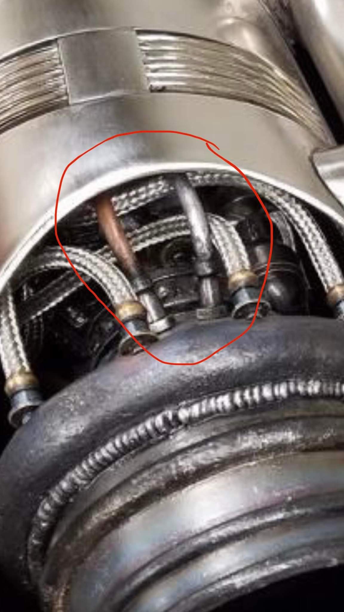

Quick question; the copper pipe doesn’t come bent in the shape I need so it’s gotta be fabricated somehow or do I have to use a different material and make it look like copper?
Which question; the copper pipe doesn’t come bent in the shape I need so it’s gotta be fabricated somehow or do I have to use a different material and make it look like copper?
If you want a good smooth bend on copper tube use this trick: put soapy water in the tube by blocking the ends with a rubber plug or hot glue from a glue-gun. Freeze for 24 hours; remove from the freezer and bend it right away. Thaw and remove water + plugs;)
