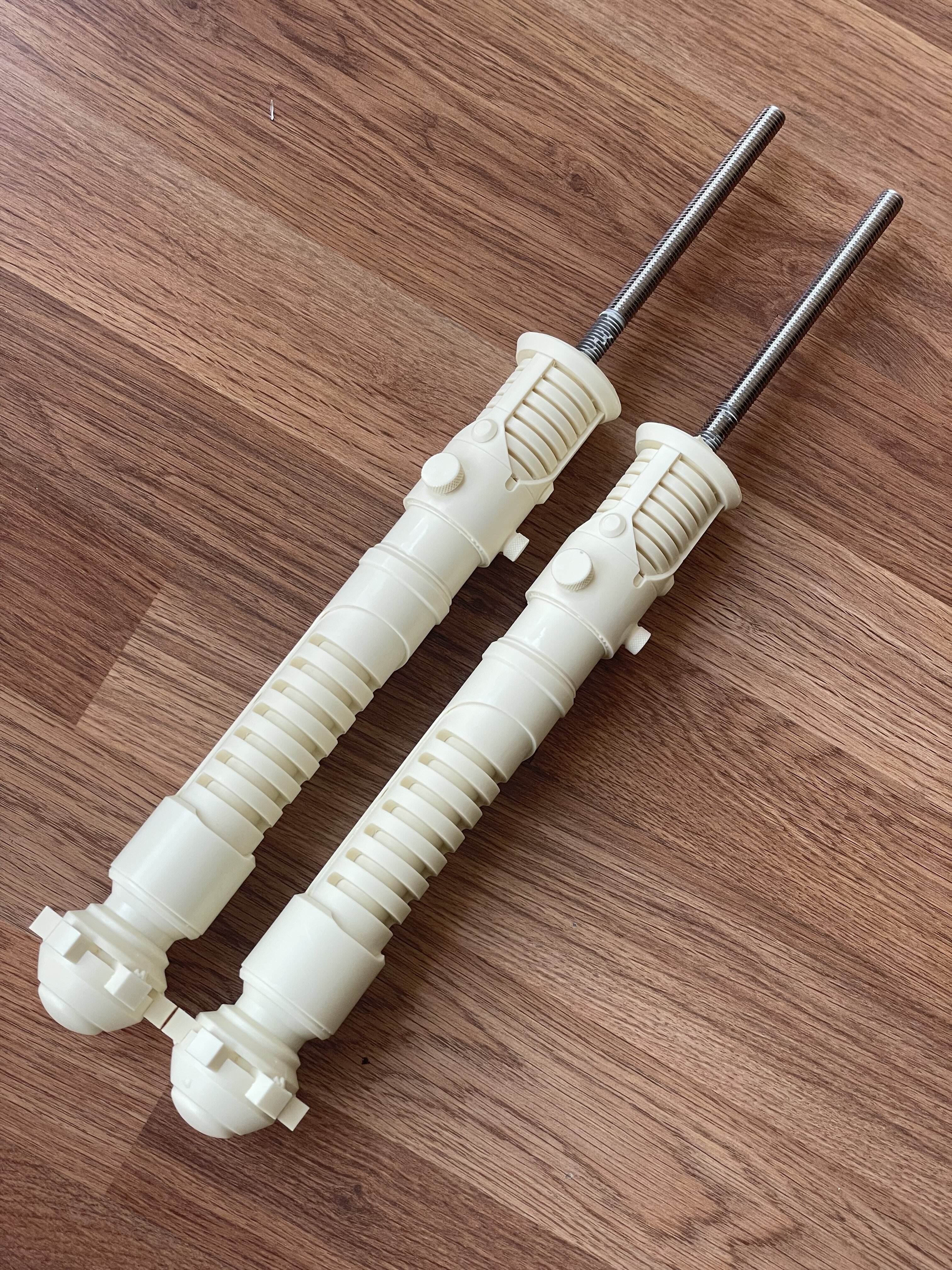

How long will the threaded rods be, and how far will they protrude from the emitter?
I'm no expert, so please forgive me, but I feel like I remember the originals having a longer protrusion....

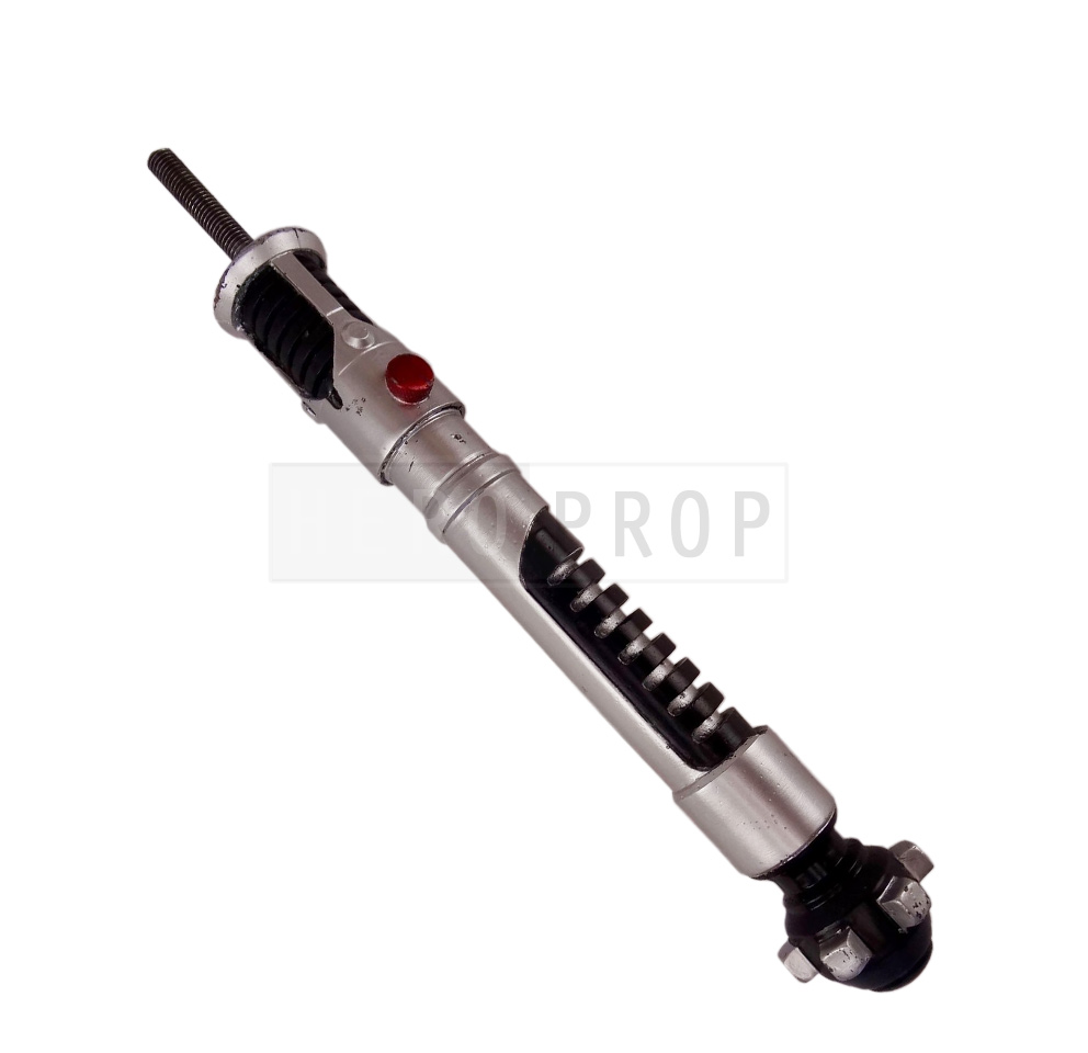

It varied greatly. Some were only 1-2 inches, some were quite a bit longer. I am somewhat limited by the height of my pressure pot, but can make it protrude more upon request.

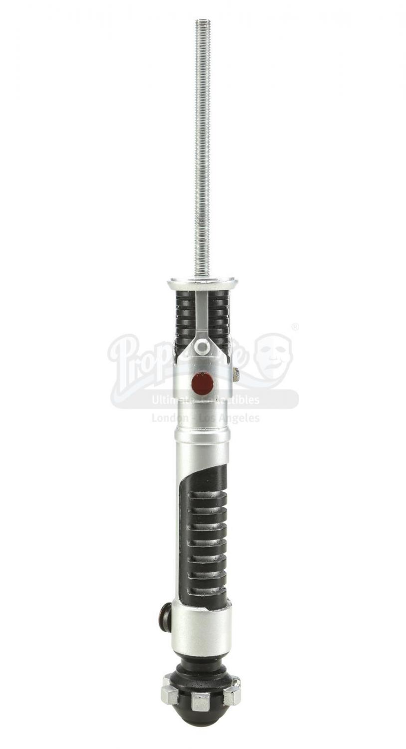

Shorter:
Longer:

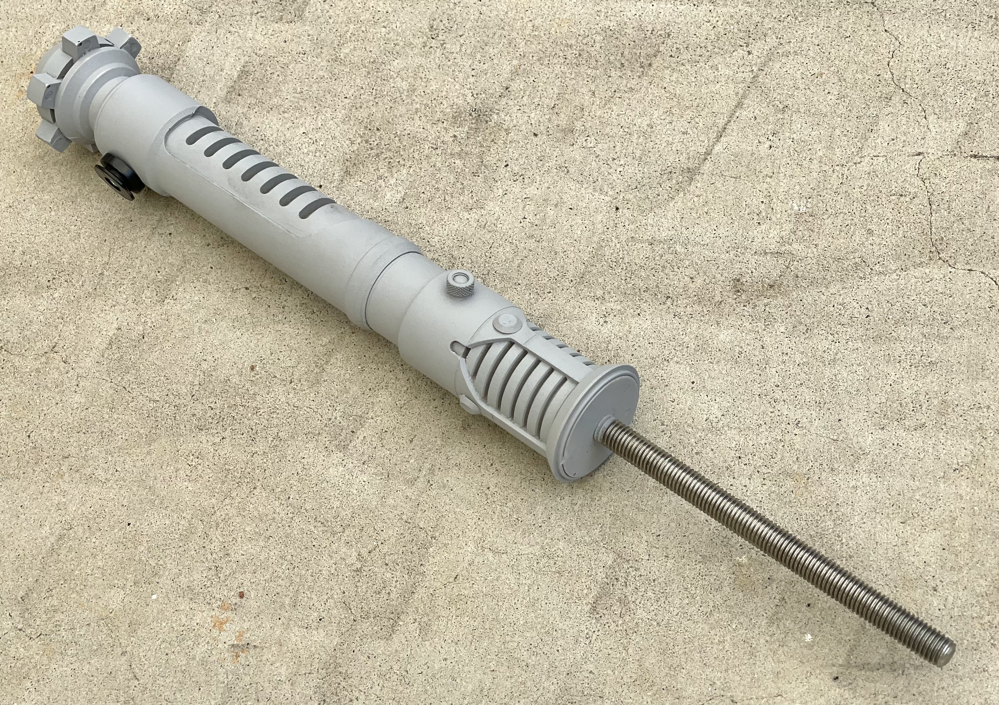

Out of curiosity (and the fact that I’m not going to be able to resist trying to dual with this) how deep does the threaded rod go into the hilt? Does it run the length?
It varies because I’m not super precise about positioning, but I’ve been using Min: 250mm, Max: 300mm threaded rods, so they go well into the grip almost to the pommel. From memory, the saber itself is ~285mm in length.
I make no promises to their durability, but I’m confident they should be approximately as tough as the original stunt sabers.

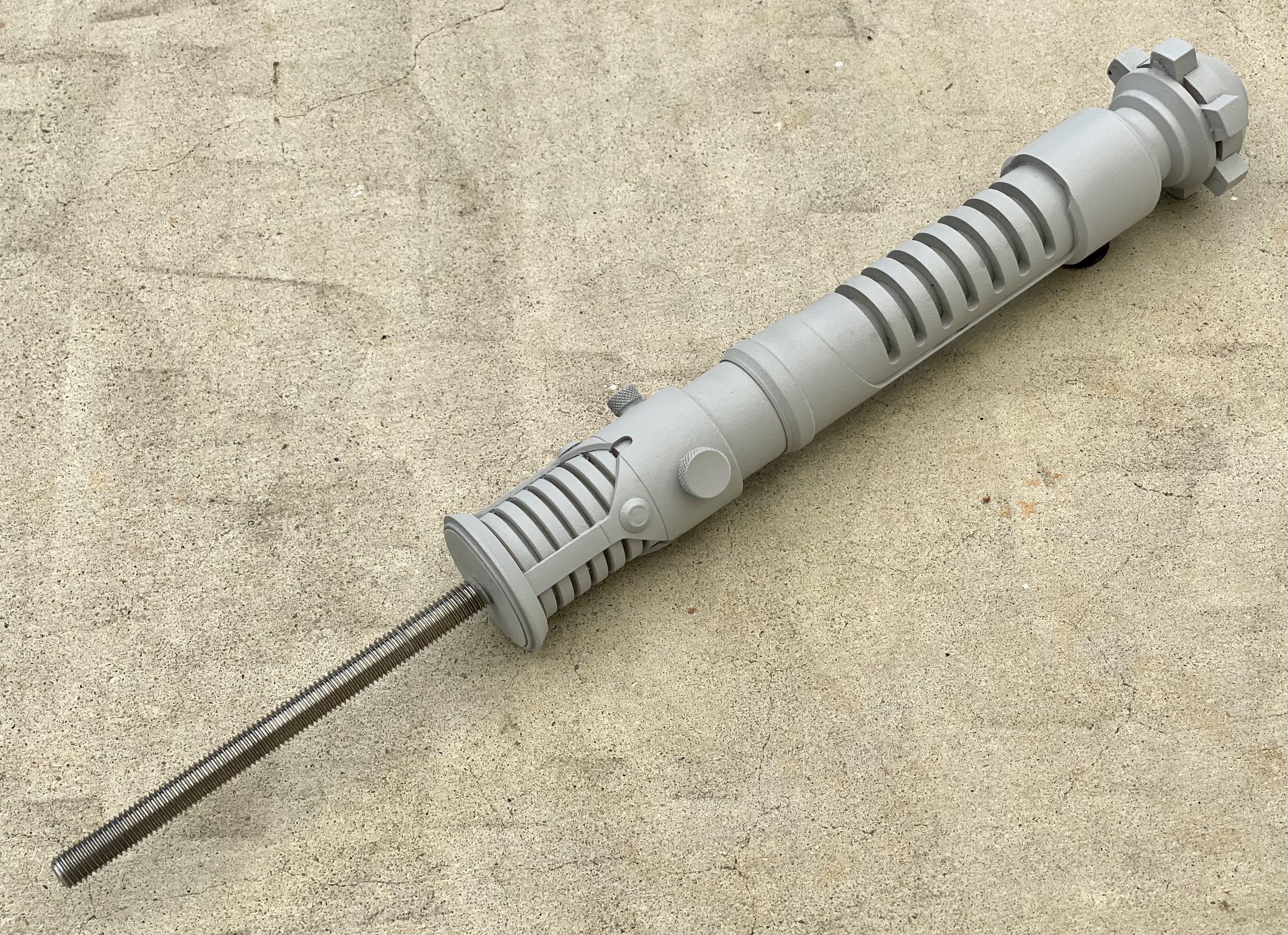

For reference, this is just about the maximum stick out of the threaded rod that will fit in my pressure pot. Unfortunately, these don’t fit in the shipping boxes I ordered, but that’s my problem, not yours!
Man I really hate that they won’t fit in your boxes with that much protrusion. How much shorter does it need to be to fit?
Hahaha don’t worry about it! These are not special boxes or anything. Just the shipping boxes I happened to order from Amazon to ship these in.
I’m planning to default to the shorter stick out except for when requested otherwise, or when a featureless stunt commission is ordered.

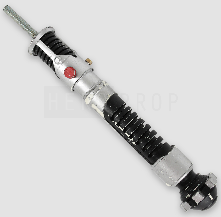

What do you mean by featureless?
The featureless stunts were the ones used for heavy dueling where the pommel cubes, red button, and brass knob were removed from the casting and painted on in “2D”. See the first post of my research thread:
Ah, yes, I know the ones. There's also a photo of Obi, little Ani, and qui gon where Ewen has that stunt in hand

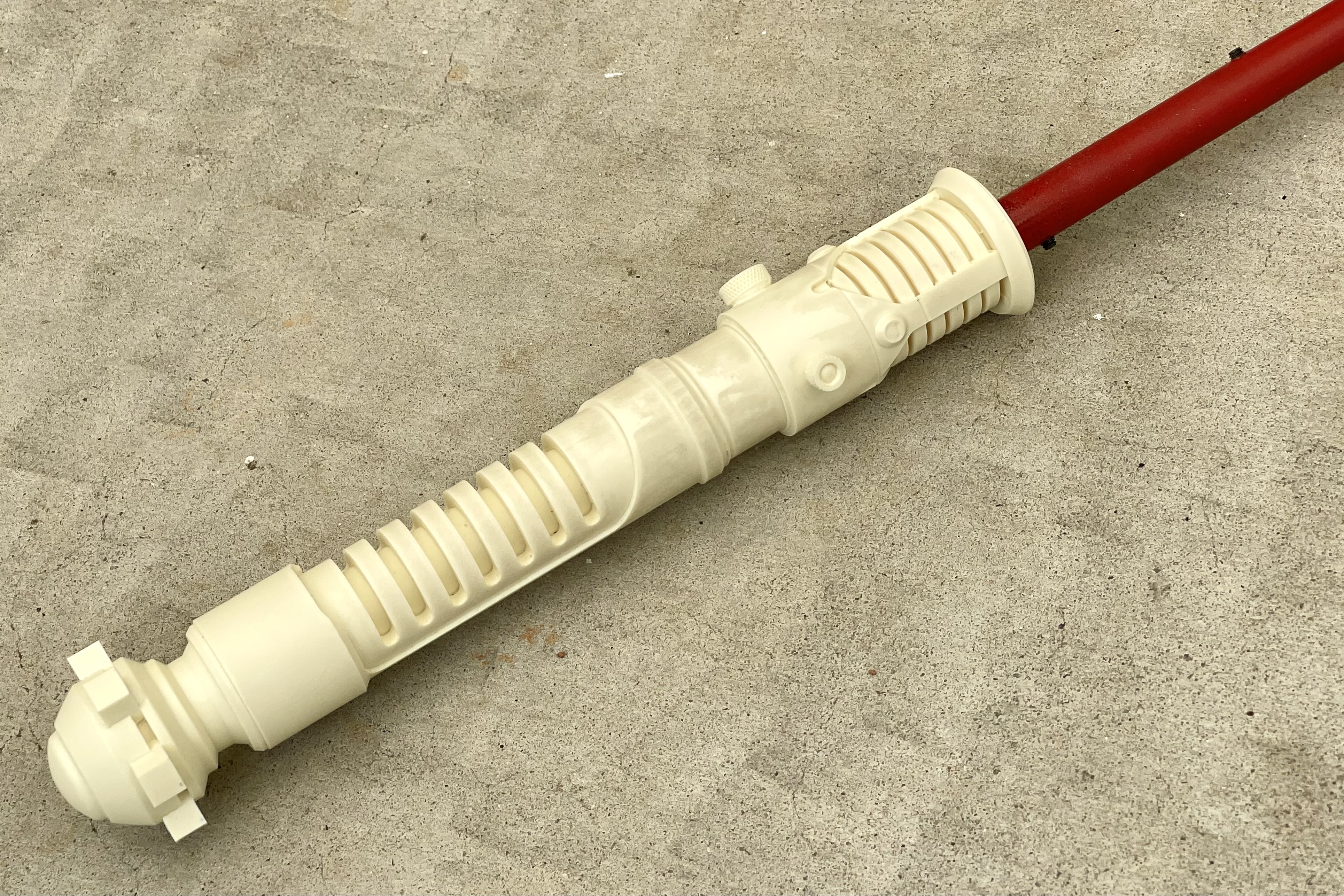

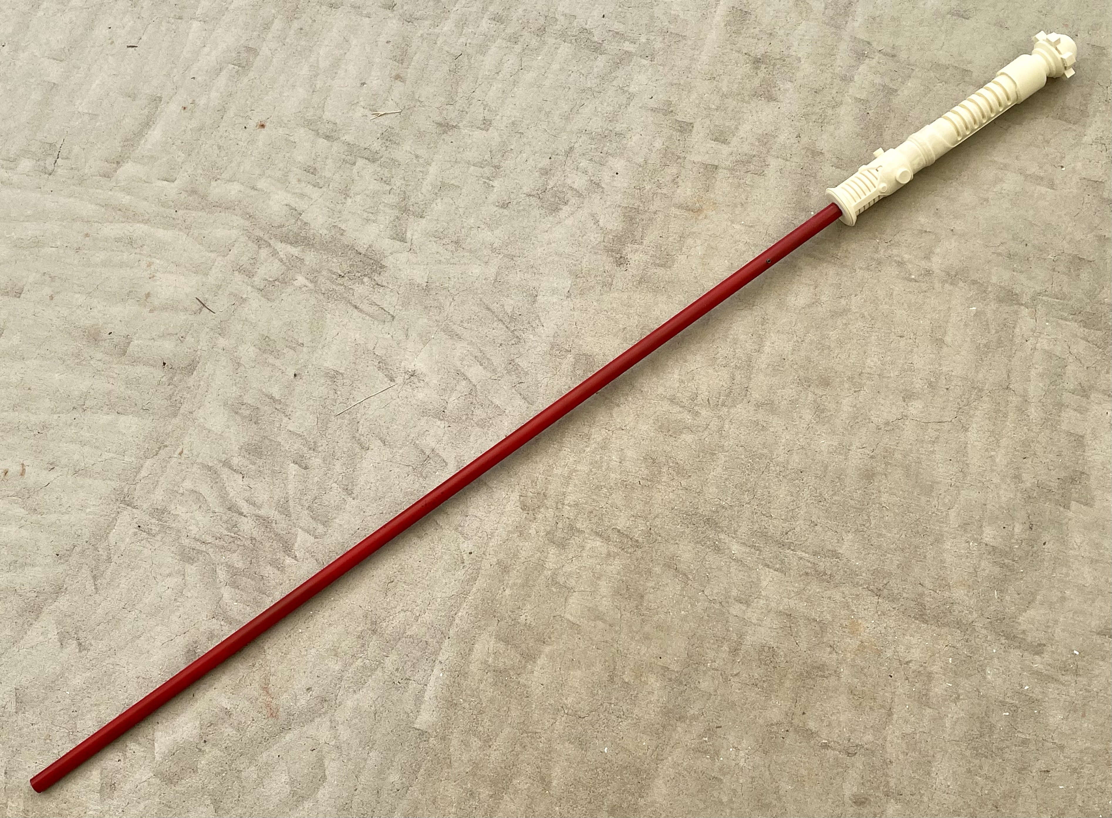

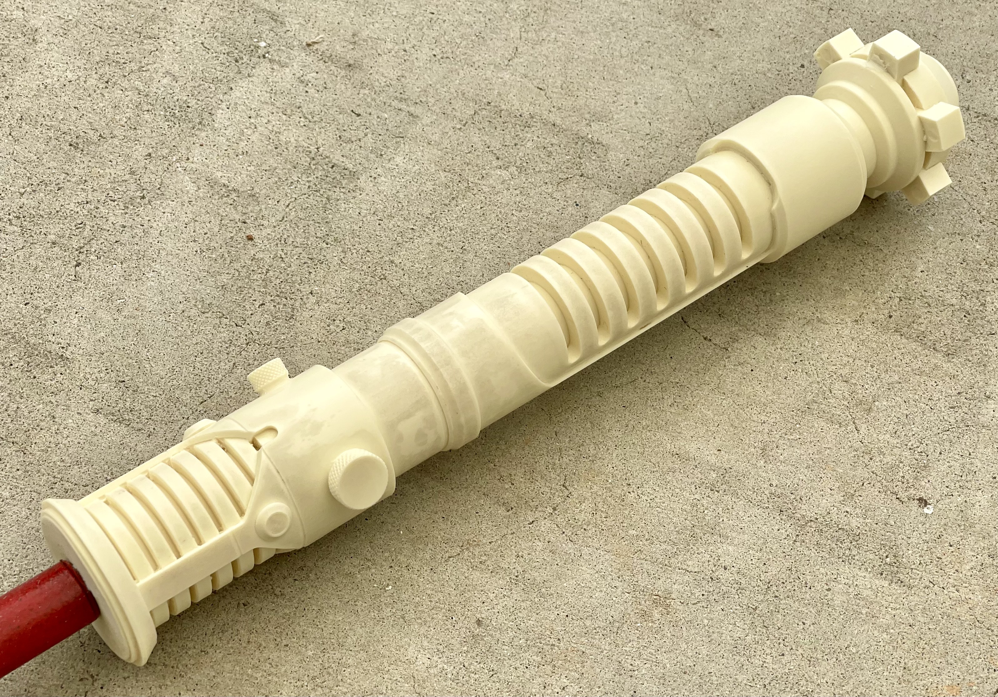

My hilt came. Please excuse the dirt, I whipped up a quick blade late last night out of a curtain rod and some aluminum bar stock that I drilled and tapped.
Diameter is smaller than the actual stunt blades, I just grabbed the first tube that I thought looked good enough to use for the moment.
Sprayed the closest red I had on hand, really fast, and helped it along with a hair dryer.

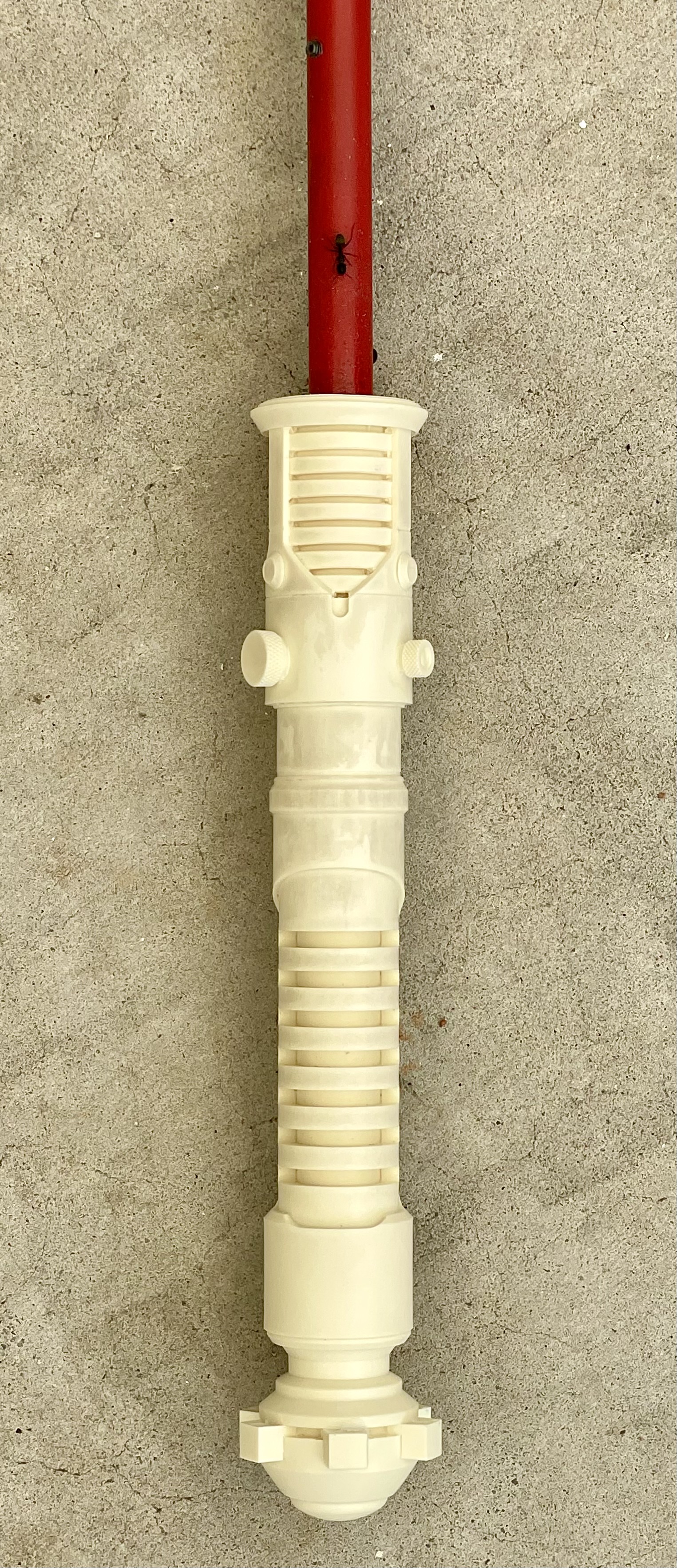

One picture caught an ant crawling along the blade, I thought that was funny.
Anyway, thanks, Dewy! Great job on these!

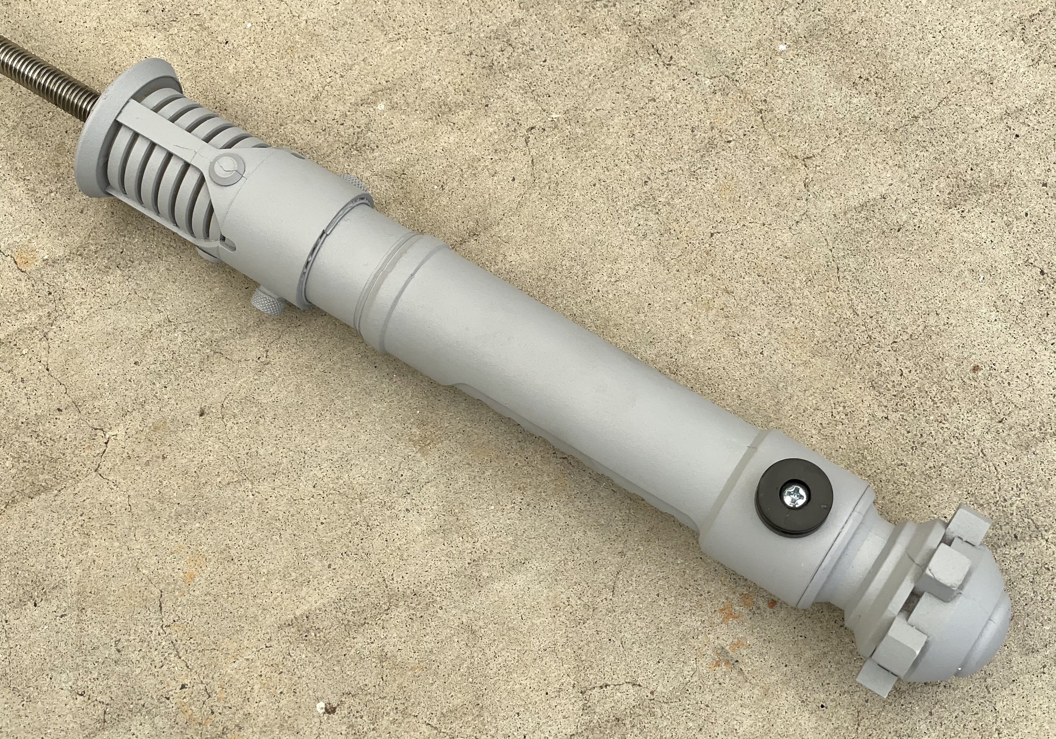

I hit it with a quick coat of primer this afternoon. I thought I still had some Tamiya spray primer, but I couldn’t find it. Had to settle for some other junk. Also dug out an old Covertec knob. I’m pretty sure I’ve had that thing since 1999!
