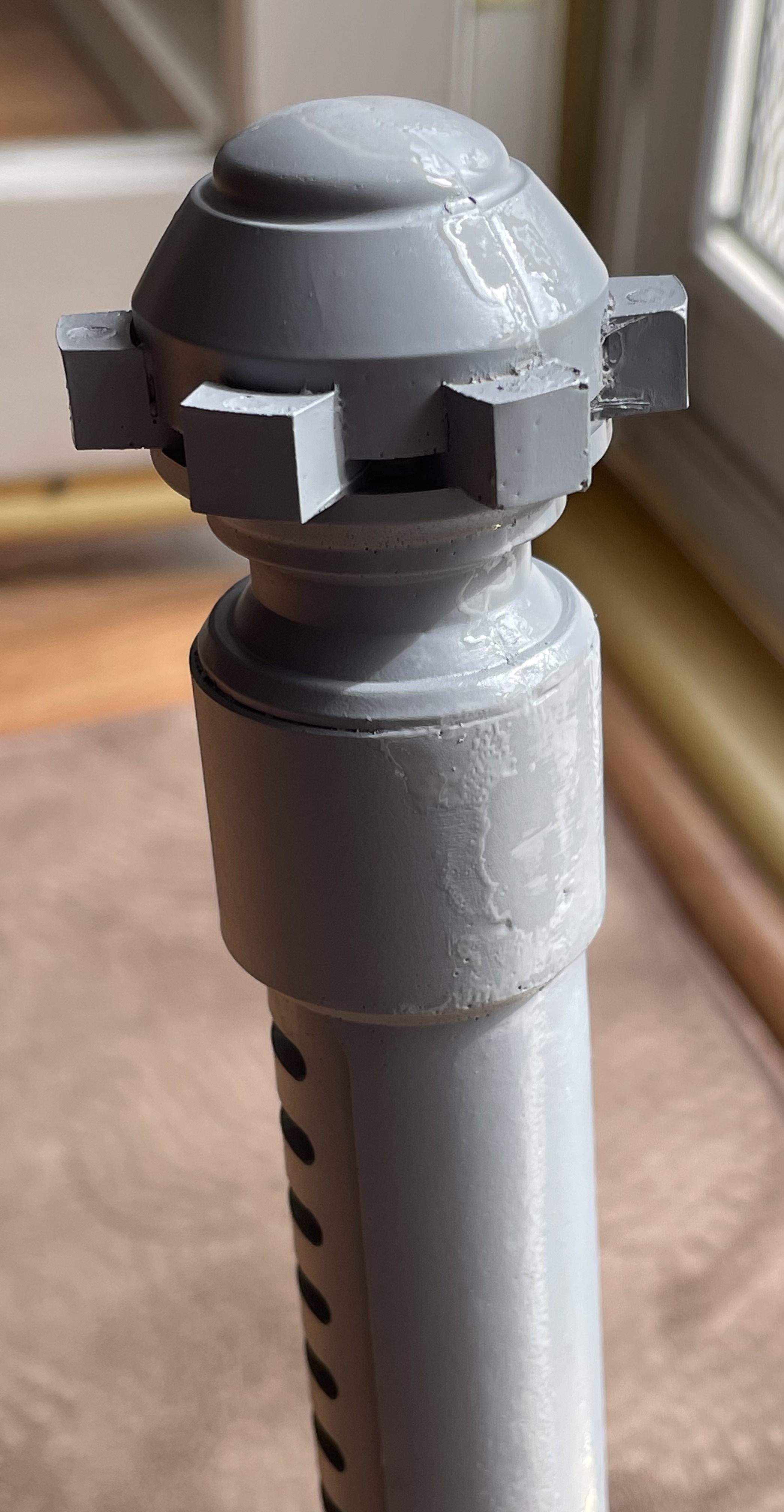

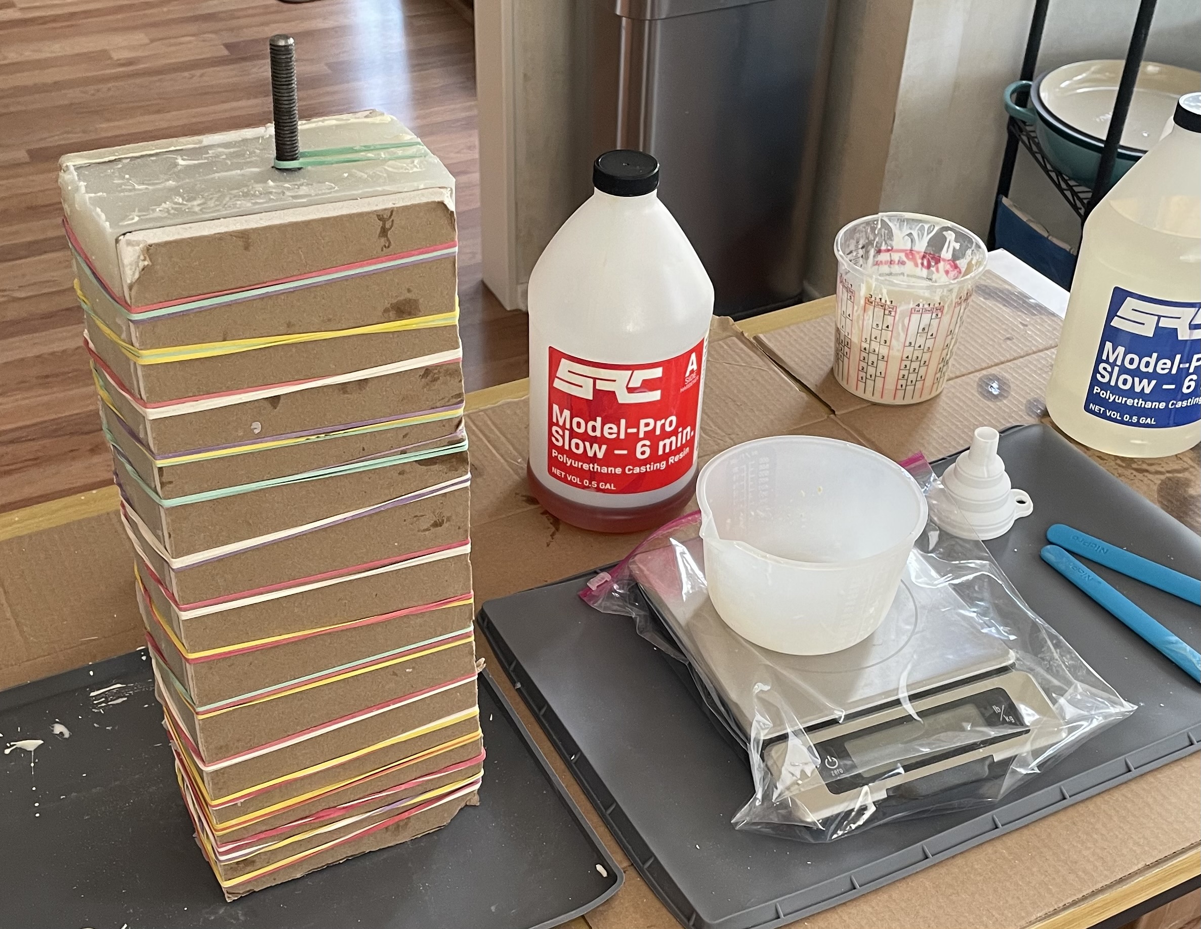

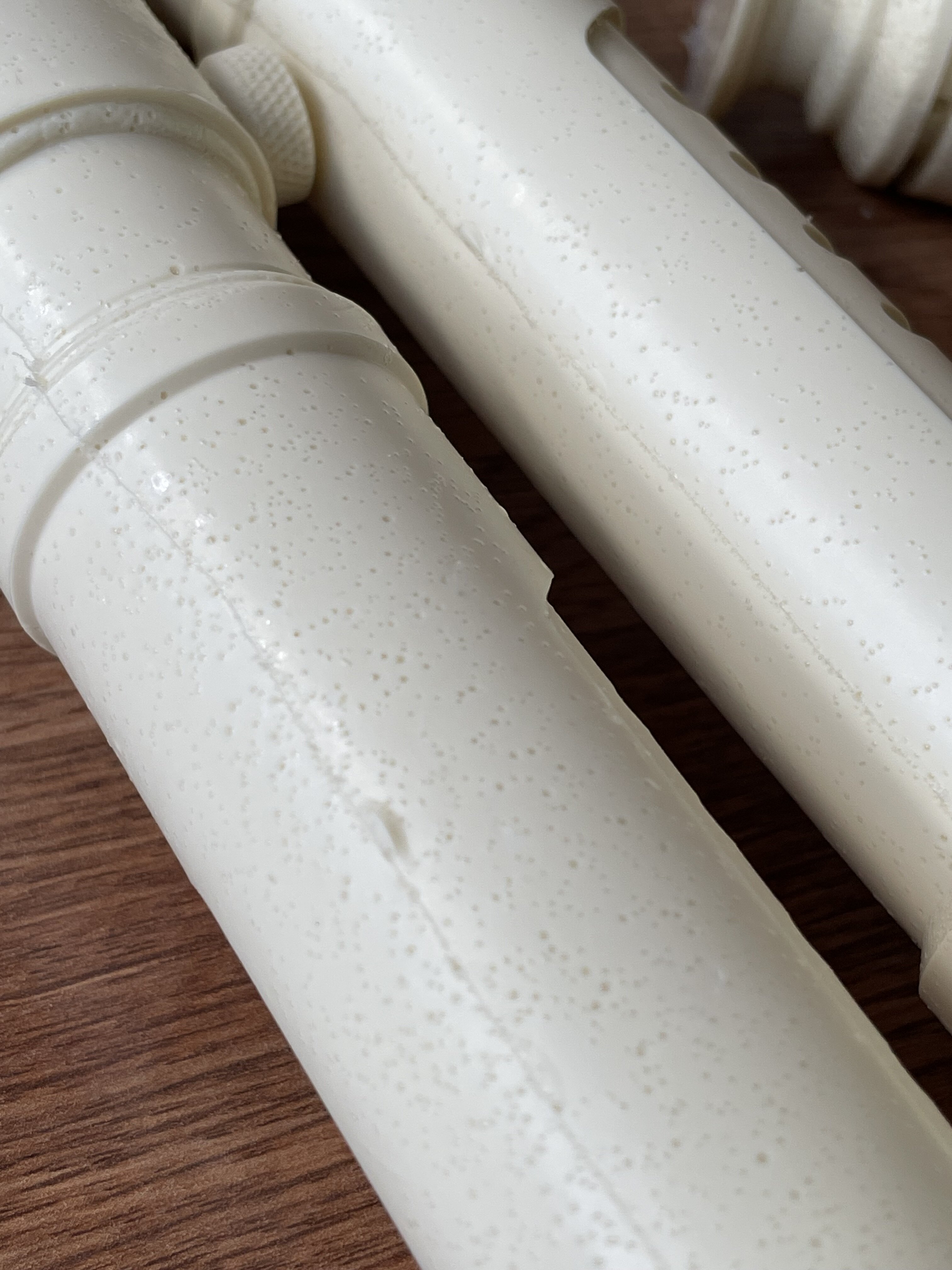

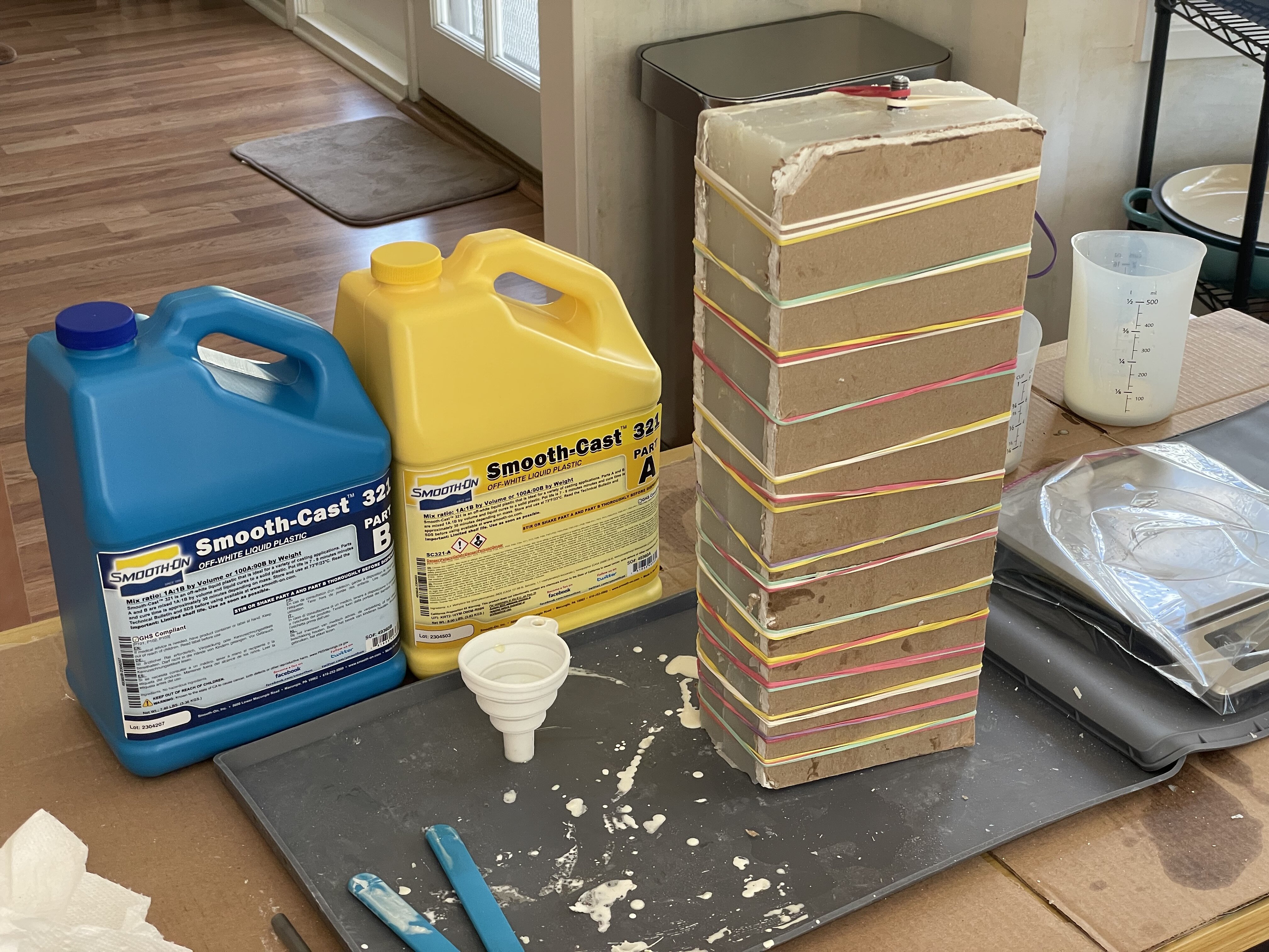

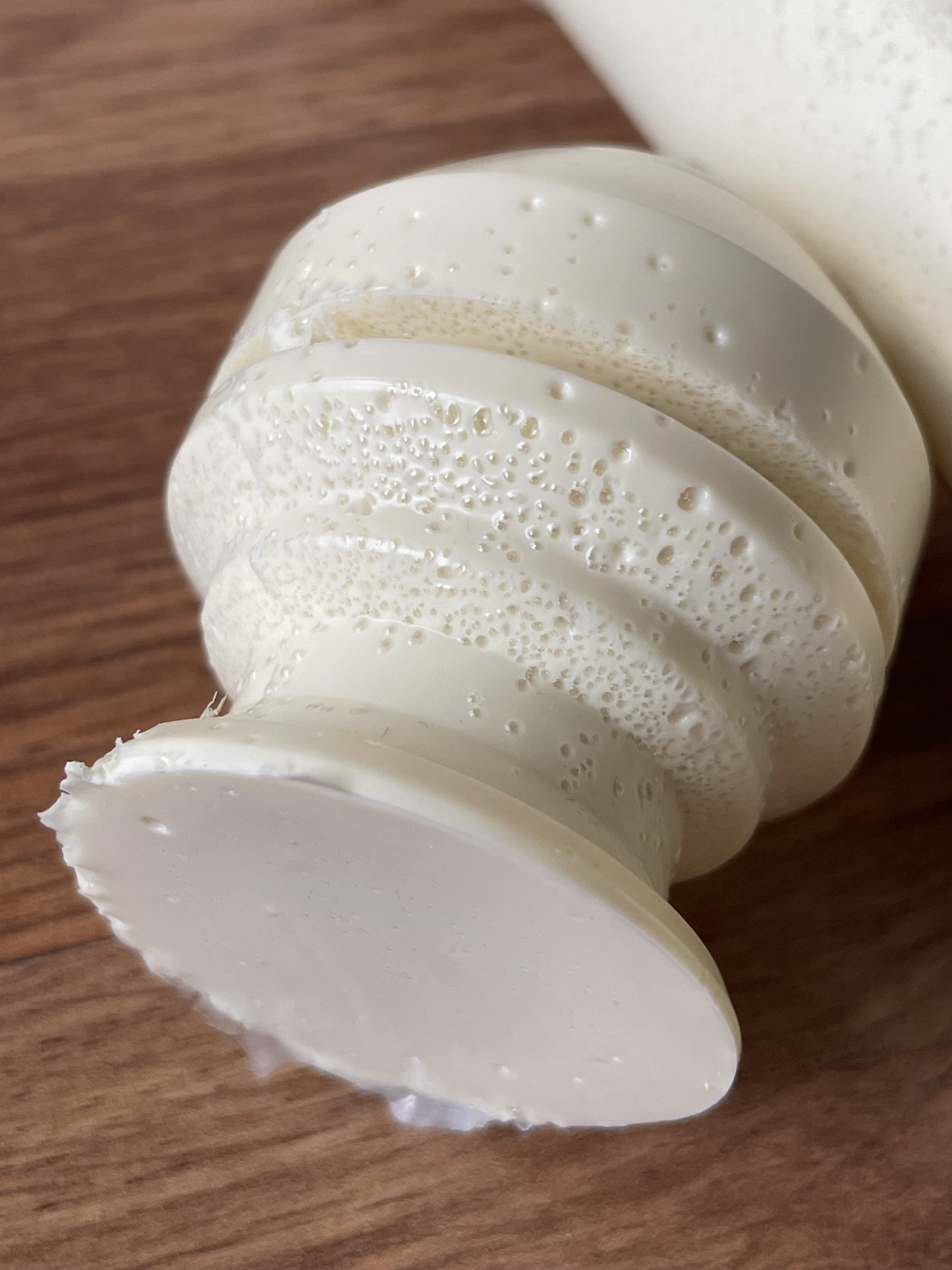

  2. I think I may have a bad batch of resin. I recently ran out of the original batch I ordered and got a second batch of the exact same material. Both of the castings I’ve made from this new batch are weeping. I am measuring them out using a digital scale and get the 1:1 ratio down to the gram. Unfortunately, I didn’t notice one of them was weeping until after I prepped it yesterday when the primer just wouldn’t dry. Today the primer is tacky and there is visible seepage.

There is tan high impact MPK resin and I’ve never had weepage, it’s like water with a tiny bit of thickener in it.

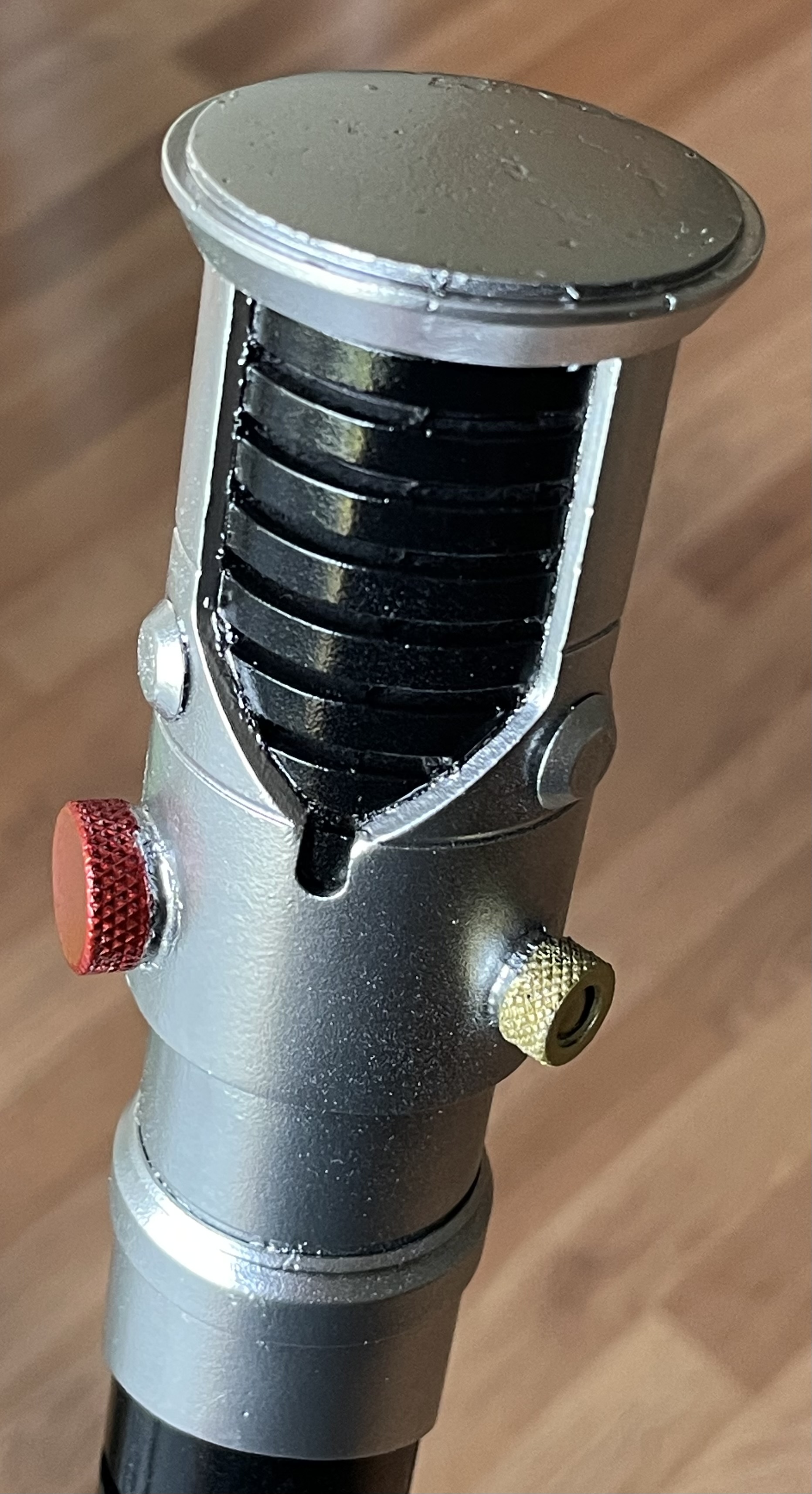

Okay this I’m even more skeptical of. I have never seen a second hero QGJ.
There were definitely two variations of the QG hilt.. as Excelsior has mentioned. Saberz replicated the non smoothed fangs/hooks version. The shape of the top half of that shroud is different too. However, the one Liam wore was no doubt what you and AS are replicating which is my fave!

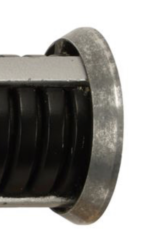

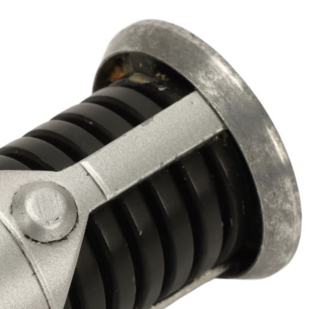

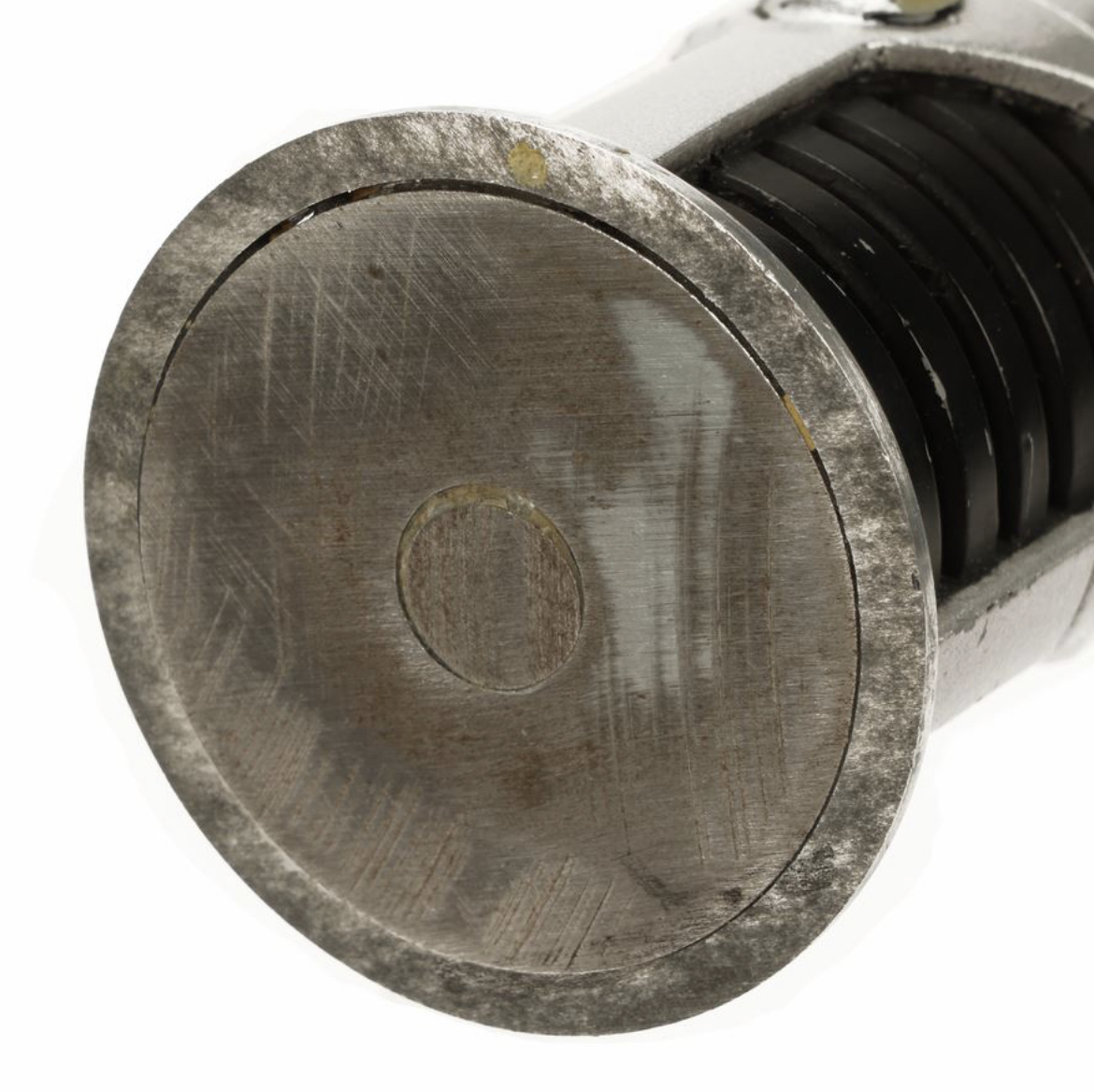

Definitely steel! You can see rust
The part looks like aluminum to me. It appears to be a white metal, not gray like steel.
If it were steel, then the propmaker would have had to make a steel replica of the found aluminum part just for this saber only. Very unlikely. Steel takes a lot longer to machine than aluminum. Plus this part looks identical in its dimensions to all the other aluminum bezel parts on these TPM props. It would be impressive on the part of the propmaker to make that perfect of a replica just for this one resin saber. And if they ran out of the original found parts and had to make a replica, it wouldn't make sense to do it in steel. The propmaker would choose aluminum because it's a lot easier to cut, not to mention the same material as the part he'd be replicating.
There is some weathering and oxidation visible, but nothing that stands out specifically as rust on the outer bezel. We do, however, see the reddish rust on the fender washer and threaded rod--both of which are confirmed to have been steel:

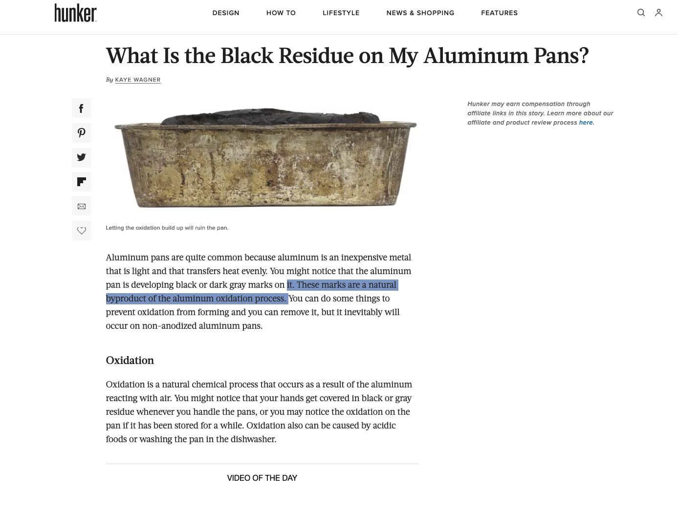

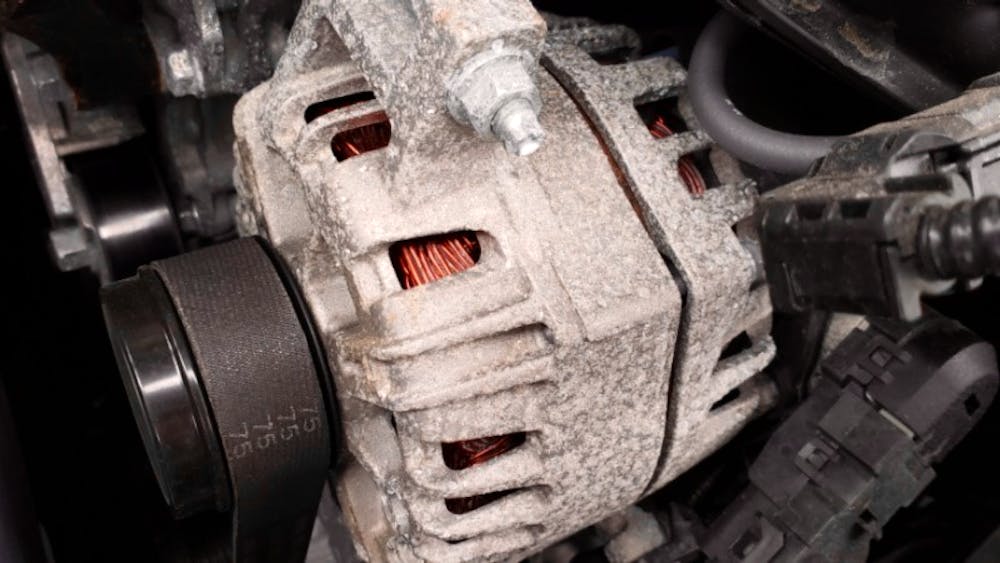

Oh trust me, I can see why folks would think it looks like steel! But yes, aluminum can get pretty dark too, especially if it isn't anodized, and that's what seems to be the case with these bezel parts. Take a look at the aluminum alternator housing under the hood of an older car for a good example:
Replicating the look for the stunt hilt would actually be pretty easy to do with some Aluminum Black.
Living in Los Angeles, I am fortunate to have all kinds of special effects shops within driving distance. I made the pilgrimage this morning to a place that is essentially a Smooth-On showroom. Surely this stuff will solve my issues. I’m still waiting for my air compressor, but I wanted to get at least one more decent casting so I can test out the custom paints that I ordered.
It seems I am cursed. These are brand new. Each part was vigorously shaken/mixed within its own containers then thoroughly mixed when combined. Humidity is 40-50% here, which doesn’t seem high enough to cause such problems.
