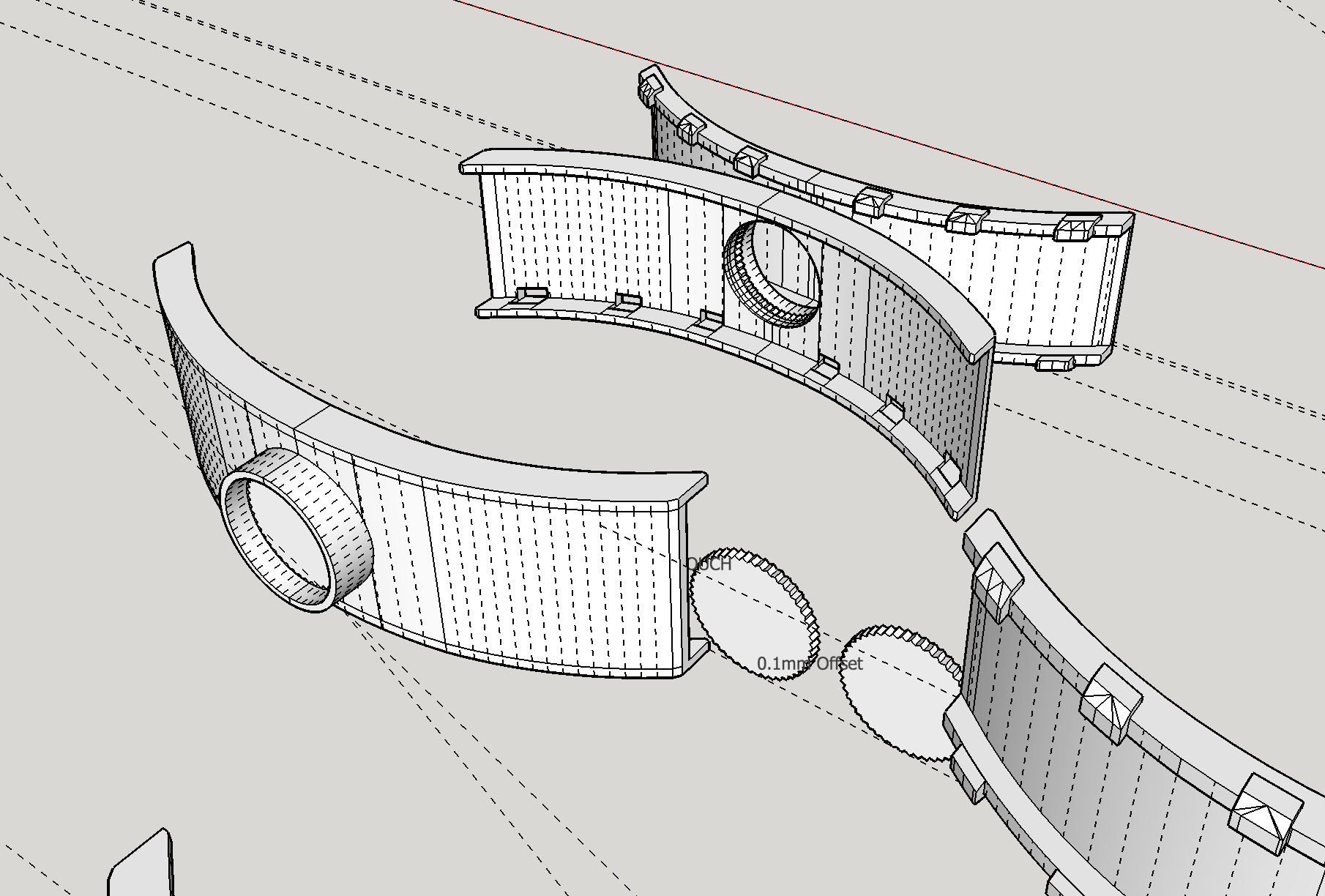

I absolutely love the approach you took with the printed parts David. The overlapping edges and screw points look like a very smart and solid design. Is there anything you would change if you were to do it again? The only thing I couldn't figure out from your video was how you mounted the lenses to it. I haven't had a chance to take my cameras apart yet (I did try but the screws are frozen and the heads are pretty soft) so I don't know much about the mounting solutions on the lenses themselves.
With the screws - you'll need a precision screwdriver that is snug. If you find the screws dont come out spray them with WD40 and leave overnight to do their magic. Then next day they should wind out okay. I did the same thing as you and then had to buy a better set of screwdrivers.
So the mounting can be done multiple ways but I tried to engineer as much a modular way as possible. I actually ended going through several types of clothing snap fasteners, like you'd find on the hem of a duvet for example. You want fairly hard-wearing ones that keep their grip. I had four of these round the back of the lens to fasten the body of the print. My 3D print was a little deeper than I needed by half a centimetre or so, so I actually used a dense foam as a backing to the snaps. Way I saw it, they would act as little shock absorbers too (as I was concerned the vibration from the lens might go through the body and make a strange noise or feeling). If you're super confident you are done you could hot melt glue gun the whole lens assembly in there, but I had far too many tweaks to do.
As for things I'd change about the print - it came out okay. I had to open up some of the screw holes a bit more and sand back where the tubing meets the eye front piece, but all in all the shapeway print was so accurate I had nothing to worry about. It all fit straight out of the box. I think my sanding improved as time went on, but that wasn't anything to do with the print. I might have been a bit severe on sanding the front piece, but it gives it more of a vac-formed look so I'm ok with that.
I did spend months making the 3D printed section - that took the longest planning and checking. I definitely used the measure twice print once approach. And I sent for test prints to get an idea of the finish, fit and scale in hand. I just printed a half section of the front portion. Test prints for fitting are always a good idea if they aren't too costly.

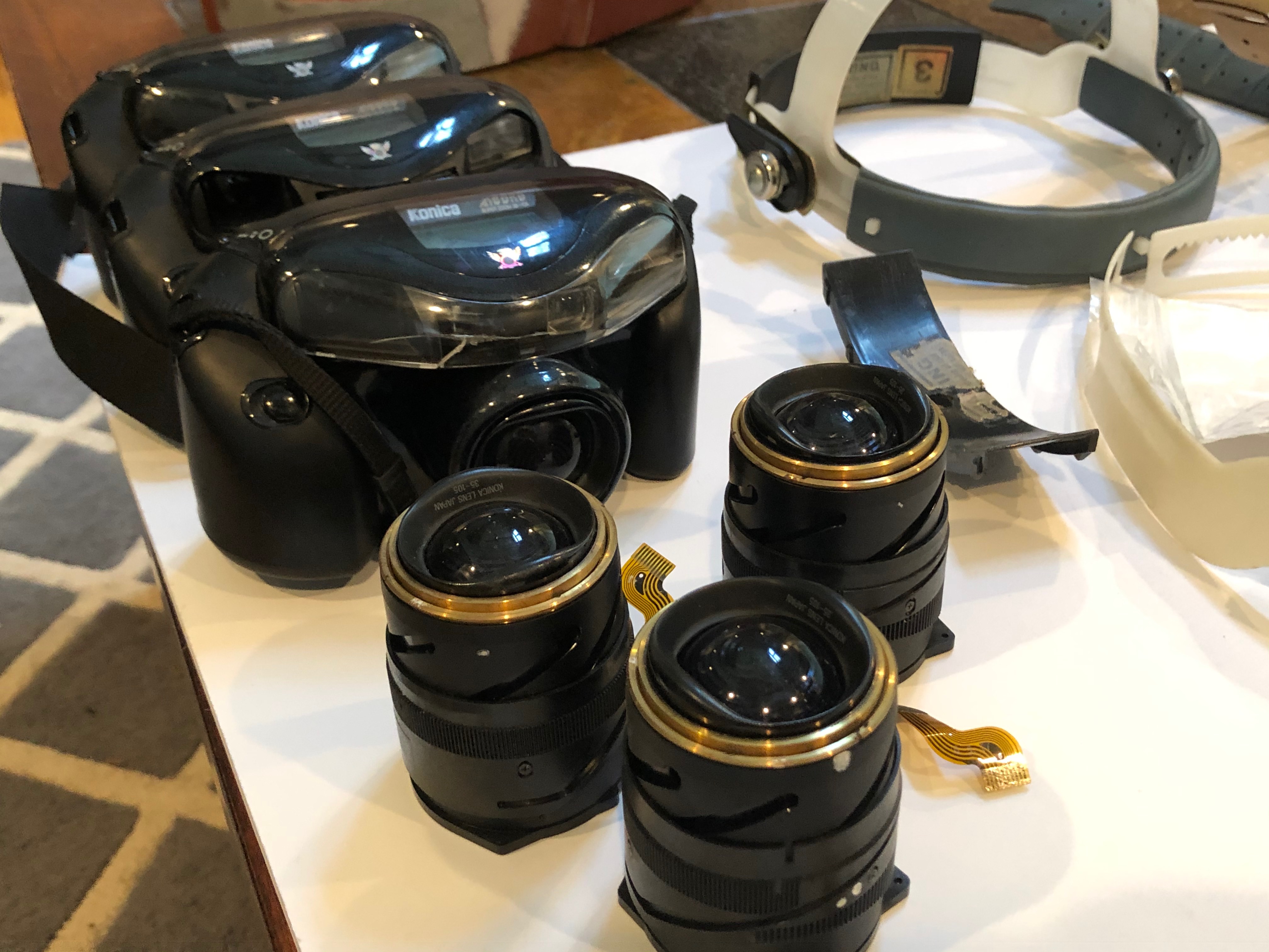

Got my cameras in! Can’t wait to get started. By any chance has anyone seen a spare translucent headband around? It’s been quite a hunt looking for it so far...

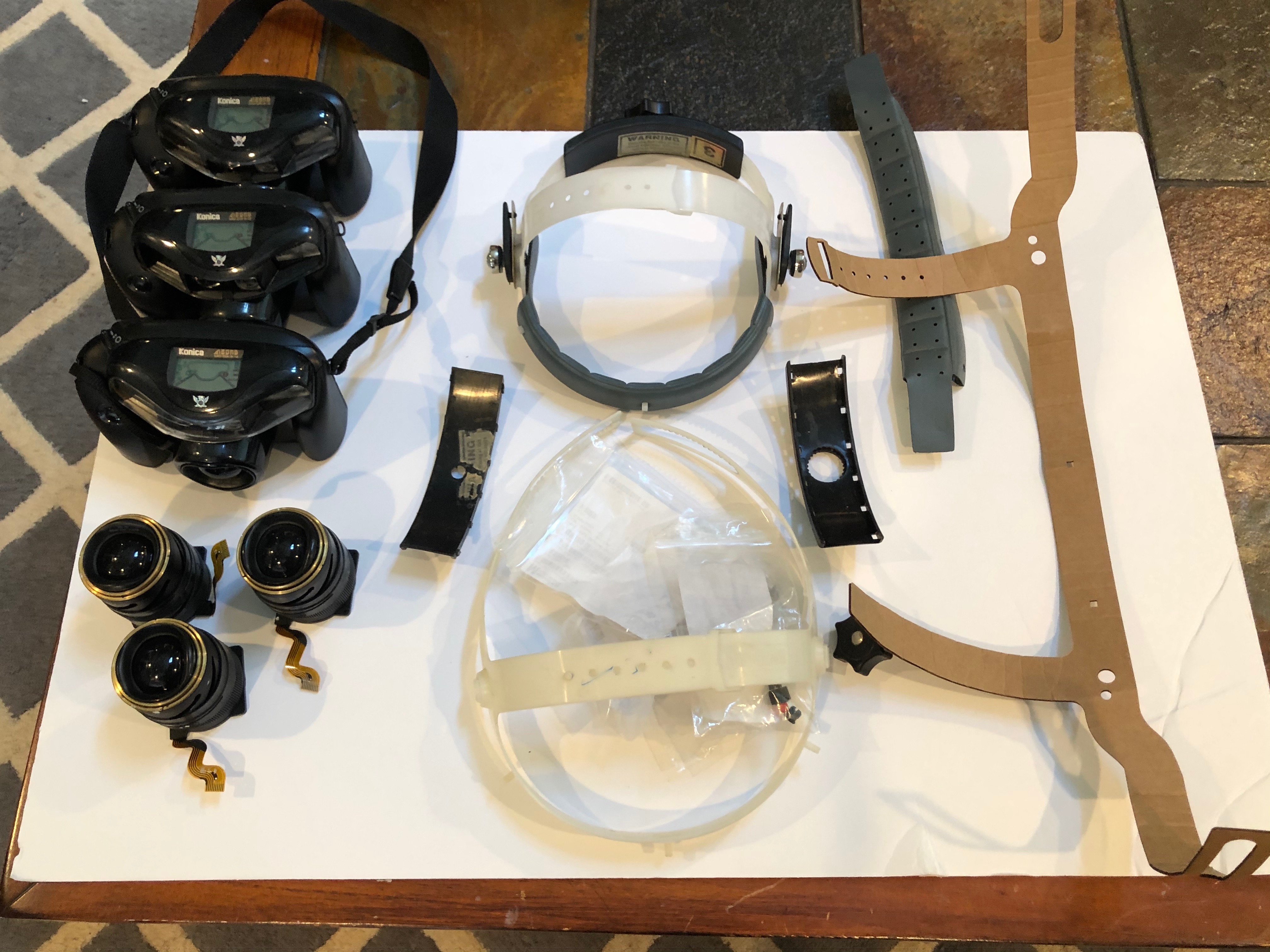

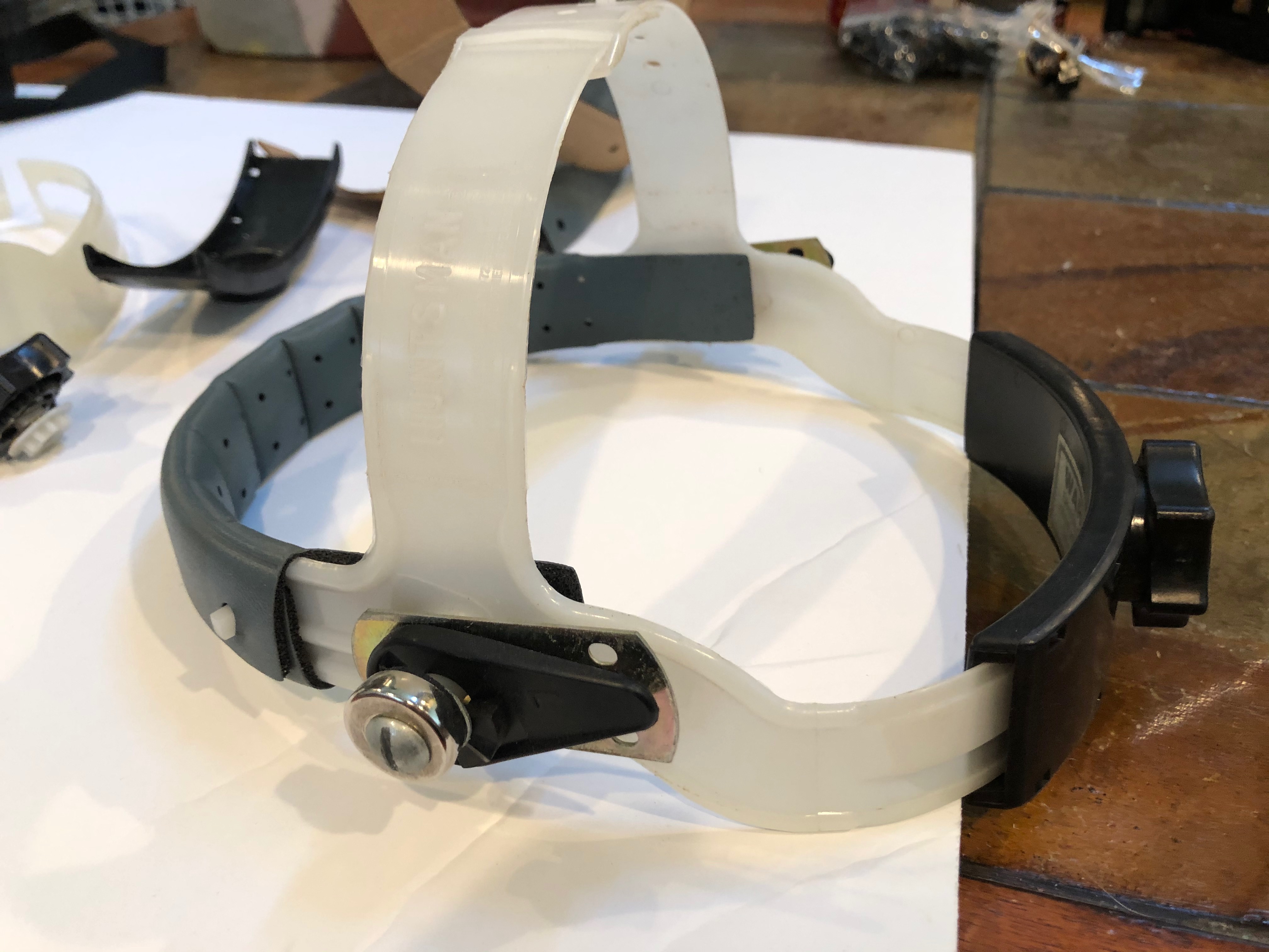

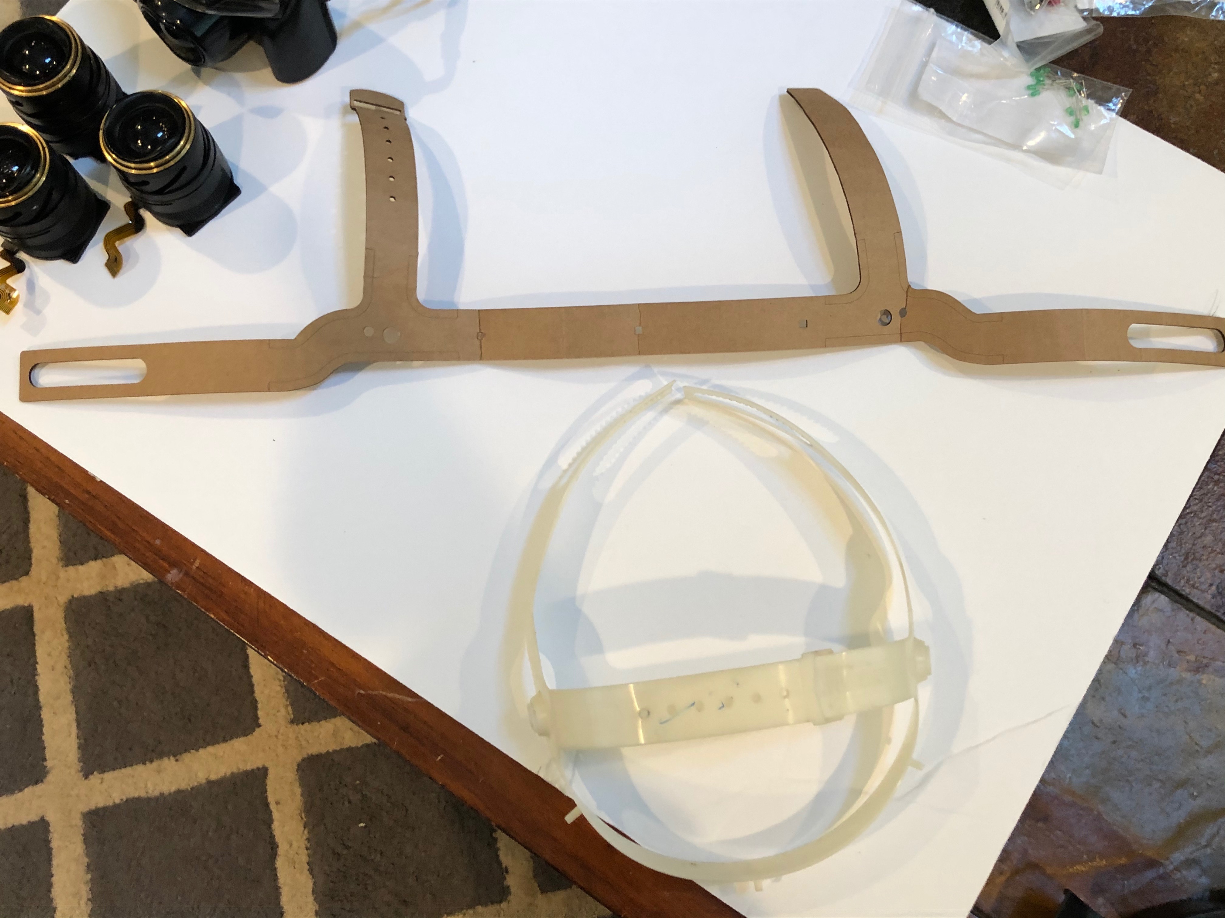

So I started collecting pieces too and went a bit overboard. I also finally found the right harness after getting two 930P helmets.
One thing to look out for, for those trying to find this harness is the Screws on the side of the helmet. Now most of them are either rusted, Black, Red and or Sometimes Pink Plastic. But if you see a white harness with flat head screws on the side where the harness connects to the helmet, thats your first clue to your on to something.

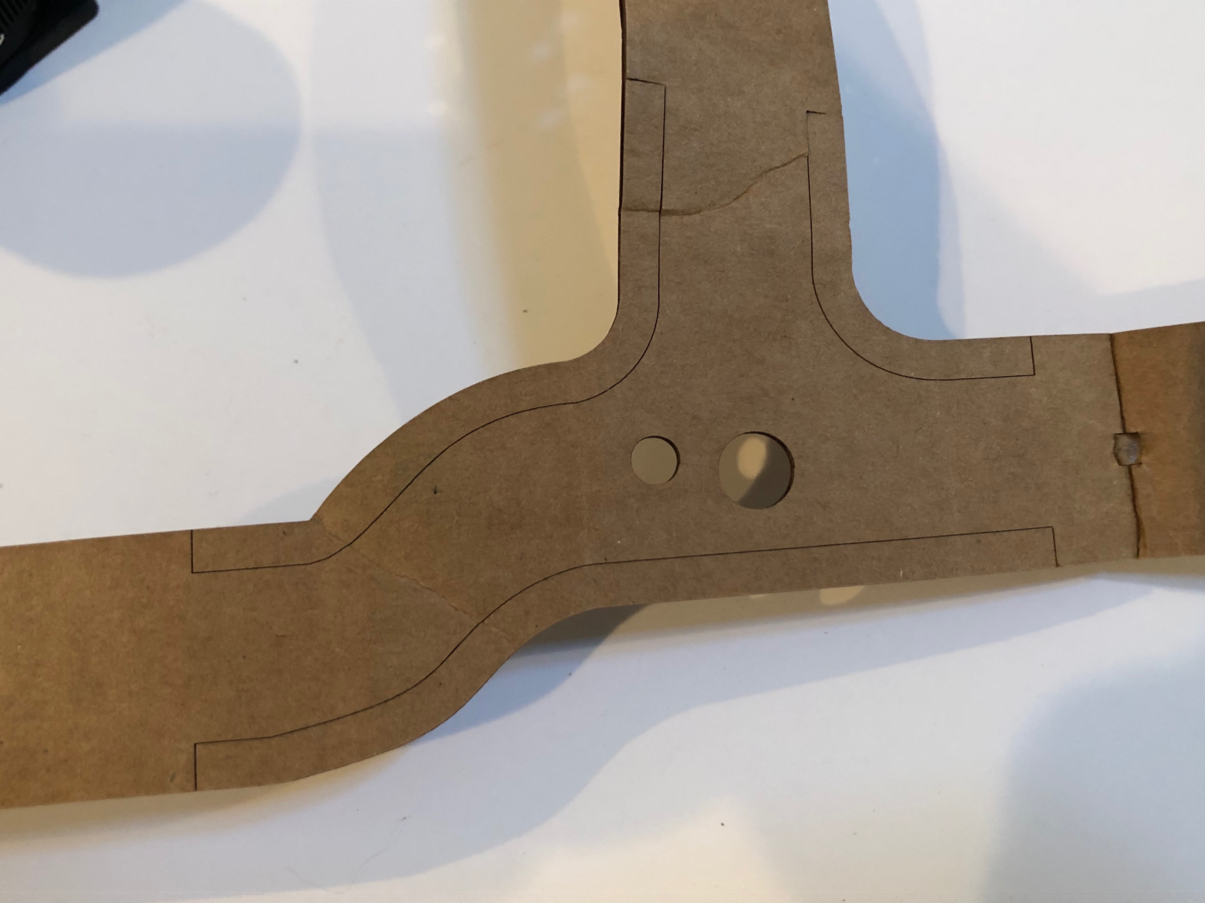

I know i am lucky to have found the right harness and I know their Super Rare, so I started remaking it, based off of the regular "newer" white bands that come with the black plastic adjusters. I took apart one of the first two welding helmets I got to begin seeing how it worked and for reference also tracing it. Then going back to my screen accurate one and based on photos of others harness and mainly a TON of screen shots of Davids Goggle Video (SO GRATEFUL AND THANKFUL FOR THE WEALTH OF KNOWLEDGE IN IT) lined up where the Tubing on the original harness would be. Traced it up in Illustrator and got it laser cut as a test piece. The cardboard mock up works, in theory and from trying it on. Seeing that Chronicle Plans on remaking the harness all together I suppose I will put this part of my project away for the time being.

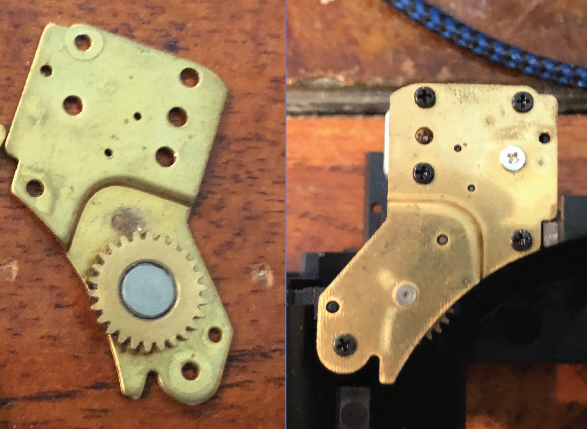

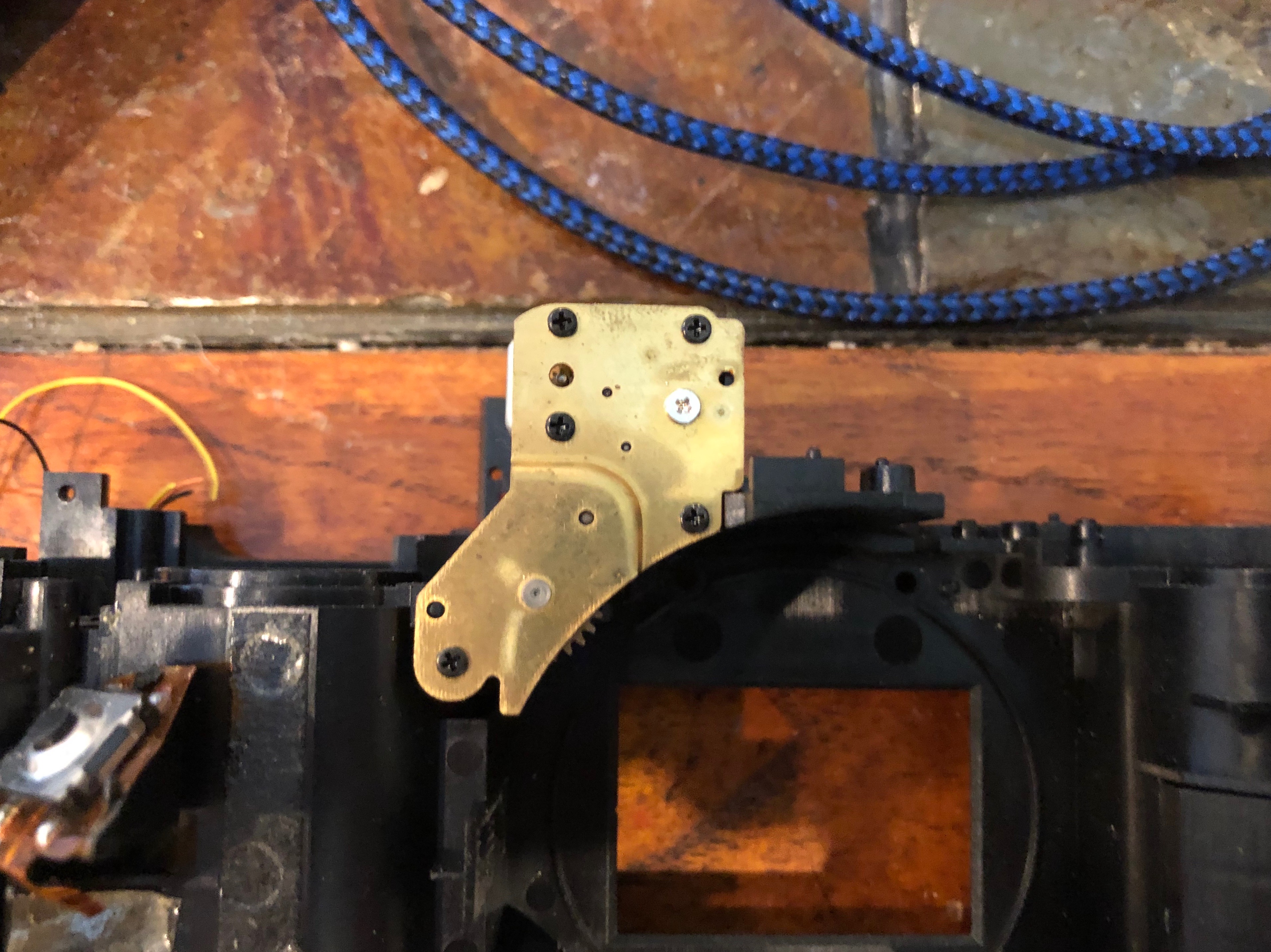

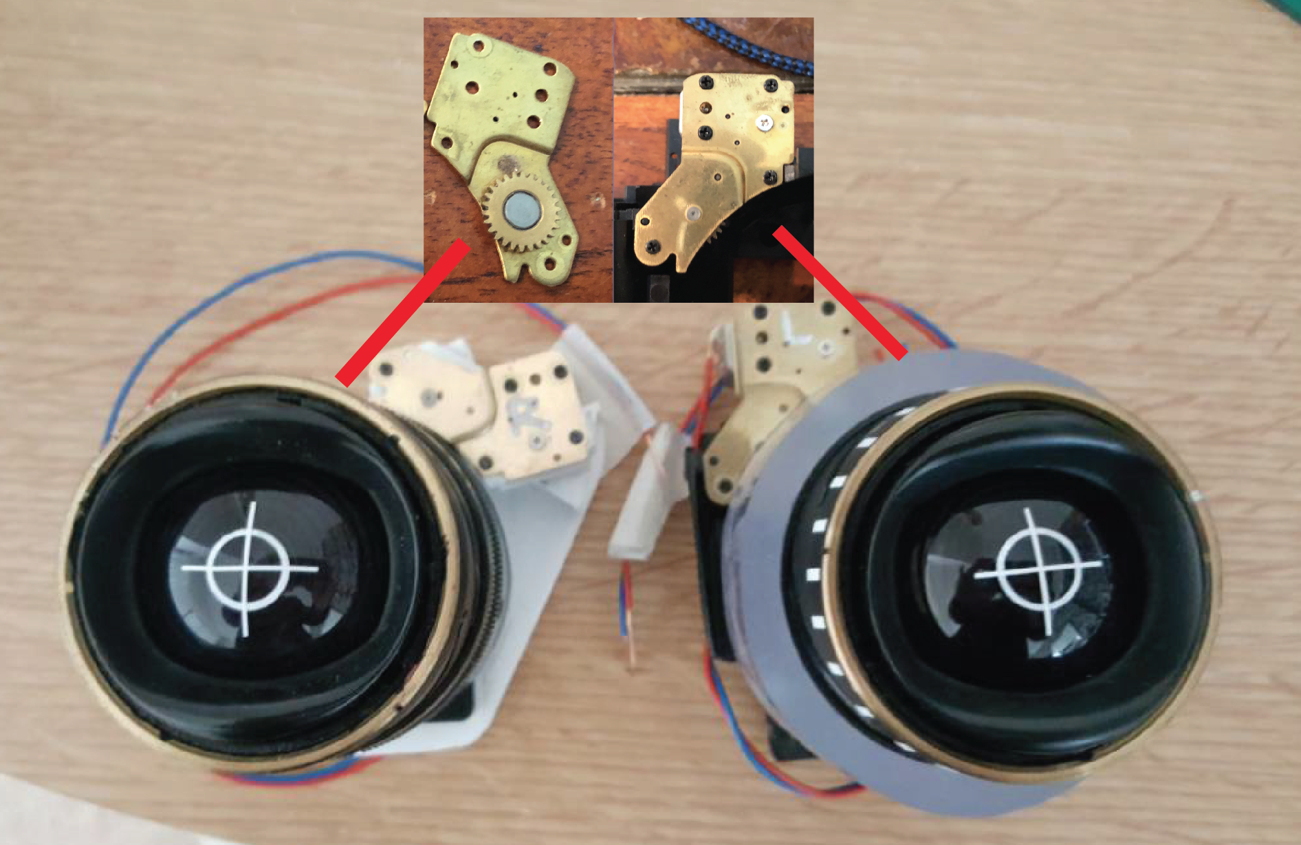

When I took my first AIBorg apart. I accidentally took ALL OF IT apart, including the motor, I learned to keep that part intact. But i still have all the parts to it. Which made me think of this, I know space is really limited in the goggles housing (The Watermelon Visor) and the motor itself is one way as in they all come made this way and engineered this way. But I bet it would be possible to Flip the brass Motor housing to be the opposite direction? It would free up some space possibly I don't really know if it would fit. But it would be more practical as if it were a real manufactured product for the park. (last Photo Credit to David for base photo)
IMG_E6762.jpgScreen Shot 2020-08-12 at 1.53.29 PM.pngScreen Shot 2020-08-12 at 1.54.51 PM.png
Just thought Id throw that out there. Thank you again for the Info! Build on my Friends!
