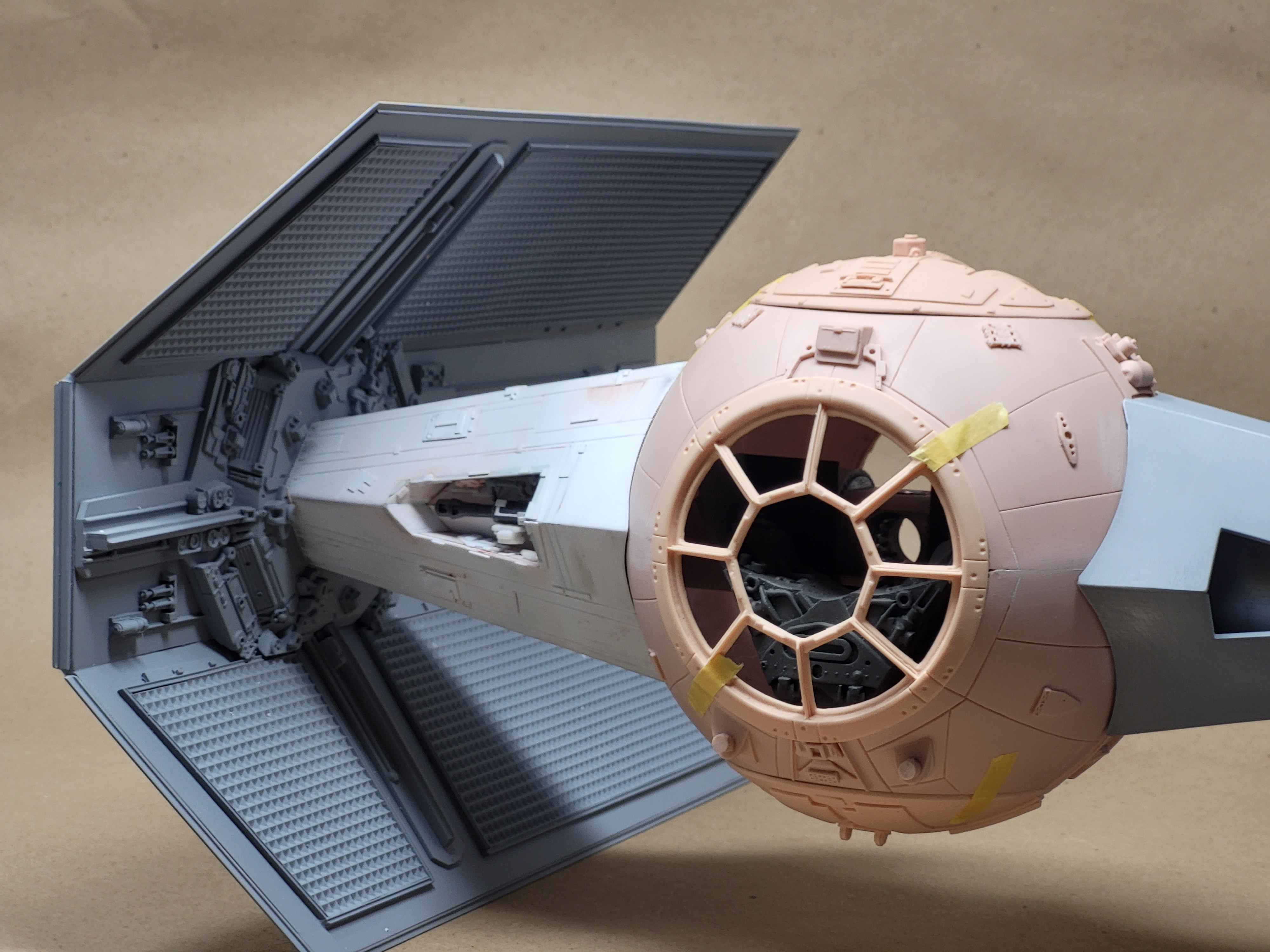

Probably won't have any updates for a while, work is getting crazy, I have outside jobs to finish and real life is getting in the way.

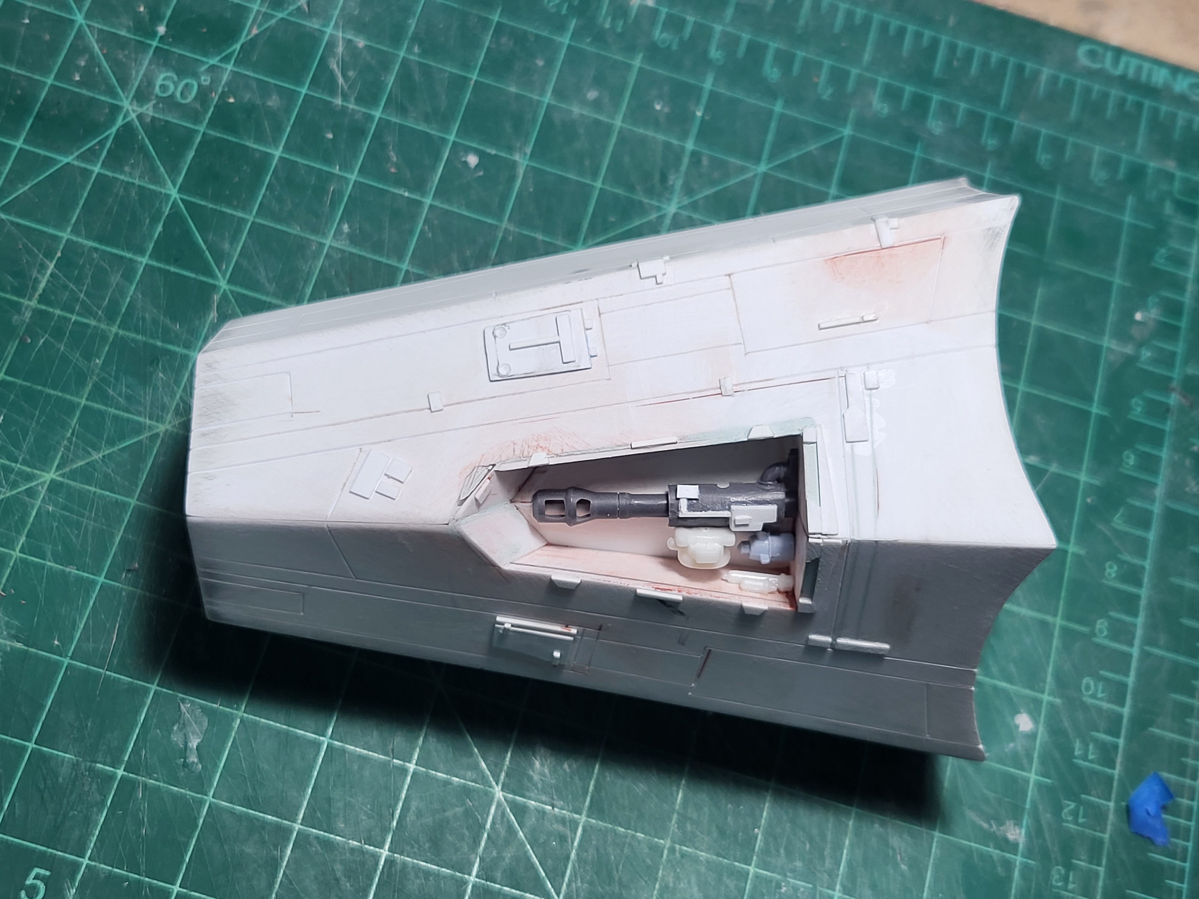

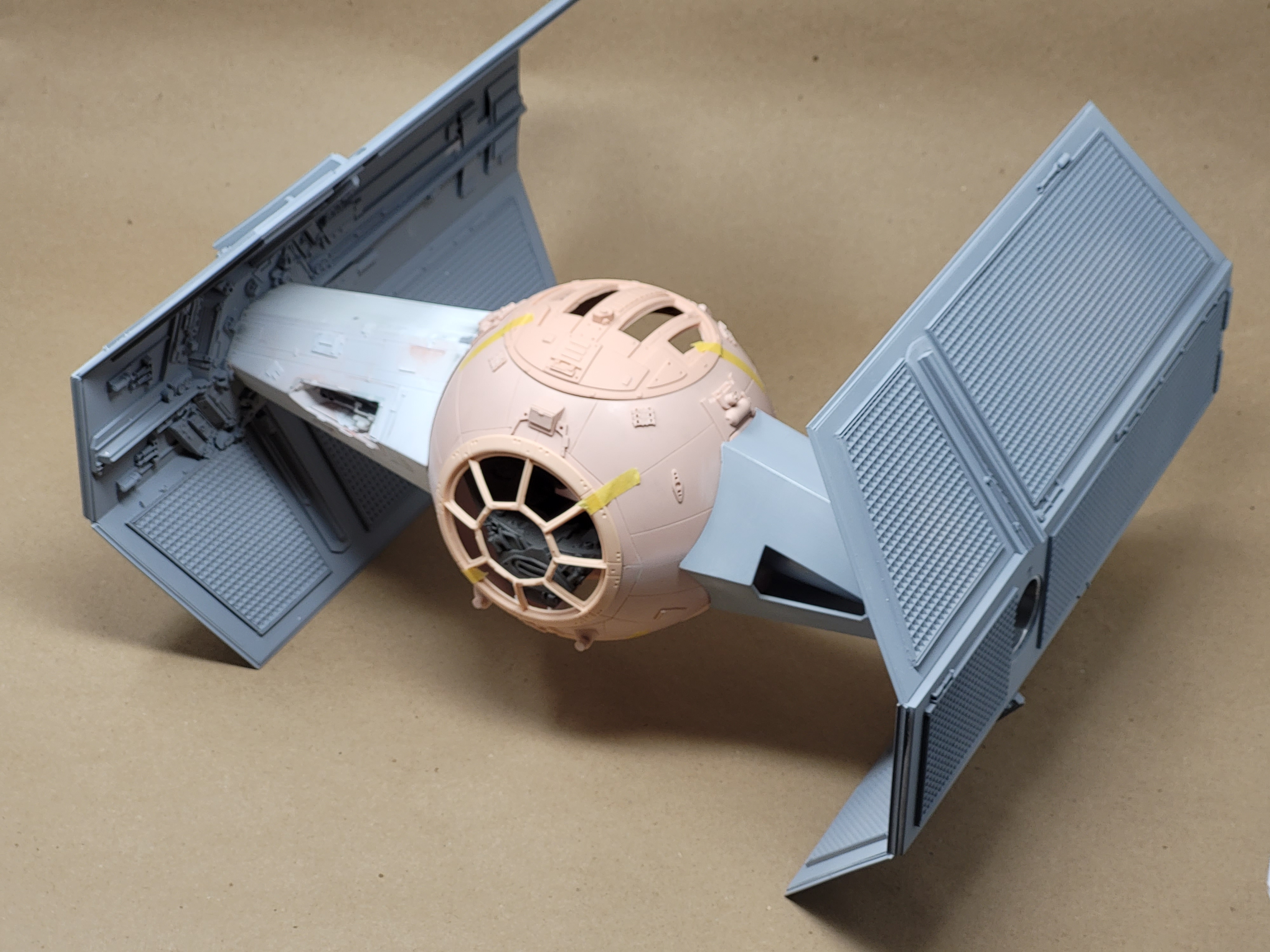

Anyway, finished the lower "droid strip" today.
I'm finally getting around to starting my TIE Advanced thread.
As with all of my Studio Scale builds, I want to thank everyone who has done the hard work before me to ID the kits and share the information here. I also want to thank those individuals who have helped me directly to find those really hard to find ID's and kits. Thank you!
On with the build.

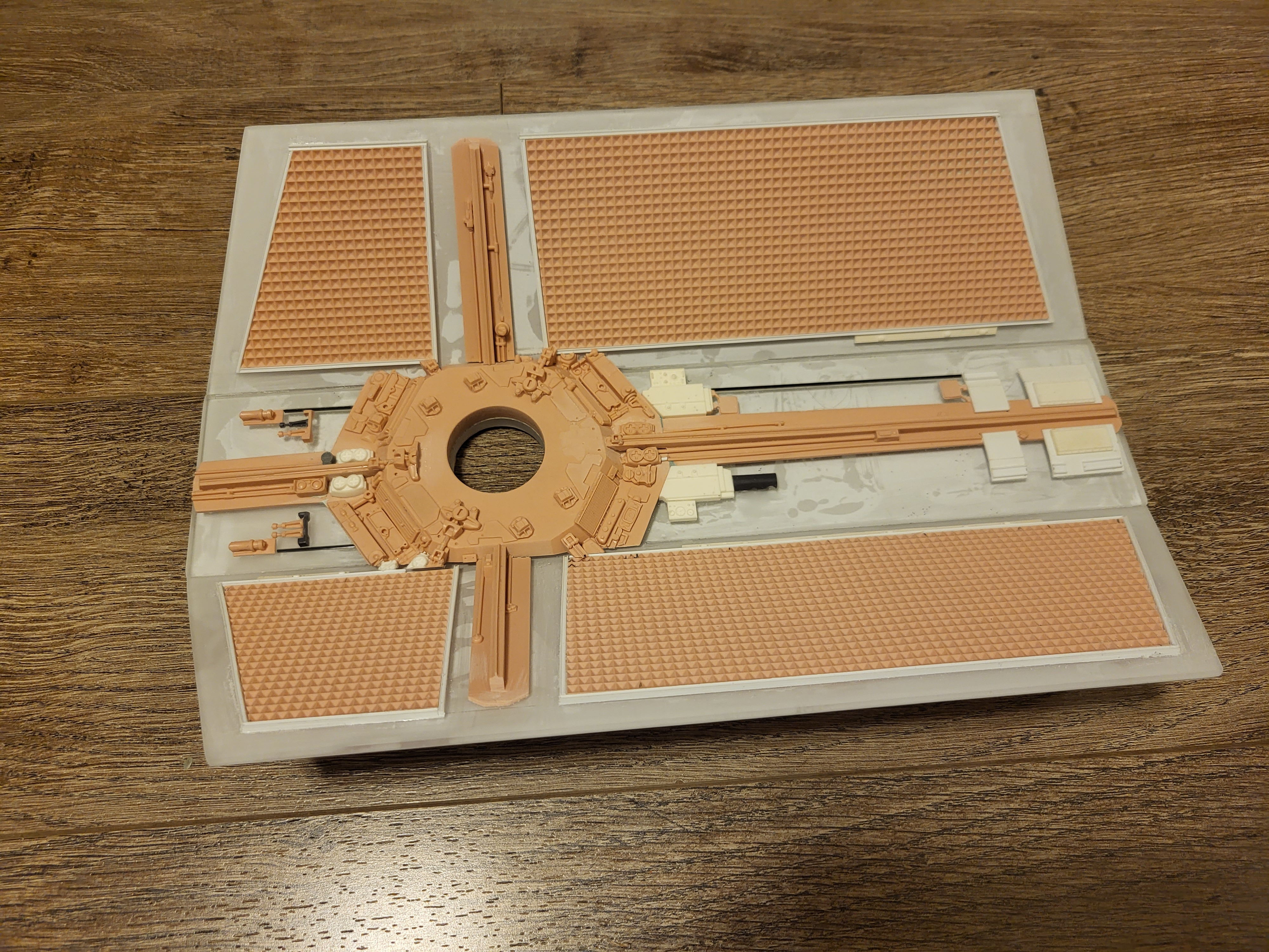

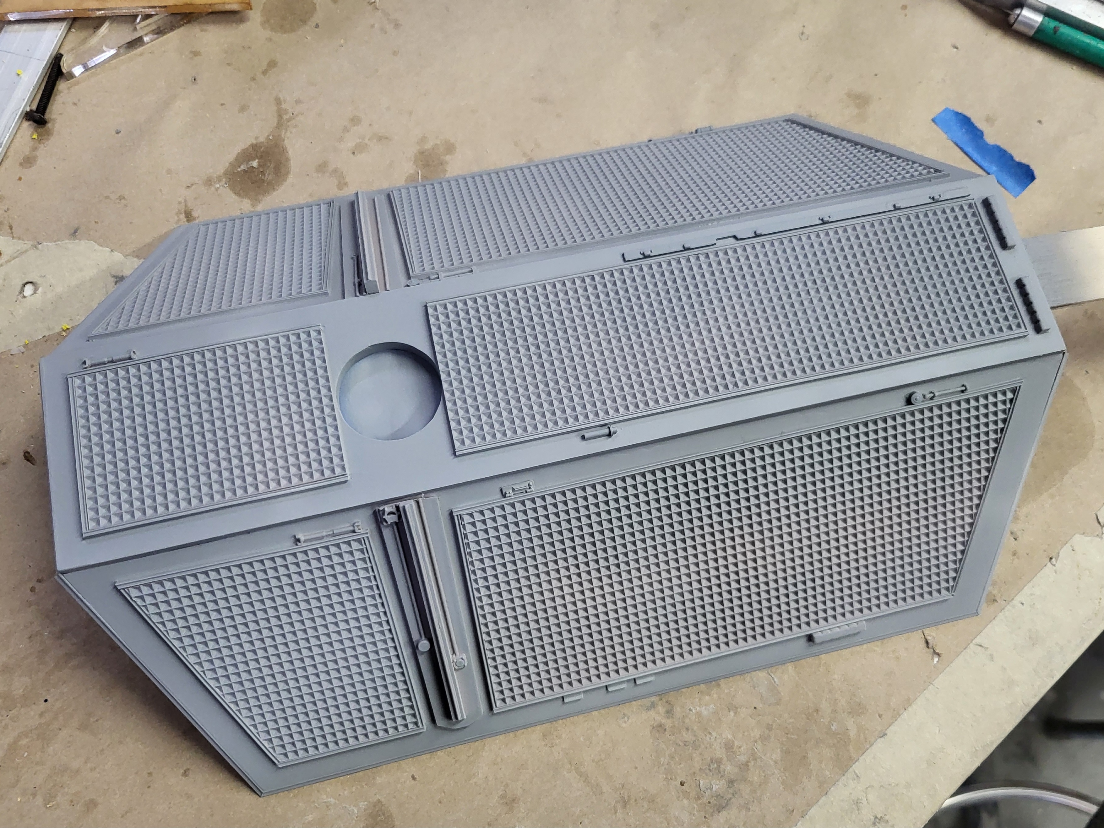

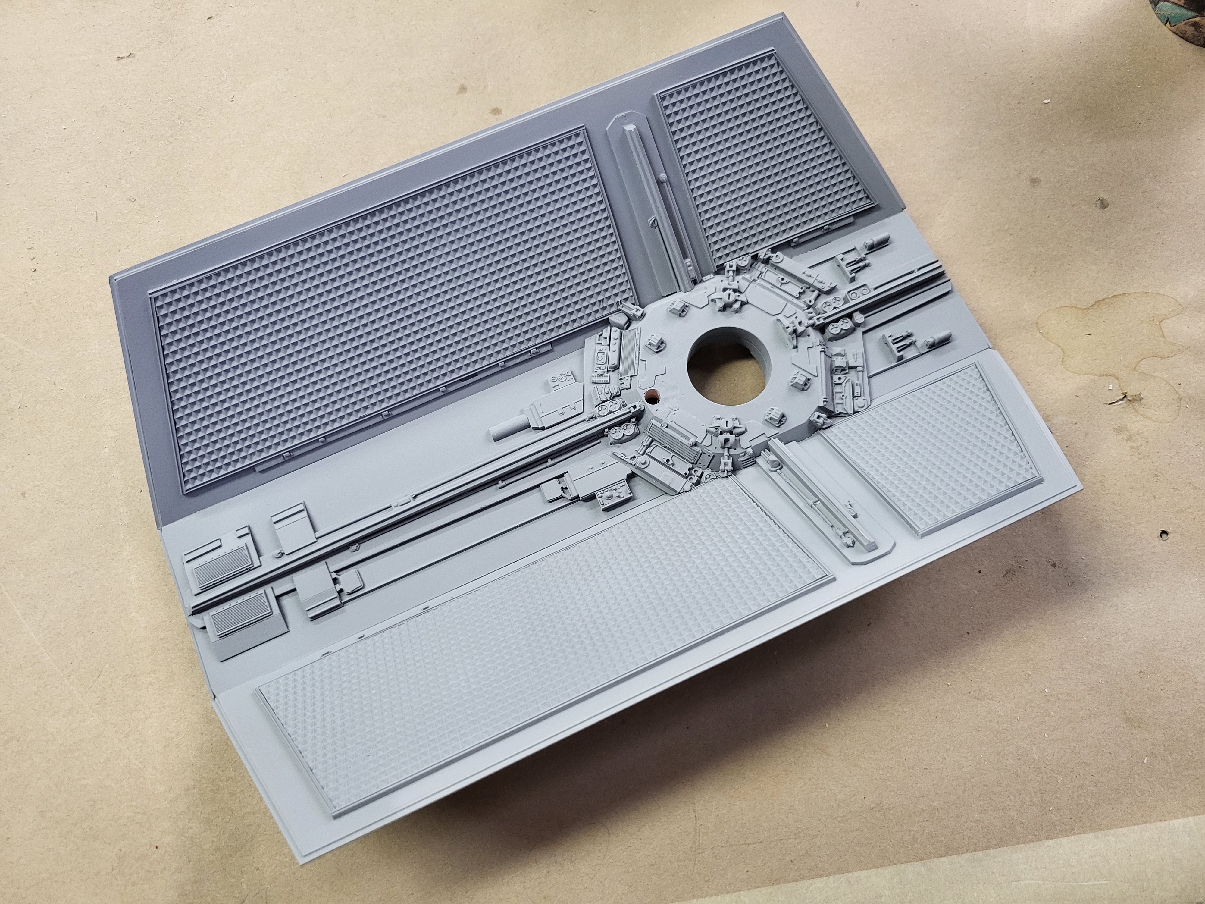

The first part I started with on this build that wasn't from my TIE Fighter project, was the wings.
I did a lot of work on the computer trying to figure out the dimensions of everything and laser cut the acrylic for the wings. I couldn't find any acrylic that wasn't metric, no matter what the acrylic shop said. After cutting and gluing the wing parts together I compensated for the incorrect acrylic thickness with .015 and .02 sheet styrene.
Next was cutting up TIE wing stars for the interior central detail piece and exterior and interior vertical ribs. After that I glued on the Panther G parts and sheet styrene.
I could never find the correct light diffusion for the solar panels, so I modeled them in Rhino and printed them. I printed one master big enough for the largest of the solar panels (most of the panels are different sizes from inside to outside and from one wing to the other.) I then molded the master and cast all the solar panels, trimming each one to the correct size.

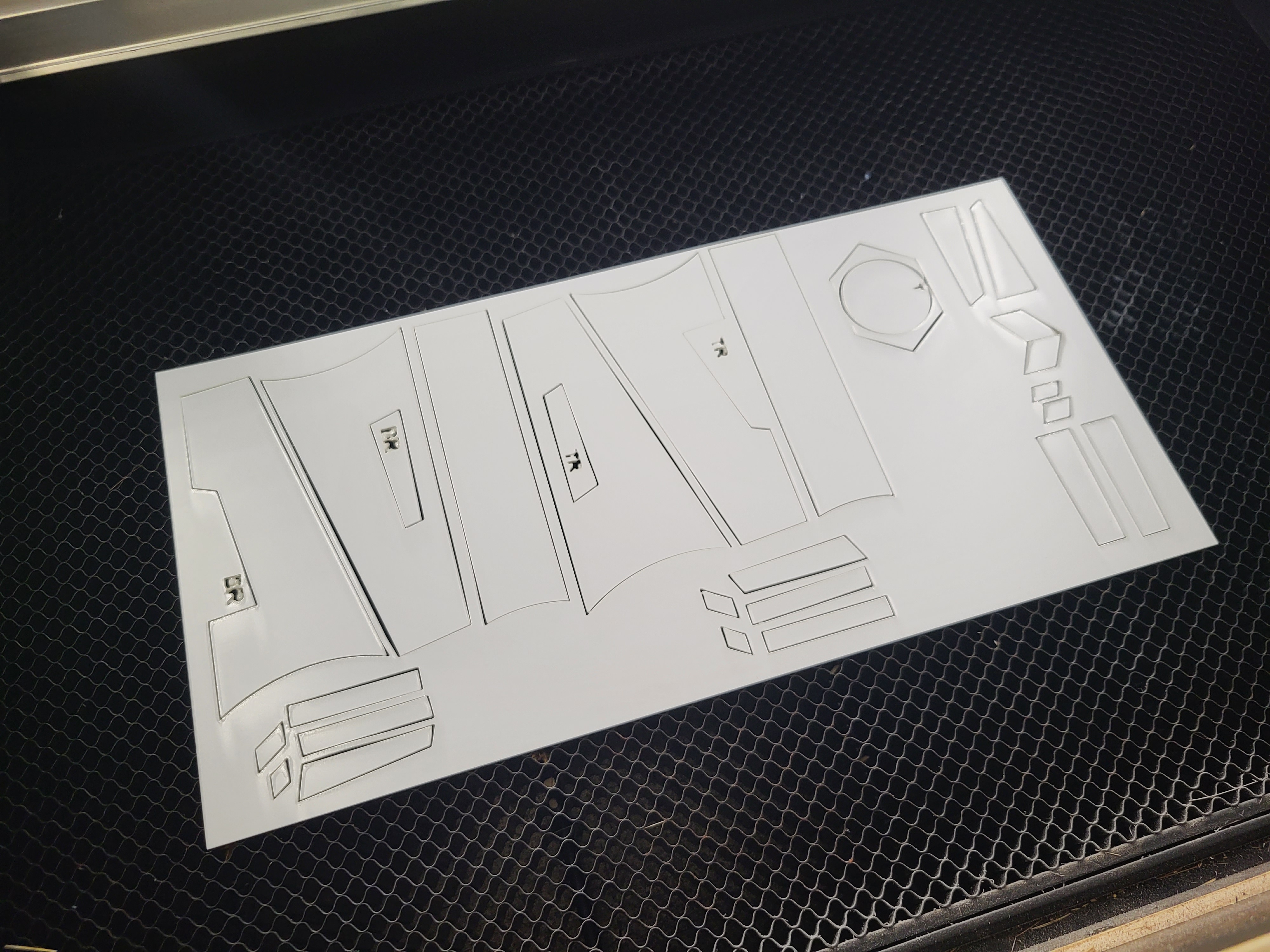

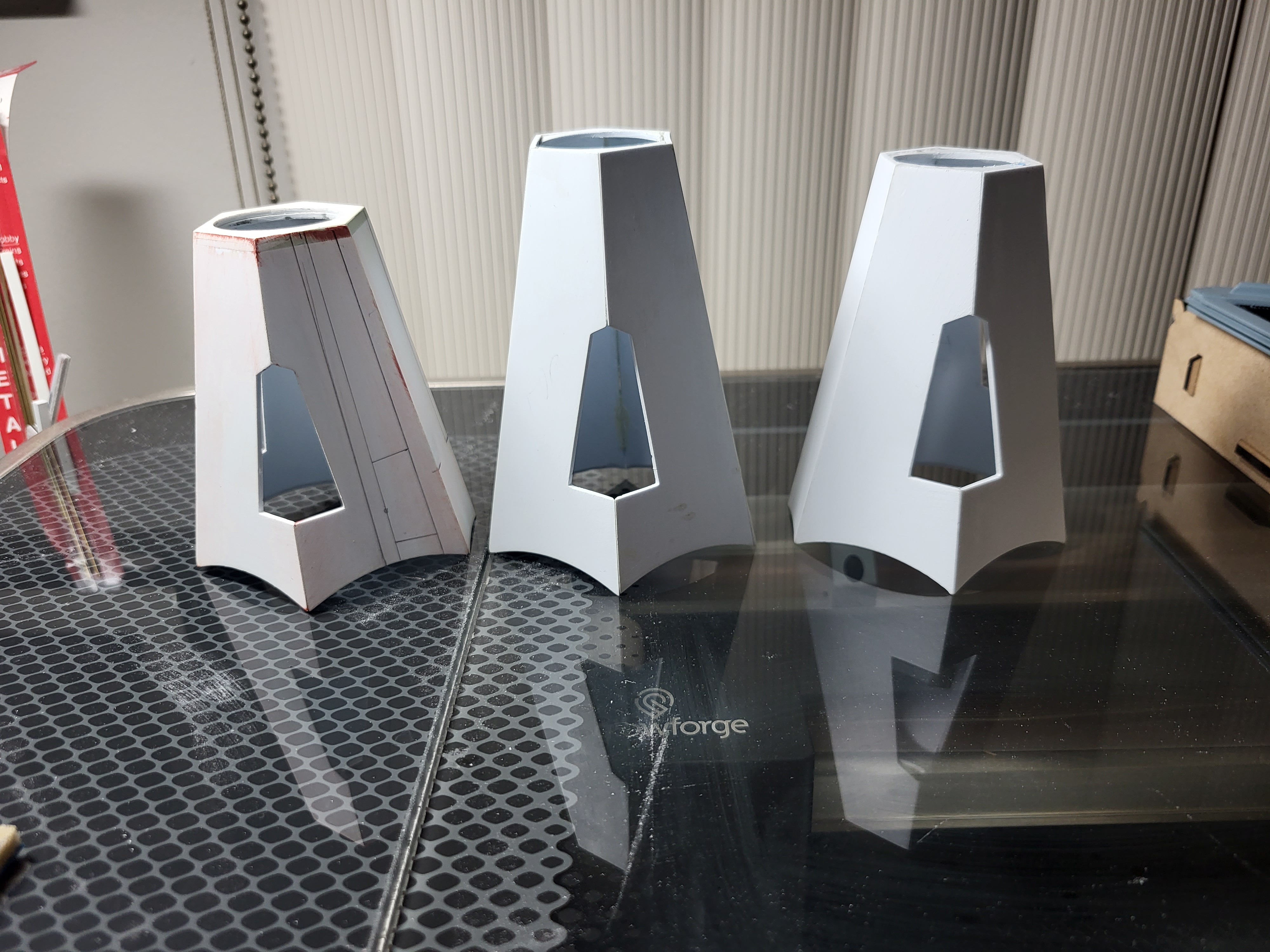

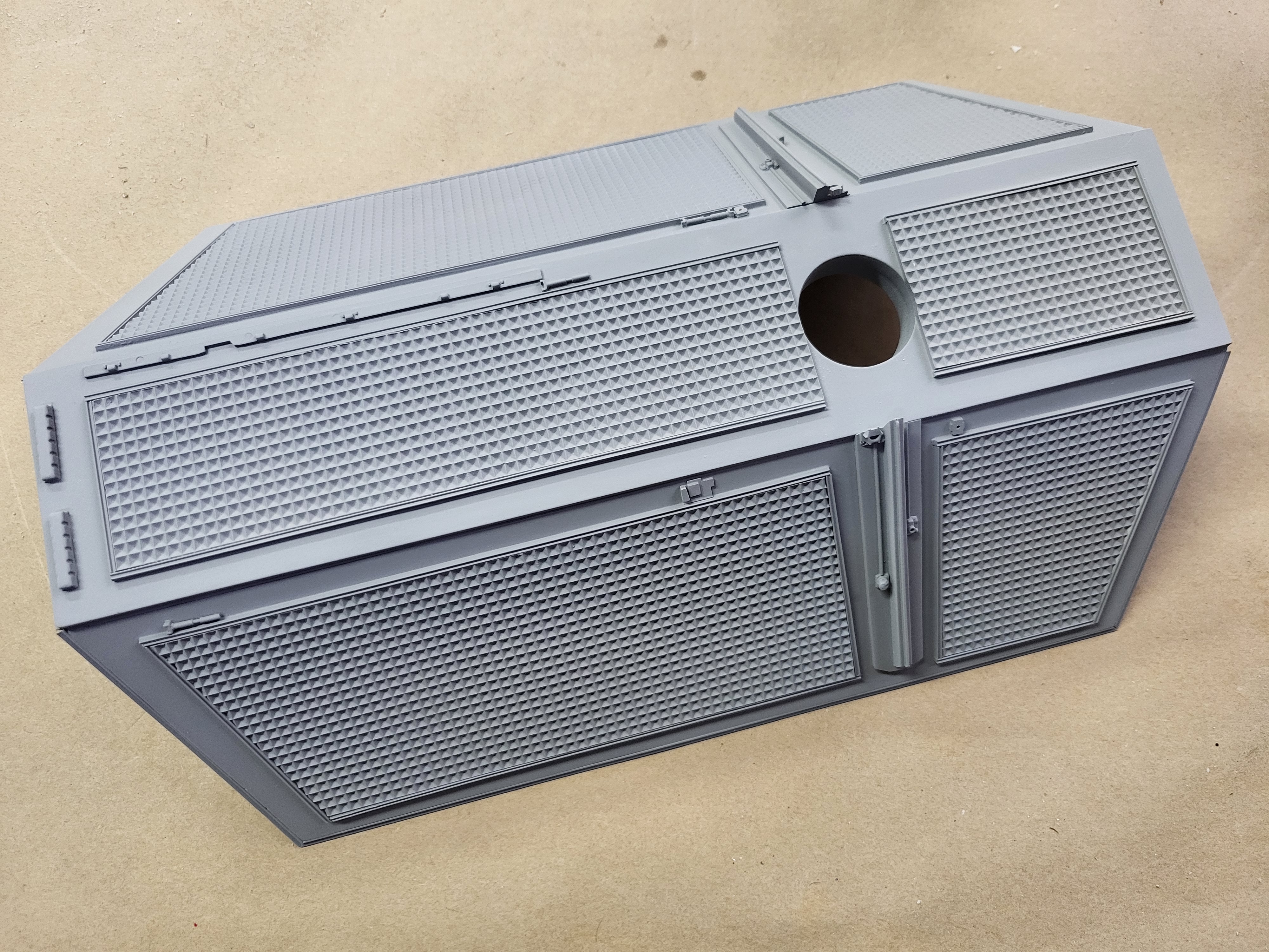

Next was the pylons (or what I call pylons). Again, I modeled these in Rhino and laser cut the parts out of .03" styrene. As with most of my builds, it took me three tries to get them (what I hope is) right.
View attachment 1774000View attachment 1774001
View attachment 1774002View attachment 1774003

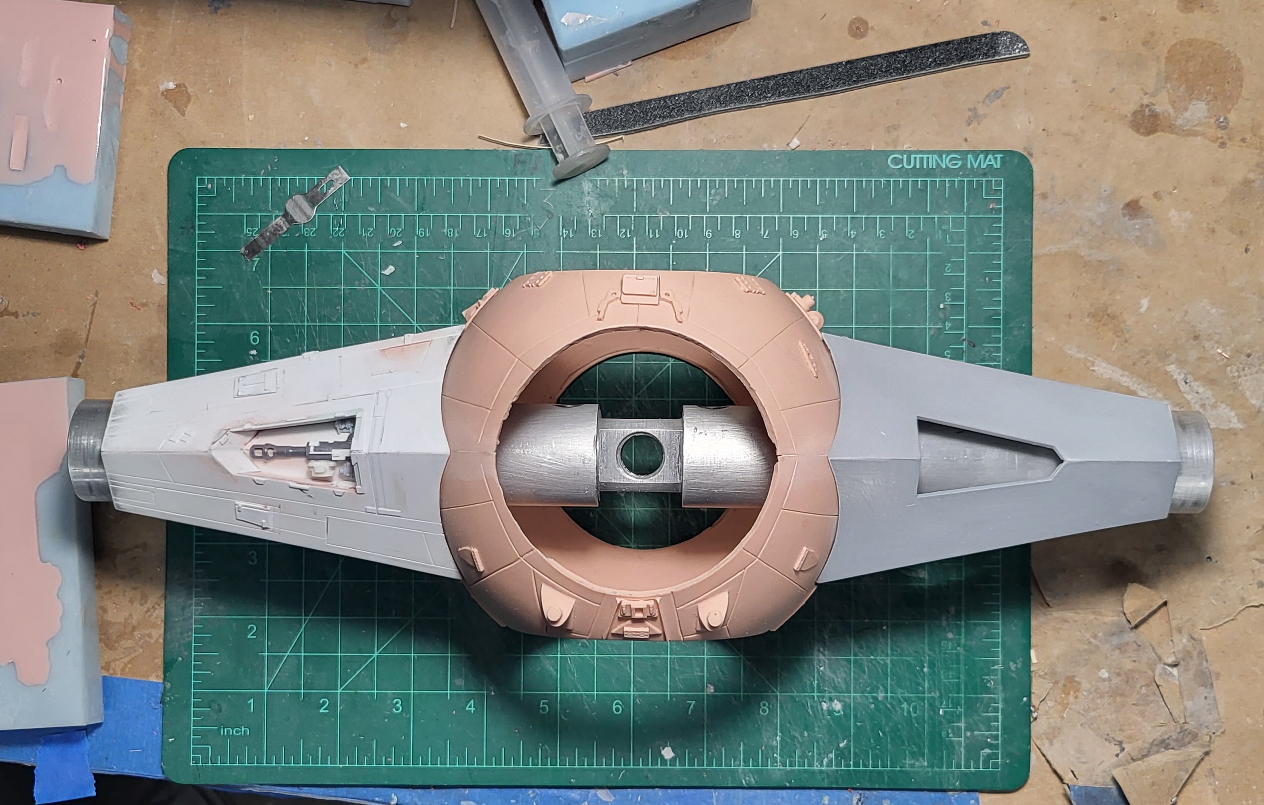

This is where it stands now. Most of the parts are just on temporarily.
View attachment 1774004View attachment 1774005View attachment 1774006
