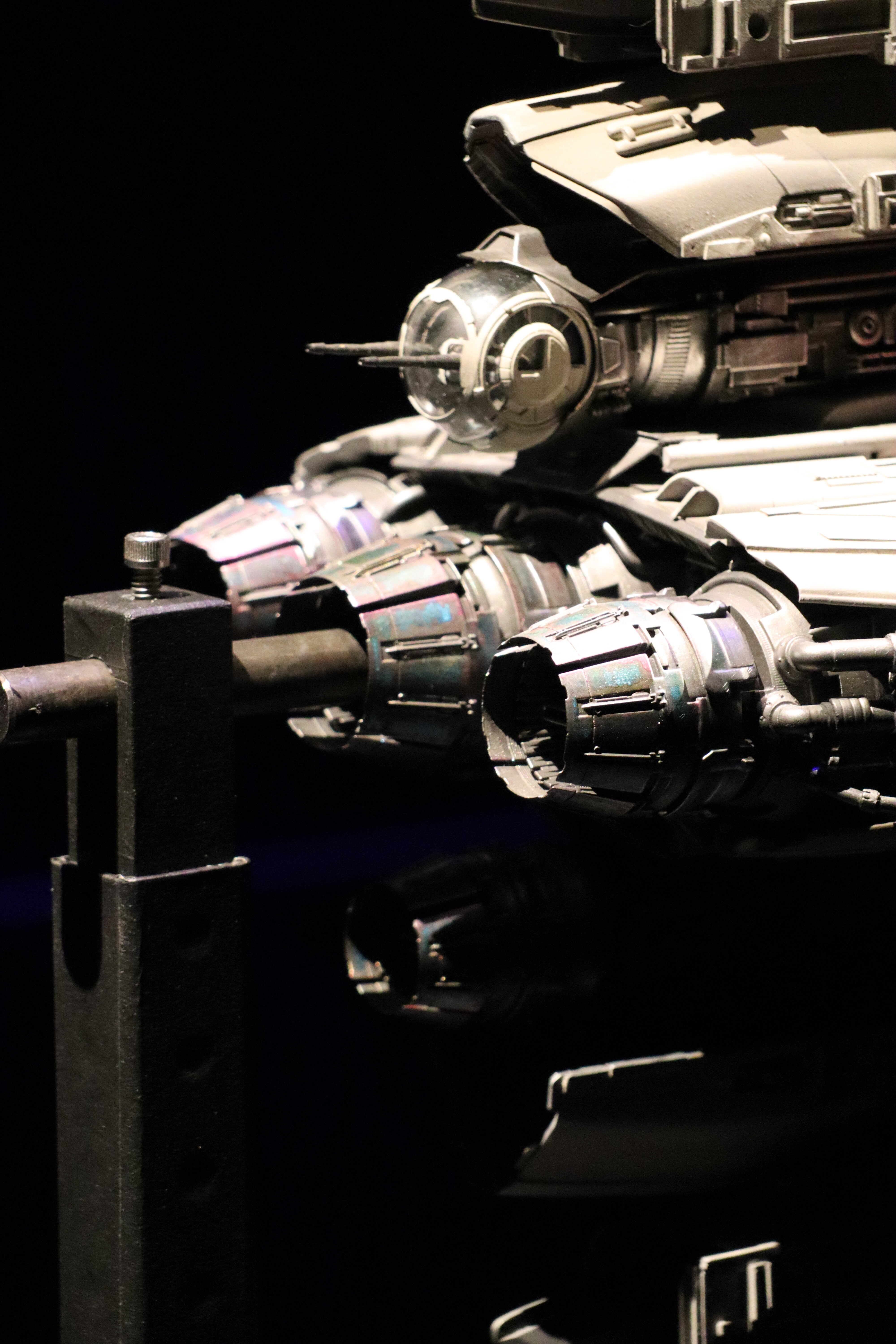

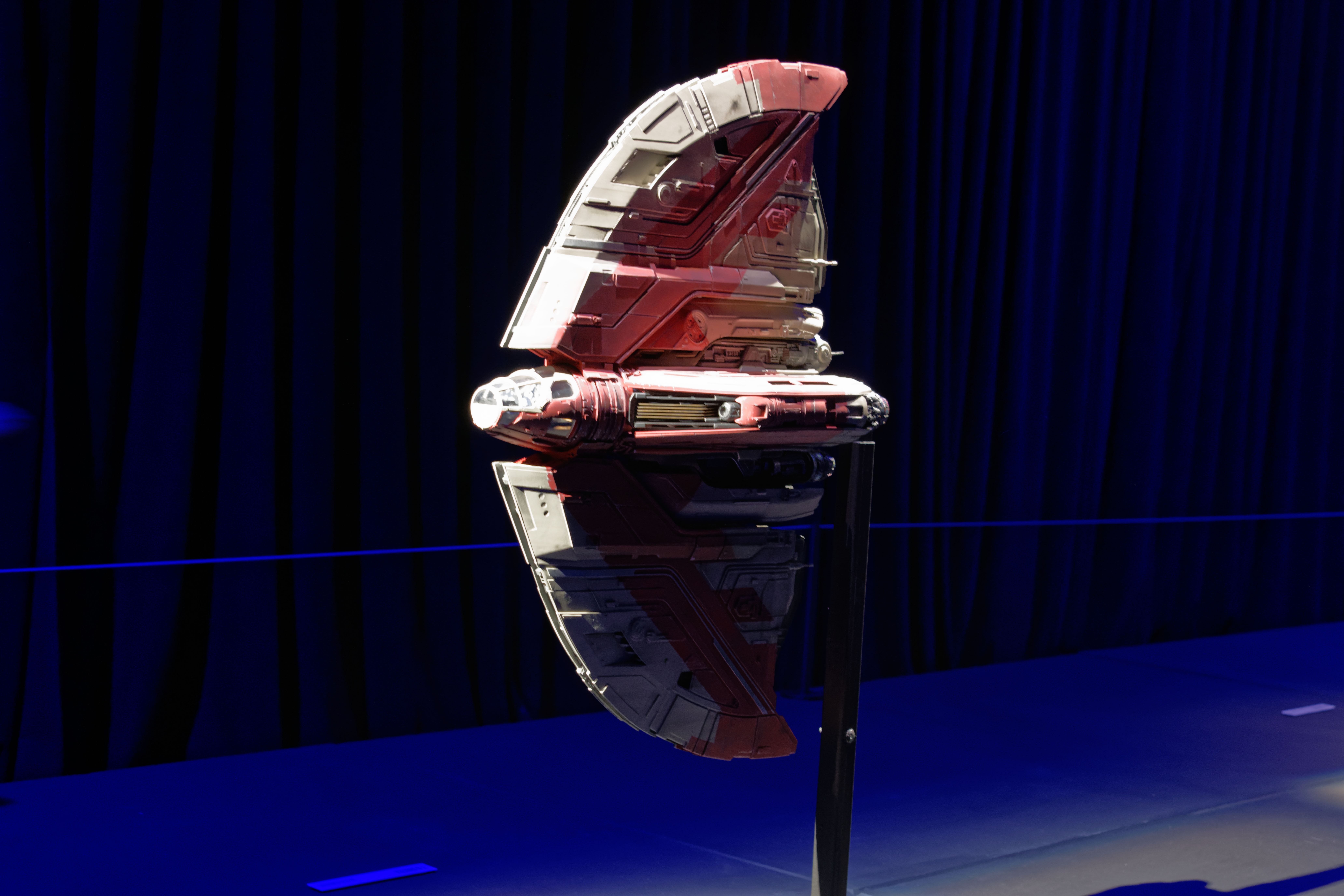

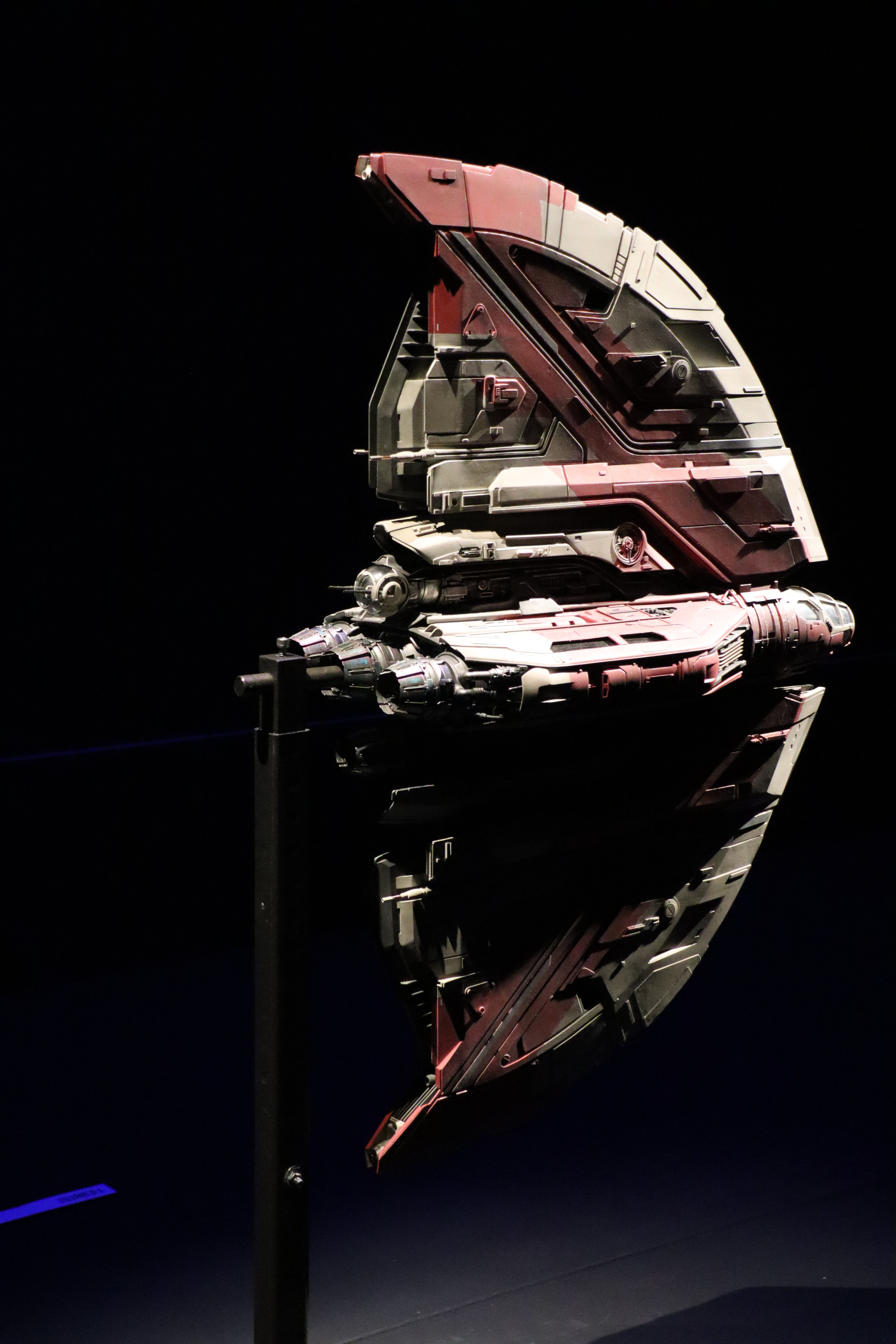

I'd also like to tackle 3D modeling the T-6 Jedi Ambassador shuttle shown at the Mando Experience using 3Ds Max. I have a lot of nice reference images I found on the Dented Helmet forum:
