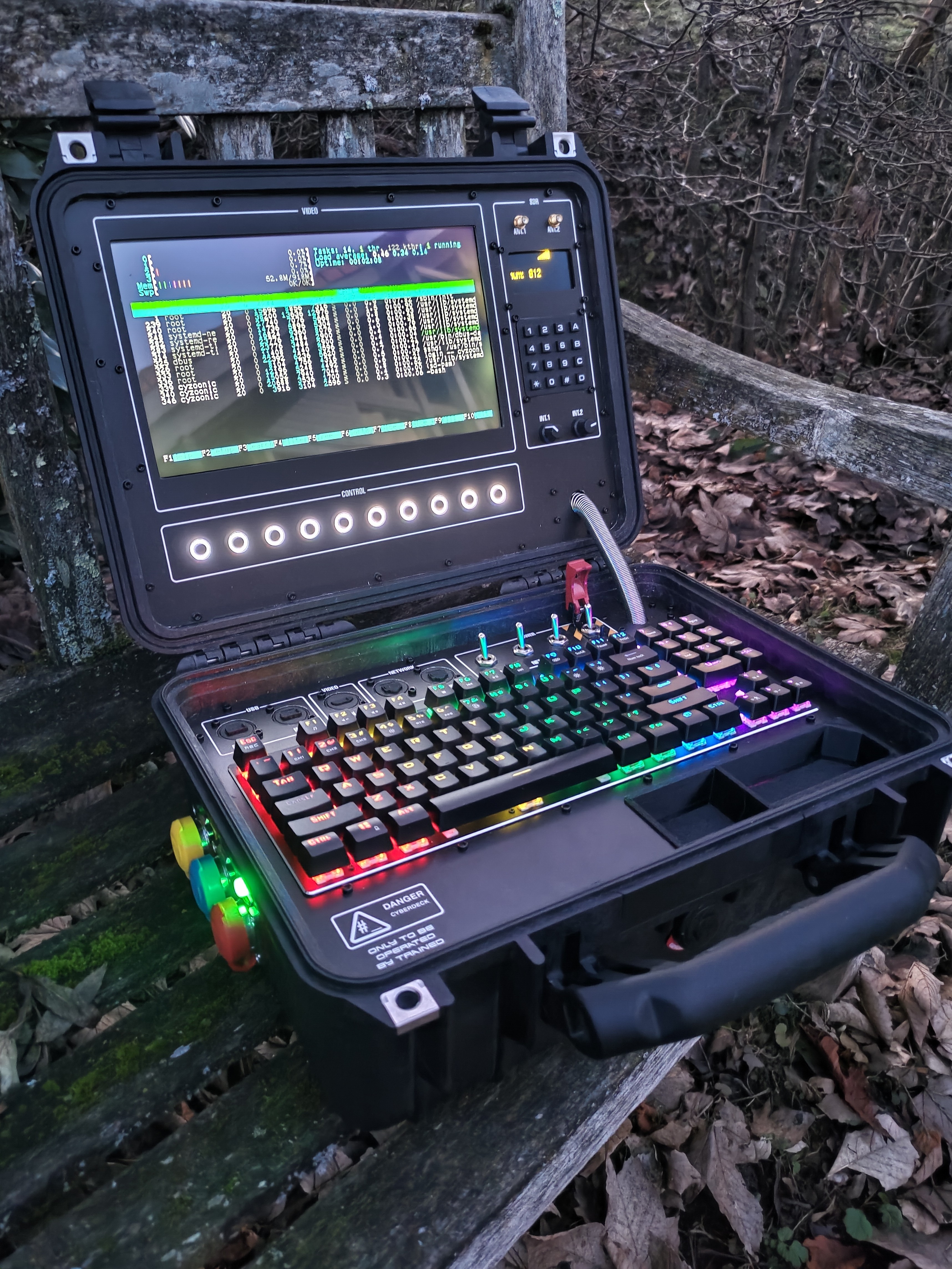

Sorry for not posting for so long. I got side tracked and build this (not a prop but movie inspired). I got some new PCBs for this project, a new 3d printer and I hope to continue now that my other project is done.
That’s what a laptop should look like.
