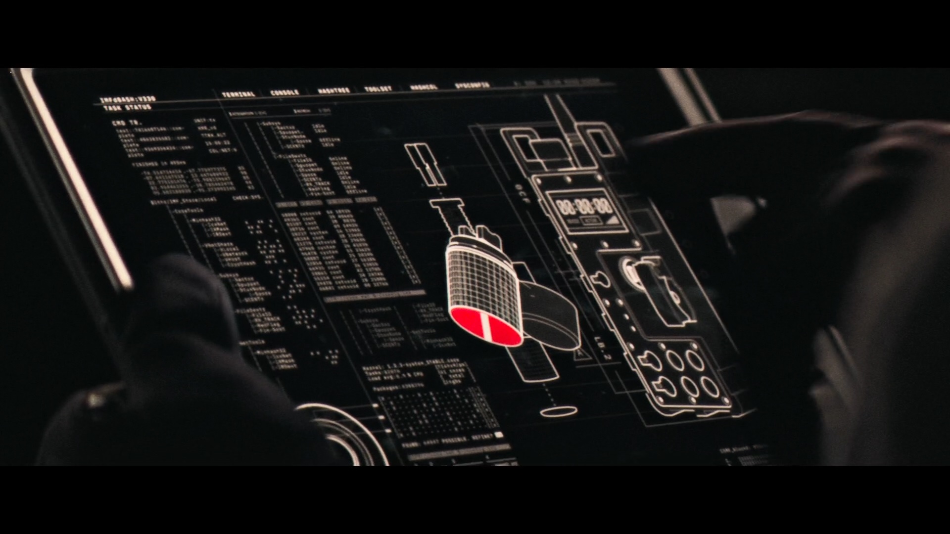

Great work, everyone! Has anyone had any luck identifying the firing key? I've scoured the internet, but haven't had any luck. We know it is knurled, has a red inside with two oddly-shaped prongs, and it has a lid. Any ideas for where it could have come from?
View attachment 942374 View attachment 942375
I've tried everything from circuit breakers, kill switches, battery isolators. I'll let you know the second I find something, but it may be a scratch built component, I don't know.
Yeah, I originally thought it was a scratch built component. But the more that I look at it, the more that I think that it was at least based on an existing part. Especially considering the part has a red interior with small screws (?) opposite the protruding contacts.
Looks like it could be a military / aviation waterproof connector without a cable attached and the end cut short. They usually have a cap of some sort and come with many different pin configurations.
Something like this: GX16 Waterproof Aviation Connector Plug Socket Sensor Encoder 2/3/4/5/6 Pin New JUL10 dropship-in Connectors from Lights & Lighting on Aliexpress.com | Alibaba Group
I agree. This is what I was leaning towards as well. Do we have an approximate outer diameter of the connector? This might help us narrow it down a bit.
I've also never seen this oddly-shaped 2-pin configuration either. I've been searching and haven't found anything remotely similar.
In my model the outer diameter is 16.5mm but I did size up the model slightly for the LCD so something like 15-16mm could be the actual size.
I think the key may be custom. I went through hundreds of items at Enabling The Electronics Revolution | Amphenol and other places. I can't find anything that matches, especially odd is that rectangular pins as it seems an odd choice for any connector to not use round or square pins.
