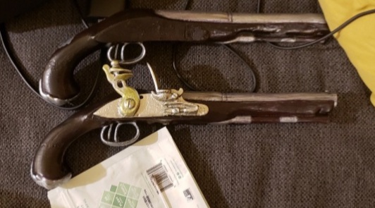

5) Pistols continued - I have painted my pistols black as a base color. This way the hard to reach spots will be shadowed instead of glowing white. I need to get a few minutes in watching my intended pose scene, again, to get a grasp of the dark brown stain on the pistols. I have found that making the dark color first and going over it with the lighter color is so much easier to control versus trying to add a dark "undertone" over a lighter base. Trying to paint over a white pla 3d print makes everything too light so I am covering the entire print.

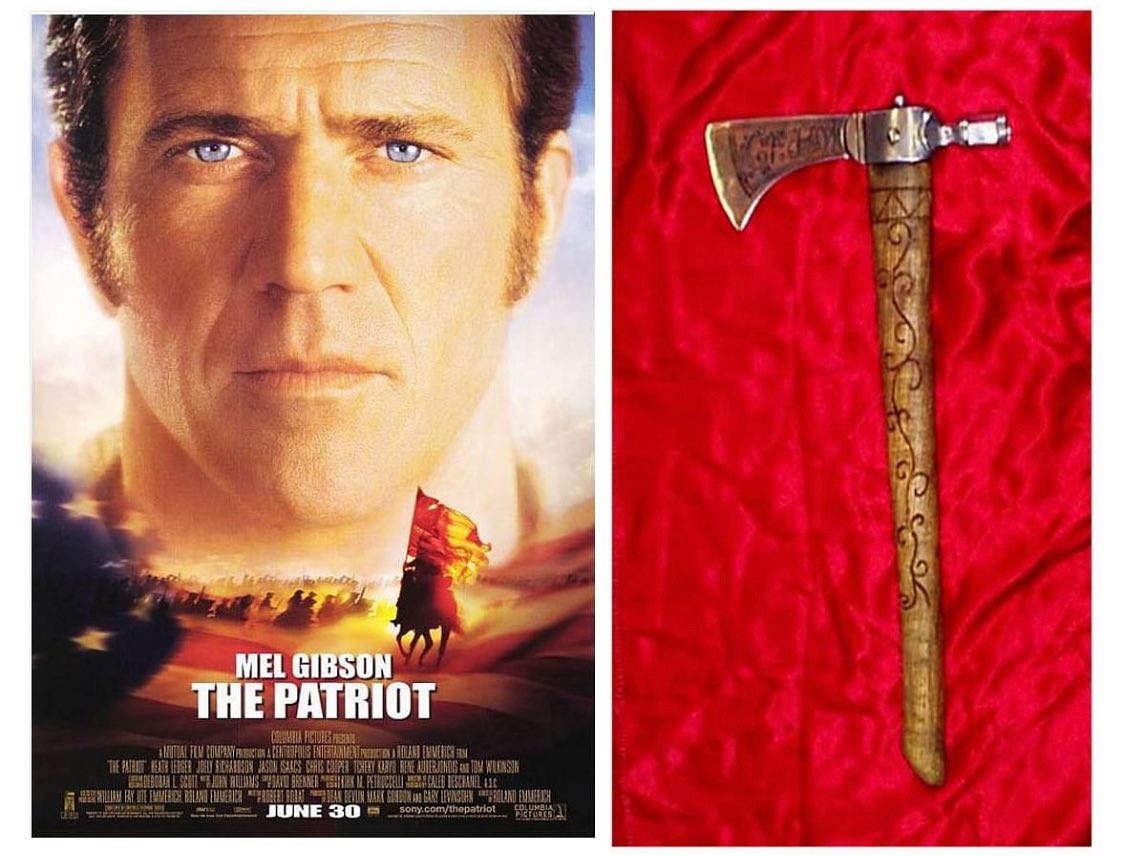

Would you mind sharing the Auction pics of the Tomohawk? My plan is to get the image cut in vinyl, line it up with existing engraving on my casting, hit it with a few layers of primer then remove the vinyl hopefully restoring a pretty accurate representation of the engraving.

let me dig, I started looking the moment I mentioned it but am having a heck of a time finding the other side. I promise I will load it up, just too many photos saved.
Well carp. My first try was a bust. Worthpoint had some great photos but they are currently hacked, virus popups within the first few screens.

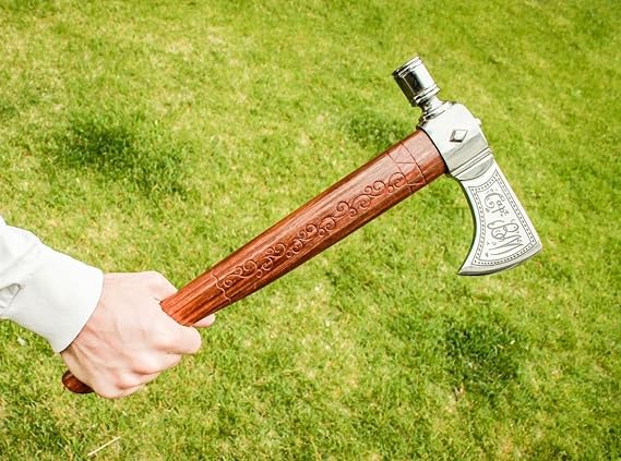

OK, still working on this but wow what an interesting day. So, Worthpoint has been hacked and just a few pages in it will begin to do the fake you have a virus blabla, to which you just close your browser. That sucks because it had great images of a couple tomahawks. Then I go online to find that the only current "other side" pictures of the tomahawk are the poorly done but clearly stamped Amazon replicas which are vomit for accuracy.

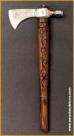

However, there was this link to Sword and Stone, Tony Swatton about making duplicates for sale..... which would be ludicrous to have anything Tony makes. I checked on a couple swordandstone url and found most to be broken and likely not even his. Then I found a tonyswatton page that was him and was clearly their main homepage but no tom. So I tried a few of the links from the facebook page.... I have no facebook account so this was very limited and I could see only the one picture of the tom, obviously the right one from the movie (you can see from the distance from blade edge to the etching is much bigger than the replicas...sigh). I tried the link on that "about" section and hit another dead link. So I thought, well, I could call their office and report the dead links and maybe get a leg up on asking about the images...... Tony answers his own company phone..... I flailed, I fanboy'd, I tried for recovery and now will need to hope he doesn't have really good caller ID heheheheh. Seriously dude, you need a secretary so all the fanbase doesn't go llalalalalal when you answer the company phone. So, my search continues because Tony, who is currently in possession of the original, is extremely busy and although exceptionally polite, is booked for the foreseeable future. And is likely now a little more cautious about answering the front desk phone.
So for now, sapper36 , you will want to grab that image from Tony Swatton's facebook page showing the one face. You could trust the Amazon other face but just render it down to the correct size. I can help with the amazon one but the facebook one is out of reach for me as I don't intend to let facebook video tape my face for AI recreations.
Not the greatest straight on 90 degrees collection but here are view from both sides. It sounds like many have been made in replica form and not to exact or even near exact specs. I find that many replicas make use of warehouse stock to make a "we had this material on hand" version that does nothing to simulate the original. Any of these marked Swatton are good to go, but the replicas, I would only use those for the reverse face pattern and sized to match the front.

5) Pistols continued - A little more paint and weathering done but haven't attached the locks yet. I still have hopes of getting more believable textures.
Looking good:cool::cool:...you will attach the piece of flint in the jaw of the cock?
5) Pistols continued - Yes! I have some thin leather picked out and will wrap a flint chip for both pistols and mount in the clamps. I also am looking for some good single slot screws to mount the locks with traditionally placed fasteners. I just realized I have a bit more sanding and filling to do on the locks. My 3d print is showing through in the shelf lines.

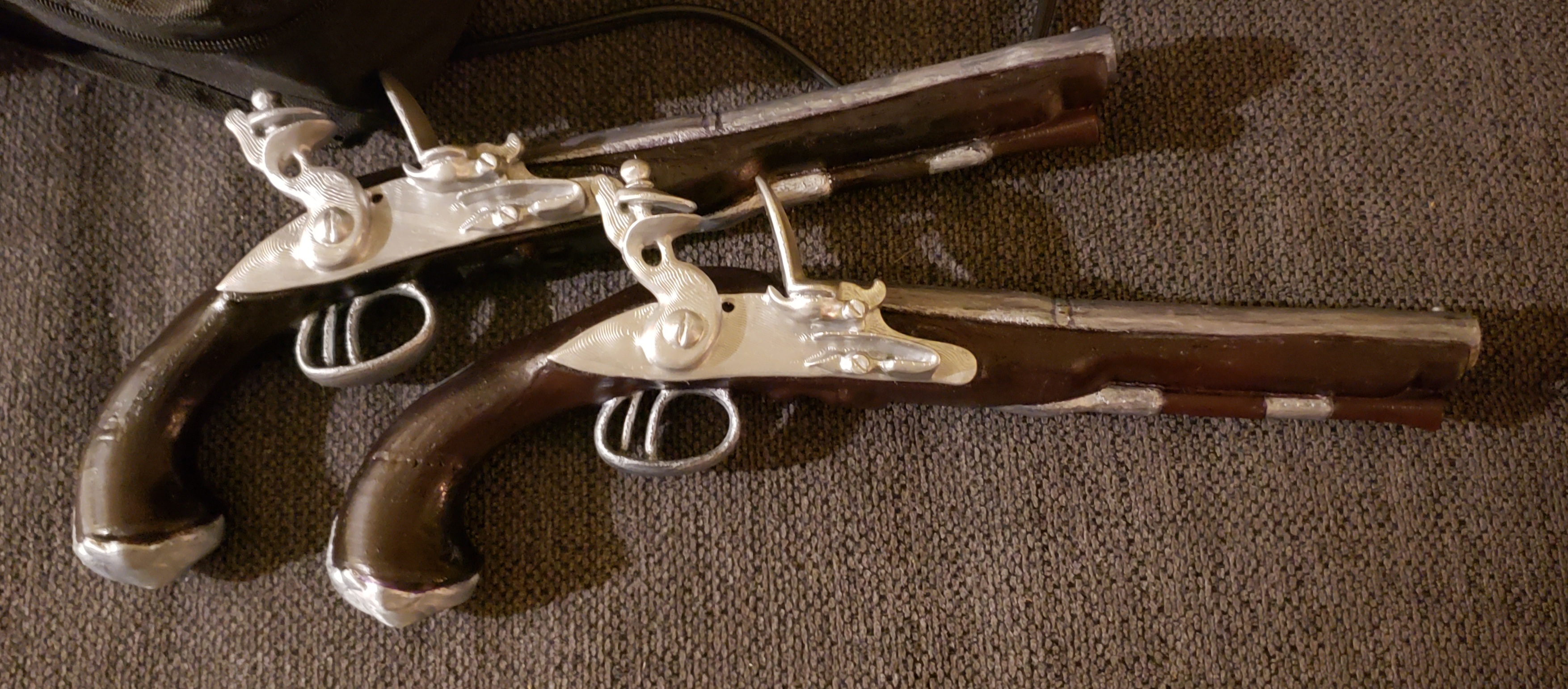

As fo the pistols, I am still refining the lock parts and getting paint colors corrected. Here is a side by side comparison that gives me hopw that I am almost done. Another silver top coat for sure but my brown is looking good.
Of course, any good comparison will need to be in full sun as the colors will change with the addition of UV.
5) Pistols continued - I had to heat and bend the locks to fix a 3d print warpage issue but is now corrected. I finished my aging and touchup so next is permanent attachment. Adding the flint will be last step:
