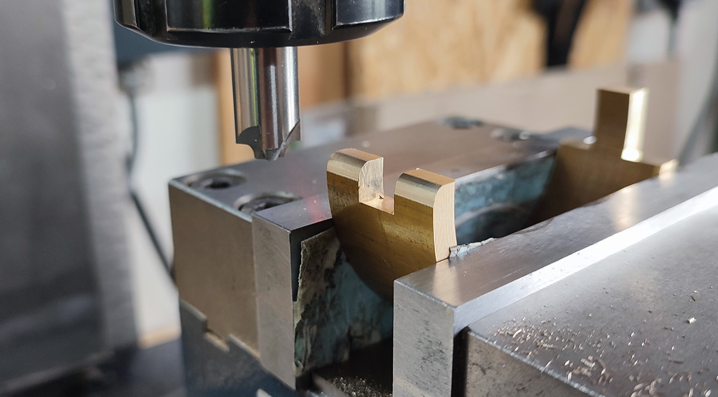

I have finished milling the mating flat spot on the sides of the Leia cuffs:

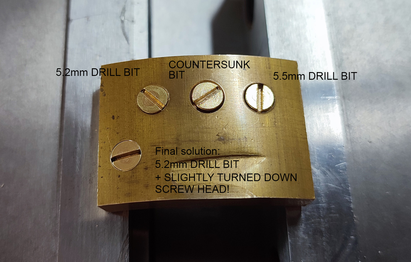

I tested several solutions/tools to get the cleanest countersunk screw heads to attache the cuffs together. Seems straightforward but the countersunk bit was too wide to get the screw to the proper depth and wasn't looking clean enough. Very happy with the final solution, 5.2mm drill bit, cleaned up screw head on the lathe to get a perfect mating of the hole and screw:
that gives a clean look I think :)
cheers

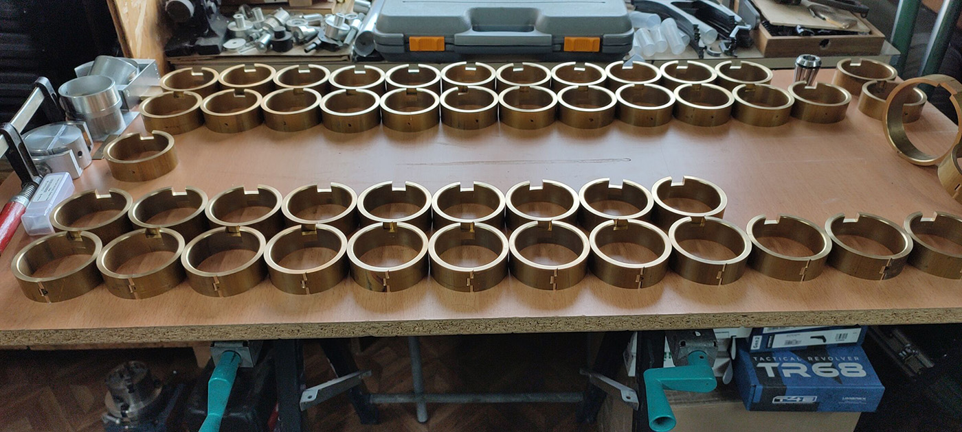

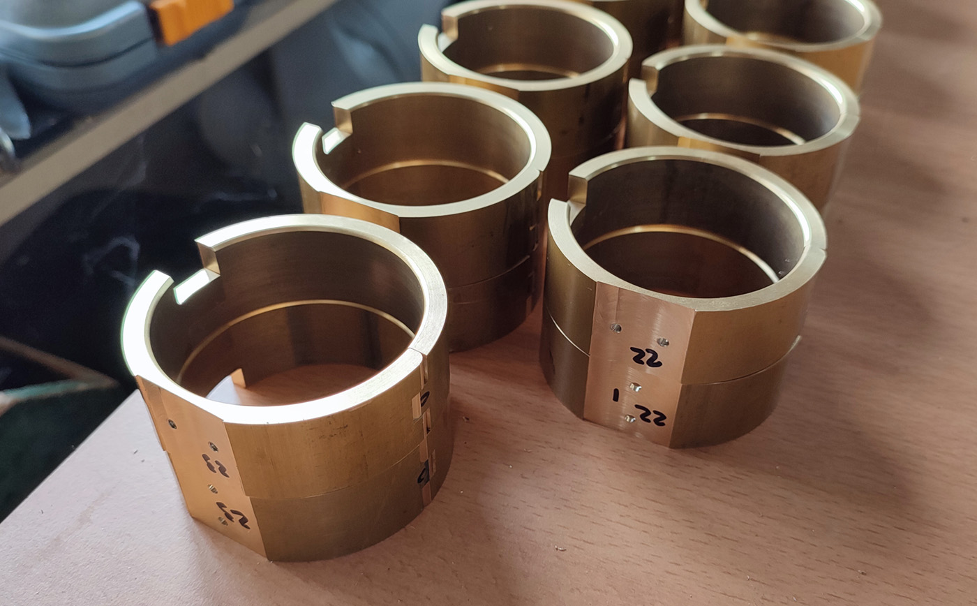

Hey guys,

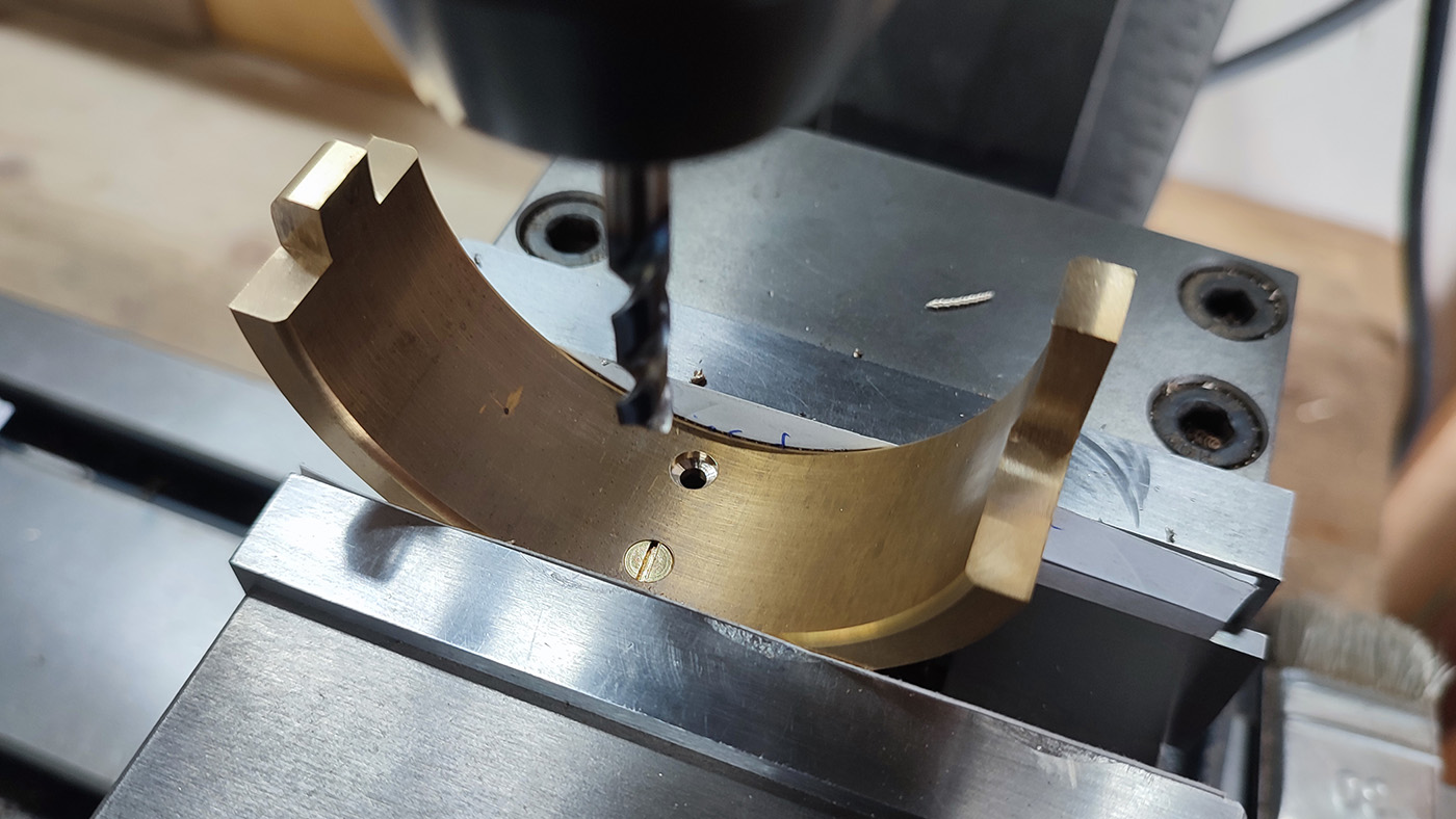

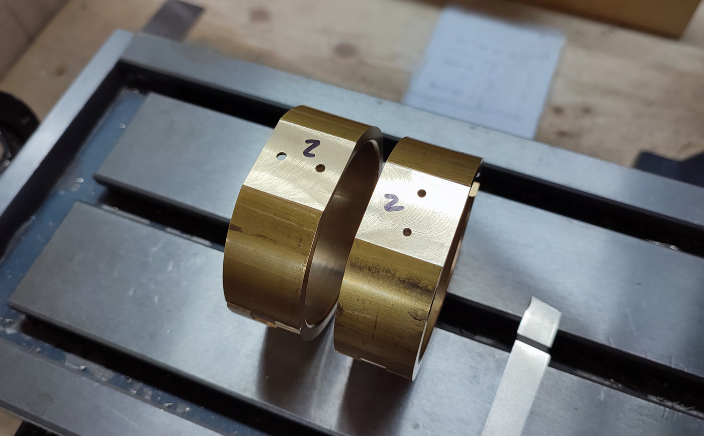

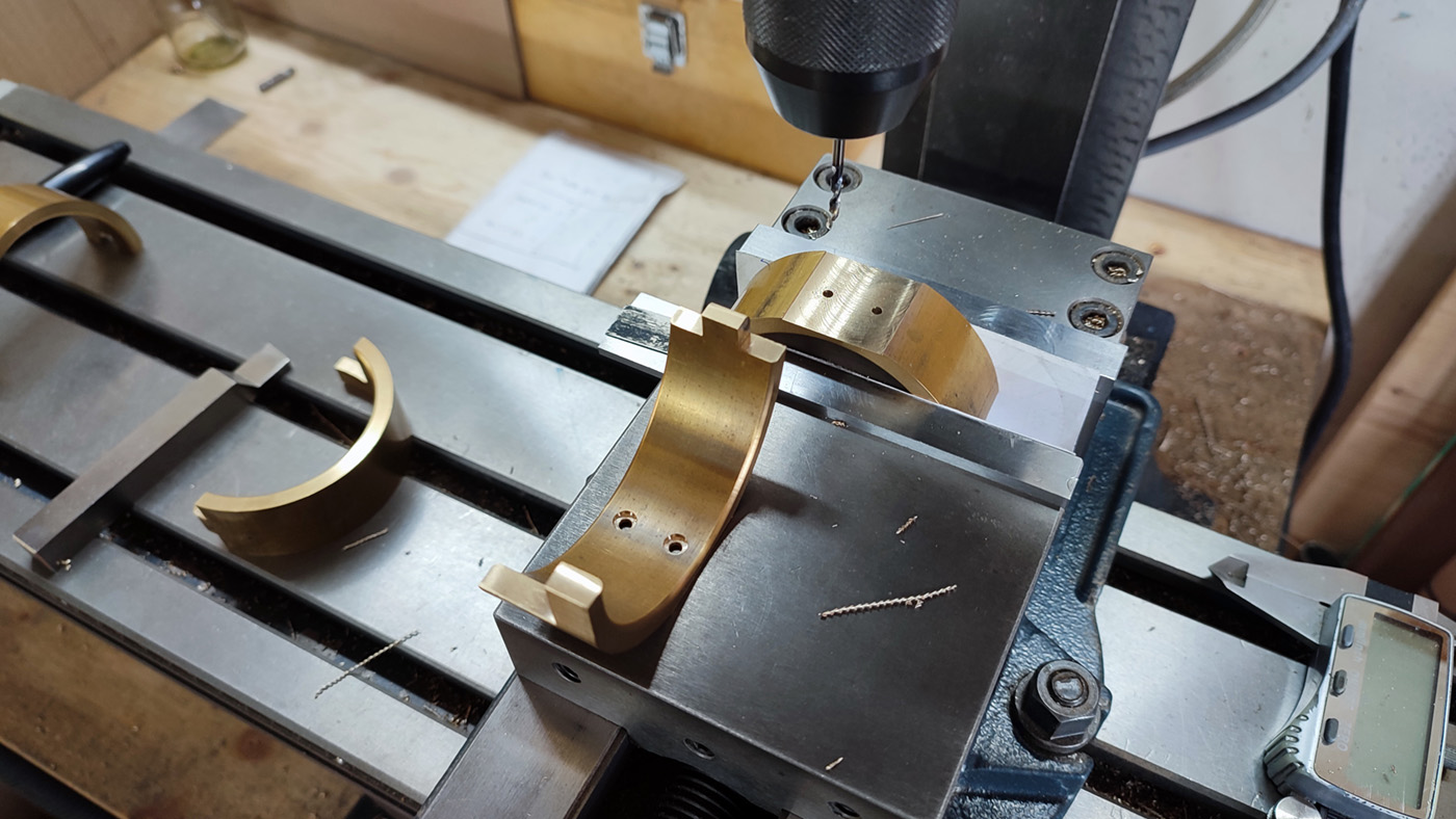

all holes are drilled and tapped, cuffs are now paired so the holes lined up perfectly for each pair.
time consuming step as each pair had to be test fitted, halves separated, drilled, tapped, put back together.
sorted by pairs now:

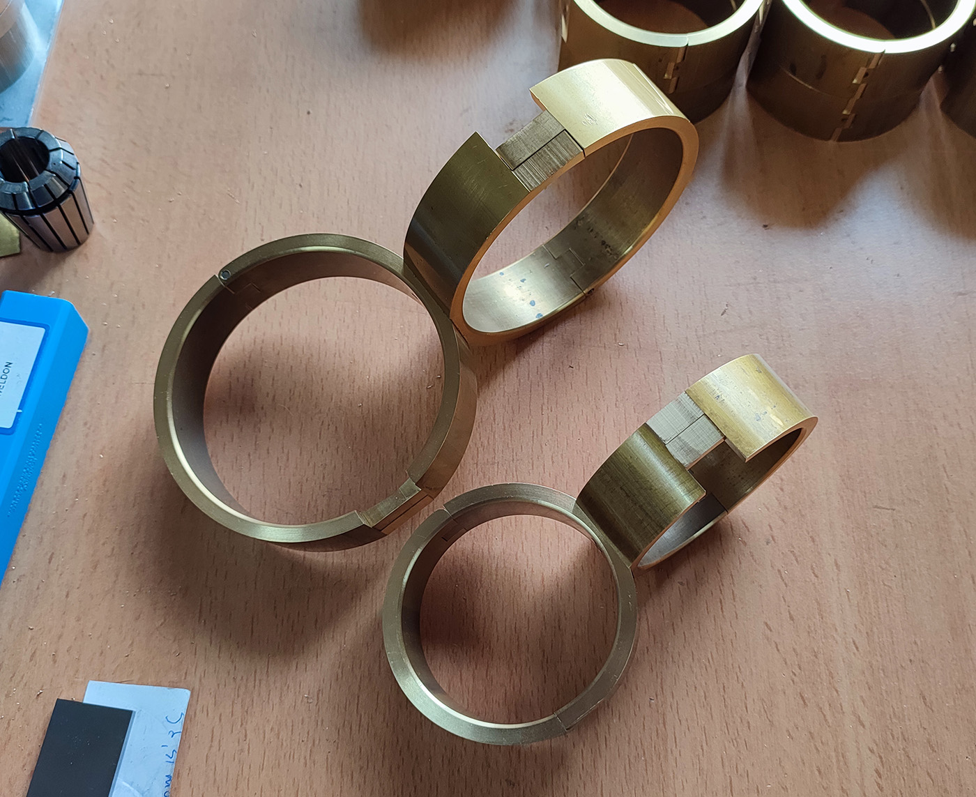

here is a quick mockup to show size difference between Chewie and Leia:
Yes, I have now tested and attached my wrists with the Leia size, couldn't resist ahah.

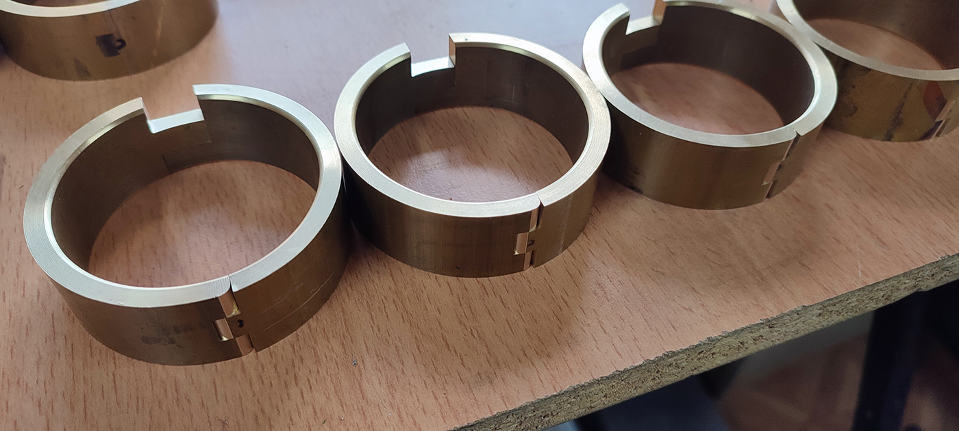

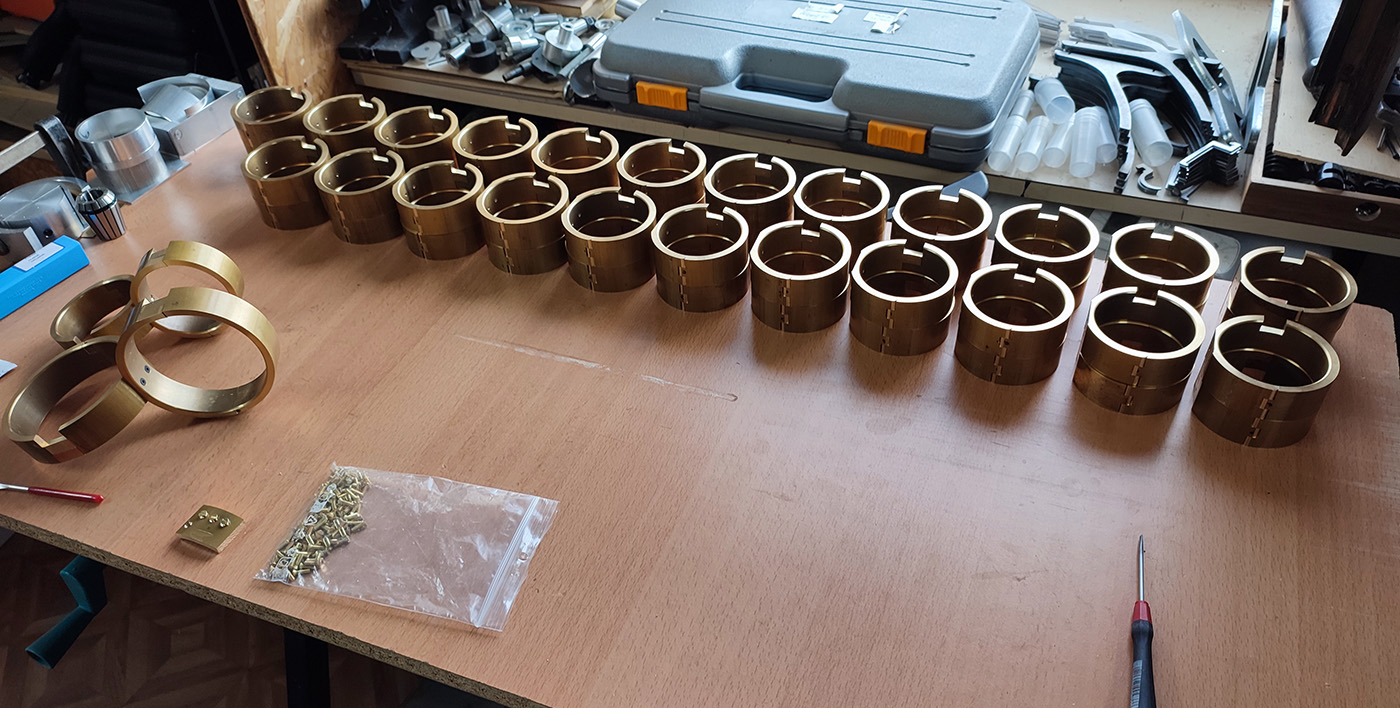

there was another long pass of clean up and adjusting in the past few days, metal is pretty much alive, so milling the flat spots changed the adjustment of the two halves on all the cuffs... I have now made the final fitting for all parts and they are ready for their hinges rods to be drilled and attached :)
first one is done, yes, you can fit some -relatively- manly wrists into the Leia size :lol:
I have bought a deburring/polishing tumbler that I hope to receive quickly and that I hope will help my work in the future. I will be doing some tests with this, I want to keep the patina, but if there was a way to smooth a bit all the edges that would be great. I will have to put a disclaimer for that run that any bedroom games with those props is not my responsibility and if any injuries occur, I won't be liable :lol:
I'm always keeping edges as clean as possible to get a clean precise look, but in this case, there are a lot of pointy edges, so I'll do my best to compromise between clean look and relatively blunt edges, but you guys will need to be carefull if playing with those for sure.
