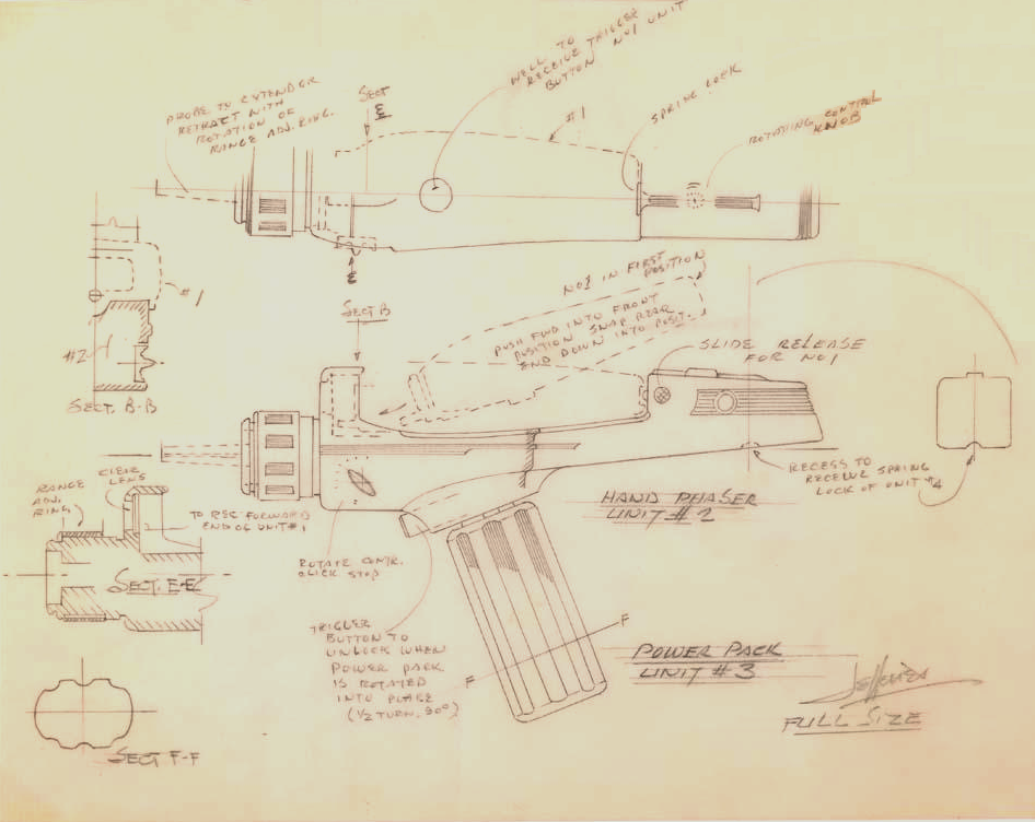

Funny enough, the inventory states that 4 "power packs" (the handles) were made "to make phaser #3" which was apparently the phaser rifle that never was. This bit of information seems to confirm the intent to at some point have a phaser rifle in the series.Wasn't one of the design requests that the original phaser be something like the Man from Uncle gun where it could be a pistol or add pieces and it could be a rifle, with clips etc...
They probably thought they were going to do a lot more with it before the series started but the stories just did not need it,

Yes it was designed so it could be expanded as needed.Wasn't one of the design requests that the original phaser be something like the Man from Uncle gun where it could be a pistol or add pieces and it could be a rifle, with clips etc...

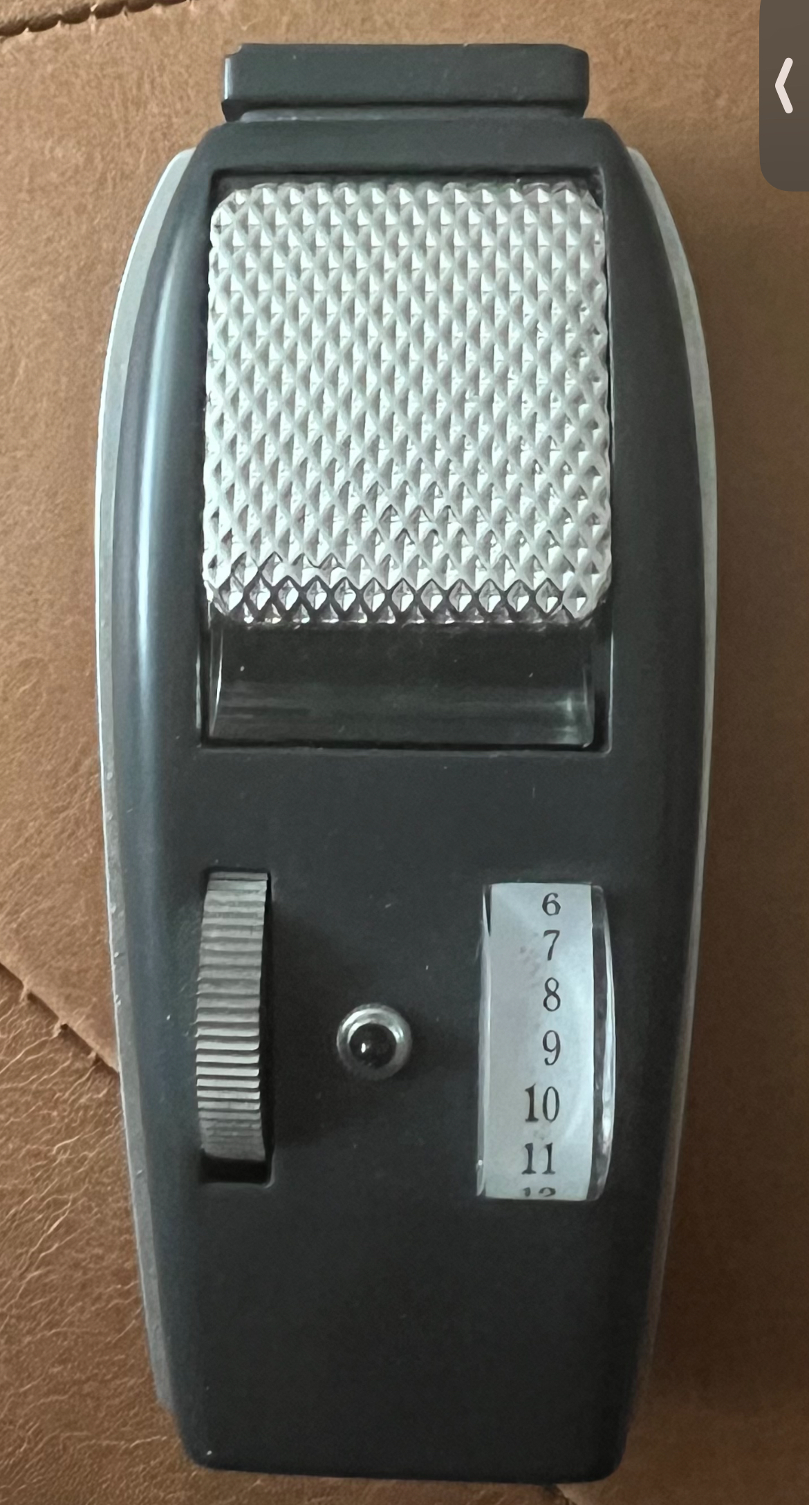

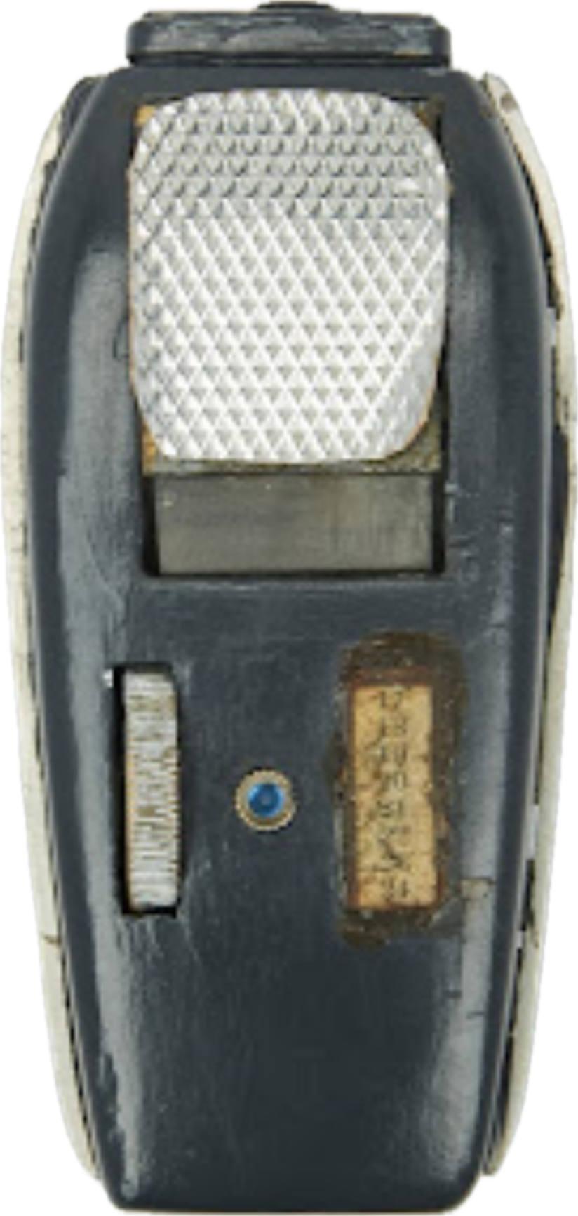

This is something I've always noticed. Still, Long's are excellent. There are some noticable differences in the hero P1's though- so there IS some wiggle room there....Looking at one of my JLong builds (this one by Robn1) compared to the Finney / MOST Phaser I, I can see that one of the details that are “off” on the JLong kit is the width of the site and site cover…these parts now look very oversized, compared to the original, to my eye. The thumbwheel and acrylic half round “power meter” also appears to be set too far away from the acrylic site on the JLong.
Still, despite these issues, I love my JLong kit phasers (even the shattered one in parts in a bag):
J.Long's Phaser 1's are known to be flawed as they are simply too long and part of the shape is incorrect. ....This is something I've always noticed. Still, Long's are excellent. There are some noticable differences in the hero P1's though- so there IS some wiggle room there....

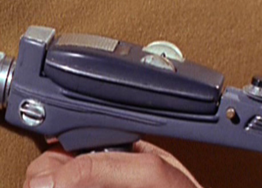

It has an additional screw on the back bottom and the emitter is strangely short along with the painted P1 release. Seems like this was the pathfinder. Also, it's in the early promo photos with Shatner so it may have been the first finished.

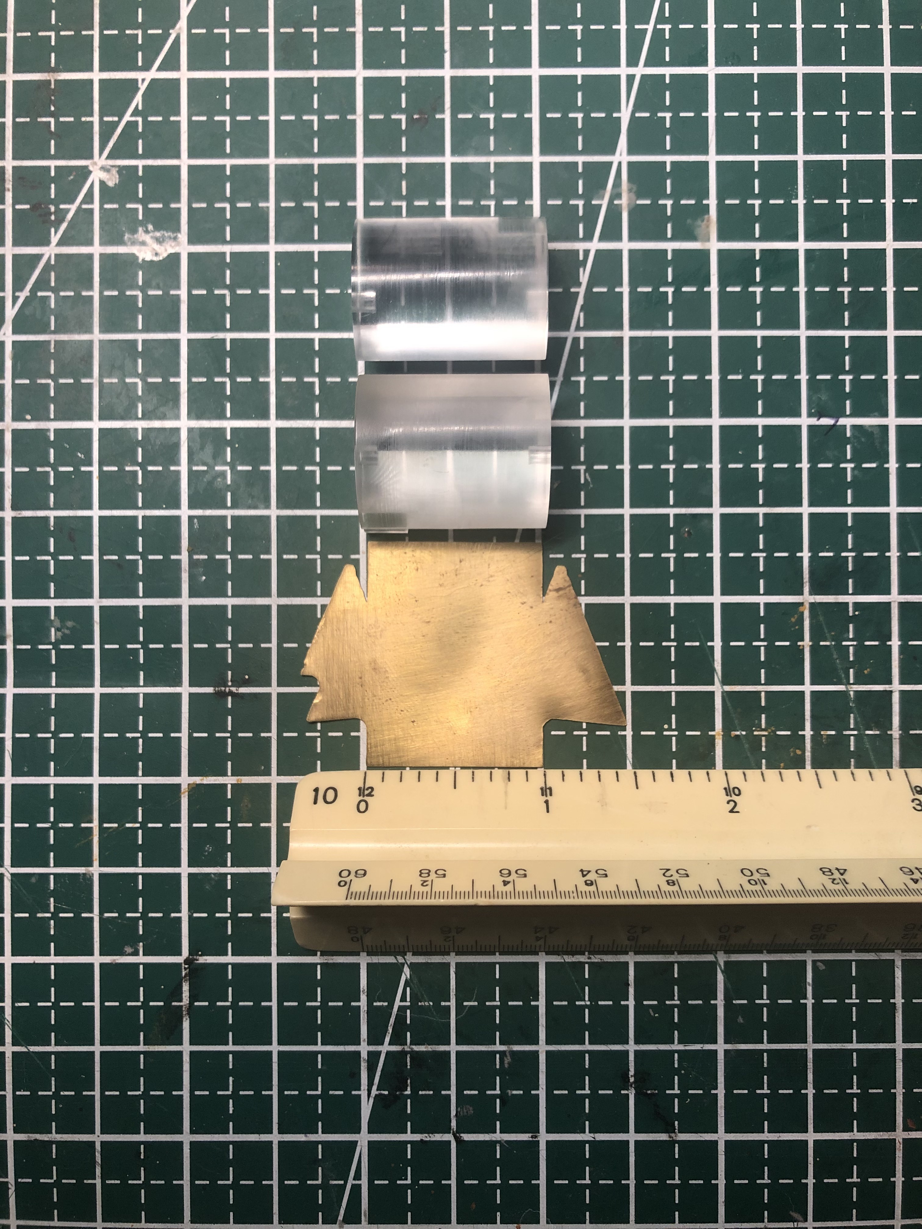

I think 3/4" is the more accurate sizeThe width of the hood and acrylic used in most reproductions has been 1”, and I believe all the current internal mechanics are modeled after Long’s. Here’s some for reference: 1”. The Hero P1 sight width definitely looks narrower, maybe 3/4” - 7/8”?
Hummm, our understanding of the mechanism would not allow the emitter to be retracted if the P1 was in place because the P1 pushes the emitter forward when it is inserted. It could be that this one phaser did not have that feature and perhaps the P2 emitter was even fixed in place otherwise, the only way it can be retracted is if the P1 is detached which allows the spring to pull it back in. I still am of the belief that the Conscience / Lenore / Ripley phaser was the first one converted and delivered and the lessons learned from it lead to improvements on the ones that followed. To my recollection, this phaser is only seen it "Conscience of the King" and "The Galileo Seven." Could be that phasers that followed were more refined and were used more, none more BTW than TMOST which seemingly was the star of the four phasers since it had more screen time and was also featured in the TMOST book. It stands to reason that they would pick the best one to photograph. Interesting that the Conscience / Lenore / Ripley was seen early on in the episodes (after the conversion) and in the early promo shots; probably because it was the first completed and delivered to the studio making it the only one available at the time. The invoice for the conversion is dated 8/22/66 which coincides with the first day of filming of "Miri" followed directly by "Conscience of the King" and then "Galileo Seven." The invoice was not actually paid until a month later on 9/22/66 so was it standard for payment to take a month or was the order not delivered in full until sometime in between. Unfortunately, we will probably never know the answer. I will have to go back and look but I believe there is a hero in "Dagger of the Mind" which was filmed on 8/9/66 which would mean they were delivered much earlier than the invoice. We do know that the Conscience / Lenore / Riley was never featured again, in either promos or in the episodes which does imply it was the worst of the 4 hero phasers.Just my personal opinion: The short emitter may just be the spring-loaded catch is not installed yet or is damaged.
I can imagine that the emitter extender assembly broke, and no one had time to sit down with it for three hours to fix or replace it. A "We'll get to it..." that never ended up getting got to.Hummm, our understanding of the mechanism would not allow the emitter to be retracted if the P1 was in place because the P1 pushes the emitter forward when it is inserted. It could be that this one phaser did not have that feature and perhaps the P2 emitter was even fixed in place otherwise, the only way it can be retracted is if the P1 is detached which allows the spring to pull it back in. I still am of the belief that the Conscience / Lenore / Ripley phaser was the first one converted and delivered and the lessons learned from it lead to improvements on the ones that followed. To my recollection, this phaser is only seen it "Conscience of the King" and "The Galileo Seven." Could be that phasers that followed were more refined and were used more, none more BTW than TMOST which seemingly was the star of the four phasers since it had more screen time and was also featured in the TMOST book. It stands to reason that they would pick the best one to photograph. Interesting that the Conscience / Lenore / Ripley was seen early on in the episodes (after the conversion) and in the early promo shots; probably because it was the first completed and delivered to the studio making it the only one available at the time. The invoice for the conversion is dated 8/22/66 which coincides with the first day of filming of "Miri" followed directly by "Conscience of the King" and then "Galileo Seven." The invoice was not actually paid until a month later on 9/22/66 so was it standard for payment to take a month or was the order not delivered in full until sometime in between. Unfortunately, we will probably never know the answer. I will have to go back and look but I believe there is a hero in "Dagger of the Mind" which was filmed on 8/9/66 which would mean they were delivered much earlier than the invoice. We do know that the Conscience / Lenore / Riley was never featured again, in either promos or in the episodes which does imply it was the worst of the 4 hero phasers.

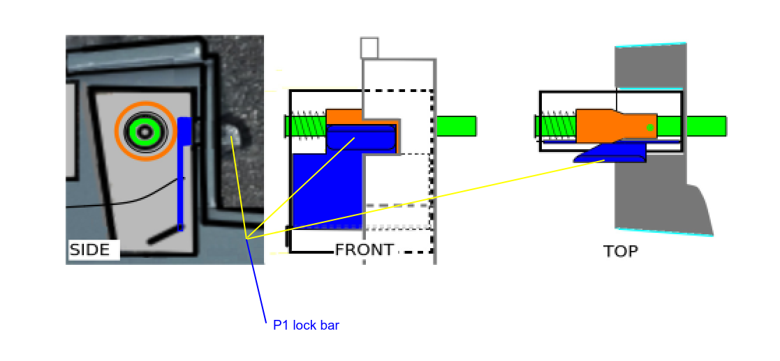

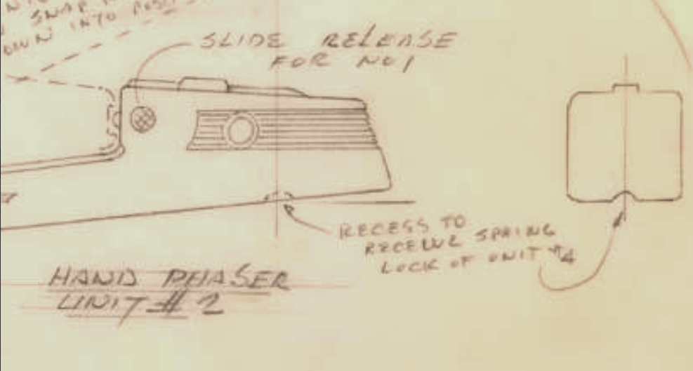

KUROK - I was thinking the same thing after I saw the photos this morning provided by Dhan on his blog (THANKS DHAN! BTW) - it explains why (IMO) there is no gap between the back of the P1 and P2 rear deck now. And to be clear the P1 release mechanism locking bar ( the stud on the flapper that holds the P1 in place see drawing below) is missing now. You can see the stud in the Court photo below. Also you can see a gap, between the P1 and P2, in Matt's original working drawing. And though there is no mention of a Phaser Unit # 4 in the Desilu Inventory list - there is mention of the 4 special power pack grips to make phaser unit # 3.The short emitter may just be the spring-loaded catch is not installed yet or is damaged.
