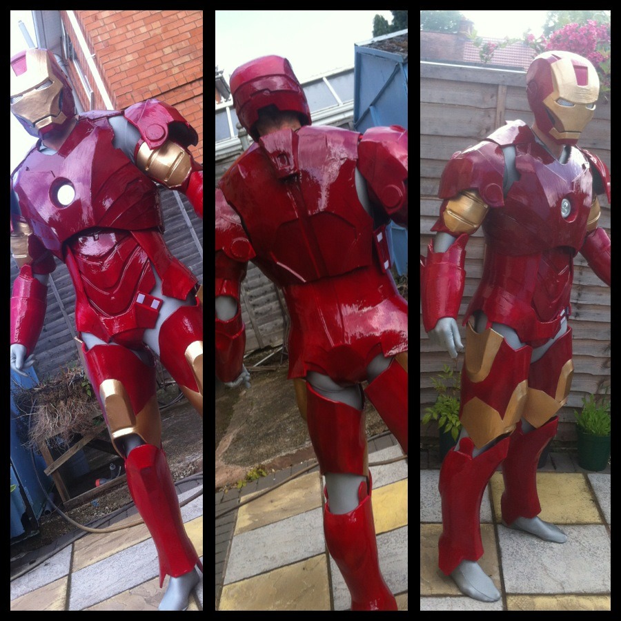

Please do a google search for xrobots plastic coating foam method. It's VERY VERY nacky but the results are amazing. This was my most recent build using this method. It's not perfect but it's a hell of a lot quicker than pepping and body filling. This suit is just foam and smooth-on 65d and it is SOLID!
