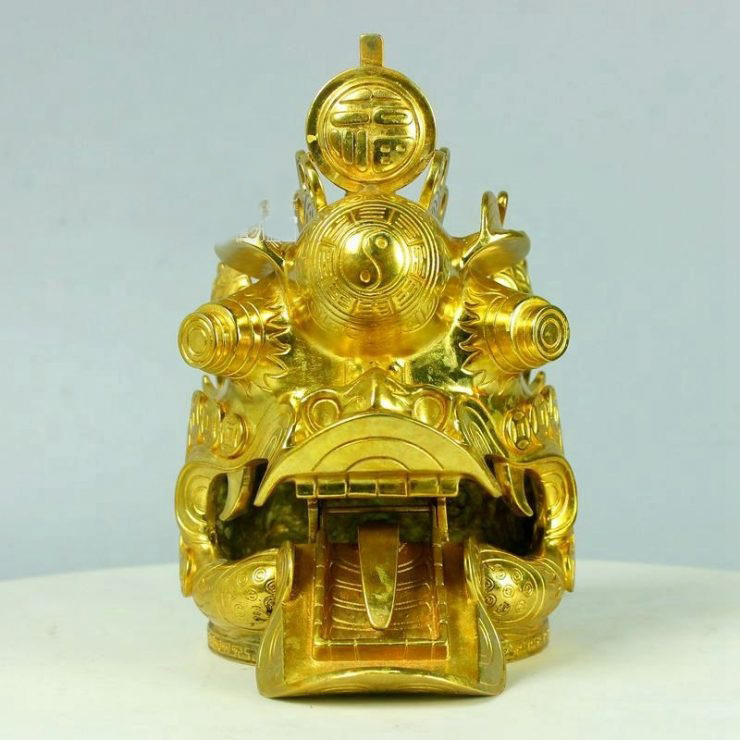

Can't they make the Bronze version with hollowed out eye sockets for real eyes to be plopped in there?
Obviously the real one was not supposed to be heavy, the easy tossing, one handed carry, amount of sand, etc. so I don't get the desire for people to have a solid metal one, but if they want it and want it to have real eyes could that not be done?
After speaking with the factory about a metal version, there would be 1 to 2 centimeter shrinkage, due to it being Lost Wax Casting.
So, after the resin casting run, I'll look into getting my master model scanned into a 3D model and have it 3D printed 2 centimeters bigger. So, when it shrinks, it will be the right size.

For a bronze gold plated version any chance you could look into rotocasting in metal. The few steps in between as minor as they are will introduce some inaccuracies in the final. Scans can be pretty good, but their poly meshes almost always need to be cleaned up. Hence no longer being 1:1 to the studio prop. 3D printing introduces steps, layers of material that will need to be filled, sanded adding yet another separation from being 1:1 from the studio prop. It seems like increasing the size for lost wax would be the way to go, but in my experience I've needed to make several iterations before dialing in the exact sizing at the micron level. Plus the shrinkage isn't always proportionally even everywhere on some features.
Let me see if I can find some vendors that can rotocast for you if you want. You can get a hollow part. Not as heavy and seamless all the way around without losing features. Plus you get the opportunity to drop eyes in if you want.
Maybe there's another way minus lost wax or roto.
How about just Vaccum metalized in nickel and plated gold? Seems the least inexpensive and easiest to control.

So, what do you guys think about this being a metal "Bronze" casting that is "Gold-Plated"?...

So, I found a foundry that can cast the Idol in Bronze, hollow, real Gold-Plating, and a wall thickness of 2 - 3mm, which will allow the glass eyes!
They'll be able to cast it with the eyes cut out, and a hole in the bottom to allow me to insert the glass eyes for installation!
Since it's being cast with a thin wall, height shrinkage will be a maximum of 3mm!
I'm preparing to send an Idol to them by the end of this week, and they will send me a sample to inspect their work.
So, this is awesome news! It will be REAL GOLD-PLATED METAL, with glass eyes!!!
I don't want to get too excited yet, until I am actually holding it in my hands to see if the quality is up to our community standards, but lets keep our fingers crossed!

YES!!! Perfect! You are on the right track with the gold finish. It's not chrome gold or high gloss at all.
I like the look of that second picture with a slight more sheen to the gold.
