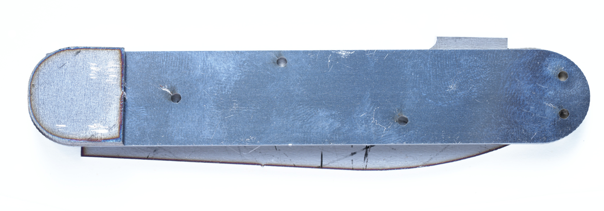

Thread edition, here is final design, opened lenght 209mm, closed lenghts 117cm blade length 92mm
Please look at post #20 and #66

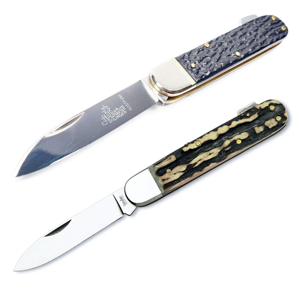

After some searches I discovered some facts about that raider pocket knife.
-it's not a Linder
-It's not a Hubertus
-it's not sourcable anywhere, new or old.
-the bolster is stainless and has no grooves
-the rivets are steel
-the handle is fake stag
-the blade shape is different from any existing knives I saw, especially the base

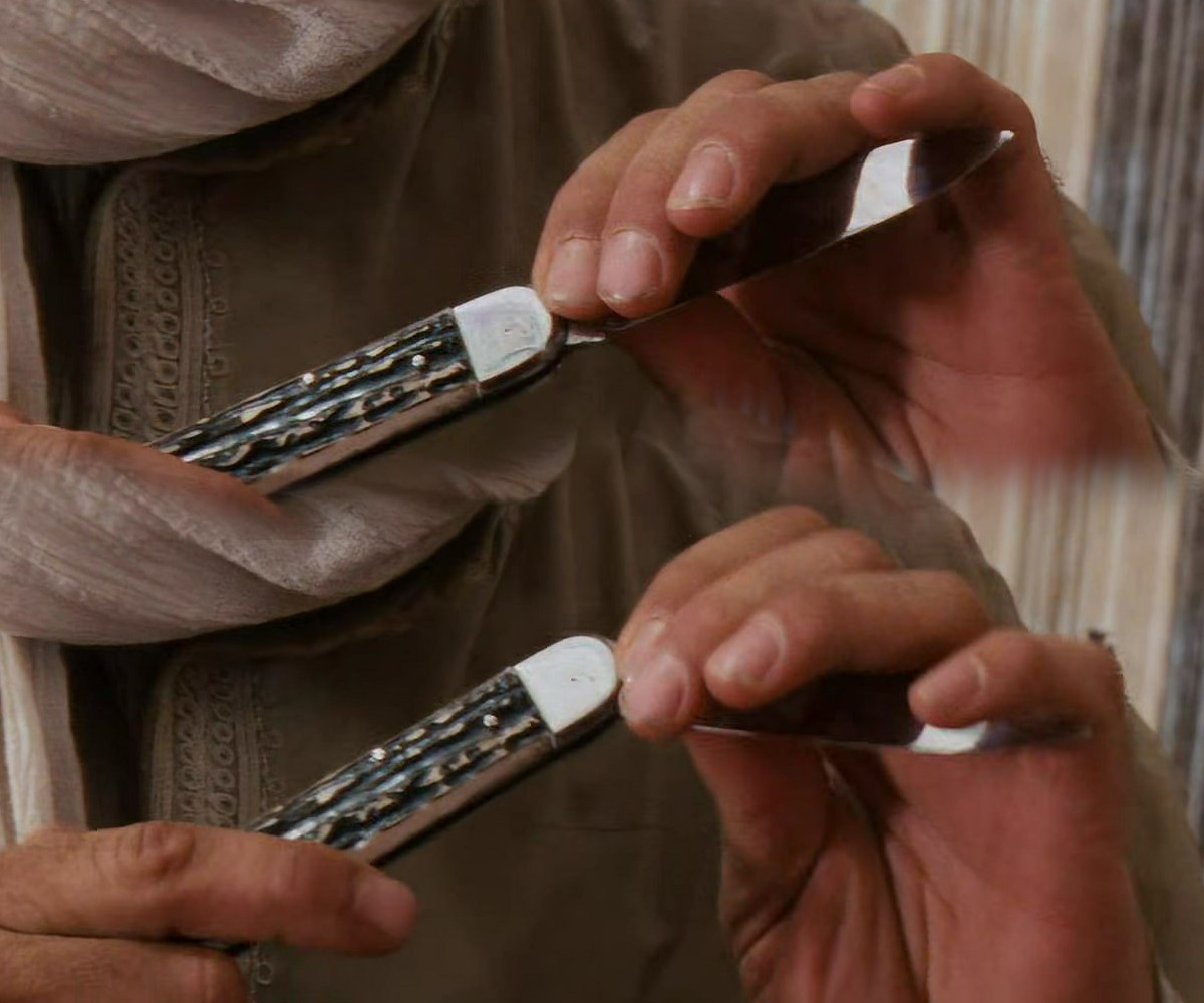

You can see the colors on this 4K screenshot, notice the bolster shape and color, rivets, stag handle, blade shape:
The stag is not grinded to match the bolster, rivets color and position, closer to linder than hubertus, but color doesn't match any of them, both have brass rivets.
I recently learn the Linder blade size, which would be 1cm smaller than my blade, which I designed based from those pictures.
Bolster is plain like the Linder, and made from stainless, unlike hubertus, which has a german silver bolster
Blade shape especially base doesn't match any of them.
The fake stag is not like any of them, but I have seen this material on vintage knives made in Thiers, I will ask some knifemaker friend to show me some examples.
