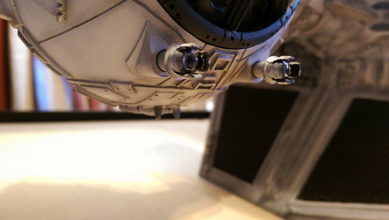

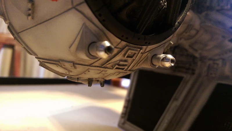

Looking good overall, but I find the weathering a bit too heavy. It just doesn't do justice to your amazing job at putting all of those greeblies together (my 2 cents;))
joberg, Thank you very much :thumbsup I really appreciated your input. You are right, on the pictures the weathering seem to be heavy .but believe me. it doesn't look as heavy in person. I don't know if is my crappy cell phone picture, lighting or my monitor. anyways I'll try to dust off my camera and snap some better pictures.

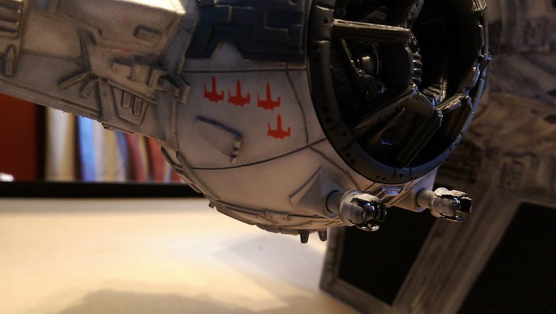

Blood stripes
Side note: white balance is off, picture taken with a cell phone htc making they grey look white and under exposing the dark shading

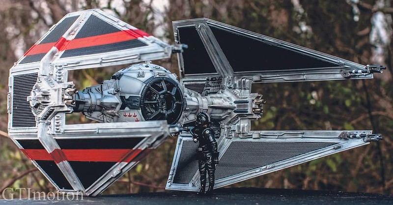

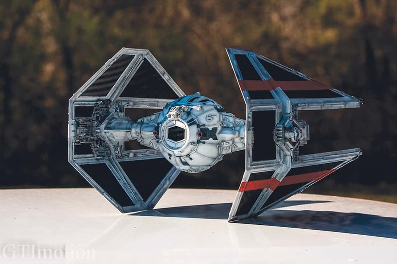

Here are few pics for you guys, I know they are not the best pictures. but they should do till stops raining.
Here is the Tie Interceptor with a 3.75" Tie Pilot
Back side of the tie interceptor
