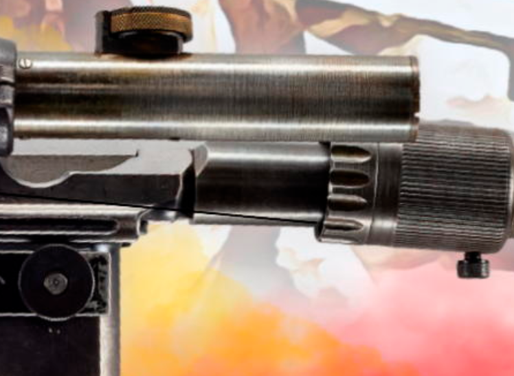

1) the bull barrel. The originals were properly rifled barrels, cut and threaded flush into the mauser frame, not slip fit sleeves that awkwardly butted up against the shoulder of the original barrel. Slip-fit was a design created for blaster replicas by kpax and team if i'm not mistaken.
2) the bullet shaped cut-outs on the flash hider were only made because fan replica makers couldn't mill the cut-outs the way original MG-81s were milled.

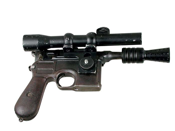

5) Effort has been taken to mimic the post-filming catalogue shot of the actual prop. If this were a backup prop or something like that, it wouldn't have identical damage, even down to the crooked flash hider. Nice try but really, really stupid.

The mount and rail on this replica even look to be the one that I helped FM bring to life a while back. The bull barrel has to be the most lazy approach I’ve ever seen in a replica. Simply slid into place without any work to make it fit. The bullets on the FH.. come on man. The hammer as well. Damn. It’s embarrassing.
