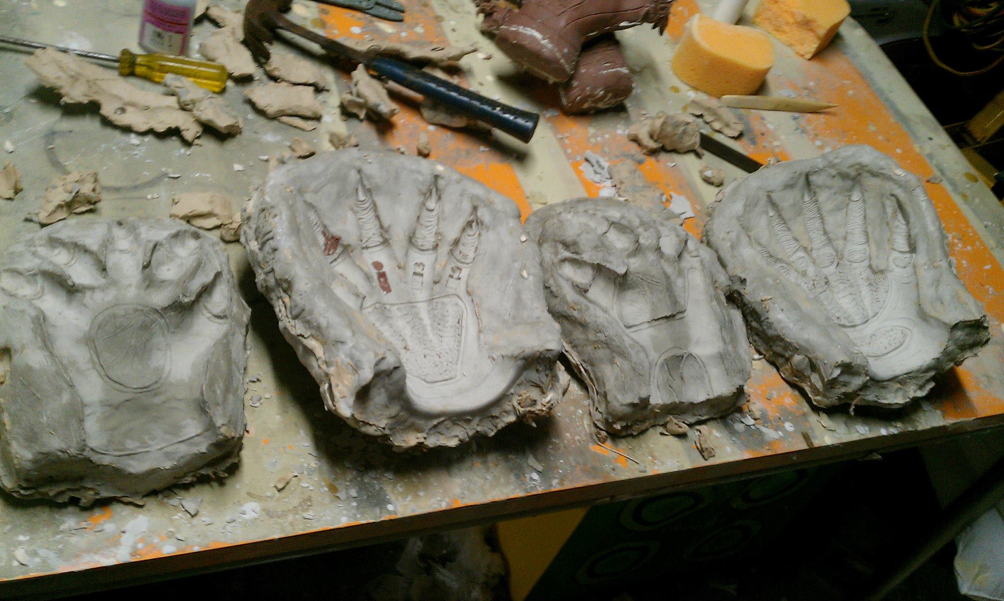

I cast the hands in plaster and am currently waiting for the latex to dry, should be able to pull em out tomorrow

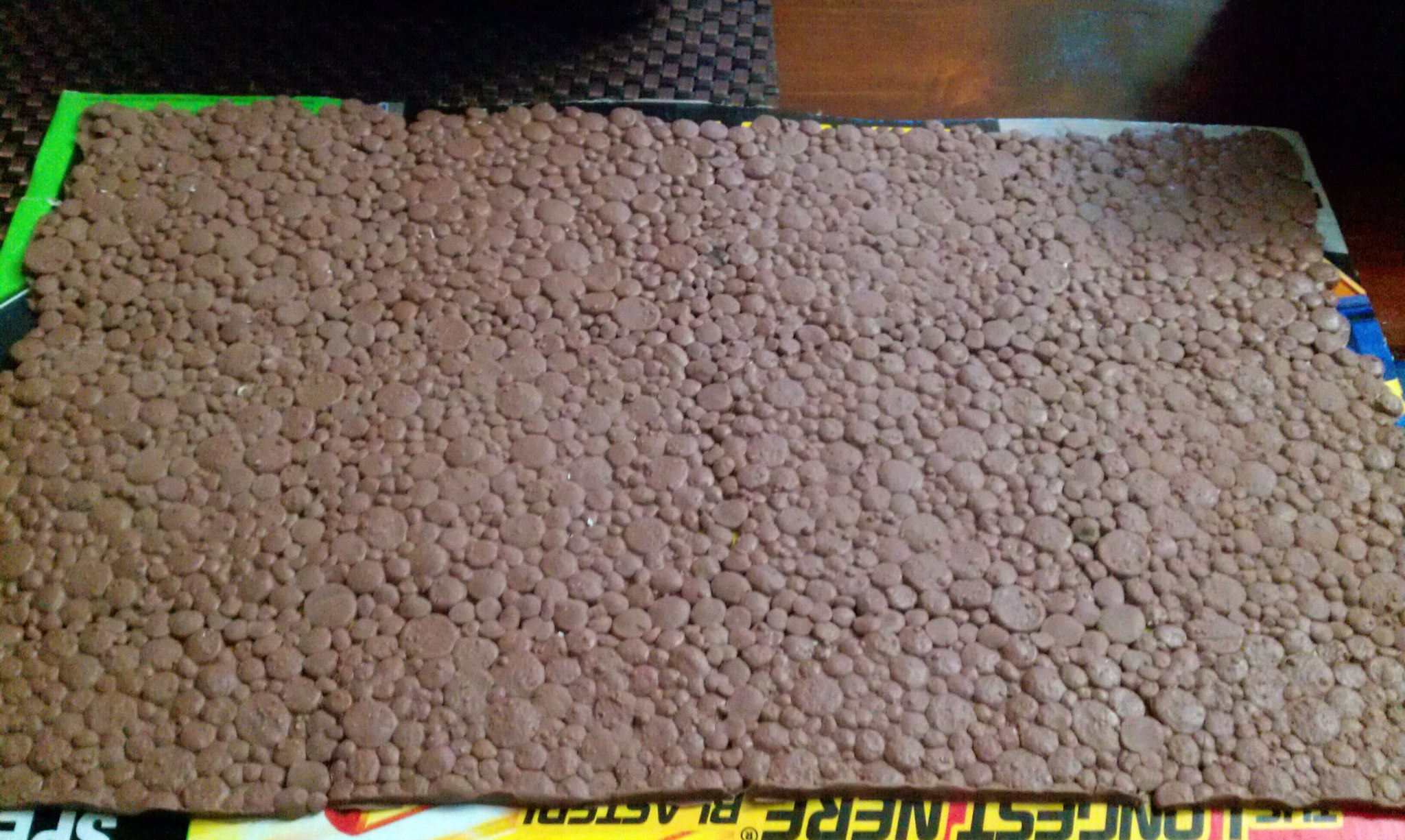

For the suit detail I decided to go a different path. I made sheet of clay skin (I made a small section first, cast with alginate and then repeated to save time)

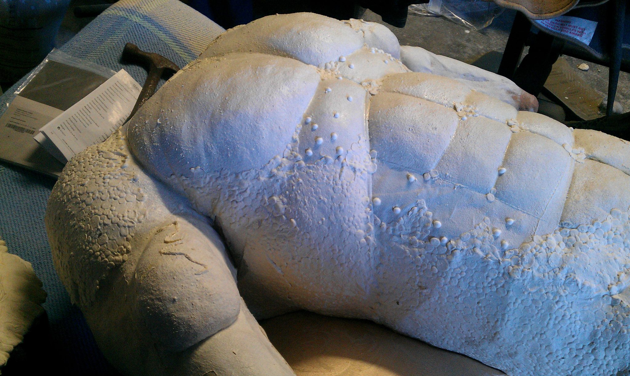

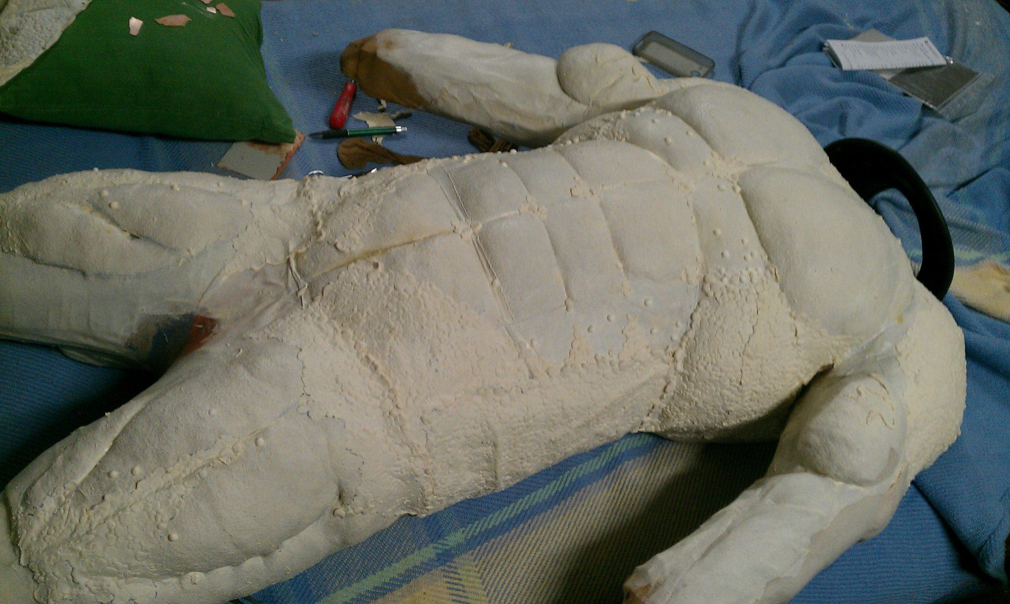

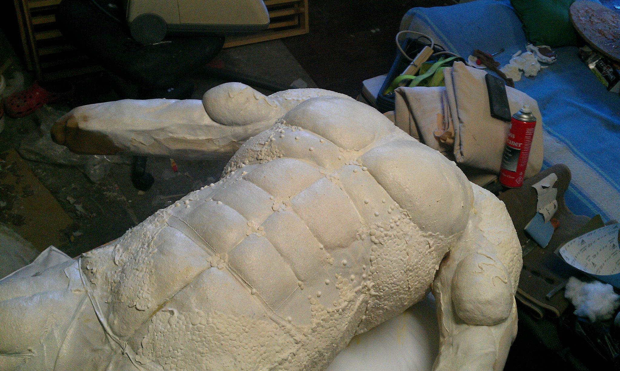

Next I cast the skin out of plaster and brushed latex on, peeled it after a day and repeated until I had enough sections for the suit.
I cut sections out and superglued them to the suit, then added some more styrofoam balls and sealed with a few more layers of latex.

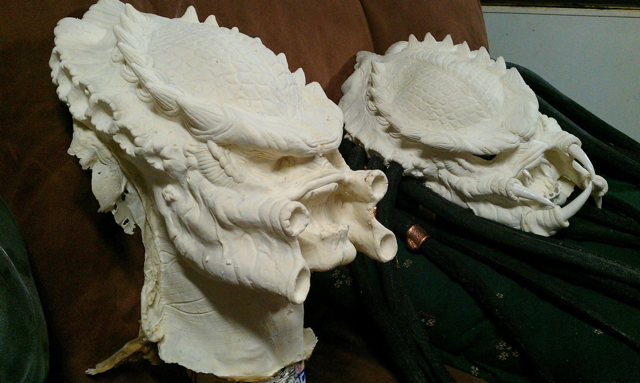

I also cast another mask, although this time I used some soft expanding foam inside to support the weight of the dreads.
