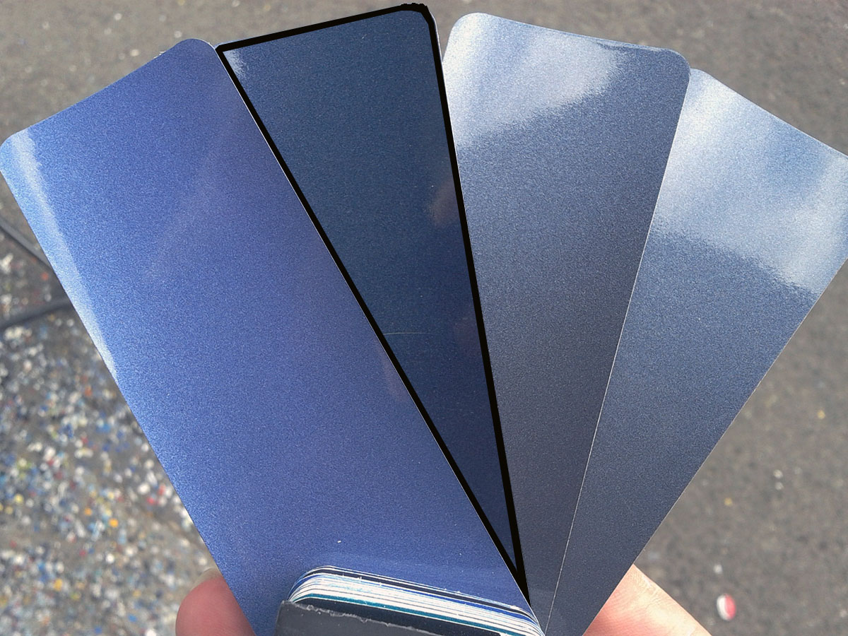

Bit ahead of myself but started looking at colours. The original paint job is going to be near impossible to replicate, take the often asked what colour is the Millennium Falcon (hope saying that doesn't bring anyone out in boils) and multiply it by about 10. There was a basecoat upon which many layers of shading and lacquers were added. So I started looking for a base colour which covered the majority of the paint scheme. Spent a few hours looking at car colours and for some reason Toyota/Lexus seem to have a wide range of shades similar to what I was looking for. Found a handy website with multiple pictures of the same car colour in different lighting conditions, so armed with a few possibilities visited my local car paint supplier.
Took a number of pics in daylight of about 20 different colours in the same colour palette, noted my phone showed them a bit over blue to real life and came home. On uploading the photos was pleased to see they appeared less blue on screen so it was going to be ballpark right. Quickly realised that what I thought was my starting point colour was way too blue and light, but luckily in a random last 4 selection hit one that is very close.
Second from left highlighted in black. If you base the colour on the full scale one or the ice flow model you will probably think I am loosing it, but the 1/12 hero is pretty close to that overall. It will need darker almost slate grey shades and silver/blue, in fact the colour to the right of the highlighted colour in the pic would probably work well for the lighter shades in misted over the main colour.

The colour choice is fascinating - as it appears a different shade in most every shot I guess its subjective but its great to have a starting point.

Jon I'm right there with you on colour. For me it's the hero miniatures every time; that's what gets the bulk of screen time and that enigmatic bluish silver-grey has always been fascinating to me. I think you've done a great job finding a good colour match there and can't wait to see it on a model. It's rare to see a fan model built in anything other than black and that just doesn't work, for mine! Others will disagree of course but I'm delighted you're going this way. :)

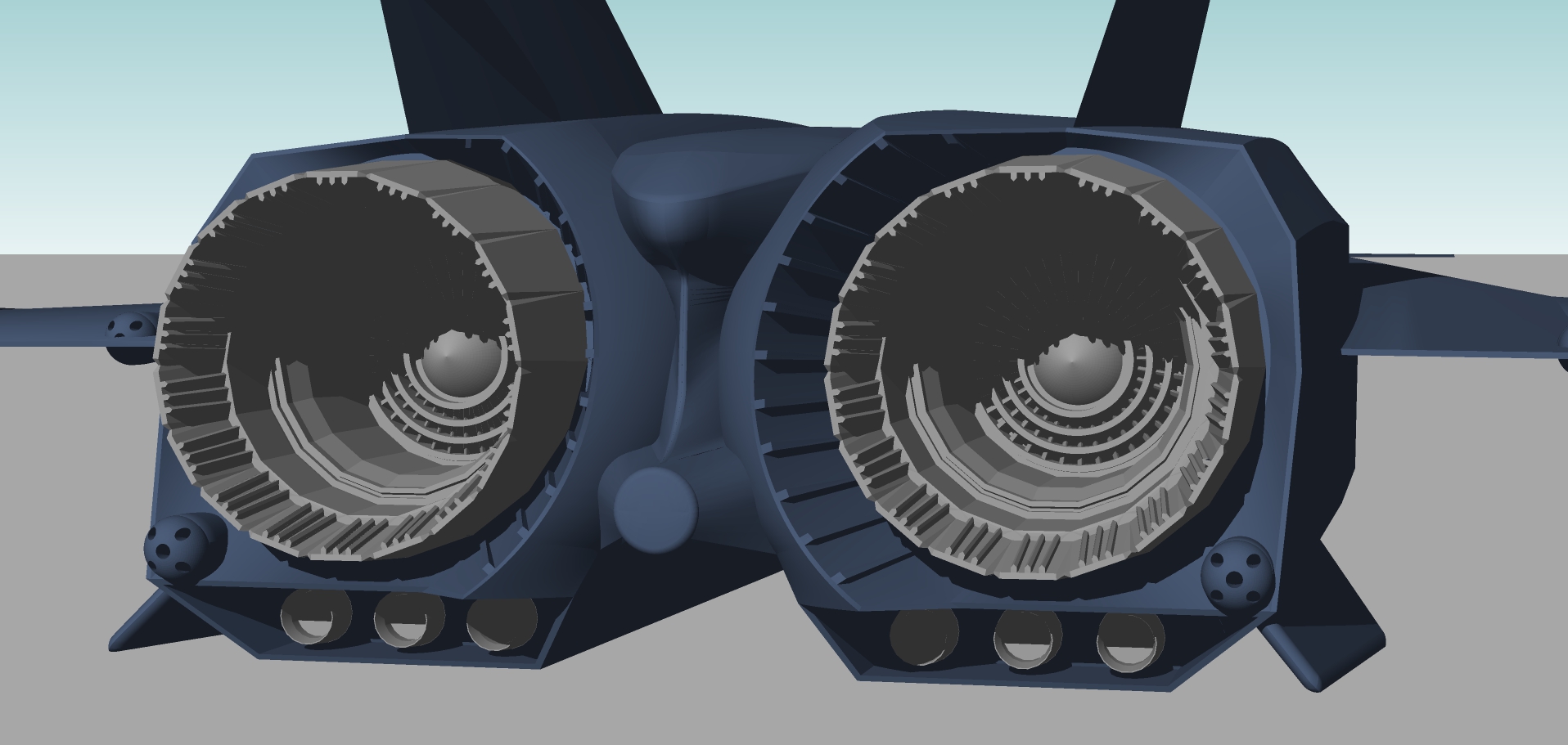

Held off the test printing as I realised that there were a few things off, and decided it wasn't worth doing before all the structural parts were done. So many small tweaks, you realise how accurate you can be when you are moving things only around an inch in real scale terms on a 63 feet long plane!
Anyway, the inset sections around the exhausts I am calling done after many hours tweaking, mainly because there was never any real detail there as the engines are always lit on the hero so there didn't need to be as it would get obscured.
Had a hard time getting it right as I had made a couple of assumptions about angles of certain pieces which I realised were wrong, once those were corrected it was a eureka moment as it started matching the reference pics, had a celebratory cup of java over that one ;)
Took a bit of artistic license with the exhaust manifolds as they are kind of plain. So found reference pics of the SR-71 Blackbird engine internals and detailed them in a similar fashion, after all it's the only plane that's got anywhere near the Firefoxs Mach 6...
Tail planes are mostly there, they were slightly undersized and the tilt angle was wrong, now they match the hero shots. Built the defence pods, undecided if the ones by the engine should be blended in or left as is. That section comes out with the engine internals on the hero and I think there may have been two sets that were a bit different - one lit and unlit as some of the shots just don't seem to show the same thing.
Have done a bit of test printing of the exhaust manifold sections which were a pain as the edges get so thin, needs a bit more adjustment on print settings for that.
So current state

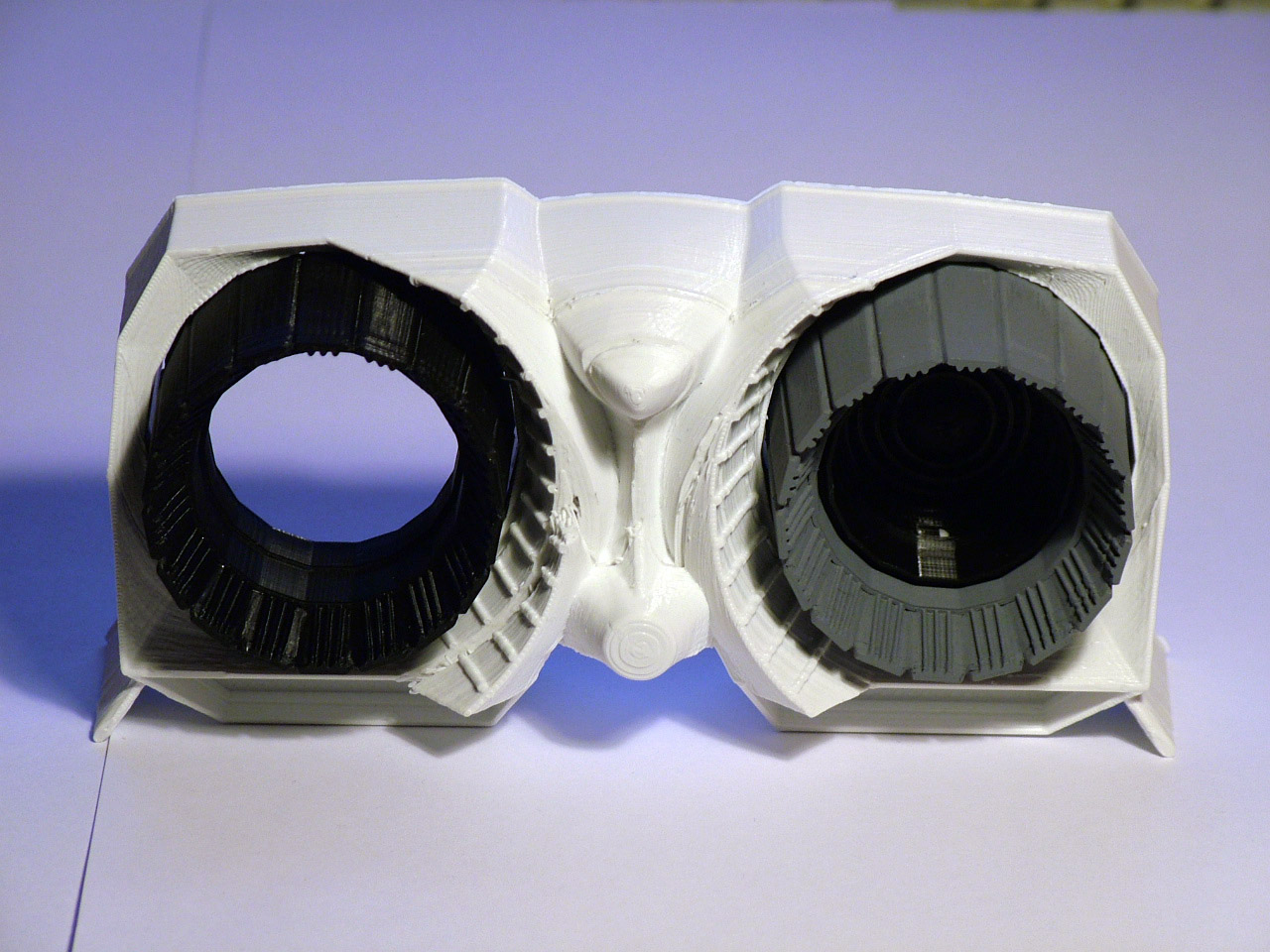

Had some 3D printing problems, kept getting issues, partly down to cheap filament, and partly down to learning optimal settings for what are complex shapes. Kept getting problems, and after starting the same print 3 times, realised I was going through - insanity is doing the same thing but expecting a different outcome situation!
Realised I was trying to print probably too fast, and with not enough infill, trying to save time on prints, but probably wasted more time in the process. I was trying to get the print time down as most of the complete engine section was quoted at about 12 hours, which sounds a long time but not a big deal if you leave it reliably printing overnight, and it is quite a big portion of the model.
I have pinned down what the main problems are including a banding effect I was getting on the engine exhaust, which seemed to be down to certain layers getting infill rather than just a perimeter when the thickness went from somewhere between 2-3mm, turning off infill and adding more perimeters fixed it, but have realised it's down to a default infill overlap to perimeter setting of 15% causing a bulge.
I had to stop the rear section print shown in the pics about 3/4 through, again know why it happened and how to stop it, but though what the hell and kicked of the rest before going to bed last night, sure enough it screwed up in the same way, see the insanity quote above!
Anyway nearly threw it in the bin this morning, but coming back to it this evening quickly glued it together and realised it didn't look that bad, al least it looks right, which was why I was doing it. There are shots of the exhaust version 1 and 2, version 2 I split it into two parts and I realised I was going to have printing problems otherwise. To give a sense of scale the entire engine section in this one is about 200mm wide.

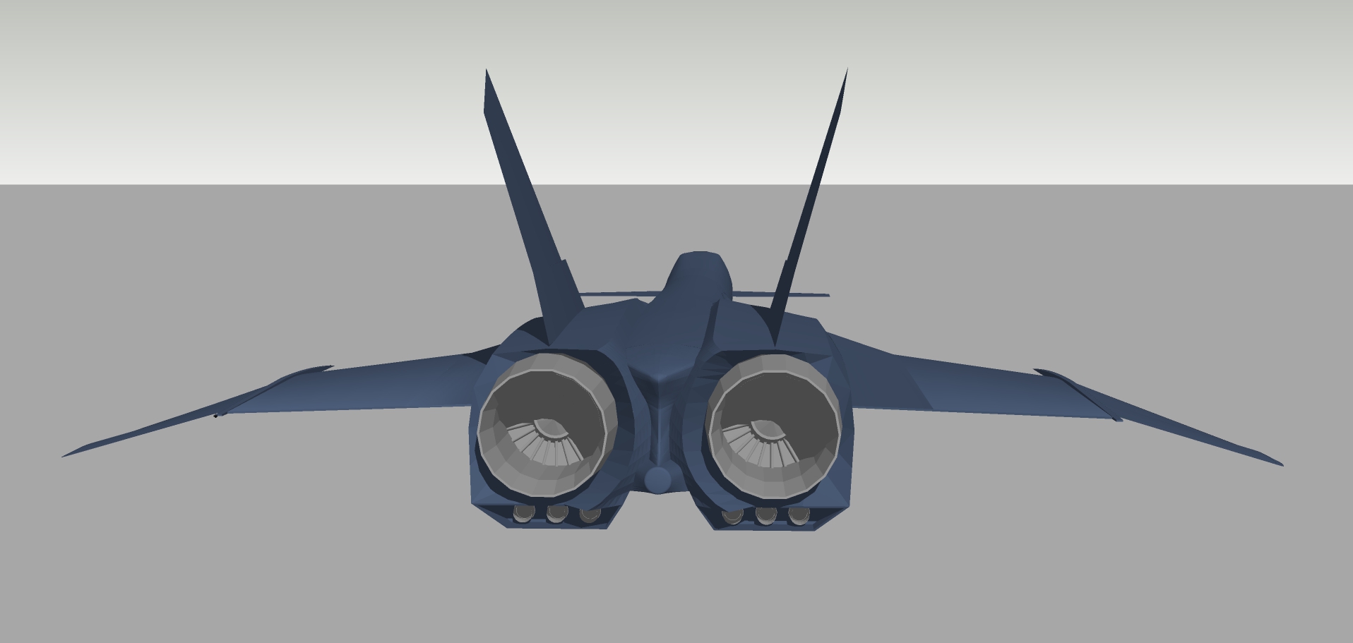

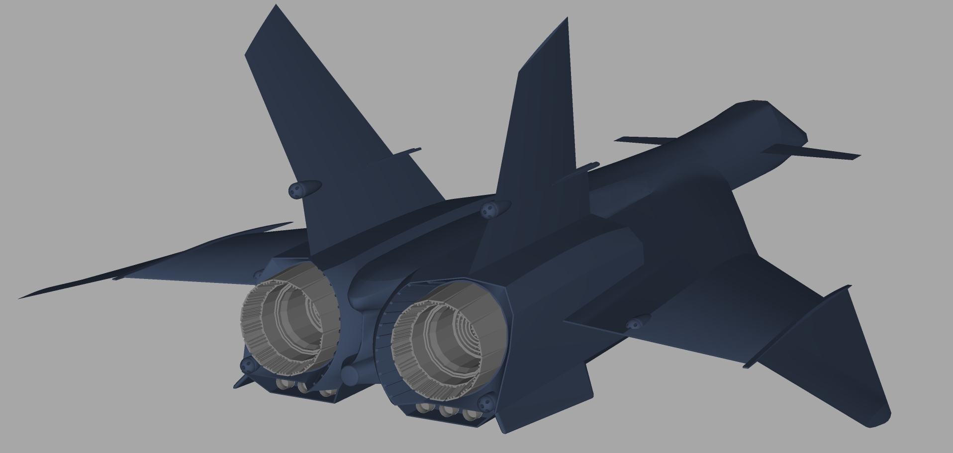

Small update, worked on the tricky geometry of the wing to fuselage shaping and the intake inlet cut outs which flare outwards so the narrow tips nearest the front of the plane are as wide as the front fuselage widest point, something people seem to miss.
The wing body join looks a bit obvious at the moment as they are two separate pieces of geometry so there is no visual smoothing being added by the software.
Done a few other things, found some subtle shaping and angles on the front of the underside intake/gun port, added the rear underside fins and defence pods. Keep checking by using the match photo feature in SketchUp where you can adjust the perspective to get an almost perfect match to any of my reference pics.

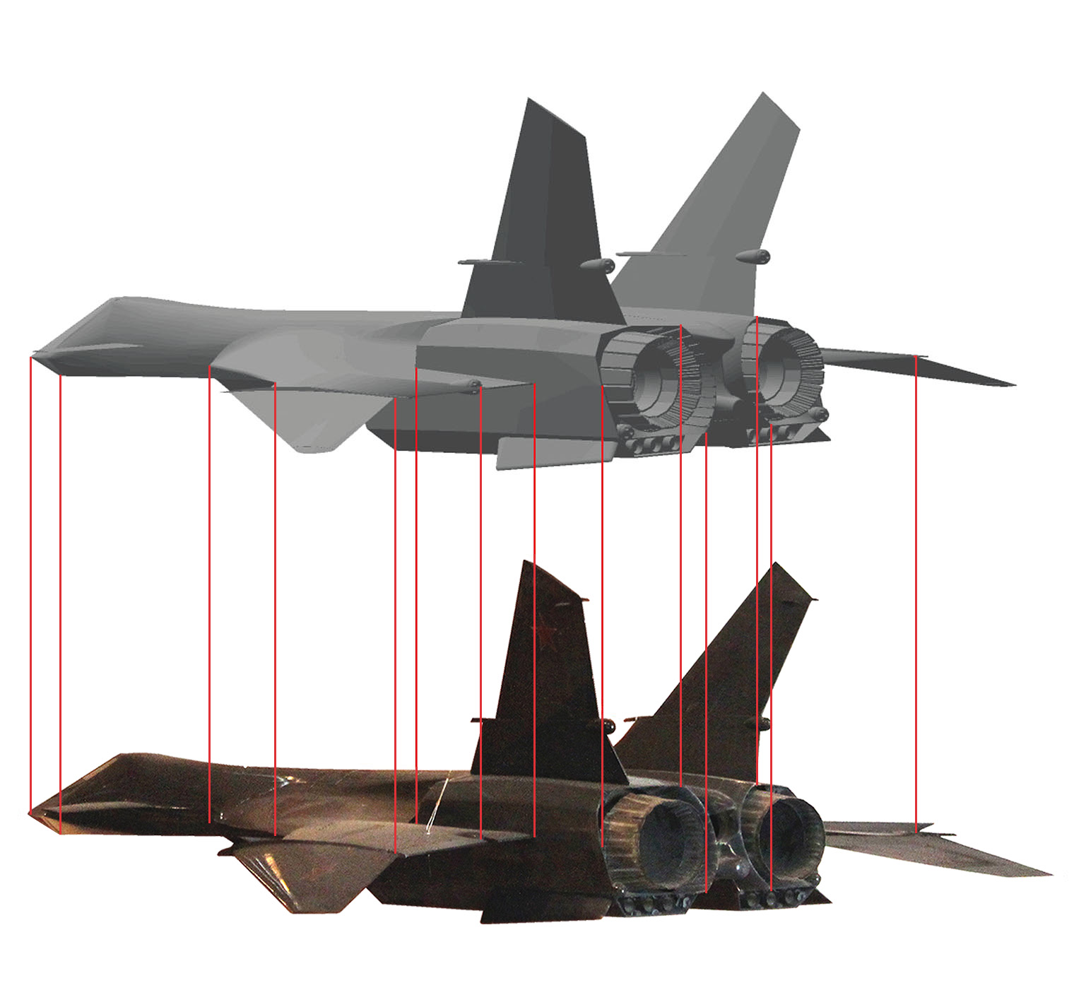

I have had to use a combination of Photoshop and Coreldraw to create this as inside SketchUp unless you can zoom in and out it it's really hard to see what's going on!
Realised I saved it after I was trying to line up what I have now realised as slightly sagging wing-tips, so my model is tilted towards the camera a tiny bit more than the hero orientation, like 1 degree or something, but it doesn't affect the horizontal dimensions. I will do some more, but they take time.
This is one of the best pics to match to as it looks like it was taken at a distance with zoom, which I have found reduces the distortion artefacts somewhat.

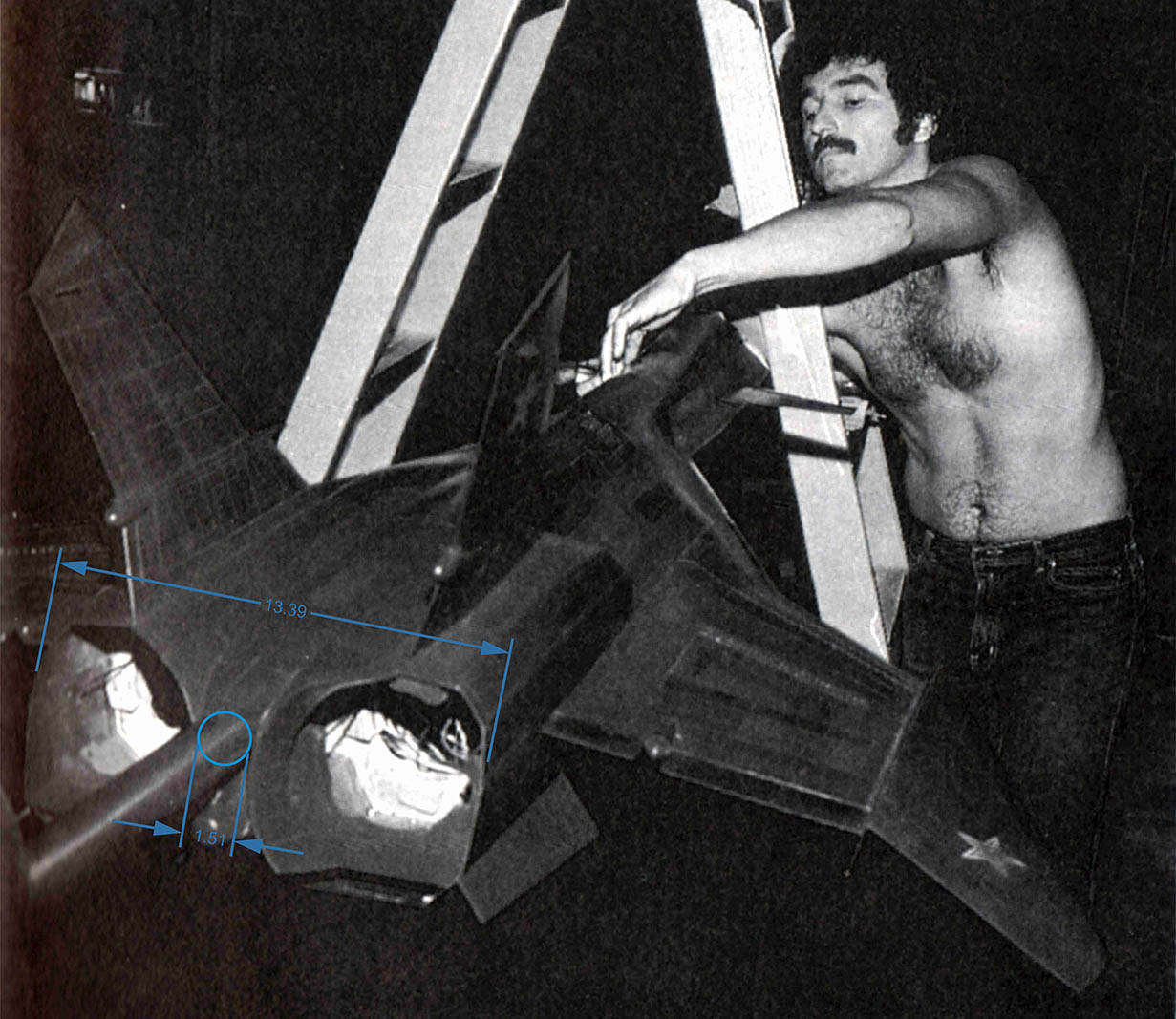

Forgot to post this, using this pic from Cinefex, I scaled and overlaid dimensions in Coreldraw, gives a good scale reference as the mount pipe must be 1.5 inches diameter, as far as I can tell that's what they used, certainly from that sizing it scales the hero correctly.
Realised this is probably the shot where they are moving the canards back, sorry about the male nudity, must have been hot in there!
Niiiiiice! Thoughts:
* that nacelle section really isn't as tall as I've always thought
* on the nacelle outer side walls, is there a facet demarcation at the level of the wing, which carries aft?
* or is that only a panel line and change in the line of the sweep of the trailing edge of the nacelle?
* do you need to move the leading edge of your lower main intakes forward a little, possibly?
* I think you need more of a 'step' back to the main nacelle at the lower edge of the nozzle shrouds.
Overall, mindblowingly close to perfect.
