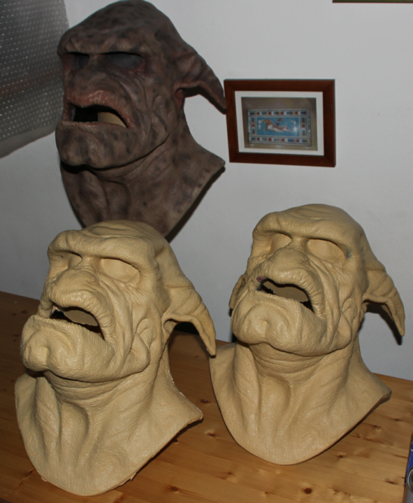

Done / Completed Fifth Element Mangalore "Kounan" character bust small run
All difficulties are solved.

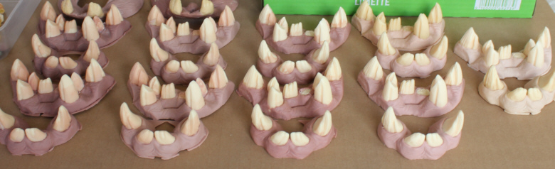

I also casted the teeth in 2 colors what makes them much more realistic than painted jaws.
your work is amazing. It's extremely hard for me to resist to sign up since you started.
Can I ask where are you located? inside or outside Europe?
good luck with the rest of the work (y)

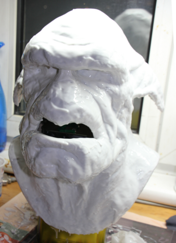

Several silicon layers later.

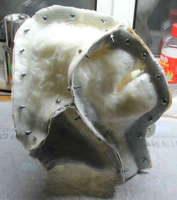

Next step is to make a hard shell and then i can start the casting of the heads...... :D
Very unusual are full sculpted inside lips and mounting platforms in the mouth for the teeth which will be also casted
together with the head in one step ..... ;)
OK, next lesson learned!
Never use too much fibreglass shreds in epoxy resin and use a fast curing one!!!
It took over a week for all parts of the shell and i should rename me here at RPF in "Bloody Pin Hands" ..... fibre glass with epoxy can be very sharp....Ouch !!!

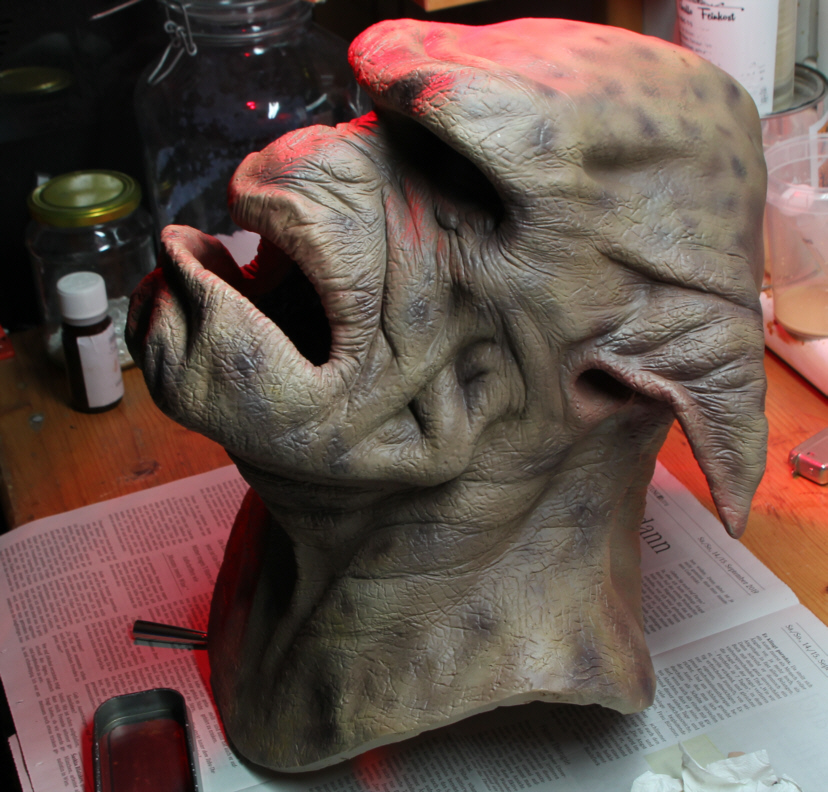

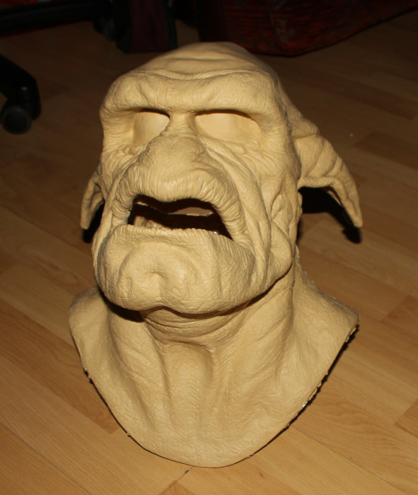

First casted head ...
nearly no seamline visible, this will save time ..... :)
Every casting will take some days because i have to make several layers inside including one layer with fibreglass

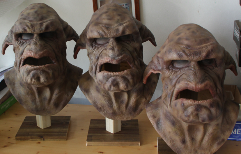

Soon i can offer the first finished head :D

One fun fact is that the Mangalore camouflage really works.
Depending on the amount of light and the angle the head is from dark brown with dark freckles to mid brown an only sligthly visible spots.
The overall color varies from red/brown to grey/yellow/brown ......o_O
