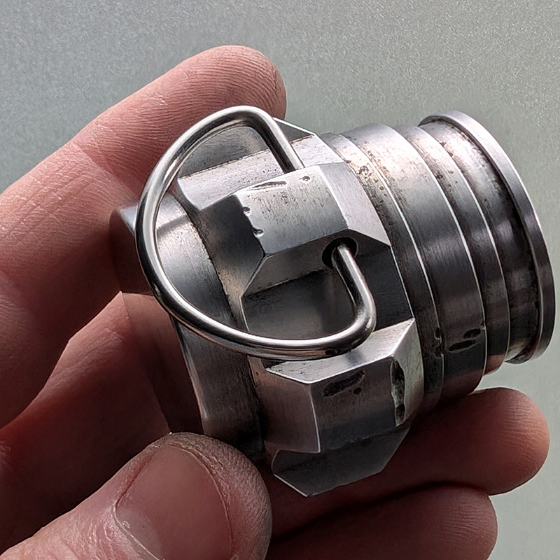

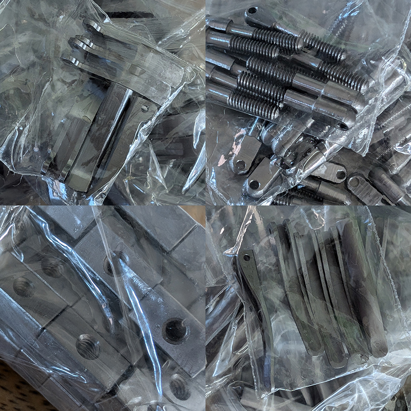

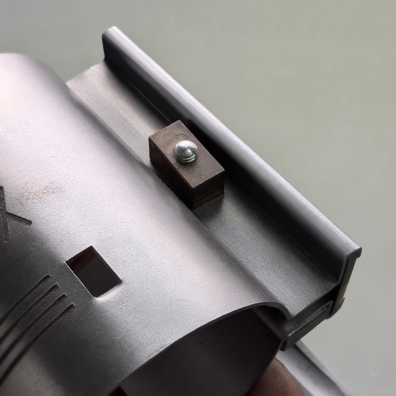

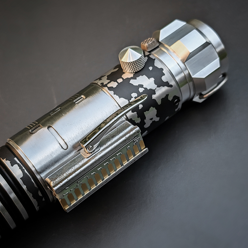

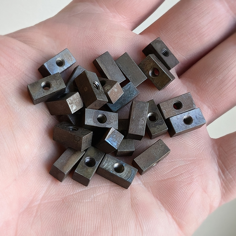

First priority last week was to go through all of the clamp parts and to get them in for plating. I dropped them off on Wednesday morning and they are now in the process of being plated. (y)
I assembled both a V2 and V3 clamp just to get a few pictures of how the final clamps are looking with their respective levers installed:
** Please bear in mind that the parts are not plated yet in these images. **
The blocks for the V2 clamps aren’t being plated. Instead, they have been darkened/aged using water/heat:
The plating process is usually fairly quick, so I’ll keep you updated as soon as I receive any news. (y)

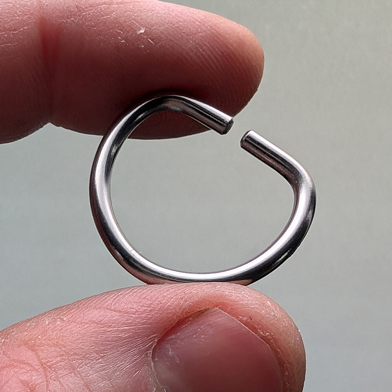

Ring jigs are also "in production" still. I am expecting those to be finished soon and on their way, with them being one-offs.

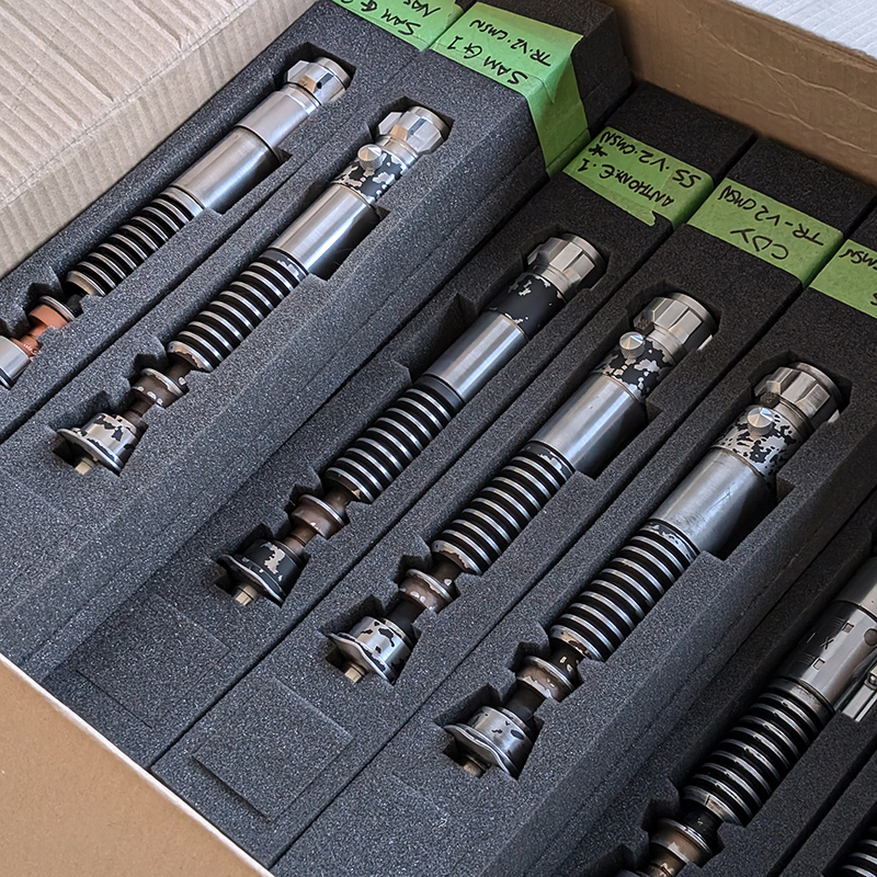

Batch One commissions are safely stored away and awaiting their clamps and D-Rings. As soon as I receive these and can complete Batch One, I’ll send out final invoices and get them on their way to their new homes.

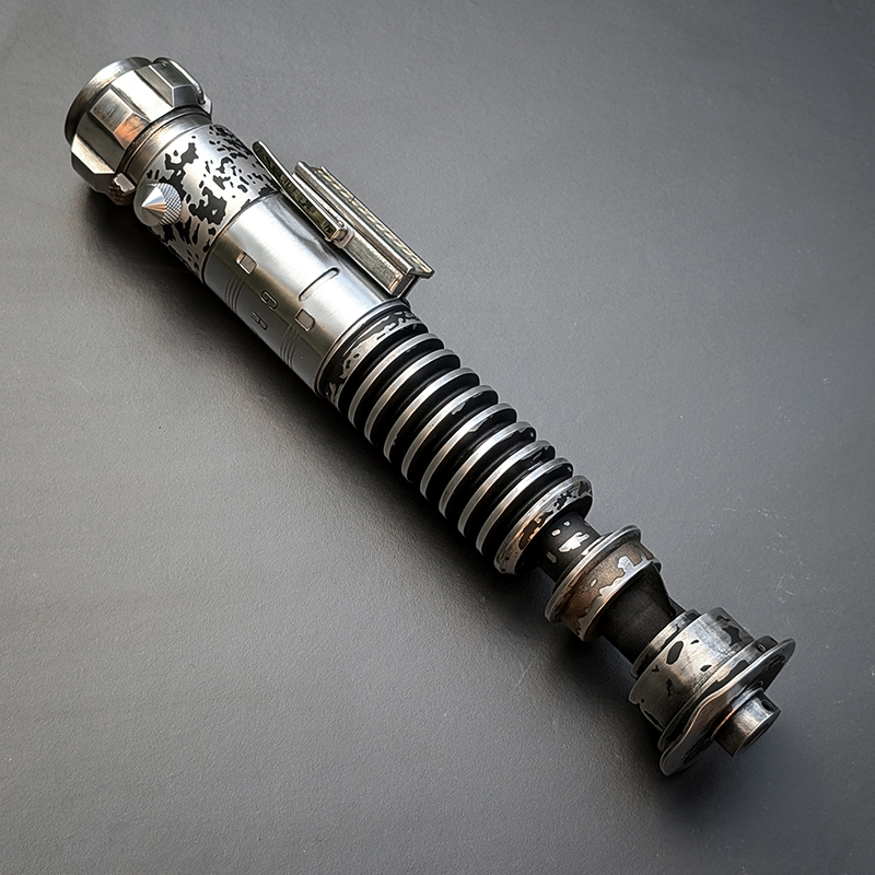

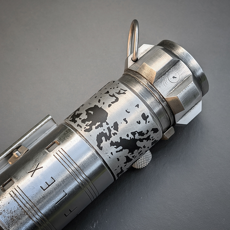

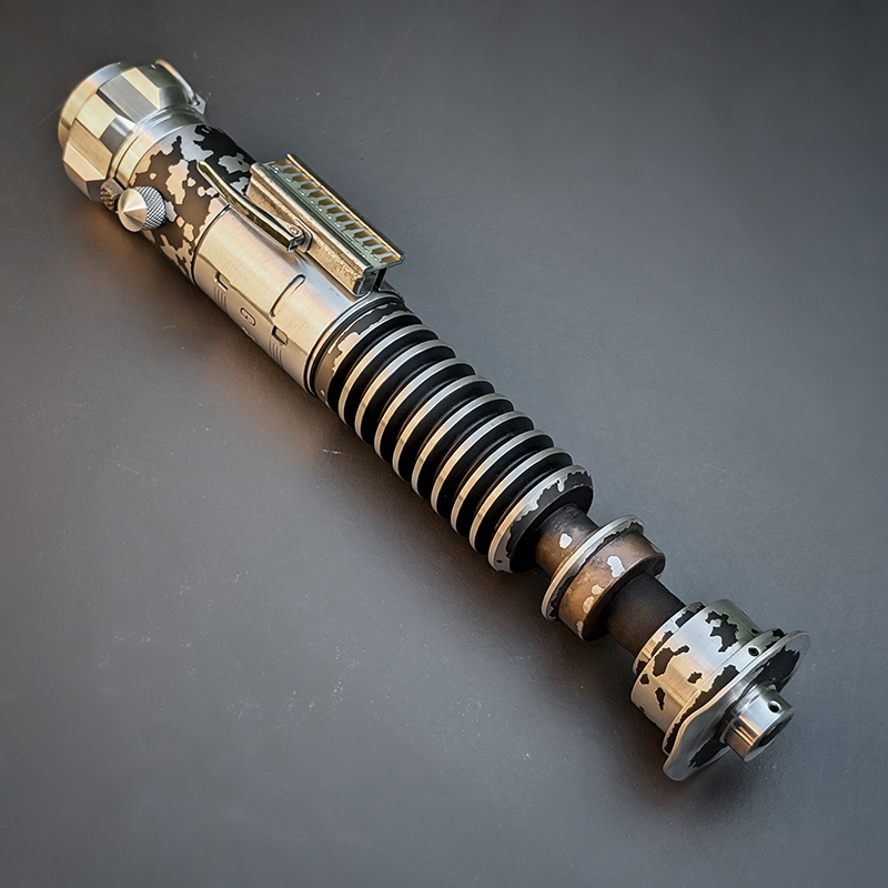

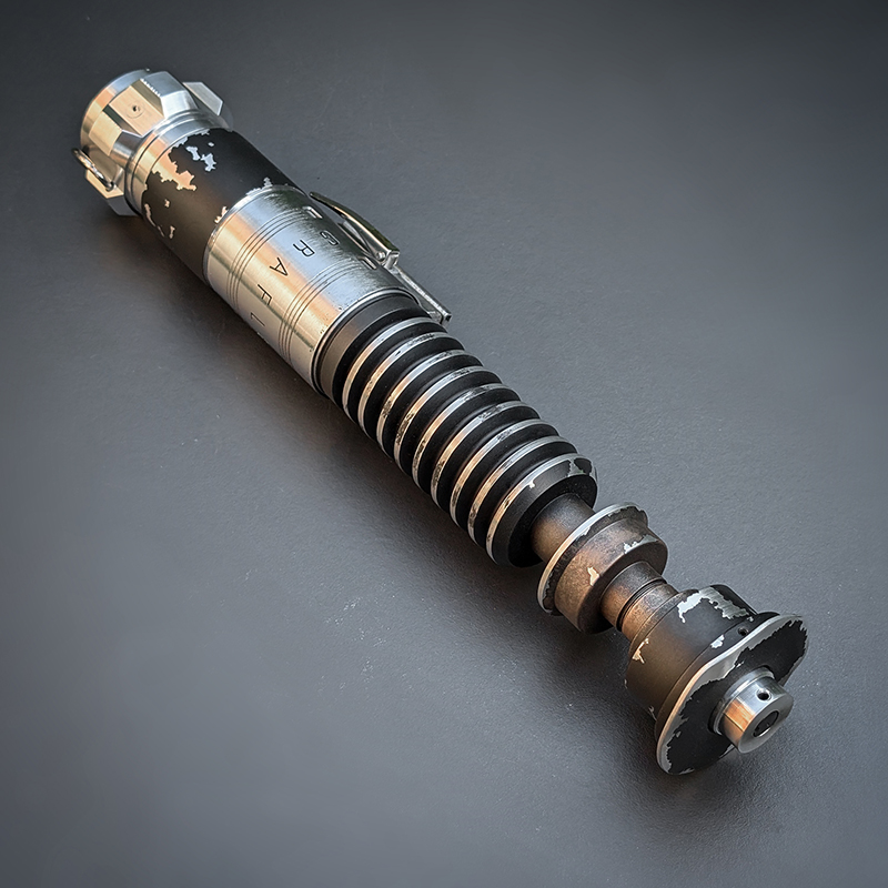

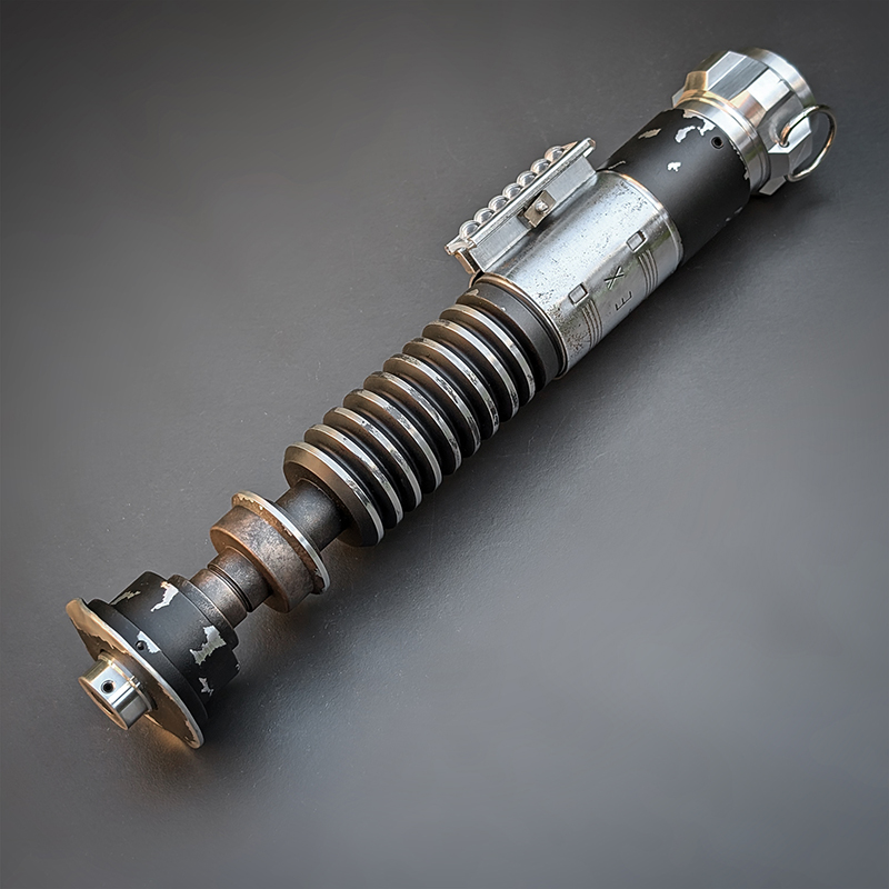

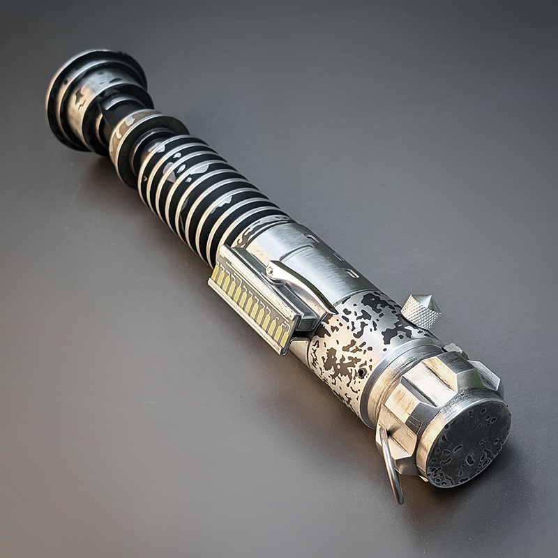

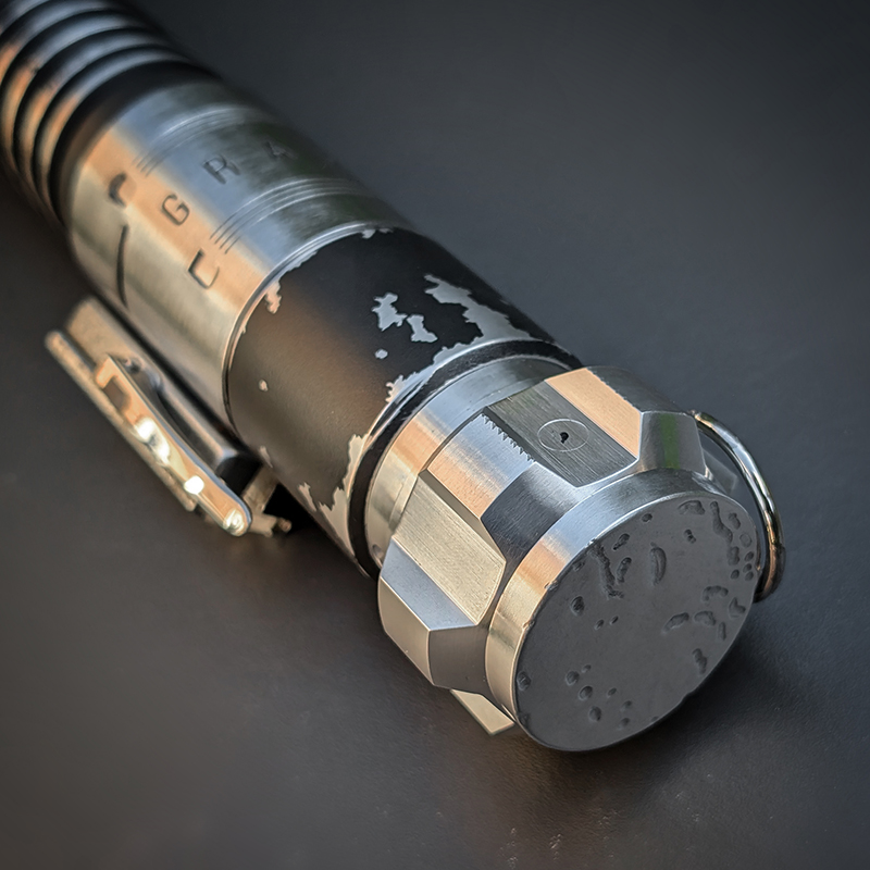

I did manage to get a few pictured this week of a couple of the finished commissions. I borrowed the Vintage clamp from Mo’s Sandstorm V2 to get a few pics of a fully assembled Throne Room V2 as well as one of the Current Day V2s. I also installed a Vintage V2 Ring on to Mo's Sandstorm hilt, so here's some more pictures of that now that it's 100% finished. I installed both the Throne Room and Current Day examples with temporary D-Rings. **These are from the rejected samples I received**. I did my best to correct them, but they are still not acceptable (and incredibly difficult to work by hand with them being Stainless Steel!). I installed for the photos only but will be replacing them.
SANDSTORM V2:
THRONE ROOM V2:
CURRENT DAY V2:

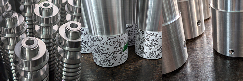

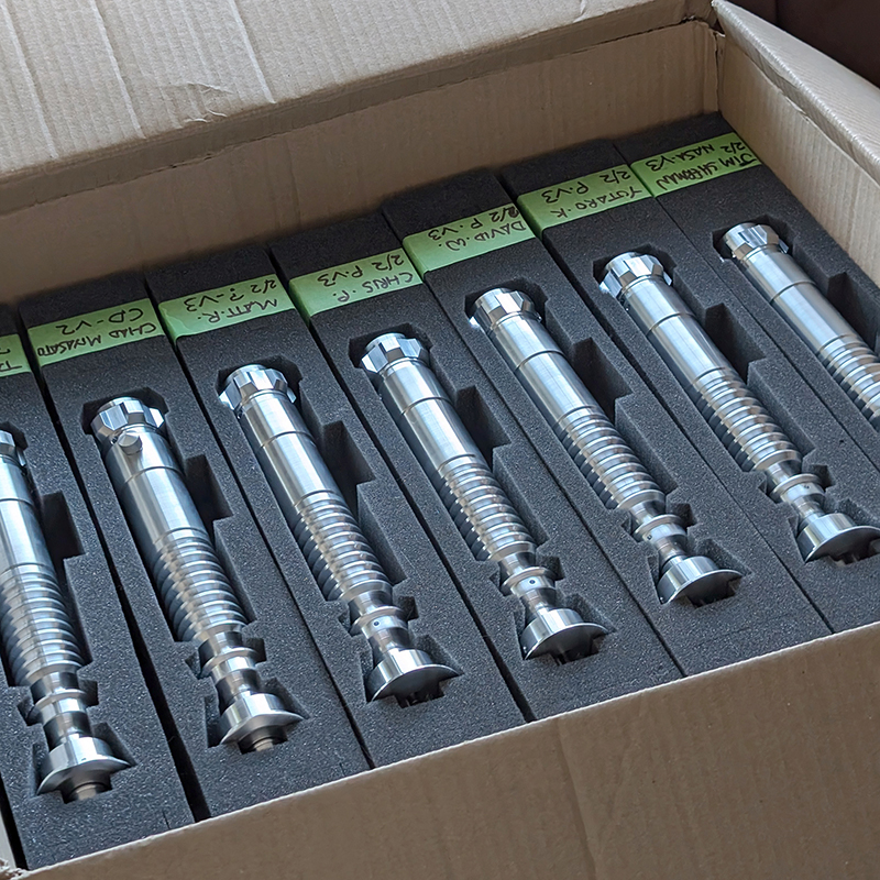

Batch Two is now well underway! Foam shipping inserts have been made and labelled. All Aluminium parts have been selected and I’m in the process of working my way through them and applying physical details such as fixing placements, V3 details, Pommel Damage, etc.
I’m expecting to have all aluminium parts finished and ready for chemical darkening (or stencilling) by the end of this coming week, and have more aluminium blacking solution on it’s way.

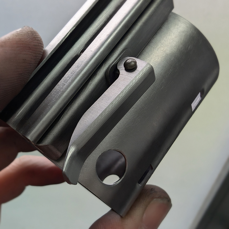

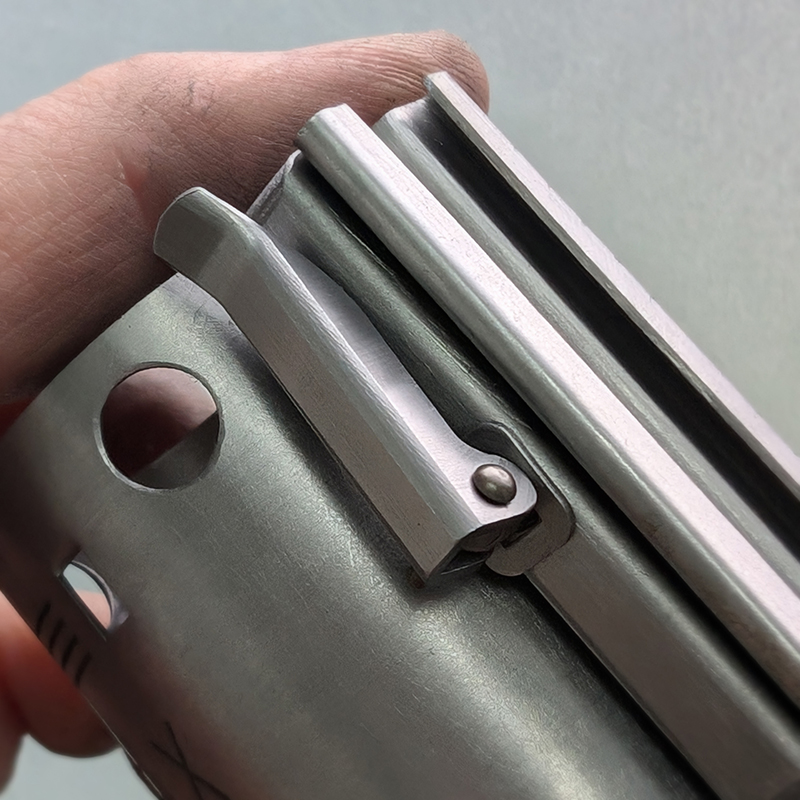

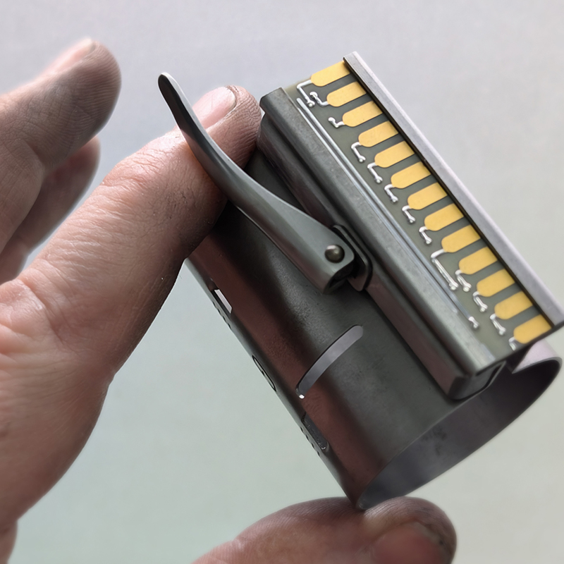

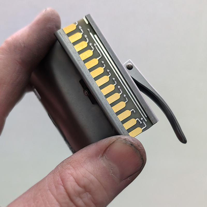

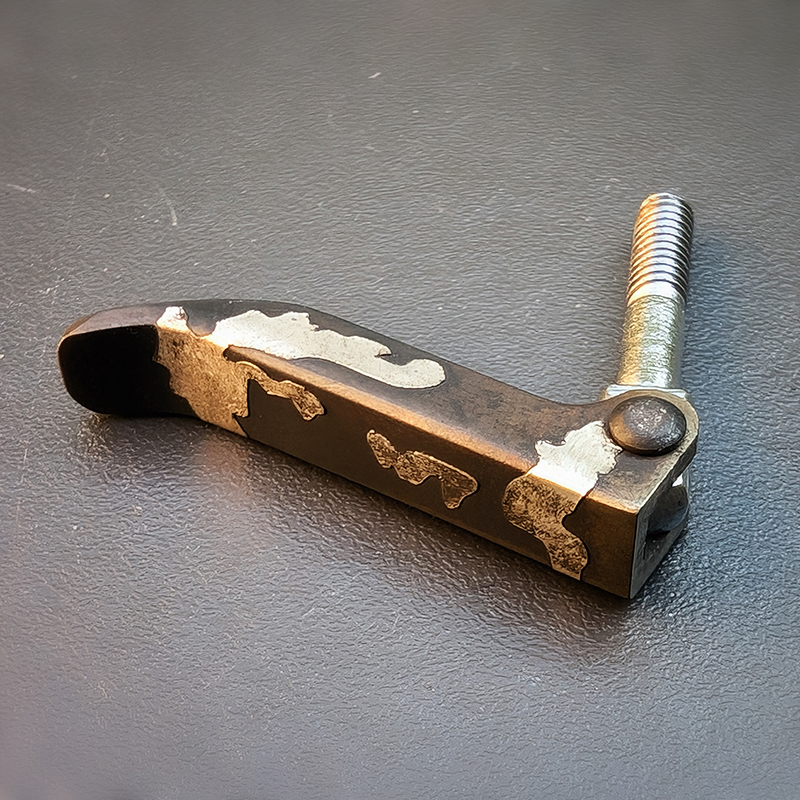

In other news, I have made a template for the NASA V3 lever. I wasn’t quite sure how I wanted to go about doing this. I was either going to create a vinyl mask stencil, and paint on the chrome (after darkening the lever), or cut the chrome out of adhesive foil and apply that way. I opted for the later in this test, and I’m pretty happy with the results. The foil is obviously more convincing that chrome paint, so I think I’m going to use this method going forward.
** This is a spare Roman's lever that I had. I swapped out the pin for a round headed rivet **
I’ll include one of these pre-cut templates in with the DIY V3 Kits before sending out, for those wishing to build the NASA version. (y)

The bending Jigs for these are still showing as “In Production / Producing Parts” but I do expect those to be completed and on their way to me VERY soon due to them being a small, one-off order.

Batch two is progressing well, but not quite at the same stage as Batch one just yet.
Parts have been prepped, drilled, tapped and chemically darkened where needed.
V2s have been stencilled and are ready for painting. I did hope to get some painting done yesterday, but it was extremely foggy and humidity was at 98%. I didn’t want to risk painting in those conditions so I gave it a miss until next week if that’s ok.
Applying the stencils is such a laborious job, that it would be a huge set back to have to strip everything down and start again. It’s far better to wait for a dryer day, and I will have Batch Two painted as soon as conditions are suitable. I might actually be able to get a few painted today.

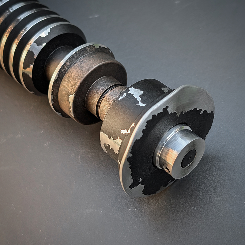

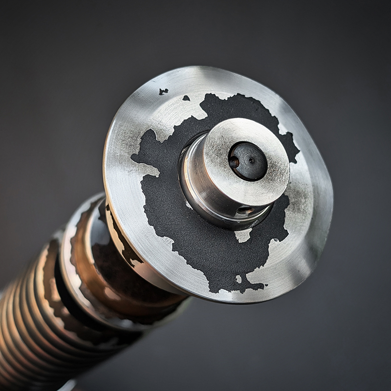

V3 Necks and emitters are painted and weathering is underway.
Prior to painting, the emitters were chemically darkened. They then had the casting flash added. This is done with “Quick Steel” (epoxy putty). That area is then colour matched as a base before applying the gold paint.
The gold paint is darkened using Tamiya Weathering Powder (Set B). I have been asked to elaborate on this process. It is the same method I use for my Hero / ISYHCANL / Yuma commissions.
In order to help the powder adhere to the surface, and for it to build up, I breath on to the surface between applications.
I build up a heavy layer of the powder before wiping back off using a cotton makeup pad.
The resulting variation in the colour has a naturally aged appearance, as apposed to the flat, clean look of the base colour.
The next step is to chip the paint by hand to match the references.

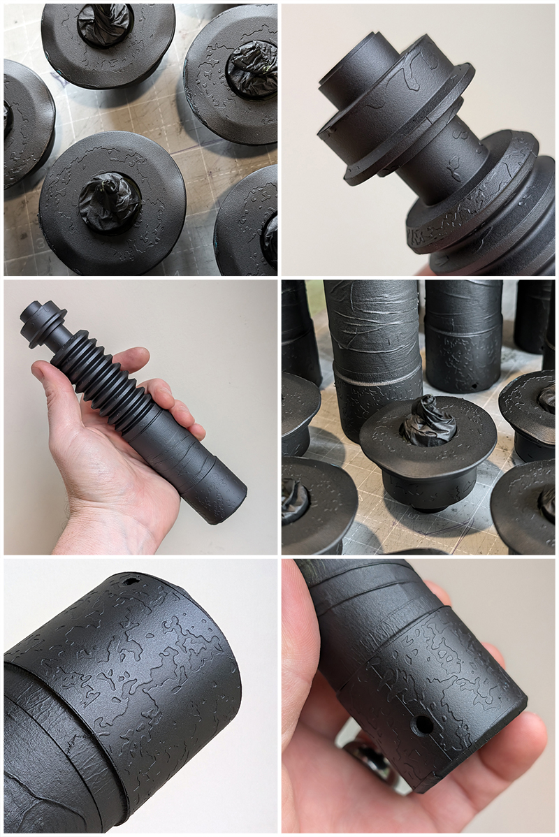

I DID manage to get Batch Two fully painted this past week! We had just one day which was perfect, so I powered through and got them all painted up. I’m glad that I did, because every day since then has been overcast with showers:
I am now in the process of stripping the stencils from Batch Two. I don’t foresee this taking longer than a couple of days this next week, which will bring Batch Two pretty much in line with Batch One (Clamps are assembled and ready to install).

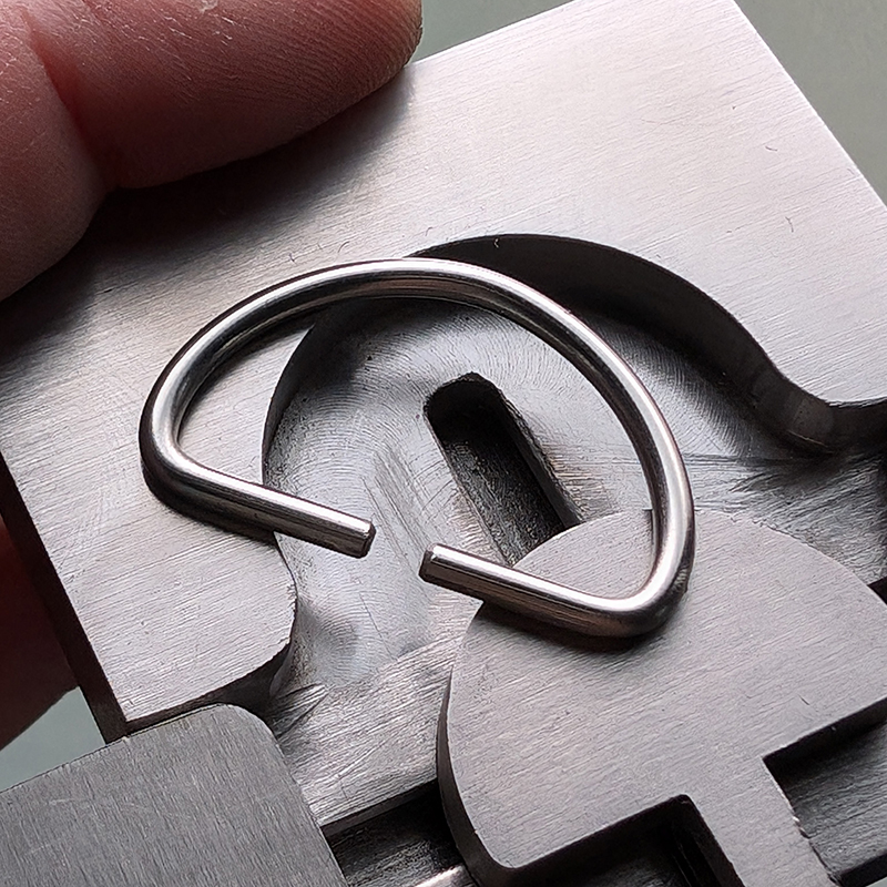

D-Ring Jigs are FINISHED! They are now showing as “SHIPPING”! To be precise, the exact status is “In transit to our warehouse”. When they arrive here in the UK, they will undergo final quality checks before being forwarded to me. I’m expecting them to arrive this week hopefully and have the materials ready and waiting to get the D-Rings made up and installed as soon as humanly possible!
It's my hope that before the end of this coming week, I’ll be in the process of shipping all DIY / Batch One /Batch Two orders. (y)

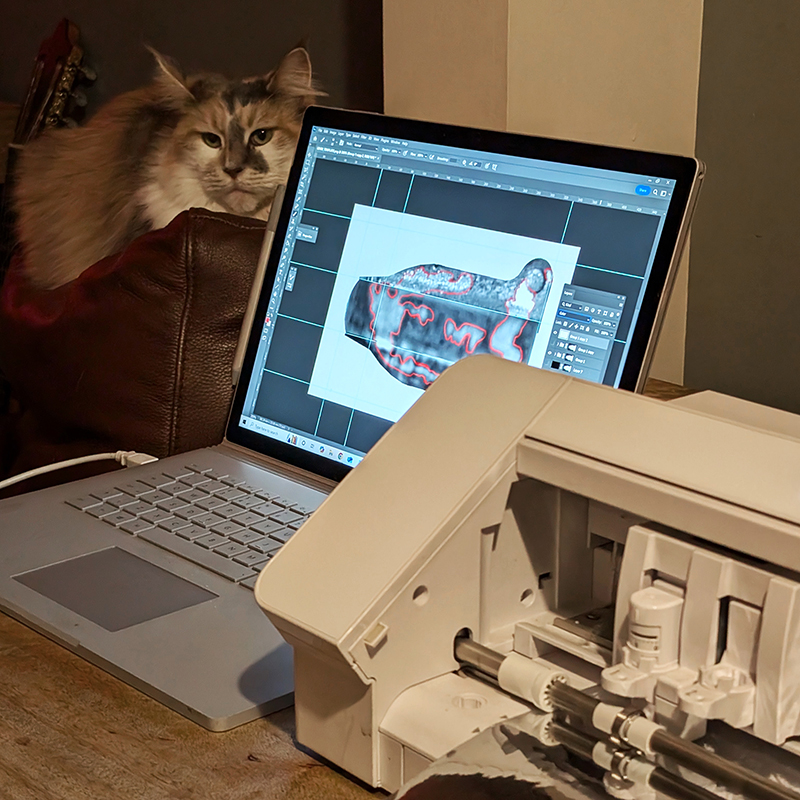

Preparations are already underway for Batch Three. Over the course of this weekend, I’ll be preparing and labelling the foam shipping inserts for Batch Three. These will then be filled with their corresponding parts, ready for detailing. (y)

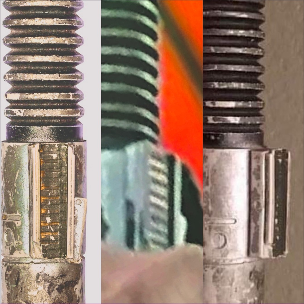

On a slightly different note, it’s been brought to my attention that there has been some discussion (and even drama) relating to my decision to use the bubble strip for the Sandstorm V2 Commissions (and the Vectorbord for the Production V3).
I’d just like to reiterate that these creative decisions were based on my own personal interpretation of the reference materials. I don’t presume to claim that these are 100% correct with any degree of certainty. The references for the Sandstorm V2 in particular, are very unclear.
My decision to use the bubble strip was based on what I considered to be wider spacing in the vaguely discernible features than the spacing that is seen on the current day clamp card.

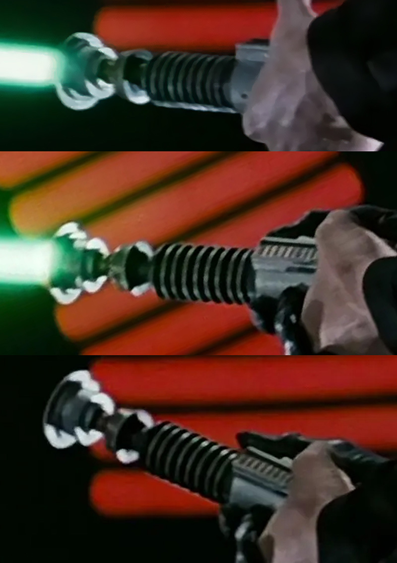

I also noticed what appear to be rounded, raised features in the Ewok village reference:
I figured that it was not completely outside the realms of possibility that the clamp (which is 100% the clamp used on the motorised Obi stunt) **could** have retained it’s original bubble strip from the first movie.
**Please bare in mind that there is a lot of noise / interference in both of these images.**
Based on what I could see in the references, and the fact that I really liked the link to the prop in it’s original form, I made the decision to include this as an option.
This IS only an option though, and the decision was never intended to undermine other people’s interpretations.
My V2 commissions will be sent out with both options, so it’s really down to personal preference as to which option is used. Swapping them takes a matter of seconds.
The same applies to the V3. I personally really like the look of the Vectorbord in the post production V3. This was based on my interpretation of the prop as it appears in these shots:
It looked to me as though the traces seen here were bridging the full width of the gap in the clamp.
It has been suggested to me that the prop seen here is not in fact the actual V3 though, but rather one of many resin casts. So the finer details (which were painted by hand) should be disregarded.
The board which was used at the time of casting the V3 was certainly the Otis card. The traces can be seen in the remaining castings.
I’m in the dark as to when the actual V3 moulds were made though?? Any concrete information on this would be welcome, as it could shine a light on what was actually installed at the time of filming ROTJ.
If the moulds were made back in 1977, and the Otis card found it’s way in to the ESB Graflex, it could explain why the V3 is seen here (on the set of ROTJ) with it’s current-day Brass clamp card installed:
There are no clear shots of the throne room V3 that I’m aware of that clearly show the exact card used during rehearsals/filming.
So, as with the V2, I’m not in any position to say for certain which card would be most accurate for a “Production” V3.
I’d be inclined to lean towards the Otis card **IF** the moulds were made specifically for ROTJ, but if they were made prior to ESB, I’d lean more towards the brass card that is present today (and was certainly present at the time of filming).
It’s an interesting and fun thing to speculate on though. I do still like the look of the Vectorbord, and will continue to offer it as an option. The Brass strip (with black tape) will be included as an option too. I’m happy to install either as part of your Production V3 commissions. It is very easy to swap these out as you see fit though.
If you do decide that you’d rather have an Otis card in your V3, replicas of these are widely available and very easy to swap. I’d recommend Slothfurnace, who offers a variety of options, and whose cards are always of the highest quality.
As I’ve said previously, I do not claim to have any certainty on these particular details. My interpretations are just that, and not in any way intended to undermine anyone else’s.
I go out of my way to avoid internet drama, and would just ask that people discus these things with mutual respect. This is a hobby after all and is supposed to be fun.

No card present on the gangway rehearsal:
Throne room- cast with the ‘Otis style’ card. It has been painted gold over the surface.
You can see a distinct chip on the left clamp rail which matches the auction, as well as the gold paint remnants.
lol thank you for clarifying
Also ITS NOT AN OTIS CARD people obviously keep reading this places and it’s sticking.
For everyone: There is no elevator board in the original Star Wars films. at the time I discovered them they were the closest we could find and today we’ve found boards that are even closer, still no match. It’s not a confirmed part, please stop paying and selling them as if they are screen matched.
Thanks for going the extra mile to put me right on that, Bryan (y)
I had already come round to that particular shot being one of the resin casts, but if there was any doubt, that triangular chip in the clamp confirms it 100%.
Thanks again for going out of your way to set the record straight.
I was sure I could see strips running perpendicular to the gap in the clamp:
On closer inspection though, those features certainly don't match the spacing on the current card. The feature at the centre point in the gap could well be the lever bar too. It's pretty hard to make out for certain, but yeah, I can see how the card could be missing entirely. (y)
So, I've been agonising over this (on top of everything else), and I really don't feel right about having people pay for their own replacement cards... The profit on these is not what you might think. The vast majority of the Kit price just about covers manufacturing. The commission then just about covers materials and keeping the lights on over the course of the run. Things are tighter than you might think.
This is an oversight on my part though, so I've decided to take the hit.
I've just placed a large order of "Otis Style" cards from SkyWampa over here in the UK (so should hopefully arrive pretty soon if not immediately). I'll be including these in V3 Kits and commissions. I've paid for these out of my own pocket. To be honest the hit to my pocket is worth lifting the weight of this off my shoulders.
I've ordered enough to cover Batch One, Two and all DIY kits for now.
I'll get some pictures out of some finished V3's with these installed as soon as they arrive. (y)
I have just had to increase the price of the few remaining V3 kits unfortunately. This is just to cover the cost of the additional cards which will be supplied (along with the brass "NASA" card).
I will cover the cost on any existing orders. (y)

You may have seen on FB / Instagram that the bending jigs have finally arrived, and are working!
They arrived a few days ago, but required some additional work to get everything fitting together. I didn't allow for sufficient clearance between the parts so they required some filing/sanding to get everything working. :rolleyes:
After many (MANY) hours of work, I'm happy to say that they are now functioning as intended and producing beautiful, accurate D-Rings:
I will be selling these separately for those who need them. Please bear with me though, whilst I turn my full attention to catching up with the run!
I will be working flat out today to get rings made up for DIY kits and to get those booked in for collection tomorrow. (y)
