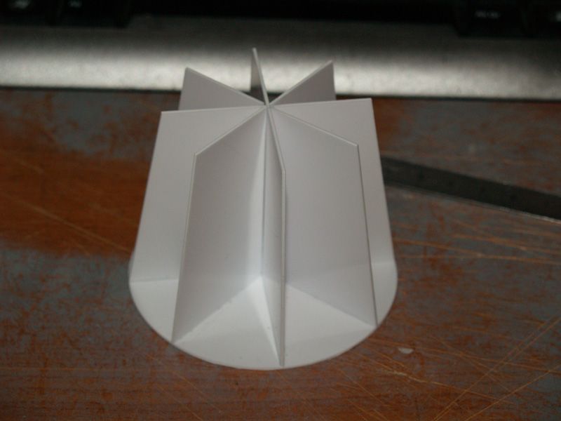

So first I built this :
Then wrapped it with 4 layers of 0.5mm styrene. The 2 inner layers are shorter to create a lip.
Eventually I ended up with that :
I was very happy ! Almost perfectly round (Im sure it's rounder than the original :p), very strong and light.

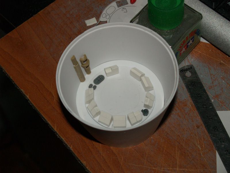

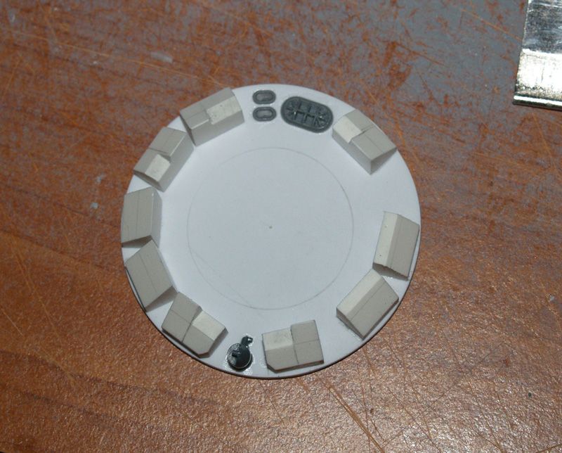

Then I cut those 9 blocks. None of them are perfectly identical :
On the round plate, with some greeblies :
Dry fit :

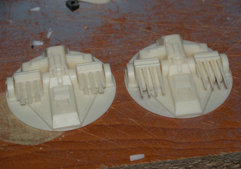

For the ones who followed this thread you may remember I built the master for the laser turrets. However I had one more part to build, the support of the guns.
I also molded the guns because I need a ton of them (16 for the turrets and plenty of them for all over the trenches). I have enough real kitparts for the turrets but I dont want to run out of them so I did a mold, I'm not sure I'm going to buy more of those PoW kits since I only need them to detail the trenches and the leading edges of the hull so I will probably cast all the parts I need.

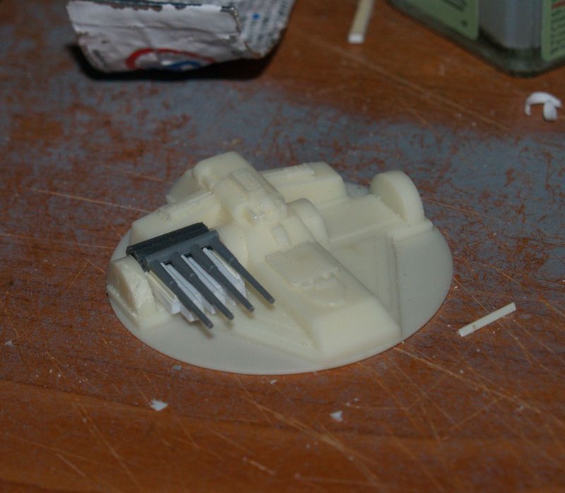

Well now the laser turret platforms... well at least the hero one ! :D Took me 3 days to build it and it's not finished yet :
The small black platform took me 3 hours to cut, fit etc... I thought that would be very quick to do but no.
I think most (if not all) of the lines of the platform were penciled, however I prefered to scribe the main lines. It will help to pencil the other lines.
