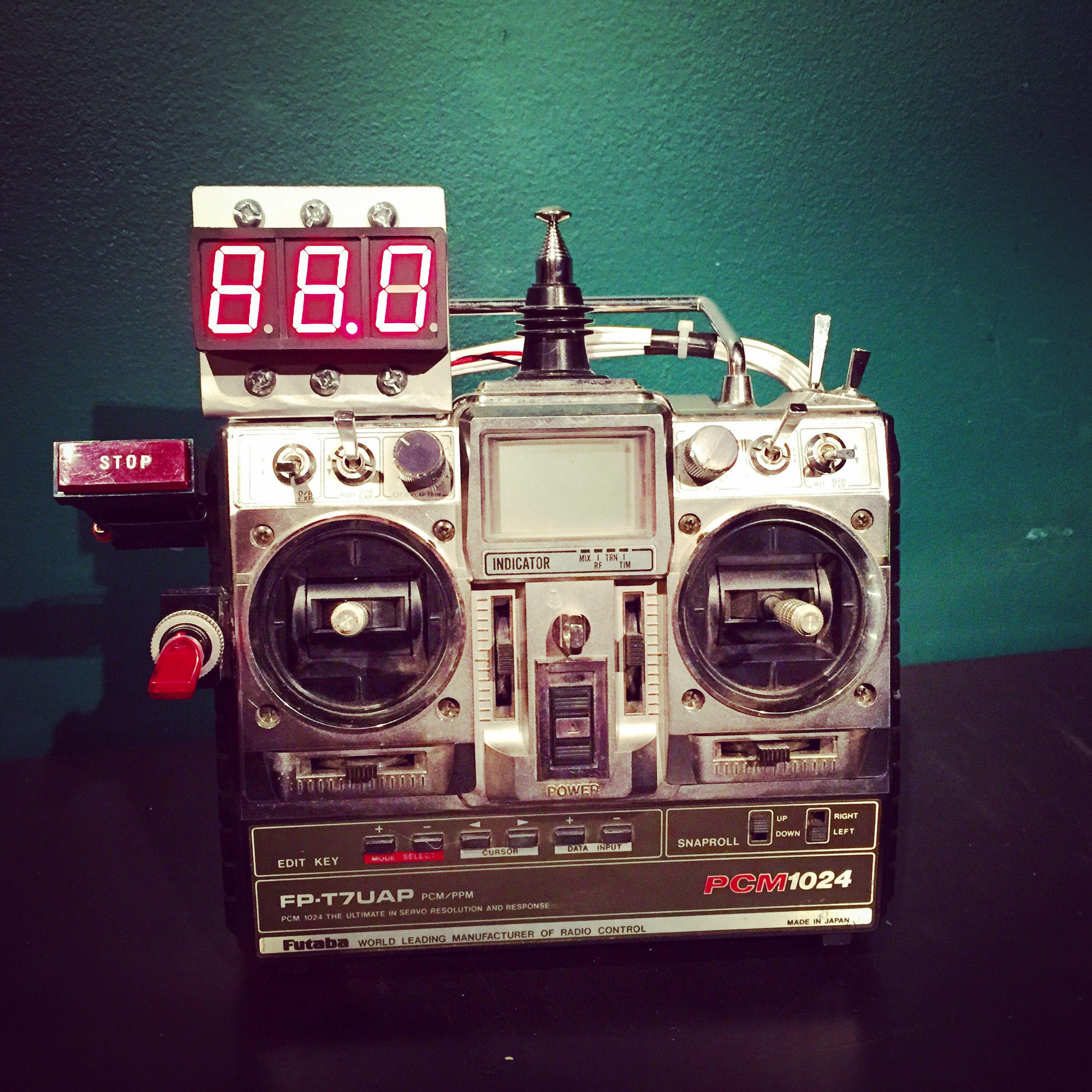

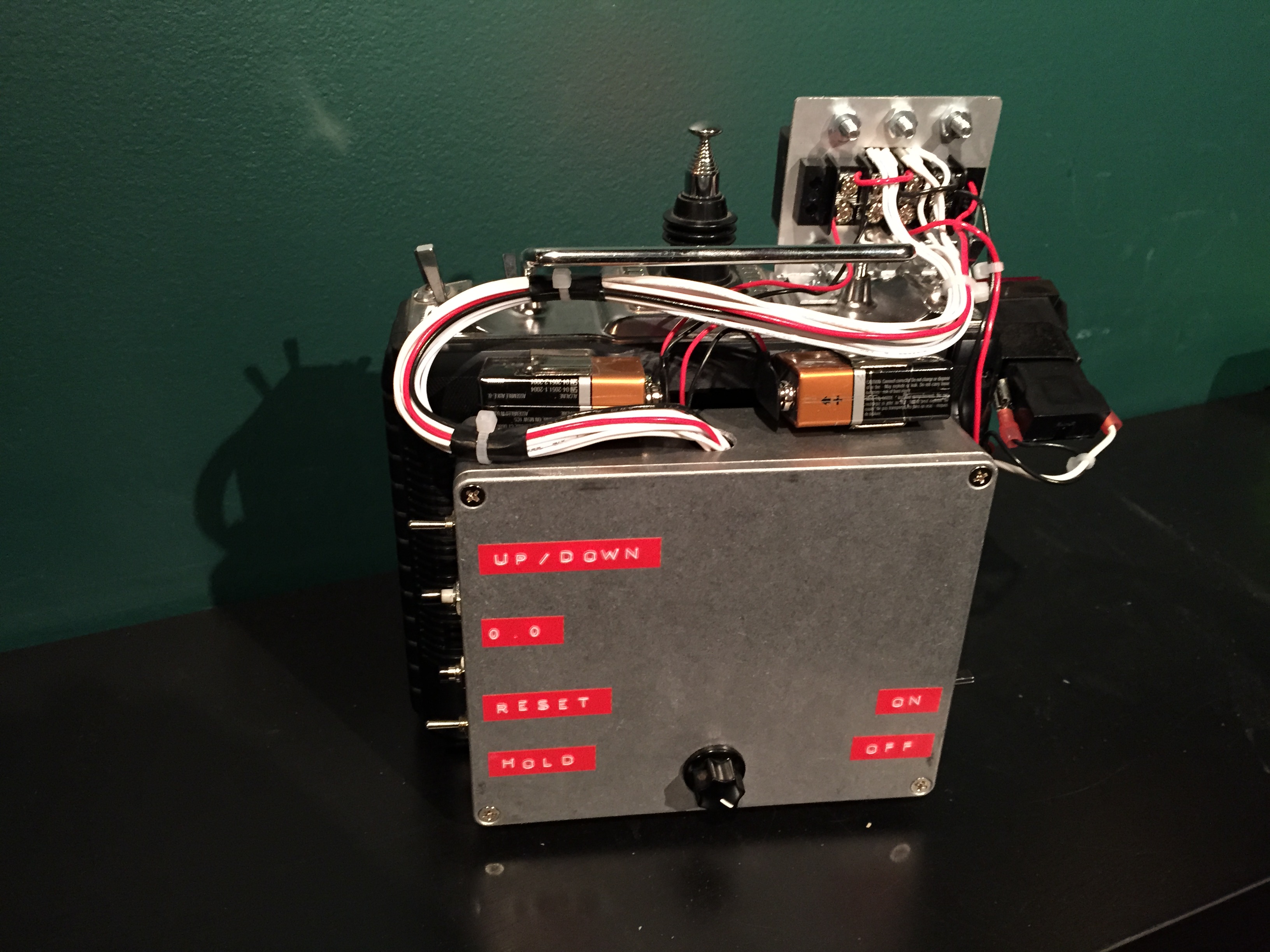

I wanted to post a thank you for helping me create my BTTF remote. This forum has been an amazing resource for finding the parts to build my version.
I took a few liberties with the parts since it is a little tough to find the exact Futaba remote. Even with the few minor differences my friends and family are still just as excited to play with it. :)
To get it working I used a arduino UNO and a 5 button birthday card sound module. I created the Boot up and Counter SFX from Scratch. Enjoy!
View attachment 497399View attachment 497398
HERE IS A YOUTUBE VIDEO OF IT IN ACTION.

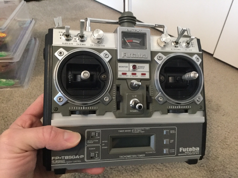

Hi all. I just got my hands on a Futaba over the weekend and have decided to give this a try too. I’ve been looking for an excuse to get into Arduinos, so this will be a great chance to do so, as I hope to program one to drive the FX for the remote. Thanks to everyone above for all the useful info, as I now have additional parts on the way for my build.

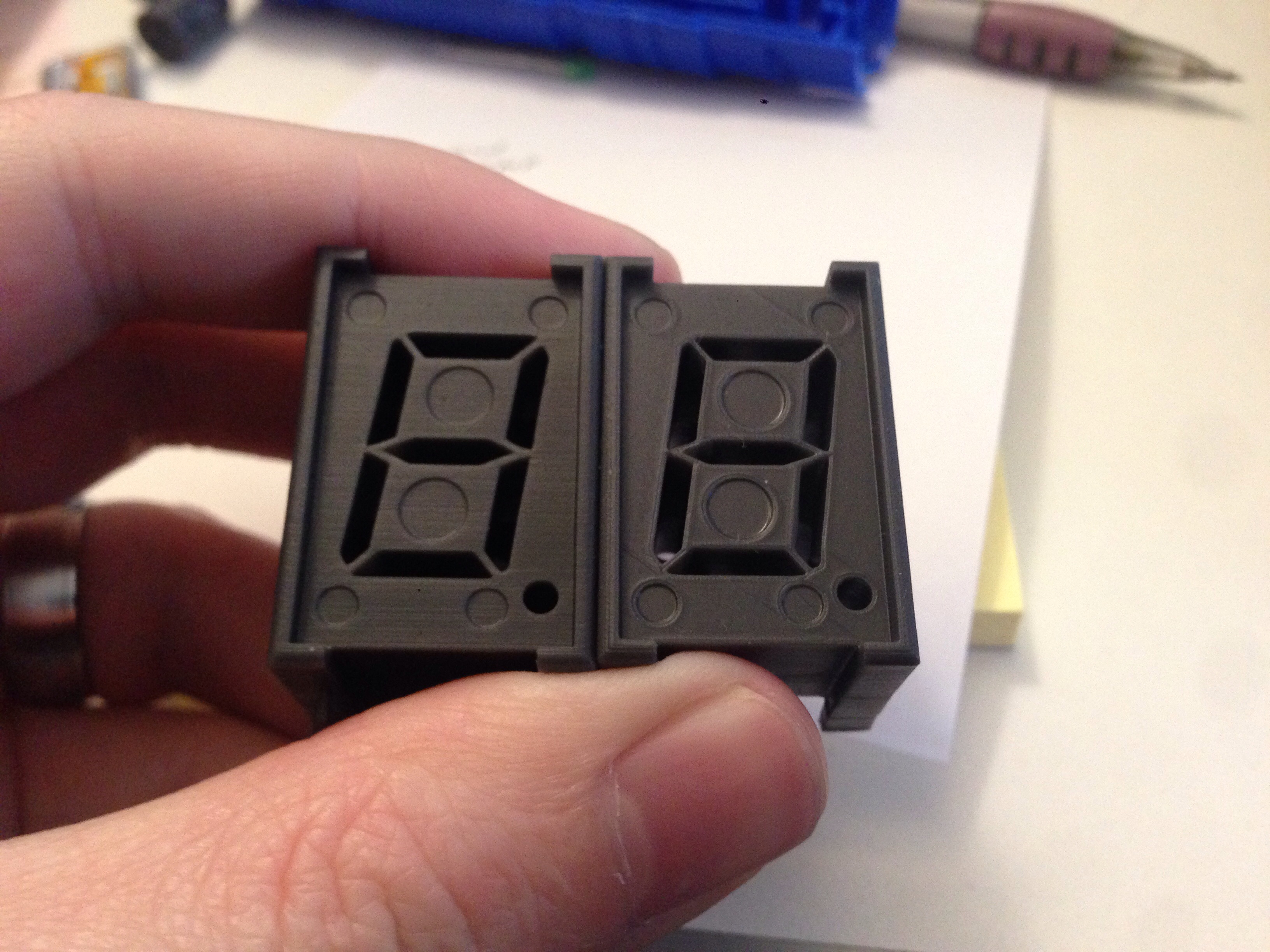

I printed a test one a few years back, only had to make minor adjustments to the segment divider thickness to get a good print. Model was based off a resin casting of a real one. I never went back to it adjust the model for LEDs and such though. I’ll try to dig up pics.
This was the first one I tried with accurate divider thickness, you can't see in the pics but the dividers failed in places because they were a bit too thin.
These were ones with the dividers a bit thicker to make them more easily printed.

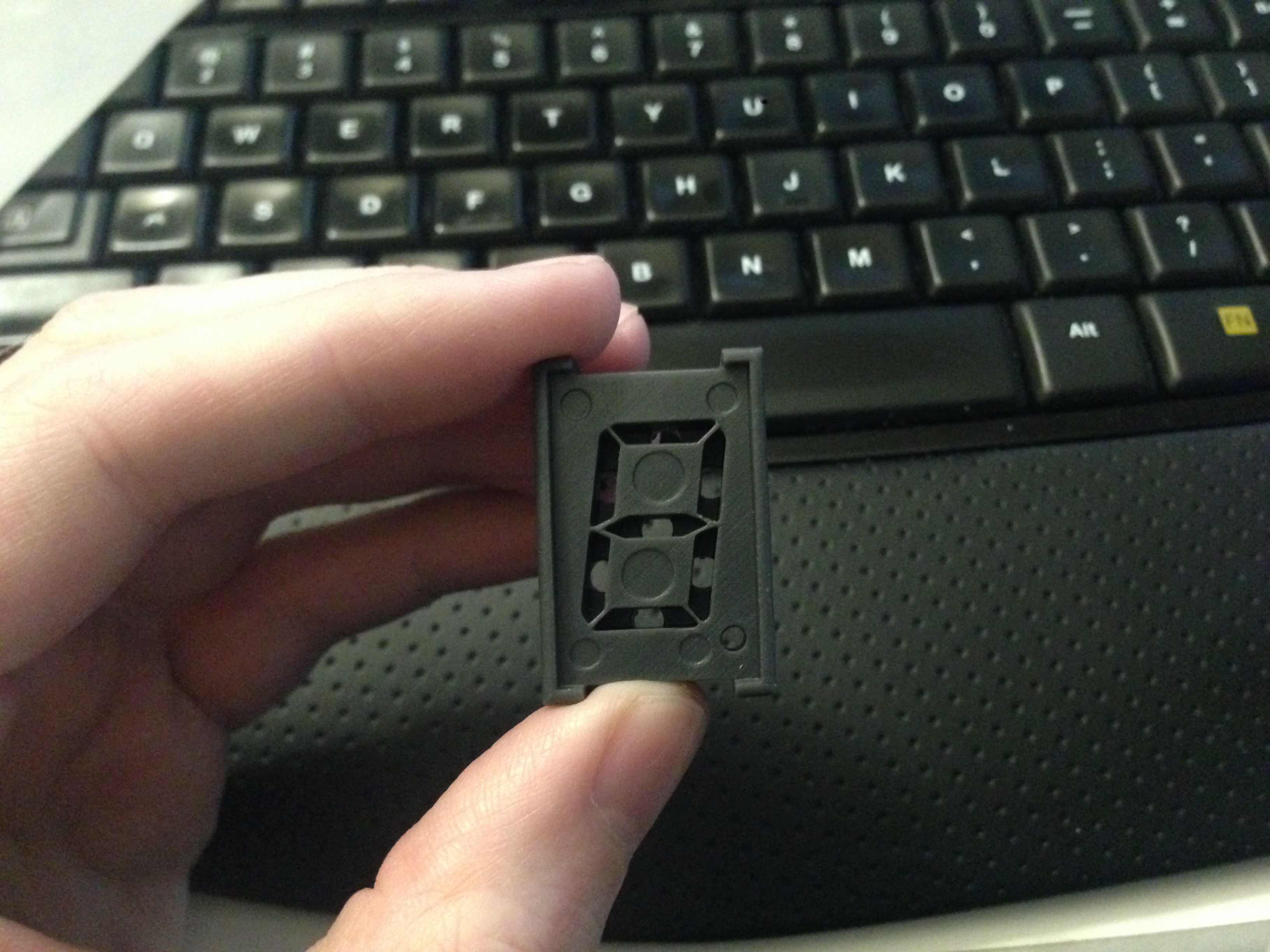

I had the same problem in mine, had to thicken up the divider. I made my one piece instead of the multiple parts put together. Just need to make a circuit board for lights, and a back cover. Also the clear front covers but those shouldn’t be the end of the world.
Ha ha yes I tried to copy all the details of the original, thought the injection circles certainly are necessary!
