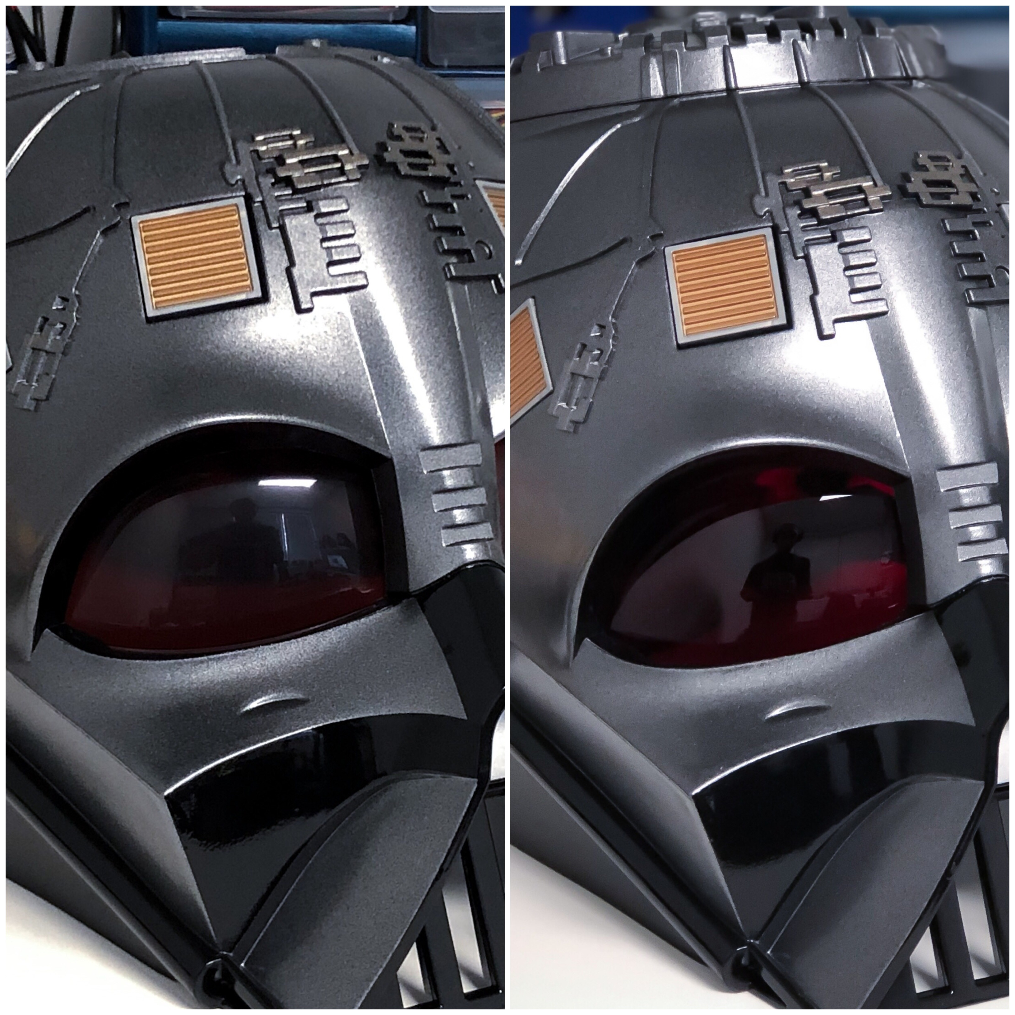

With that being said, the new lenses are here and look AMAZING. They will need to be cut down to fit but I recommend them. They don’t match the exact contour of the originals which leaves a small gap between the lens and the top of the eye hole, but you can’t see it unless you flip the helmet and are looking for it.

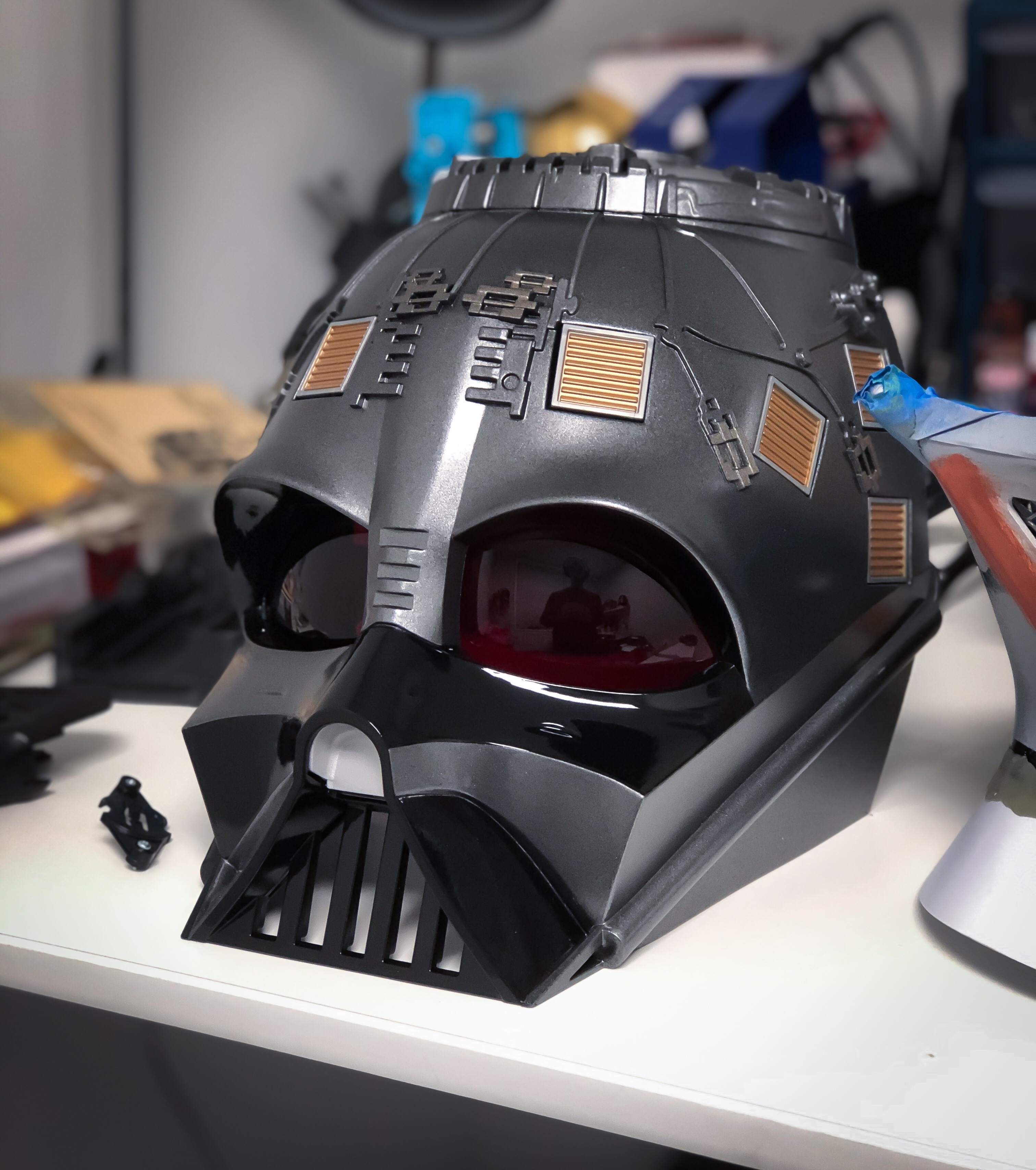

I also finalized the collar extension and am working on blending it in to the mask.
Been a while since I’ve been able to make progress on my Vader helmet but I finally got the lenses put in. They are amazing but do not fit the curvature of the originals. Since mine were damaged, I cut them out of the lens “assembly” so I could have something to mount the new ones to without gluing them to the helmet itself. Since the new ones didn’t match, I used some epoxy putty to make up for the gap they had at the top. This helped with making sure they had more surface to adhere to and not have light show through. This wasn’t super easy but the results speak for themselves!

Thank you! I considered making some myself but for the sake of time and materials, $25 for a pre-made set was worth it. If you ever thermoform some that are a direct replacement for the ones that came with the helmet, let me know!
