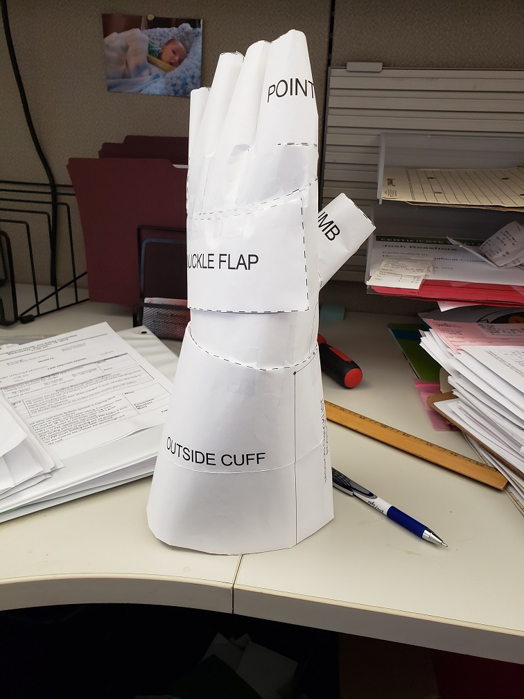

Put an extra printed pattern to the scissors over lunch and did a mockup for the left glove. Everything goes together pretty well, I imagine any difficulty encountered with getting things together was due to it being paper vs fabric. Looking forward to starting soon once I get my white nylon.
