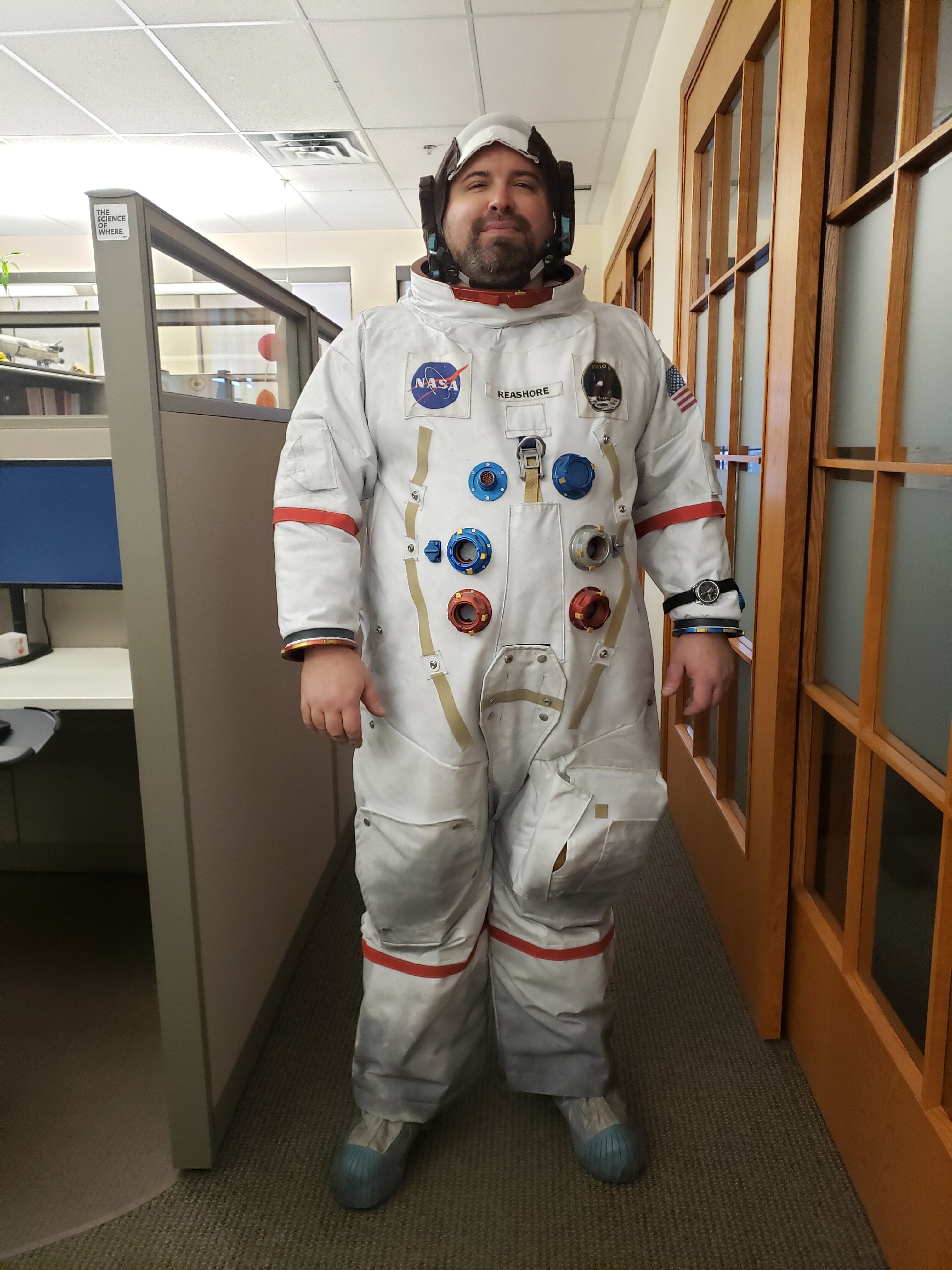

Rocking the A7L at the office today, gunning for 1st prize in the costume contest. A steady supply of gatorade is key to avoid dehydration in this haha.
