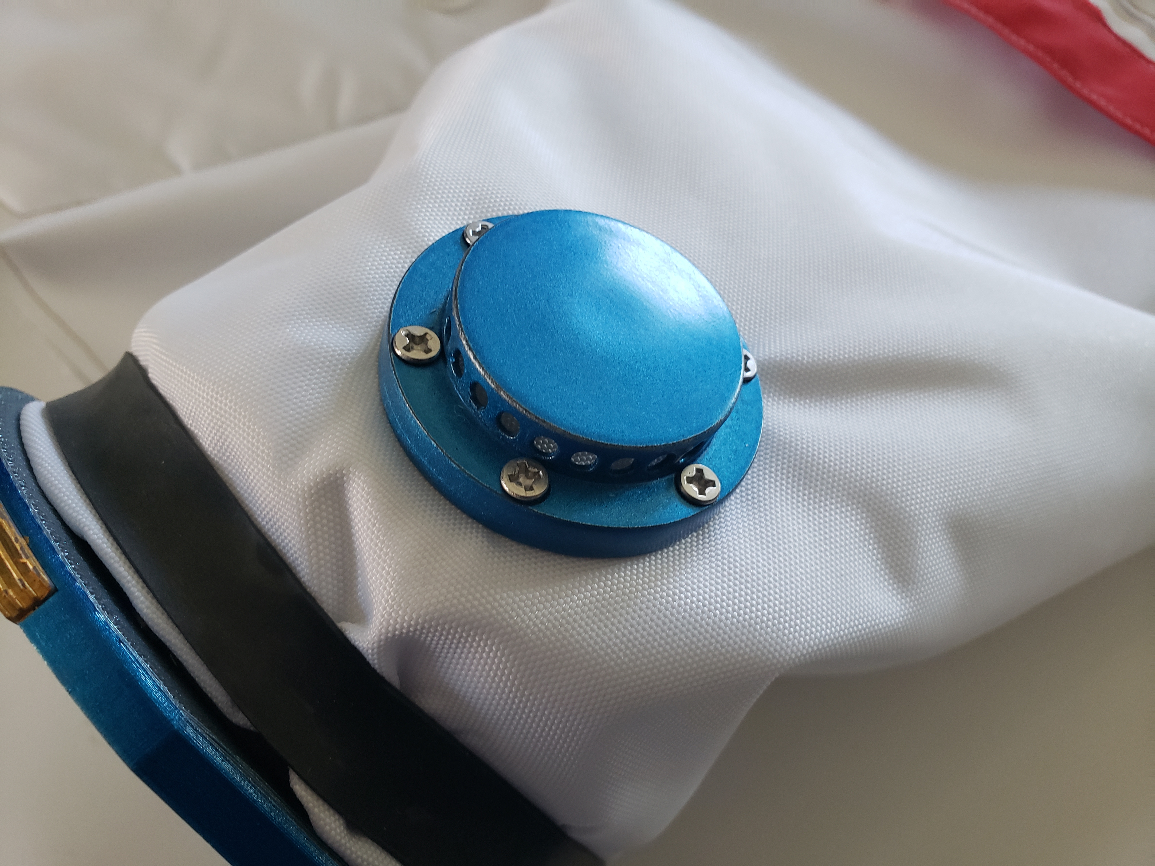

Installed the pressure release valve today. Screws are temporary until my slotted ones come in the mail. Starting to add the little detail parts to the suit gives one the impression of getting close to the finish line.
Awesome discussion points! All of my ref photos of Buzz's suit show that fitting and diverter as being silver. But you would know more so I'll take your word they should be blue and adjust accordingly!
As for the H2O and electrical connectors, they are just placed there for the photo, I have not cut the suit for them yet. I'll be sure to mount them properly. :)
That is just fading in the anodization. For some reason, different connectors faded at different rates. But they should all be red or blue, like Imgill said.

My slotted screws arrived, so after about an hour of removing Phillips head screws and replacing them with slotted screws, everything is proper now. Definitely makes the connectors look nicer and more accurate.

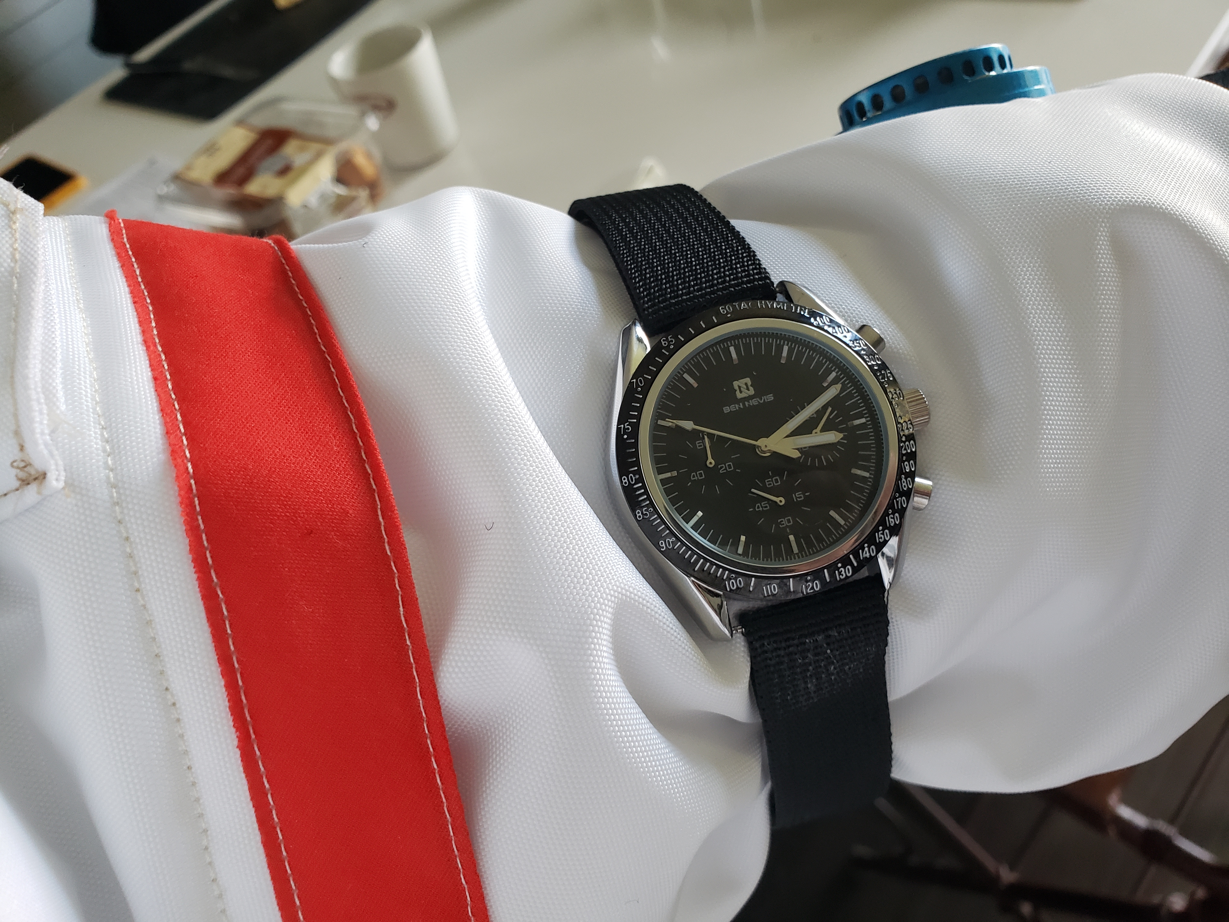

My speedmaster watch is apparently scheduled for delivery now this Thursday after being caught up in customs, so looking forward to that and getting it onto the suit.
Annnnnnd I was had.
Got my watch today, it's a great replica of an Omega Speedmaster, except it doesn't SAY "Omega Speedmaster" on it but "Ben Nevis".... Oh well, Paypal claim inbound, and it's close enough in the looks department that I'm going to use it.

Annnnnnd I was had.
Ah man that stinks. I dont know where you live, but you can prolly find the correct replica on Canal St in NYC or the Garment district in LA. It took some asking around but I got mine in NYC. A guy on Ebay.UK was selling the correct NASA strap with the correct tags a few years ago.
Canada, north of the Maple Curtain I'm afraid.
