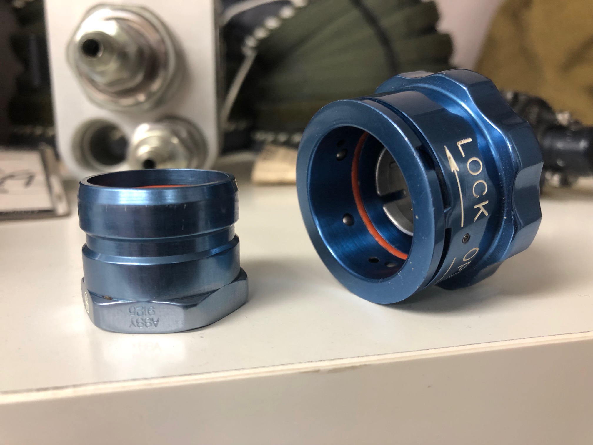

Here is a photo of an actual Airlock Apollo electrical connector. On the left is the part mounted to the suit (Less the base disc) It's .907" tall and 1.067" in diameter.
I was going from memory in my earlier post, but you can now clearly see the circumferential groove , which is flat bottomed and centered on the fitting.
Weird. This is a photo from the Armstrong Suit. Seems different... still some differences to the model. I will make those adjustments tomorrow.
It's the same outer blue anodized piece. Has to be, they both connect to the same cobra head. What you see different in these shots is a central assembly that holds the electrical connector protruding out the top a bit.

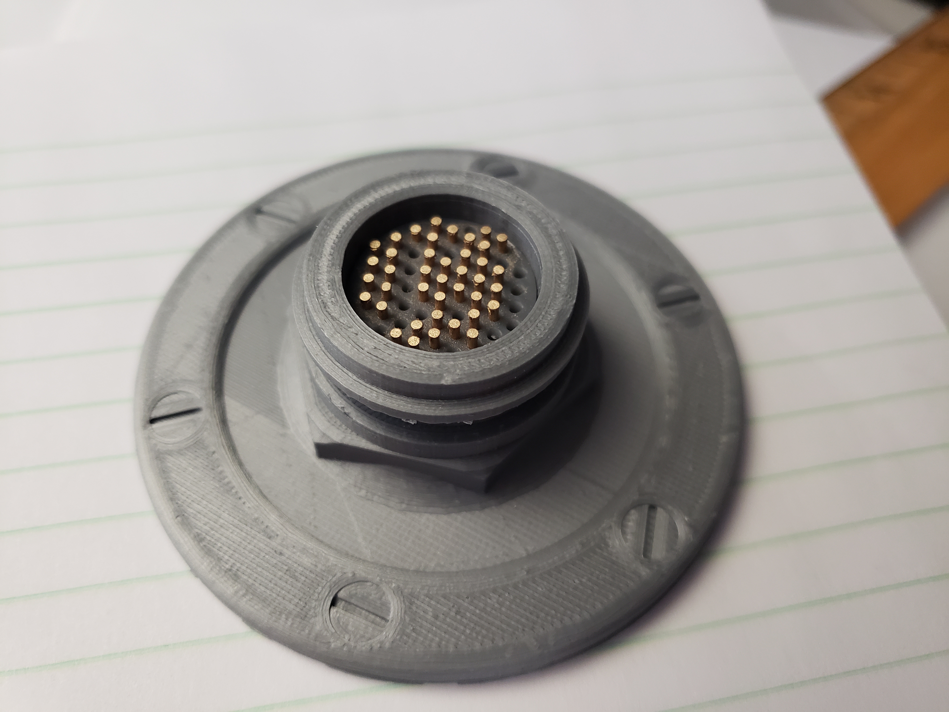

Well as this part isn't accurate, figured I would test out the method of using wire to replicate the electrical contacts of the part. Using 1.00mm brass wire, straightened then press fit into the holes of the plug. Roughly trimmed to length with a side cutter then flipped the whole plug upside down and sanded with 100 grit to get all the contacts level. Finished up with some 180 and 220 grit to polish it up a bit and inserted into the connector.
Hopefully will do the same when I get my hands on some accurate connectors.
Look nice, but I think the pins should be rounded, not flat on the ends...
