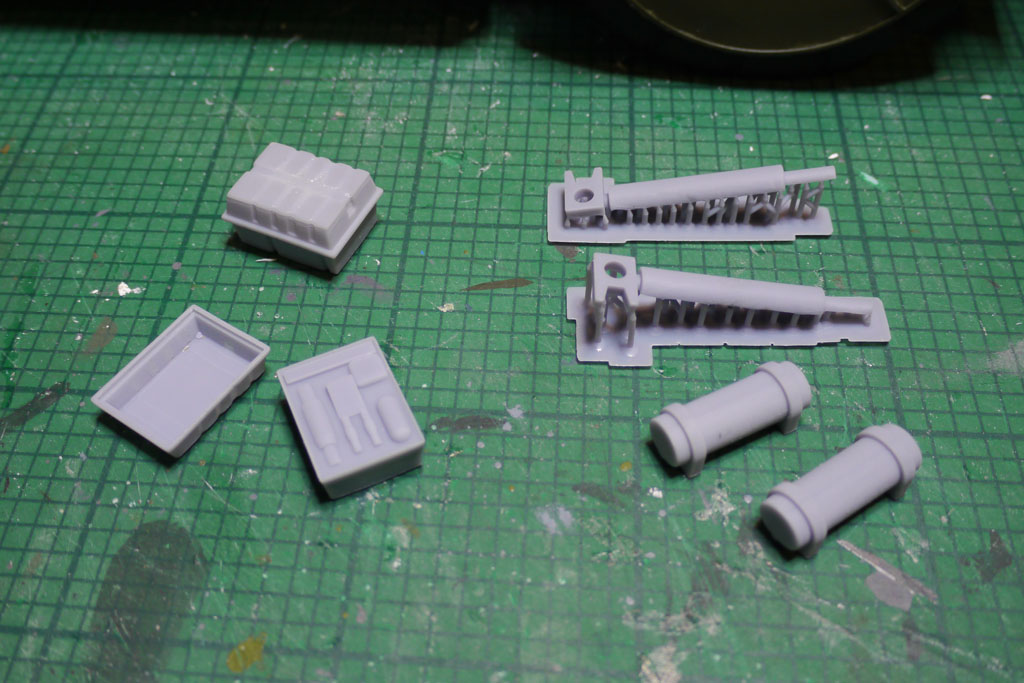

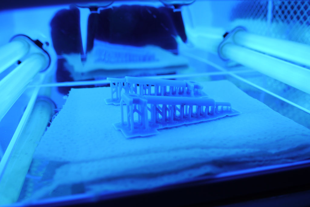

I've some new parts cooking in UV. I left them on their support for now so I don't damage them in handling before they're cured properly.
I took advantage of another round of resin printing and made a couple of copies of the Sentry Gun cases I previously printed in filament. These ones have a suggestion of contents and the lids snap on/off perfectly.

Does UV curing only affect the surface, or does it penetrate the pieces?
Initially it creates a hard shell so that the pieces can be handled. It will penetrate over time on thicker pieces (the resin isn't completely opaque) but it's best to make them hollow if there's a lot of mass there in resin. I'll be printing in clear resin soon so we'll see if the curing process is quicker. You'd think it would be.

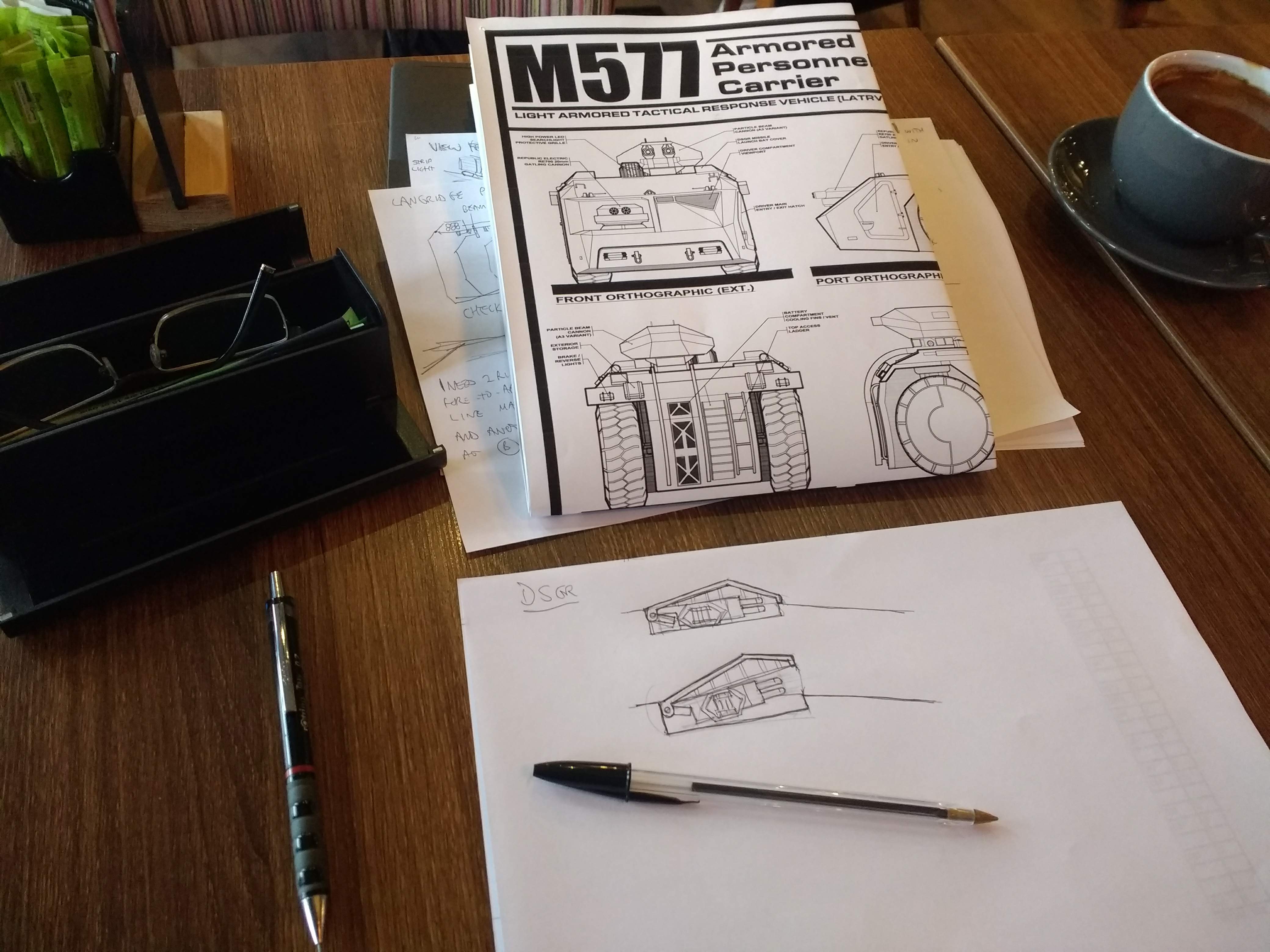

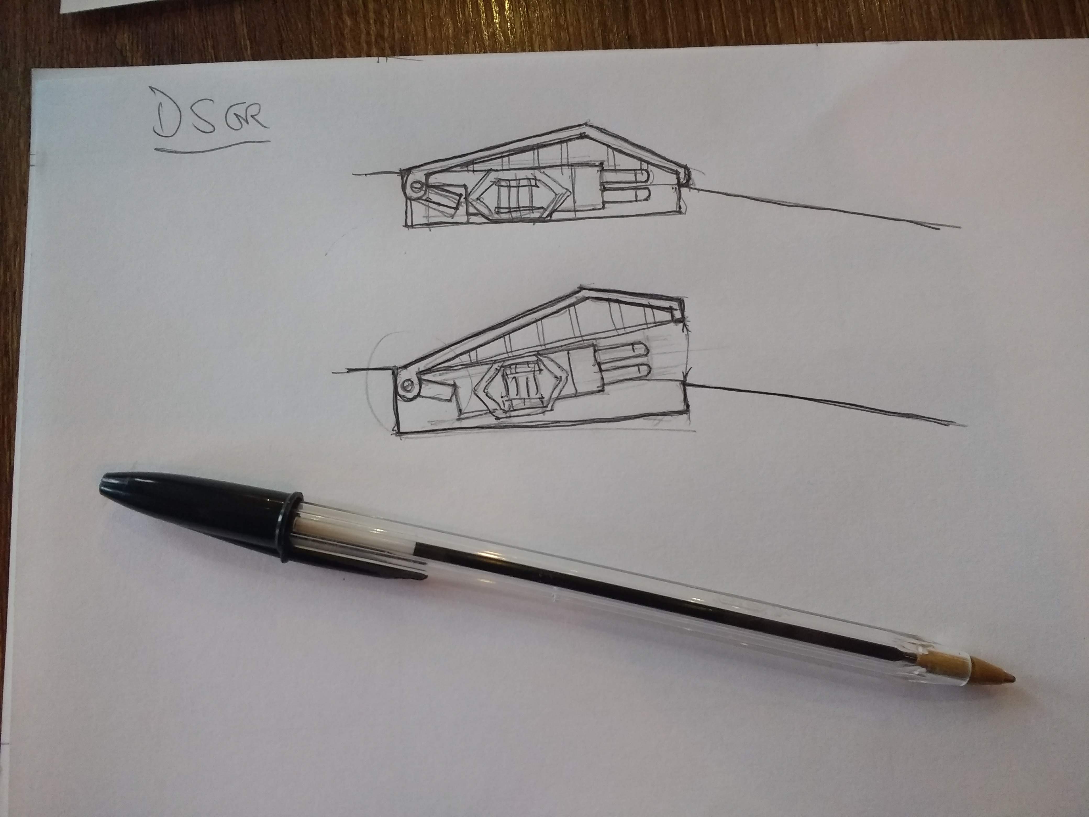

So, I'm sat in our local coffee shop with the missus. She's working on her short story and I'm tinkering with ideas for the APC.

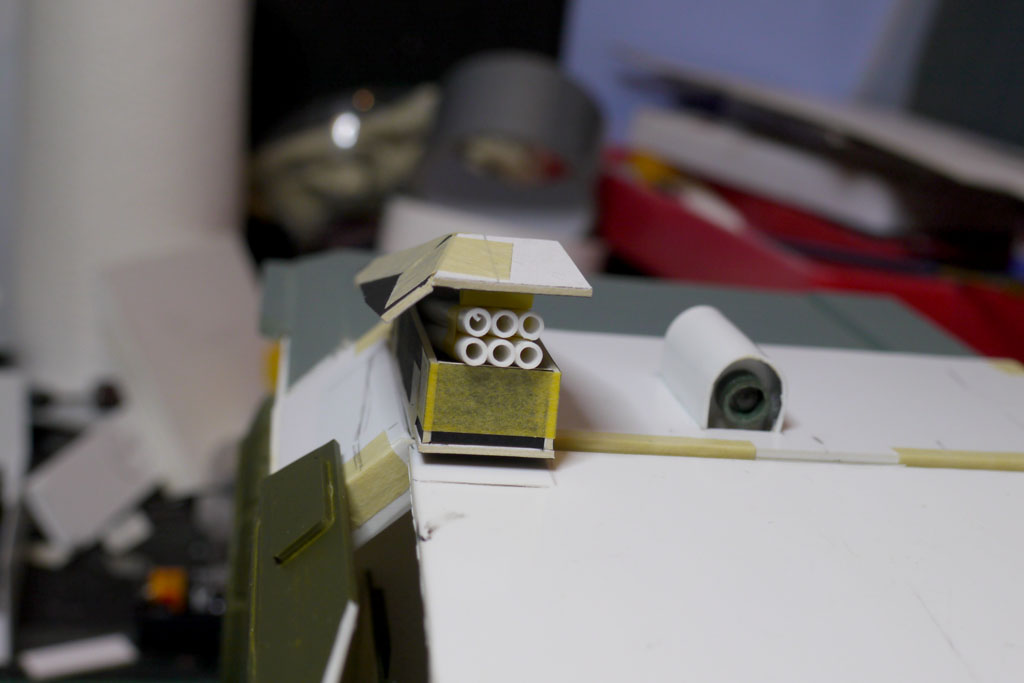

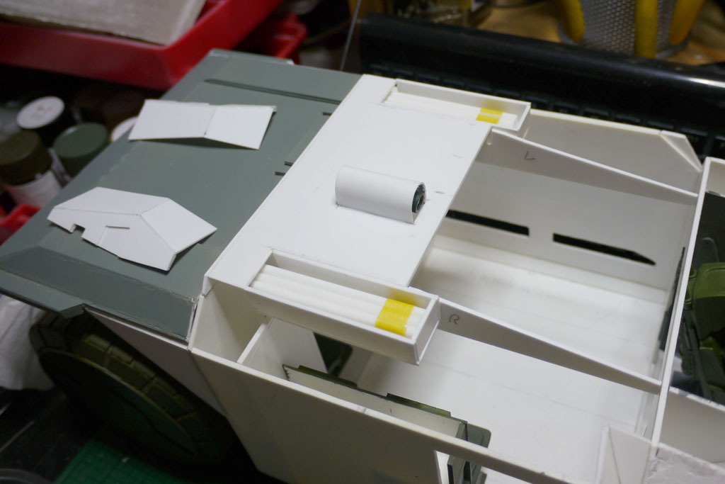

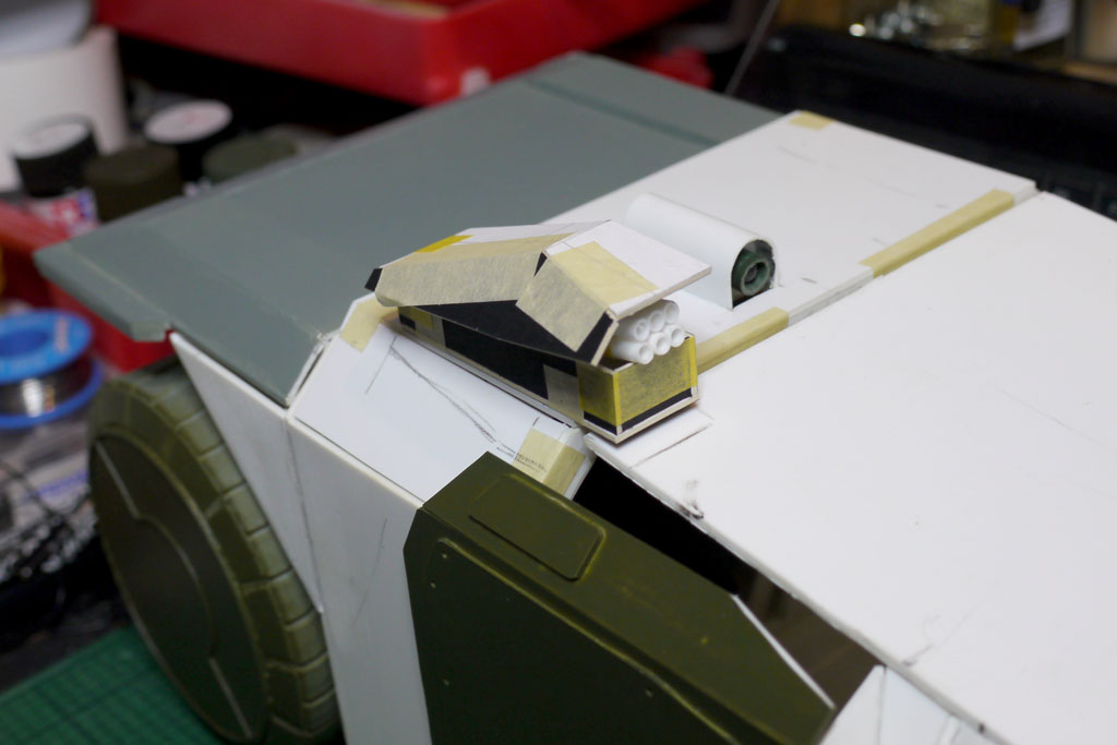

Call me crazy but I'm seriously thinking of making the DSGR missile system a functional feature - at least as far as opening up. I'm having to deal with some interesting planar geometry for the ceiling inners/outers at this point anyway so I figured 'how can I make this even more tricky to achieve' lol.
Ah come on! You've said it, now you've GOT to do it! (y)
I think you're right Duncanator. :)

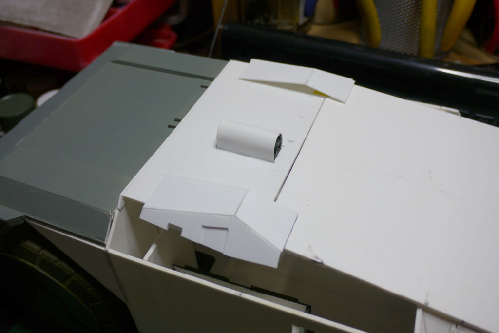

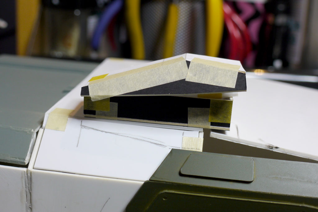

I've done some fiddling with card and I reckon it'll work. I knew all those Chupa Chup sticks would come in useful for something. :)
It's just sat on top at the moment but hopefully it'll work well.
I'll make some rounded warheads for the ends of the missiles and detail out the bays.
Next up is cutting out styrene copies of my card shapes and sorting out how to keep the rest of the roof detachable.

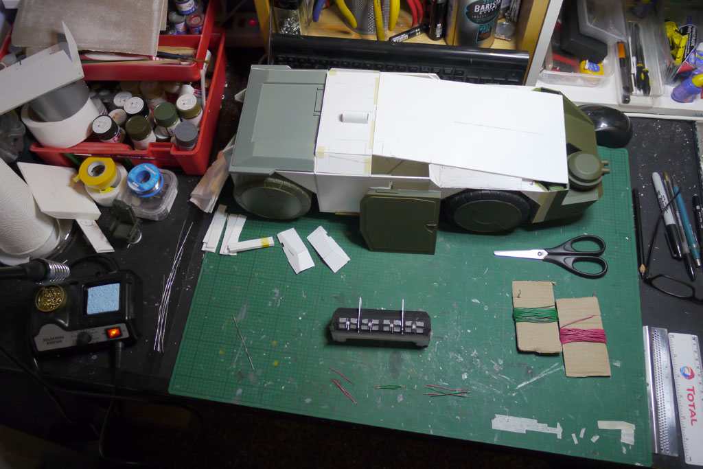

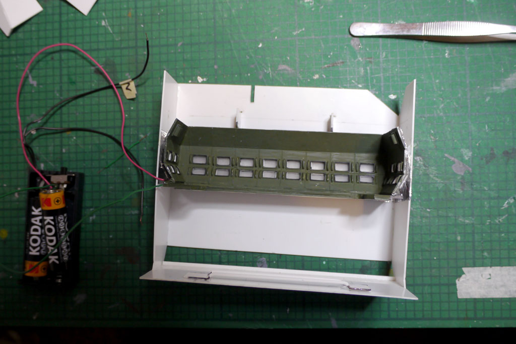

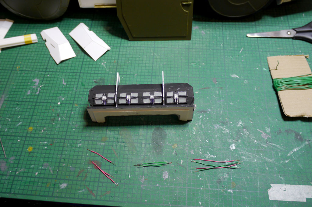

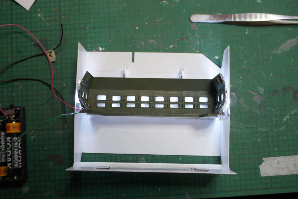

Next up is prepping for lighting the screens in Gorman's console - the TOC station.
Just about to connect and test - always a nervous time (especially given my sloppy soldering).
Yay! Not easy to see against the white background but it works!

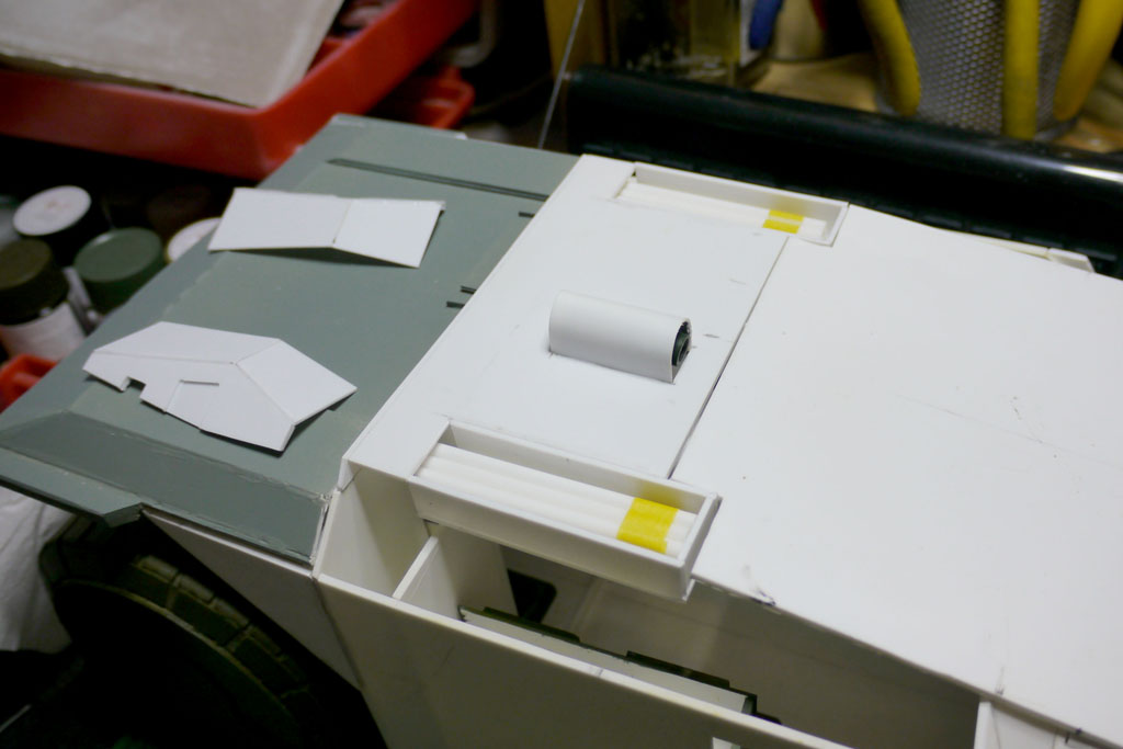

I got time to do a little more on the DSGR arrays too - building out the bays and sinking them into the roof.

Thanks Chuffy 70! I've built them in 3d so they'll be printed soon.

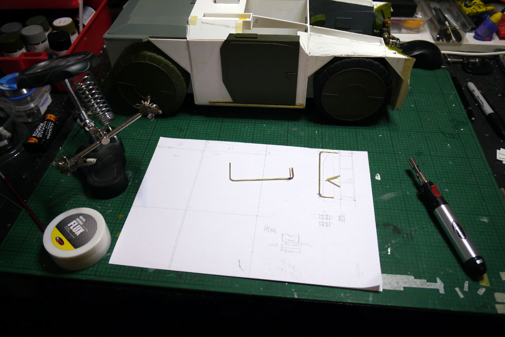

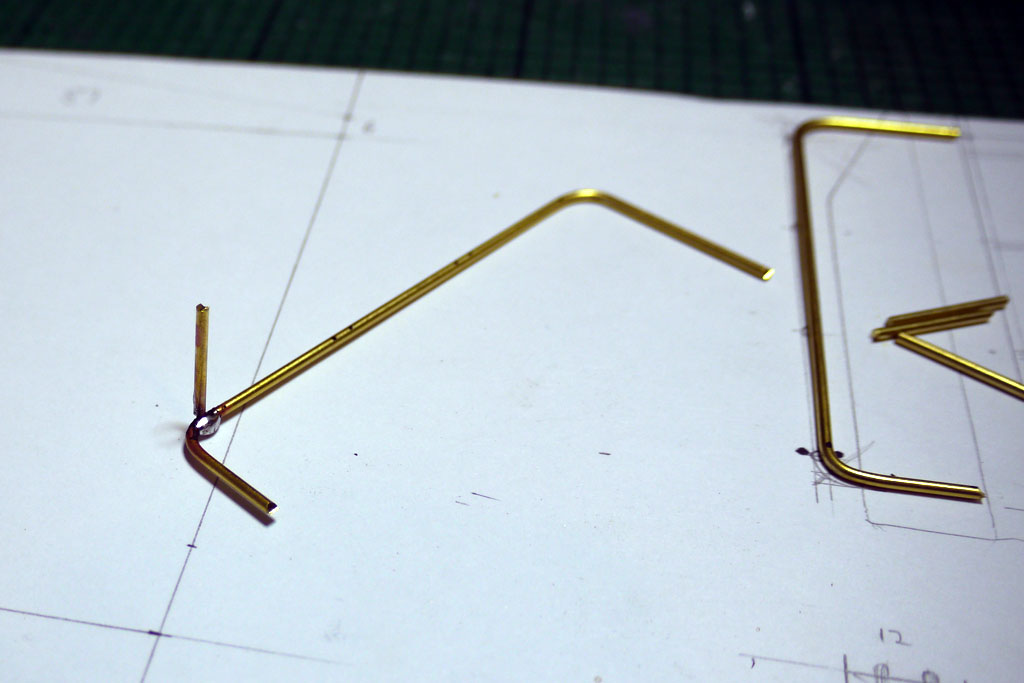

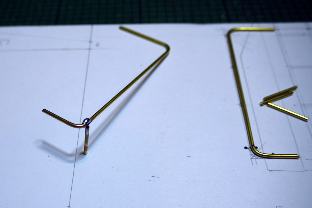

It's time to start working on the rear ladder. This is going to be soldered up from 1.5mm brass rod.
I've never worked with brass like this before - so I was prepared for it to be a learning curve. Just as well!
I filed fish-mouths in either end of each rung and tried working it with the soldering iron first. No joy there so I went with my mini butane torch and plumber's flux. That did the job and will produce decent results I'm sure - but I need a little more practice first - this first joint looks like a right dog's dinner. lol
Onward and upward, exelsior!

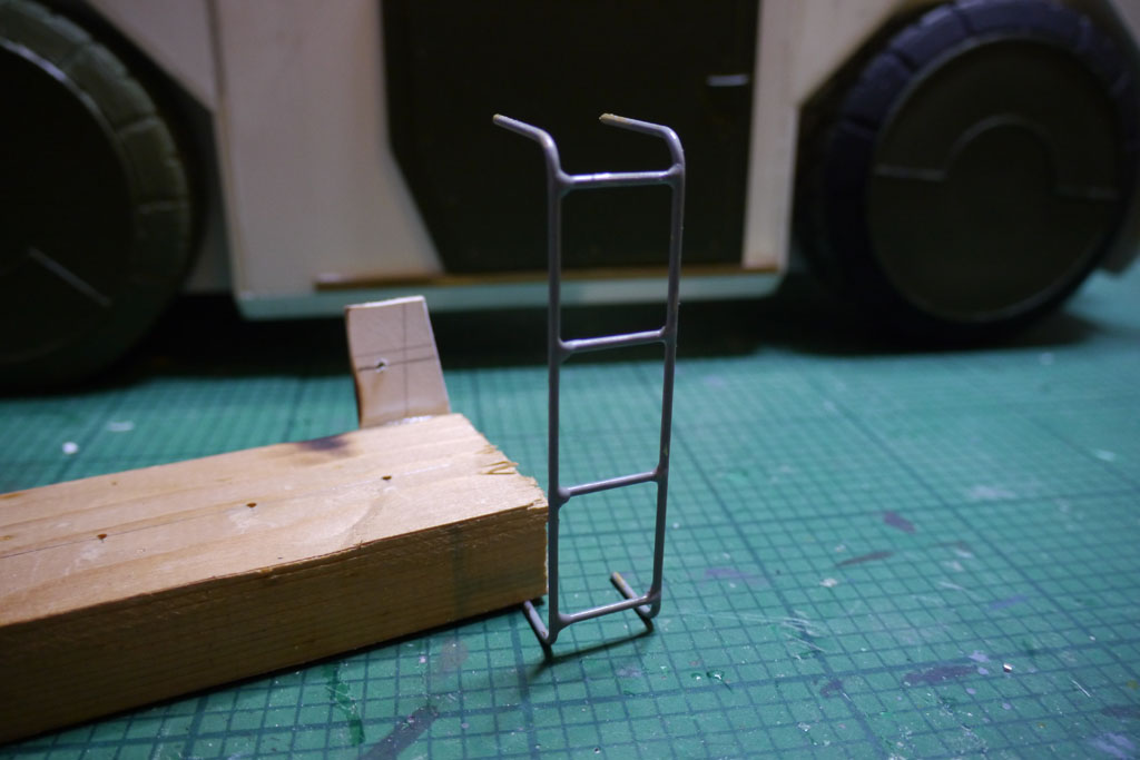

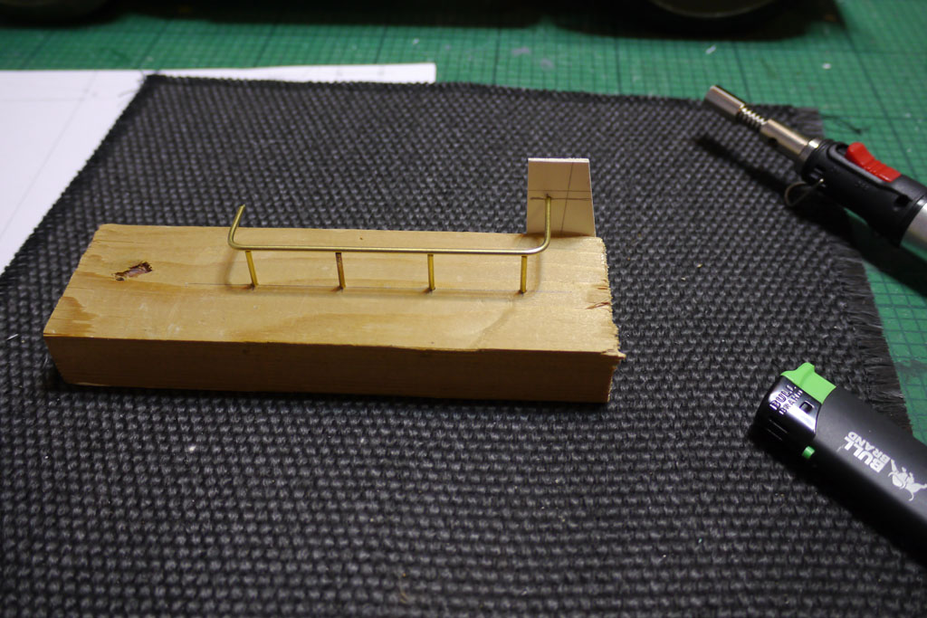

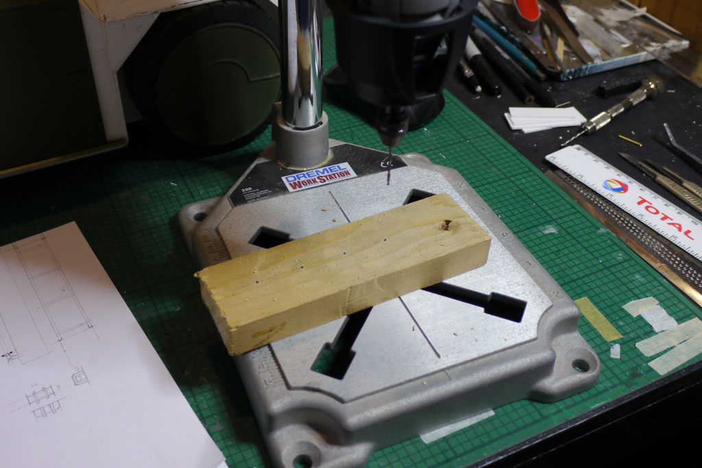

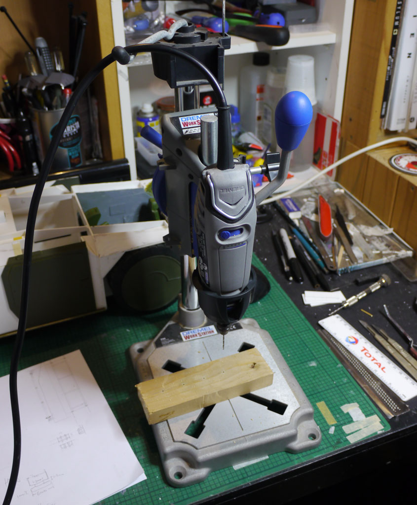

Despite my cack-handed attempt at soldering/brazing I pushed on ahead with the ladder. First up, breaking out the Dremel pillar drill.
I needed that to drill 4 holes into some scrap timber to build an alignment jig for the ladder rungs.
All set up and ready to go! That's my fireproof soldering mat.
..and there we are, filed, sanded and given a first coat of primer. I'll refine the joints a little more later.

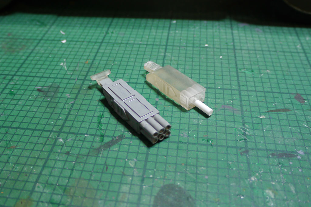

I printed out two missile racks (one didn't print properly, so I'll re-do that one) and stuck the Chupa Chup sticks in there. They just need rounded warheads made now. I printed them in clear resin simply because that's what I had loaded up.

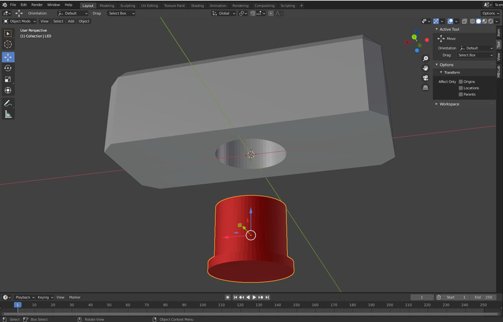

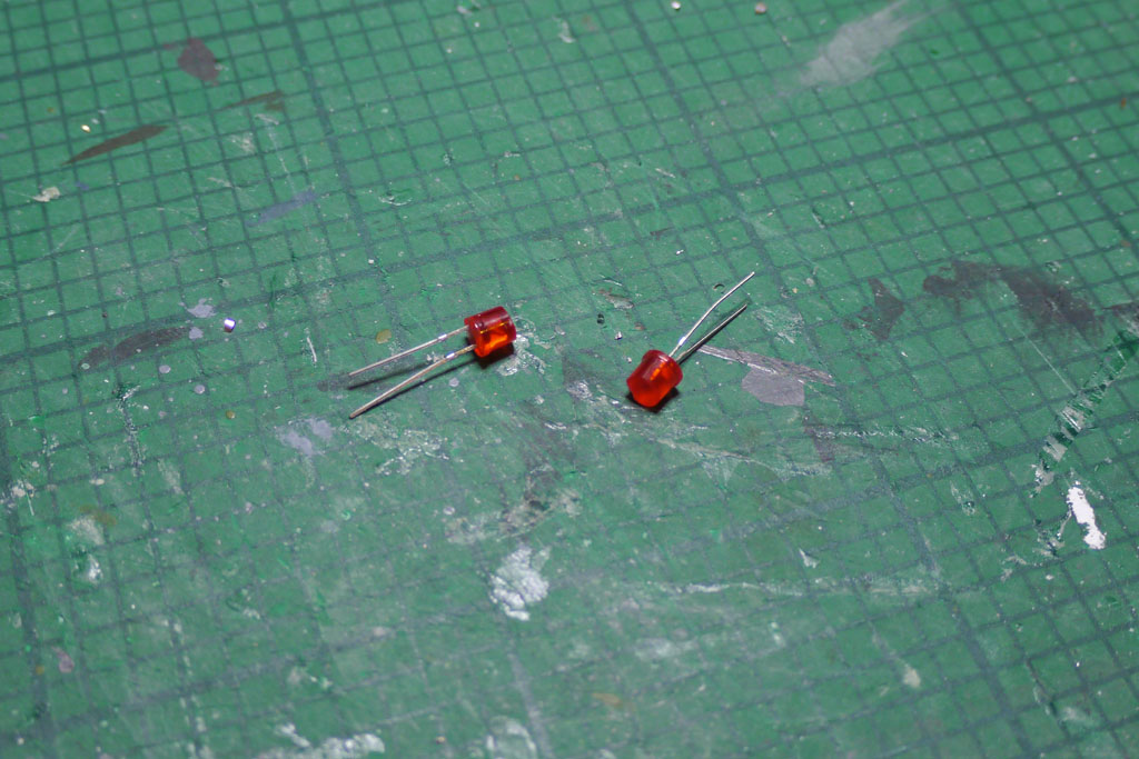

I shaved down 2 red LEDs (they had domed tops) to fit into the rear lights.
These 3d files will be printed up in clear resin, like the missile racks and will have the LED fixed inside.

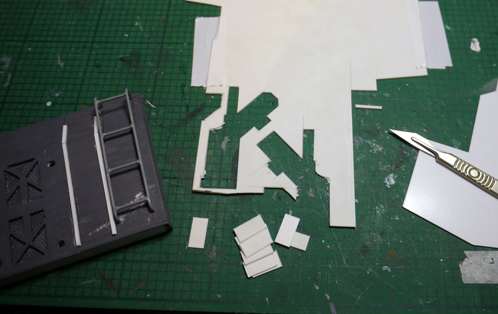

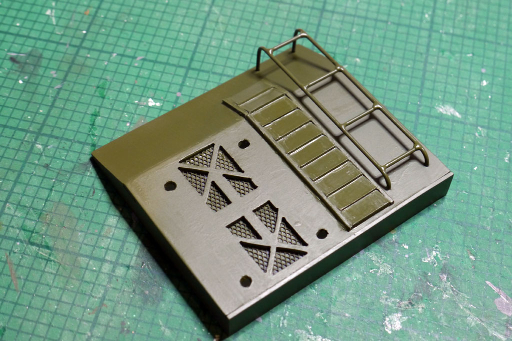

Another small update today. I made the vented grille section next to the ladder.
You can see it here inbetween the ladder and the base of the (missing) turret.
The louvres were marked out and cut from styrene.
I couldn't resist chucking some olive drab on there to see how the whole assembly is looking. Not too shabby. :)

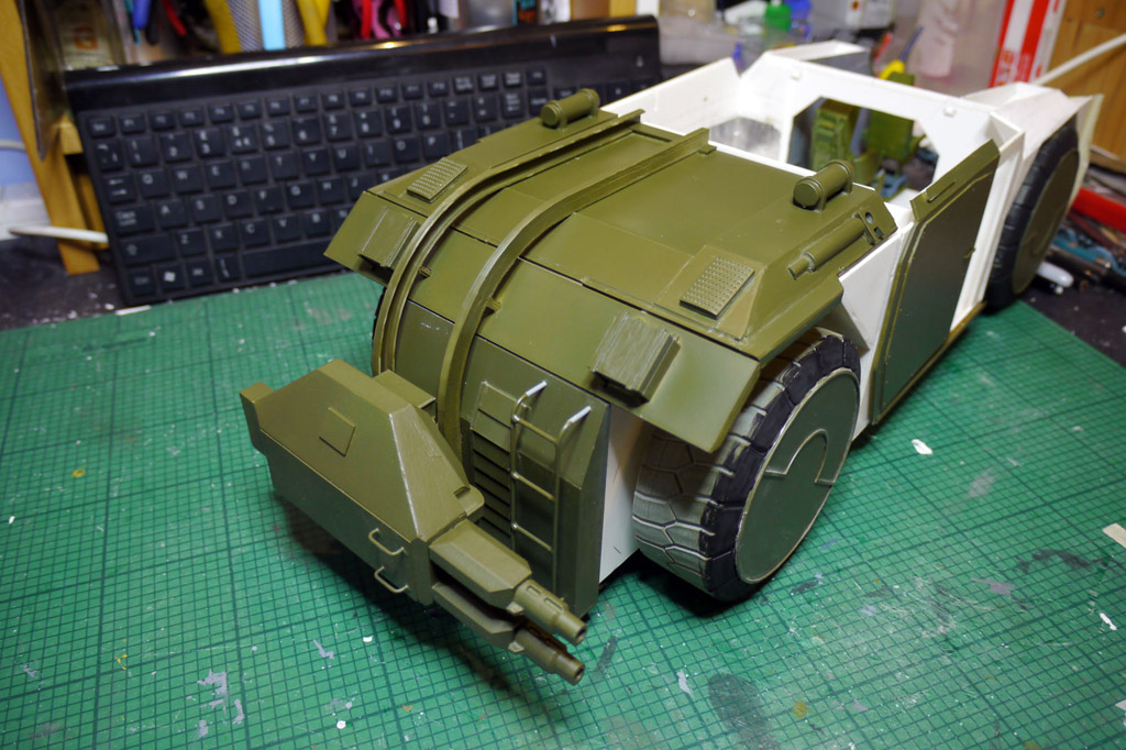

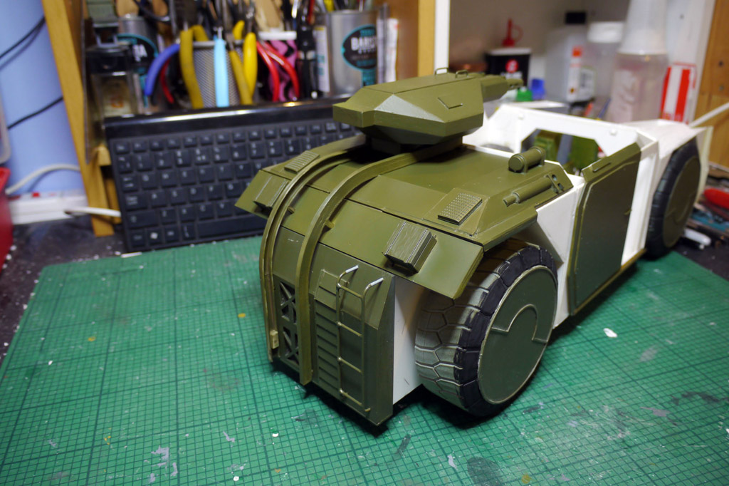

I did some more work on the rear exterior and threw some rattle can olive drab over it all to see how it was shaping up.
It's starting to look a lot better. I'm looking forward to getting the rear light assemblies done - I'm just waiting for a delivery (a new FEP film tray for the resin printer).
