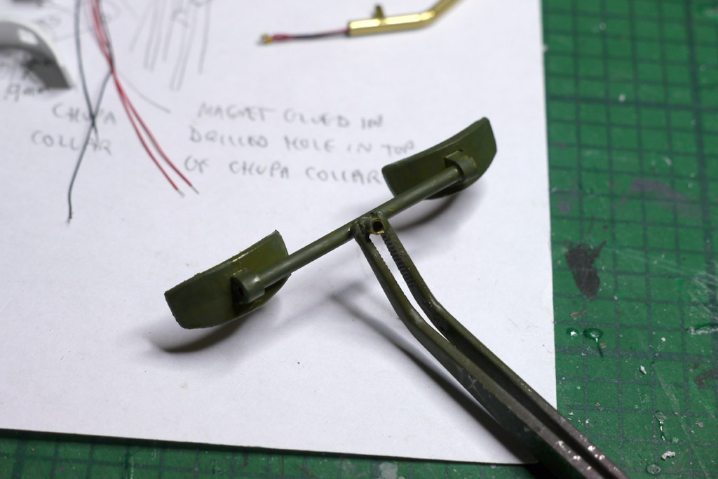

These parts will form the padded pieces that sit in the seat restraints. the hinges are hand made and are about as small as I can work (old eyes, old hands) at 3mm x 4mm.
I managed to file these two into the same shape - pretty much. Feeling like I needed a bit of a boost I chucked some NATO green on them.
Wow - they're looking very nice if I do say so myself. 2 down, 10 to go. :)

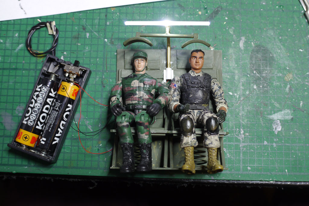

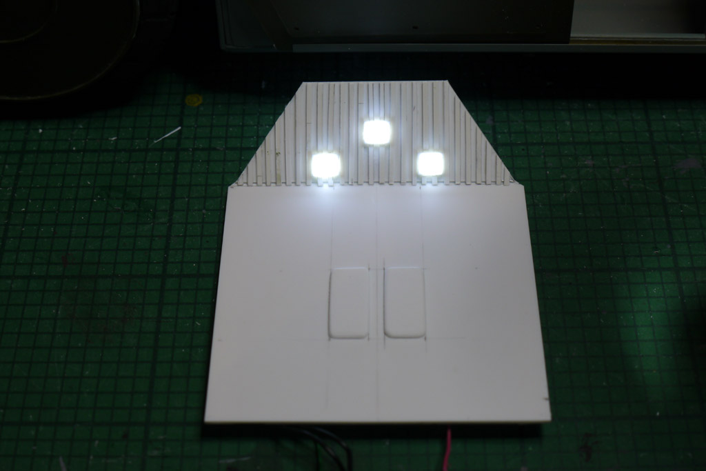

I was happy with the progress so I did a little more tonight, including adding the new lighting idea (back to back LEDs).
They look great and will get some light blocking paint in the middle and at the edges.

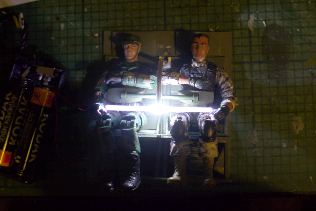

I found a couple of folks to test it out for me. :) It looks good in the light but better with it off.
This worked really well so I'm looking forward to doing the rest - especially the back eight - and seeing how they all look together.
thank you alienbuilder. I'll try to recreate as much of the interior lighting as I can without flooding the place with light.
That is such an awesome build! I have seen many builds with fully decked out interior lighting that were way too bright for my tastes. The lights themselves were IMO always placed in the right spots, but the brightness of the light sources, at least when photographed, were almost always too bright, with blinking lights often being too fast. I think that toning down the light intensity makes detail pop out, I love that light and shadow in that picture with your test personnel ;)

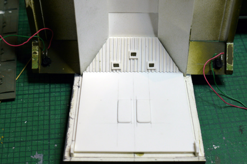

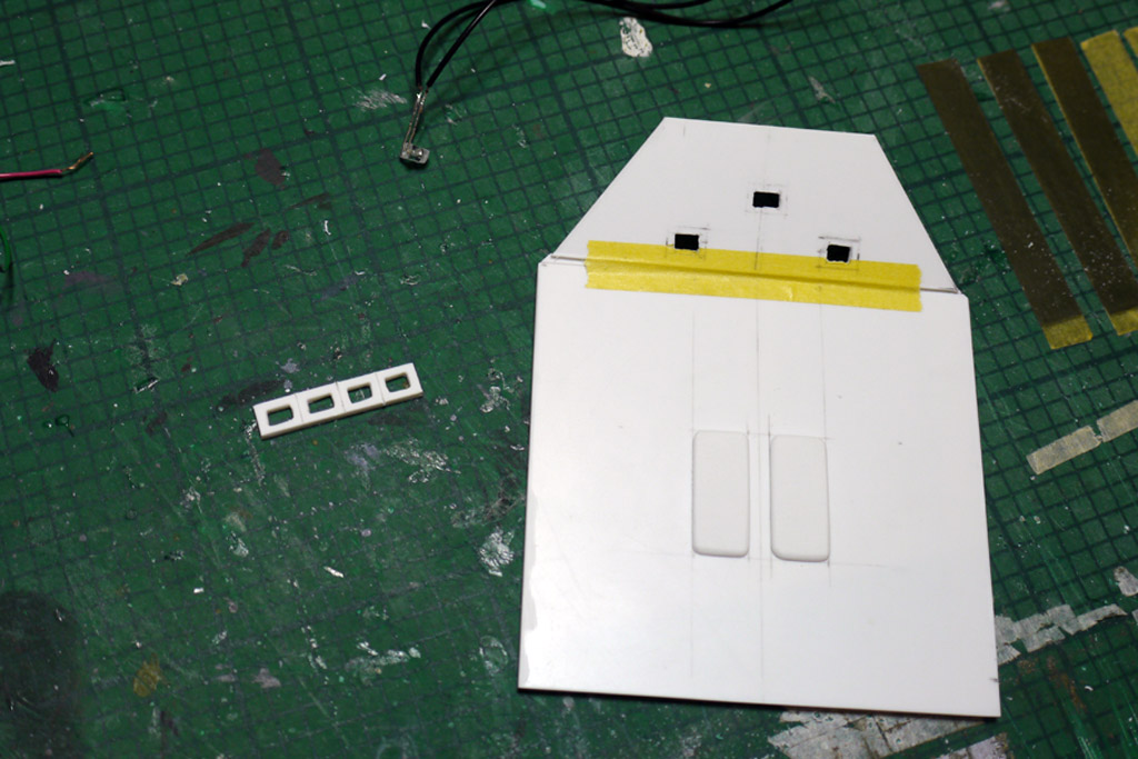

I started to give the interior rear wall some love. I've provided a gap between the inner and outer so that I can route cables through for the lighting.
The two panels on the back are in place - they'll be painted red and I think they're fire blankets. I'm making surrounds for the lights in a block of four so they're easier to work with (there's a spare there in case of a fubar).

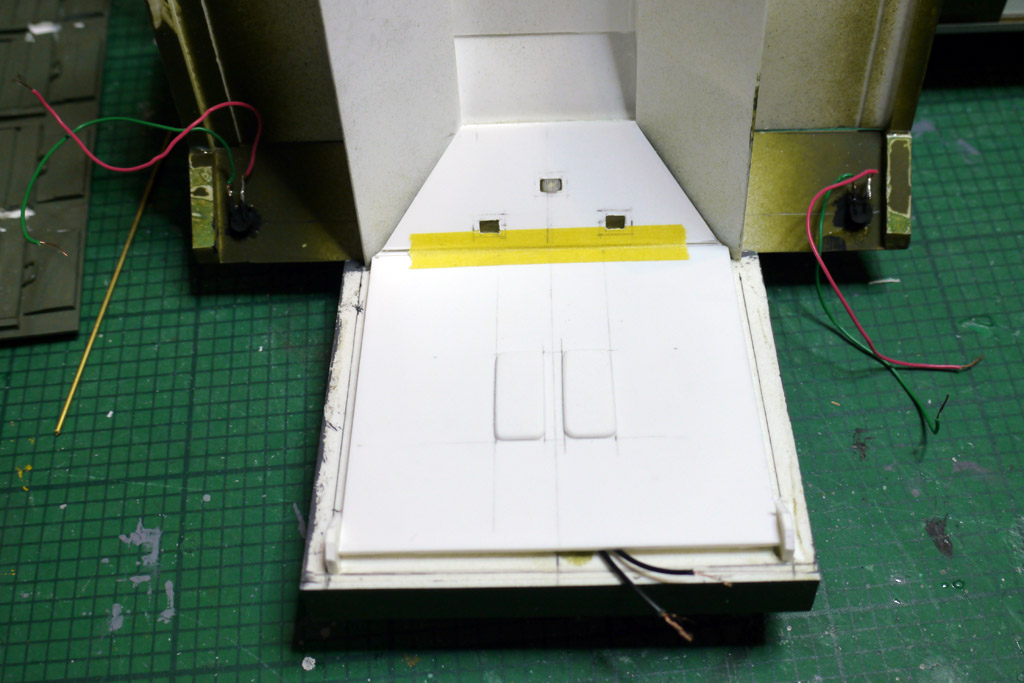

Here I've test-fit a shaved down LED in the top slot along with checking the general fit overall.
The light surrounds are in place and I've started on the ribbing on the ceiling panels.
..and here's the finished article in place but not glued in - I've got the LEDs to fit in yet.

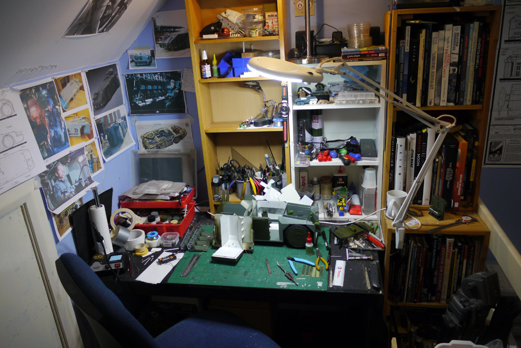

..and lastly, a shot of APC Central. I really need to tidy up but I'm too busy. :)

I am so enjoying watching the rapid progress on this build skiffy !
Funny you call your work space "APC Central", I call mine the "Nostromo Central":cool:, and I wish I was as tidy as you are! my place is a mess!
Same here mates:p!! As long as you have the space to build, who cares about the outer layer :lol:
Thank you NostromoCrew, Joberg. luckily my wife isn't that concerned about the state of this corner of my attic studio. She is threatening to come up and 'clean' sometime soon though. :)

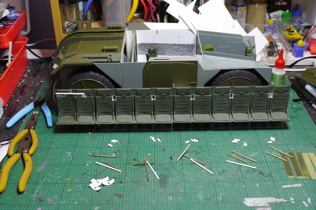

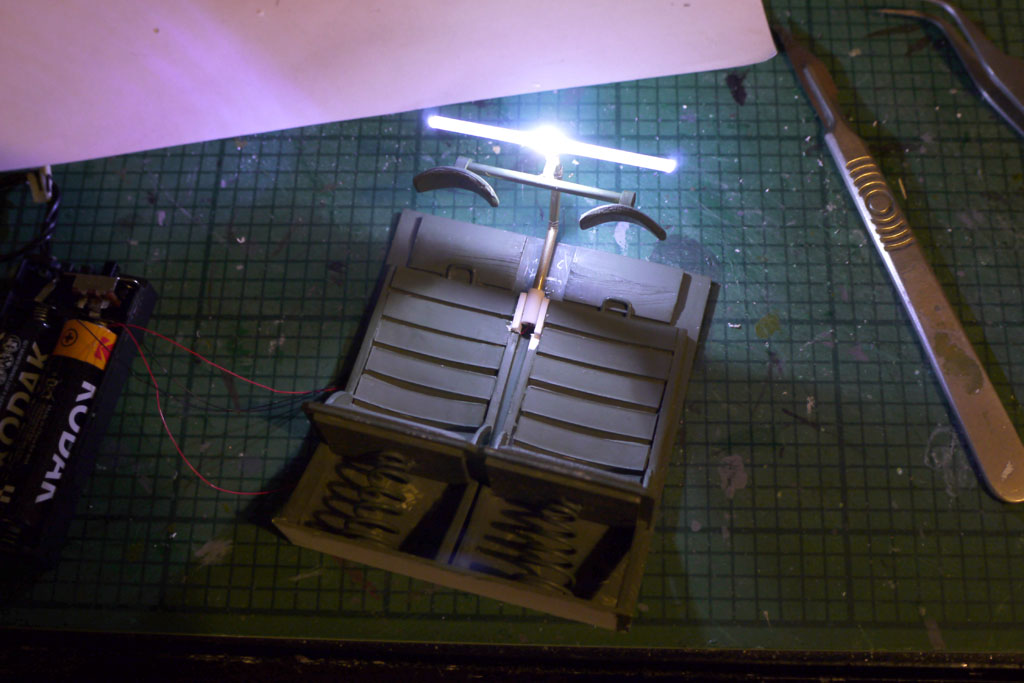

I'm making good progress while I wait for more of the micro LEDs to arrive. I've been prepping the seat restrain components.
That's a lot of seats. :)

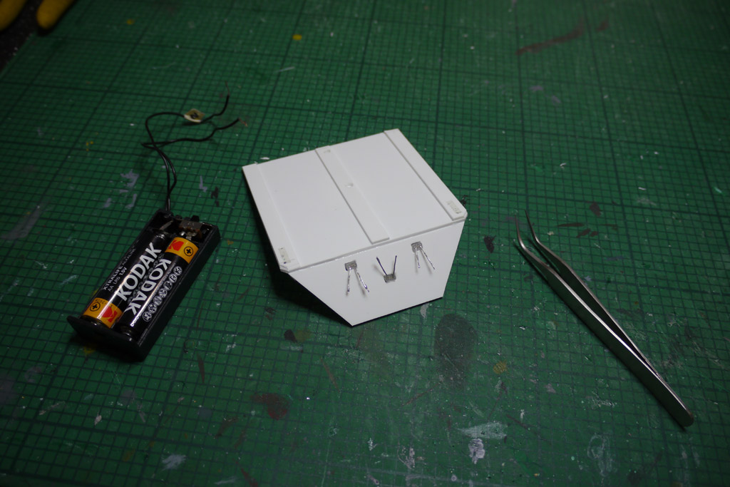

I carried on with the back wall, installing the regular LED lights. Here they are ready for soldering.
And here are some of the connecting wires ready for tinning.
It's alive! (I'm not showing the mess of wiring on the back though - lol)
The diffusers work really well - these look quite a lot dimmer in person.

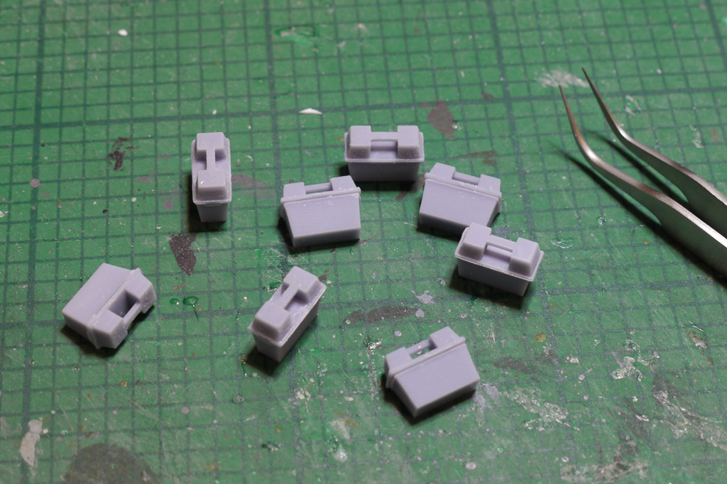

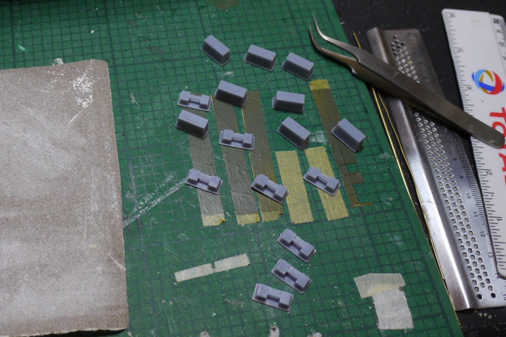

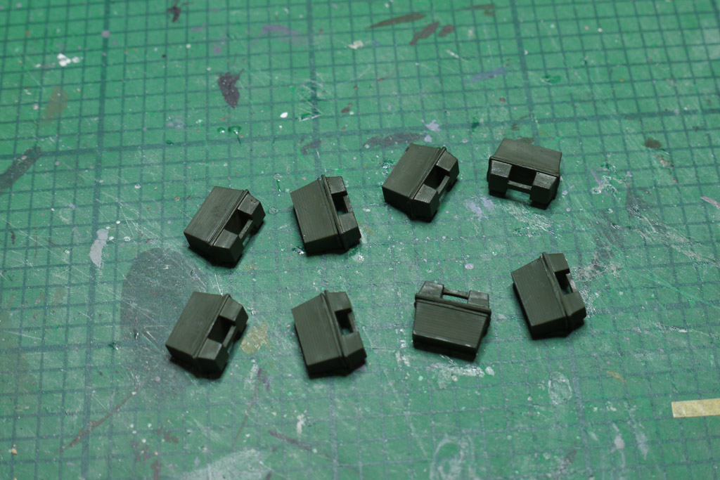

Today I've been 3d printing ammo boxes. I need 5 so there are 3 spares there too. One of these hit Gorman on the head. :) I thought about making them hollow, hence the 2 part build up but decided not to bother.
After sanding to give a gluing 'key' the halves were joined.
And painted olive green. I'll be adding some teeny tiny lettering to these, either by hand or decal transfer.

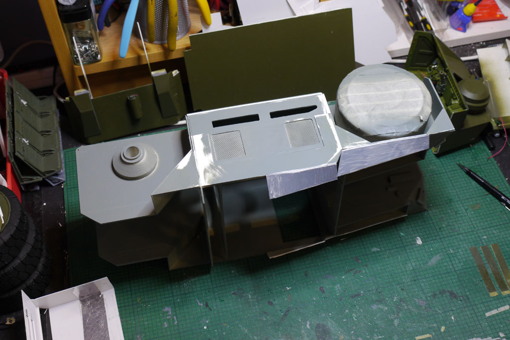

As I indicated before, I've been working on the roof and the exterior panelling. There are also little gaps where some of the styrene plates of the structure join together that need filling.
So here I'm filing, sanding and adding filler to smooth things out. The wheel that is masked off couldn't be persuaded to detach and I didn't want to force it and break the axle - so it's staying. :)

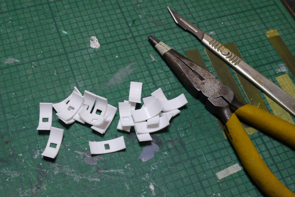

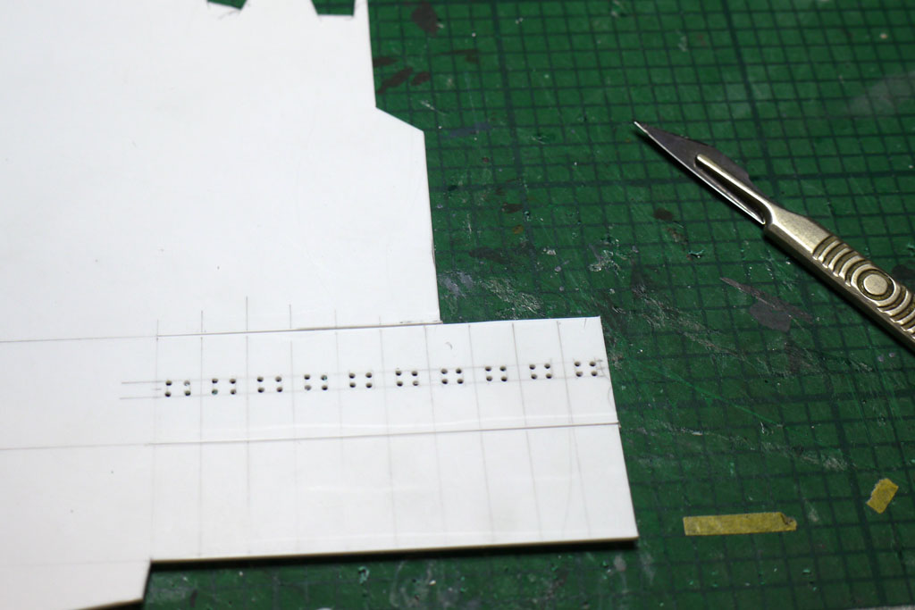

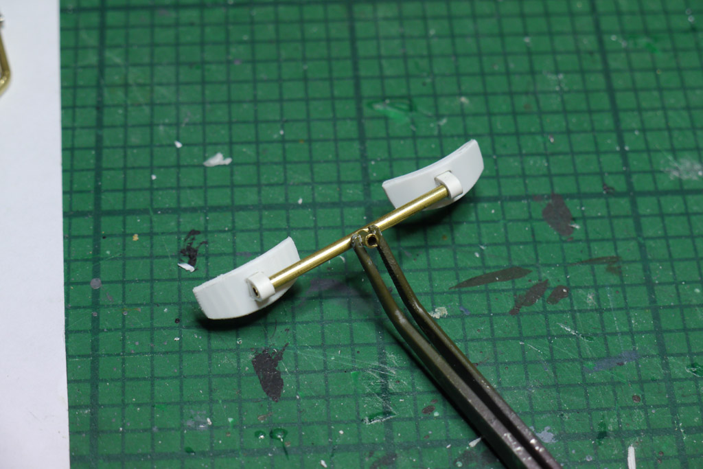

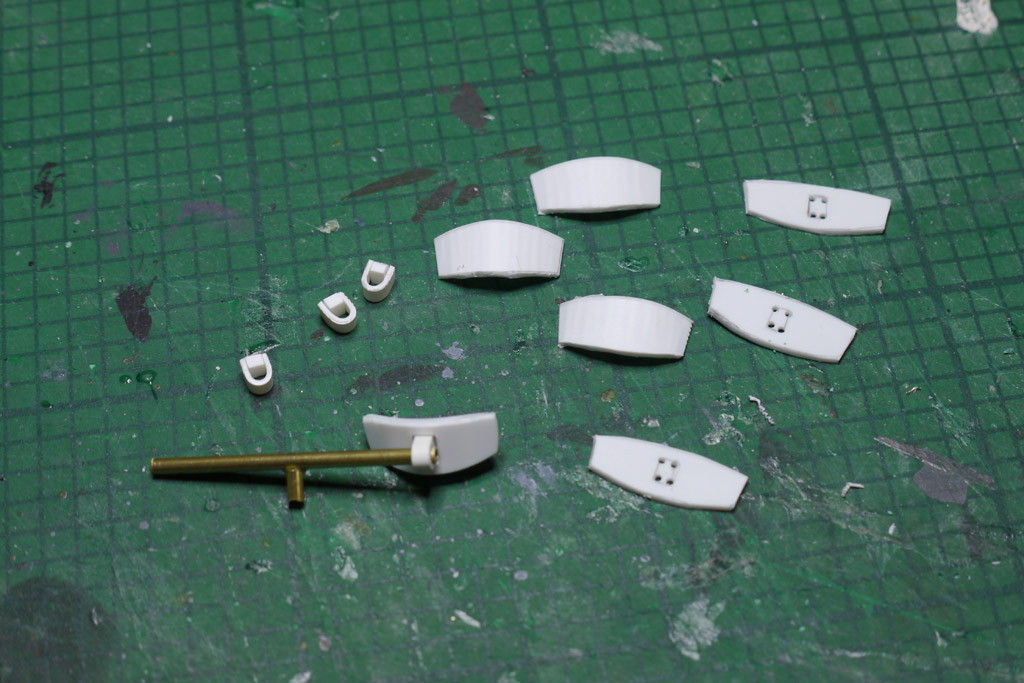

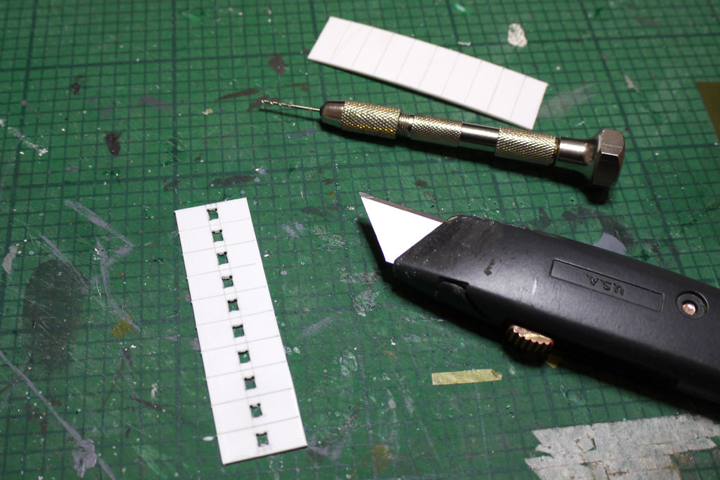

The other side got some love too. While I wait for supplies so I can finish off the seat restraints (more LED bulbs) I started on more of the curved pads that sit against the marines' chests. I need 10 of them.

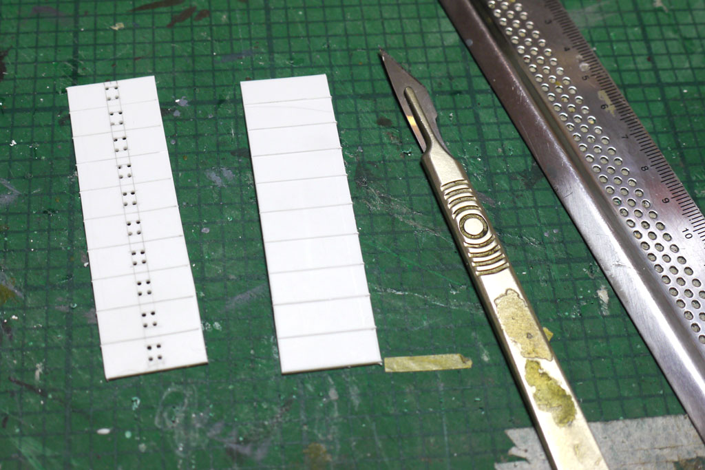

The best way to get these to 'set' in the correct curve is to use thin styrene and laminate two pieces together.
The outer piece has a square hole in the middle to take the centre hinge.
Lots of drilling, cutting and filing. :)
.. and there we are. 20 of the little buggers.
They all need a curved profile so I bent them all with pliers.

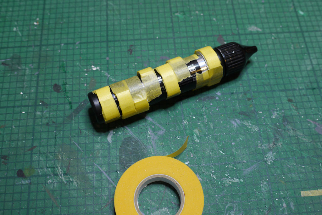

A slow-set cyano was added to them and they were then taped to a former with the correct radius - which just happened to be a refil tube for Molotow chrome paint. :)
Then I had to make the hinges. They were formed around a section of brass tube that was the correct diameter.

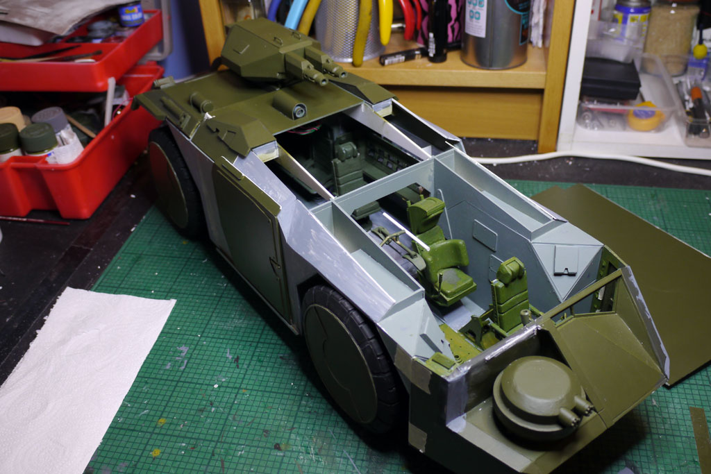

Here's an overview of the primed wall/roof area ready for a final sanding.
..and lastly another 'all-up' view. The whole thing is starting to weigh quite a bit now. It's got a nice heft to it. :)
