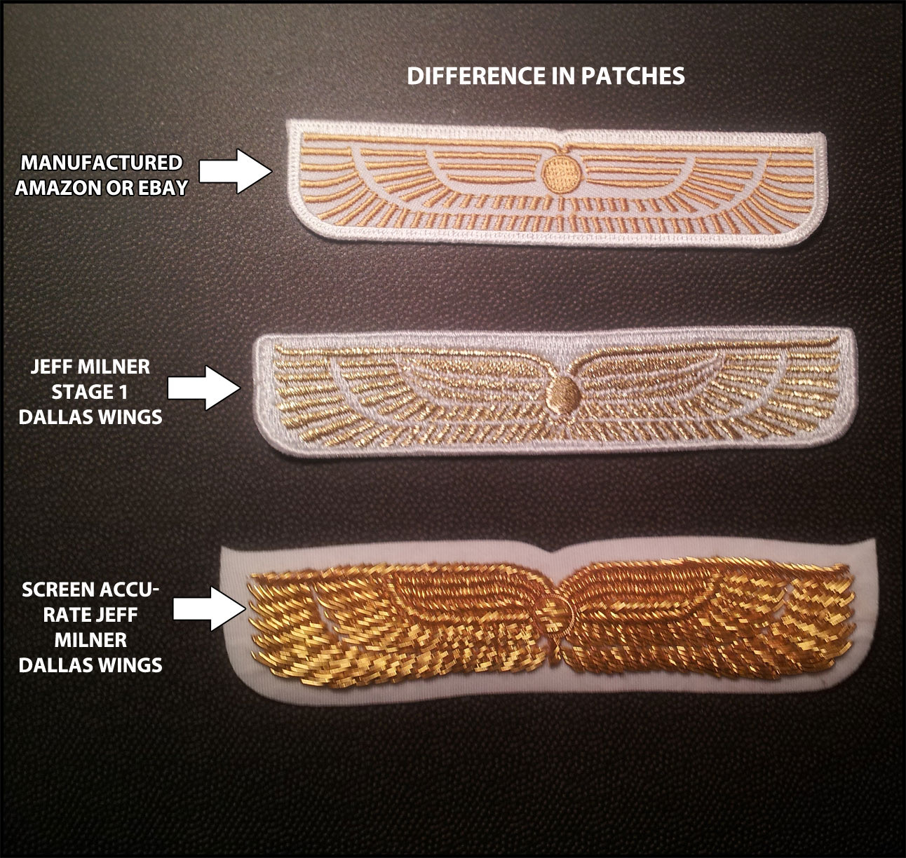

That comparison picture of the machine sewn wings and my wings is the reason I've decided to go down this rabbit hole.. very pleased with the results!

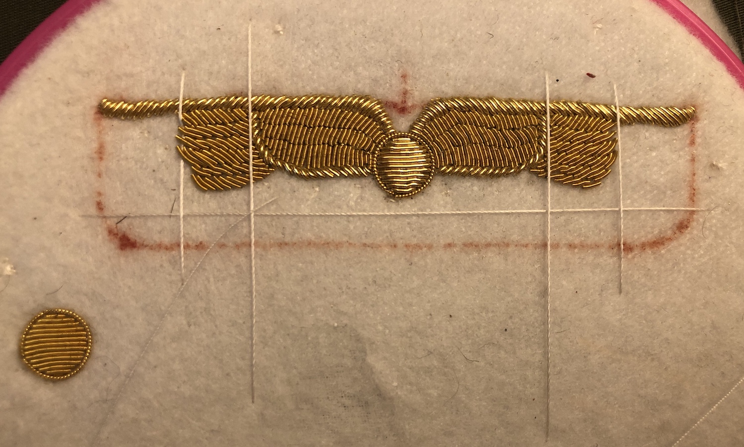

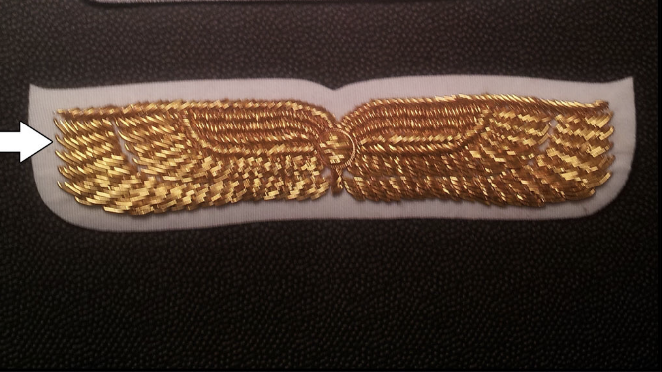

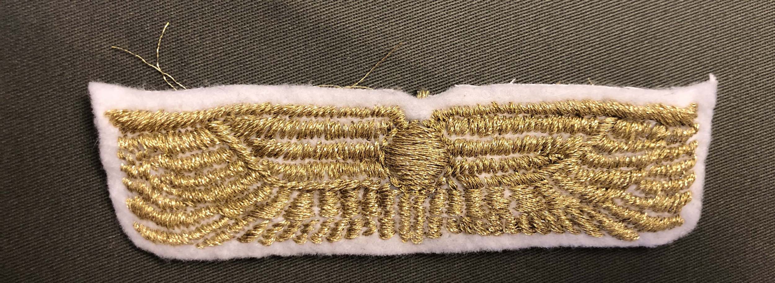

I am embarrassed to share this picture, this is my first ever attempt at replicating the Nostromo wings, but I will share it nonetheless:
Needless to say, very bad, I know.

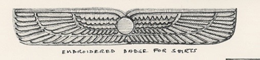

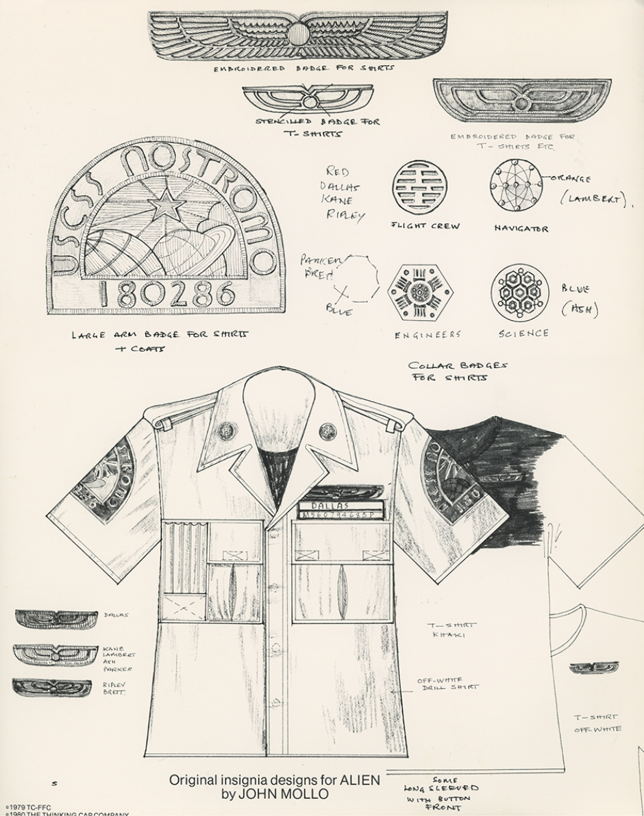

First some background, John Mollo designed the original concept art for the wings inspired by ancient Egyptian iconography namely the winged sun:
The ceiling of king Ramses VI tomb in the Vally of kings in Luxor:

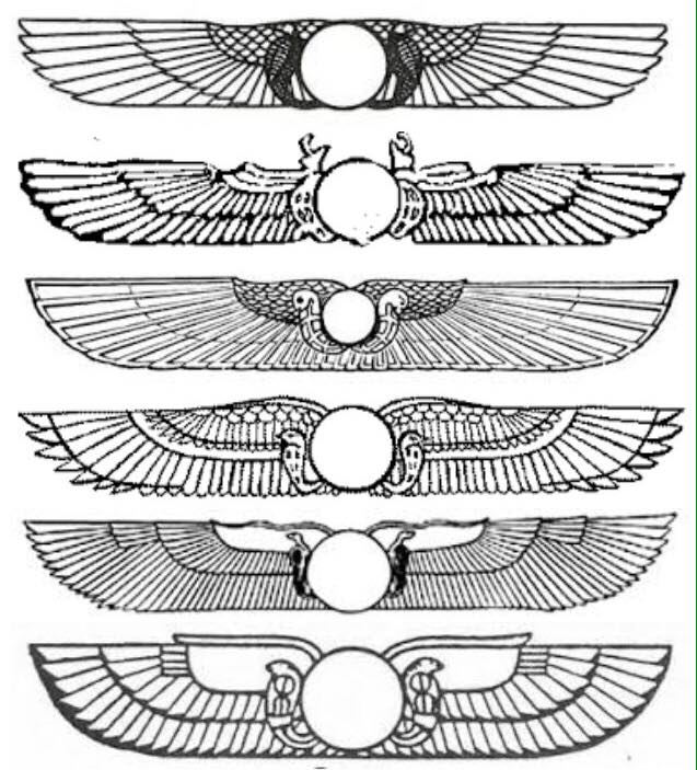

Other versions of the winged sun:
It is a symbol associated with divinity, royalty and power in the Ancient Near East (Egypt, Mesopotamia, Anatolia, and Persia).
So I was after a version based on this design by John Mollo:

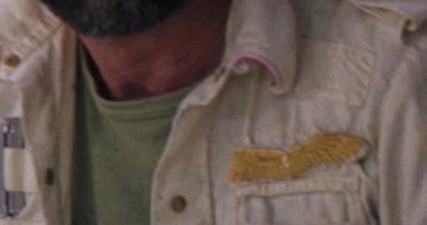

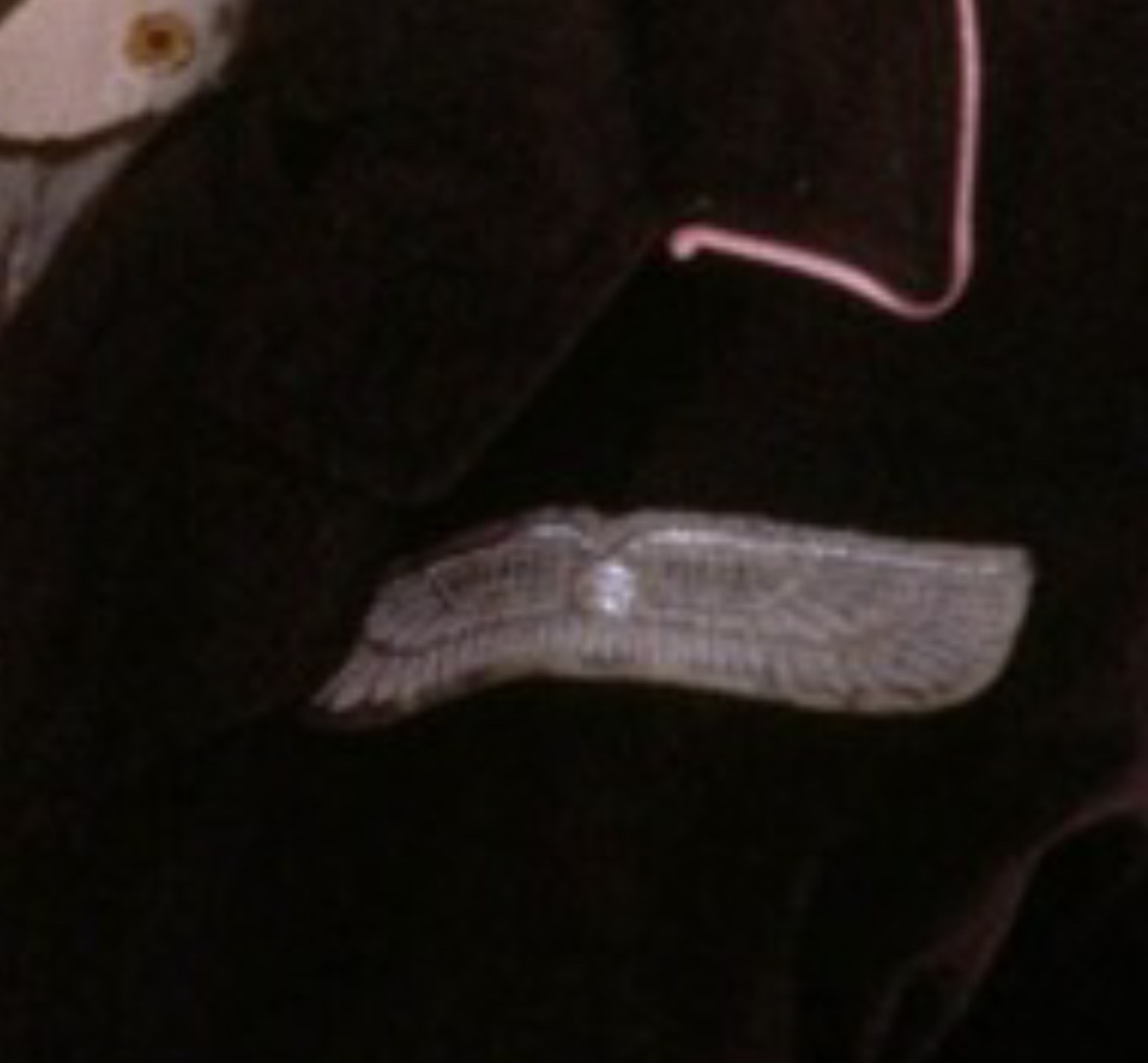

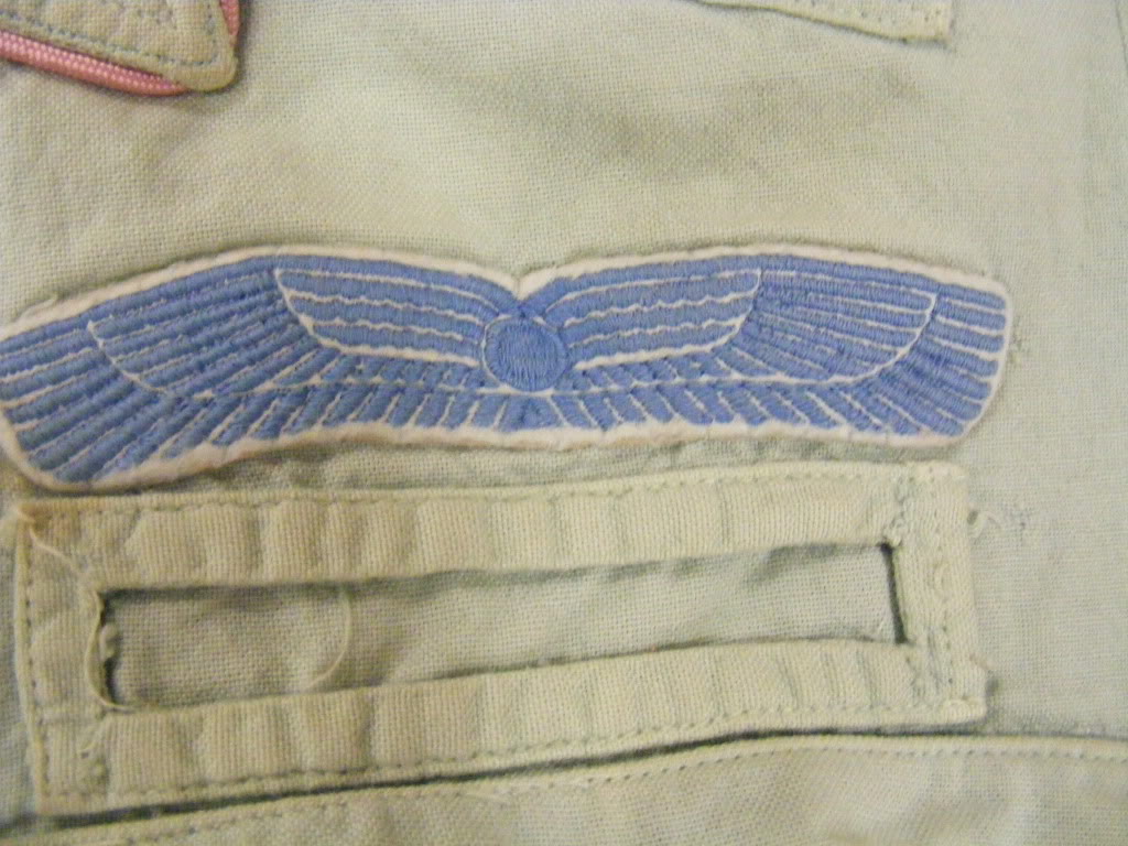

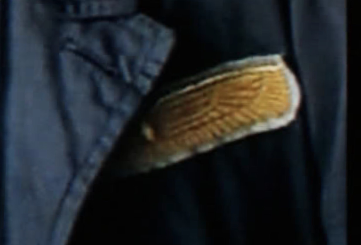

Turns out there are 2 types of wing designs used by Dallas and Kane's costumes. One for the shirts and one for the jackets.
Shirt design, with somewhat of an "angular" wing:
View attachment 1343498View attachment 1343500View attachment 1343499
In this shape:
( I'm not sure where this picture is from but my best guess is the original shirt worn by Parker/Dallas in several scenes?)
Jacket version of the wings, which is truer to Mollo's original sketch of a straighter 'boxed' shape:
View attachment 1343506View attachment 1343503View attachment 1343504View attachment 1343505View attachment 1343502View attachment 1343507

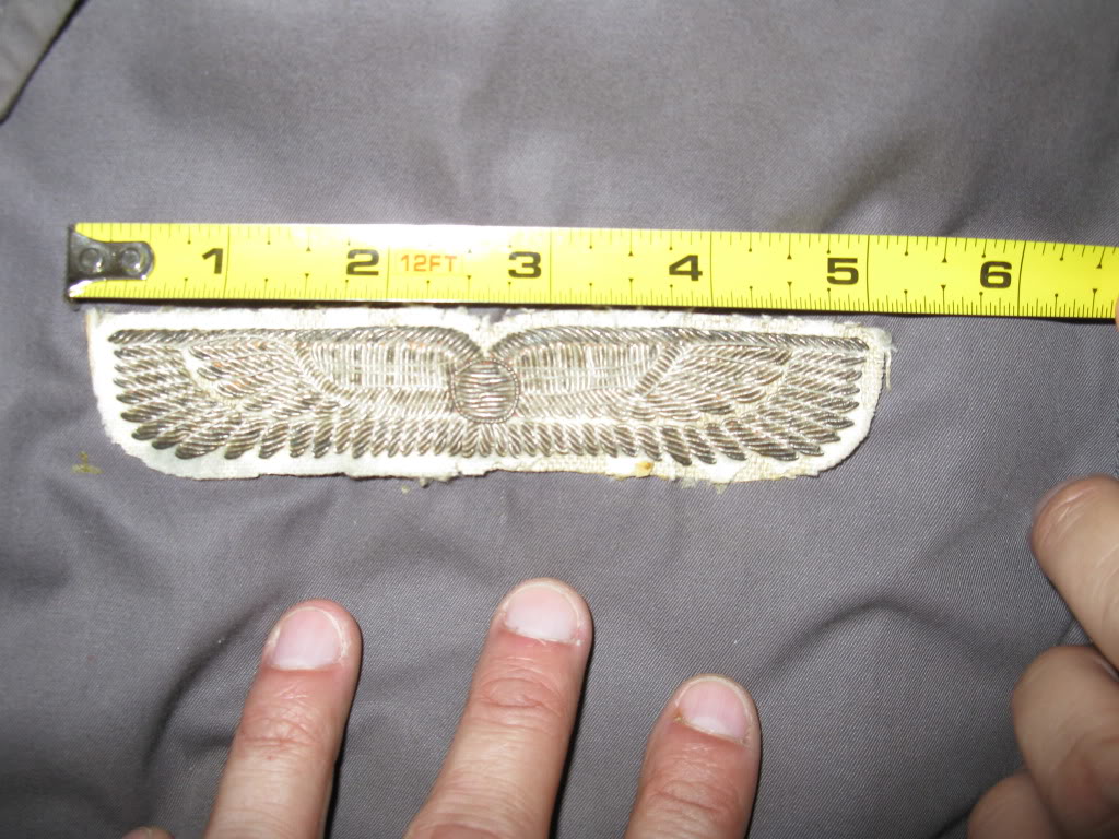

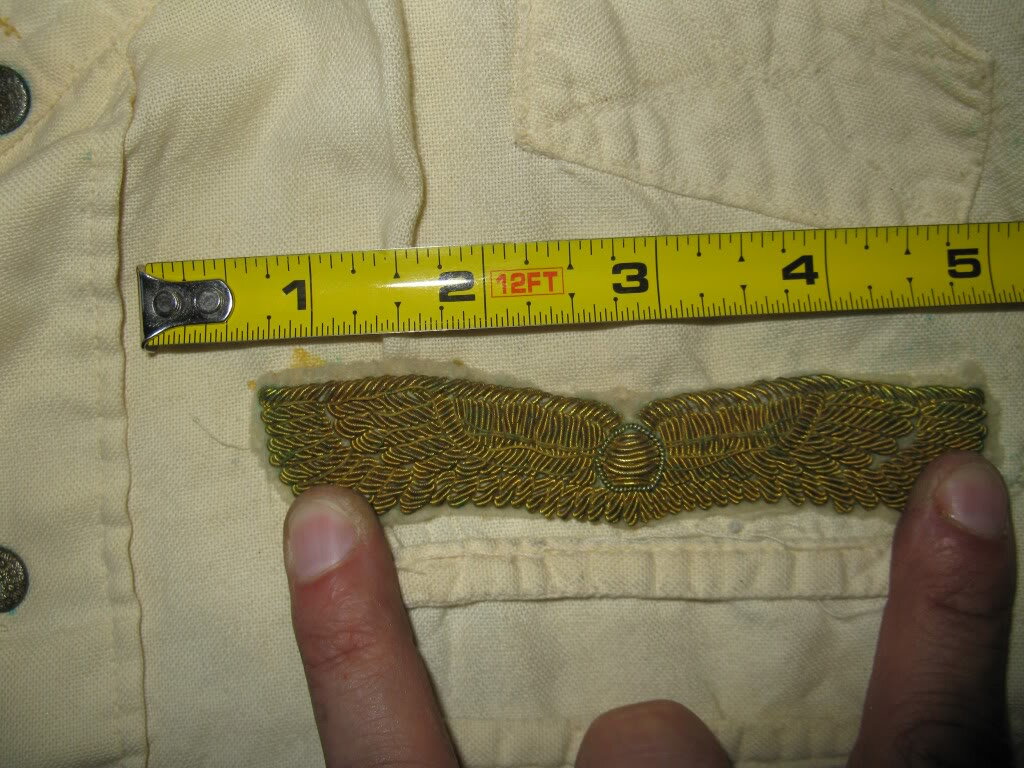

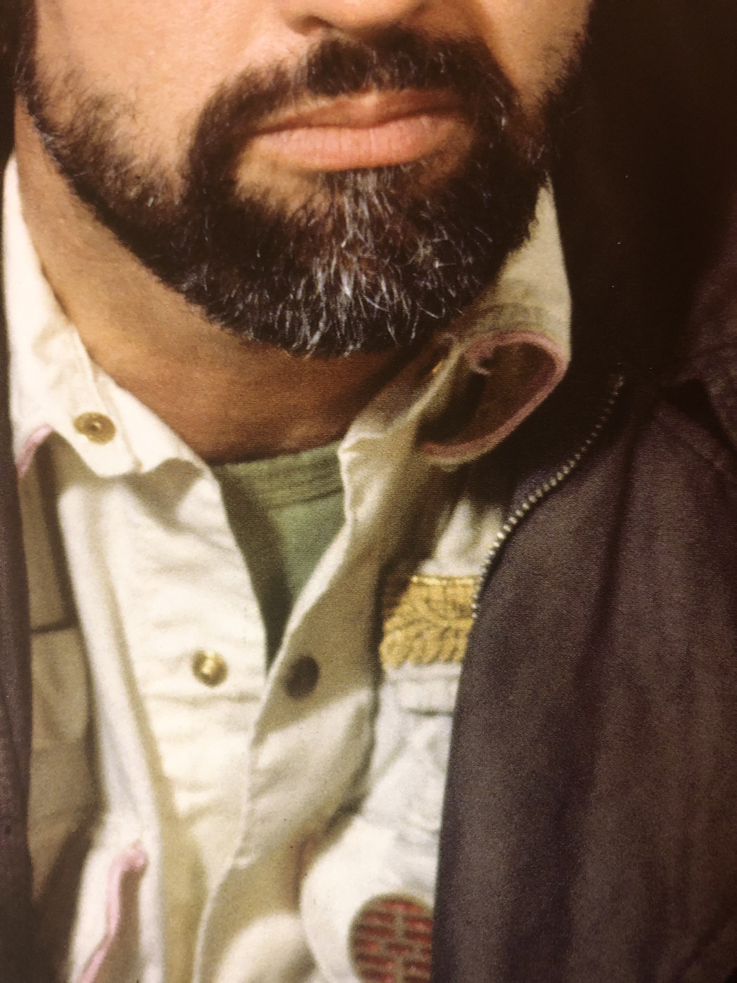

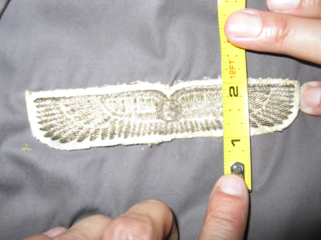

Thanks to a few members of the RPF, namely SG-RB and Funky, [EDIT Sept 3rd: Correction. It was stephen210 and funky]I have been able to get pictures of Kane's original jacket, which is a part of Bob Burns’s collection. These pictures are valuable in order to fully understand the design of the original screen used wings:
Kane jacket original:
View attachment 1343509View attachment 1343510View attachment 1343511
Dallas shirt:
View attachment 1343459View attachment 1343460
These pictures gave me a proper understanding of the making process that went in to these wings, namely the specific threading technique, placement, use of gold or yellow thread in combination with the metallic coil and dimensions of the piece as a whole.

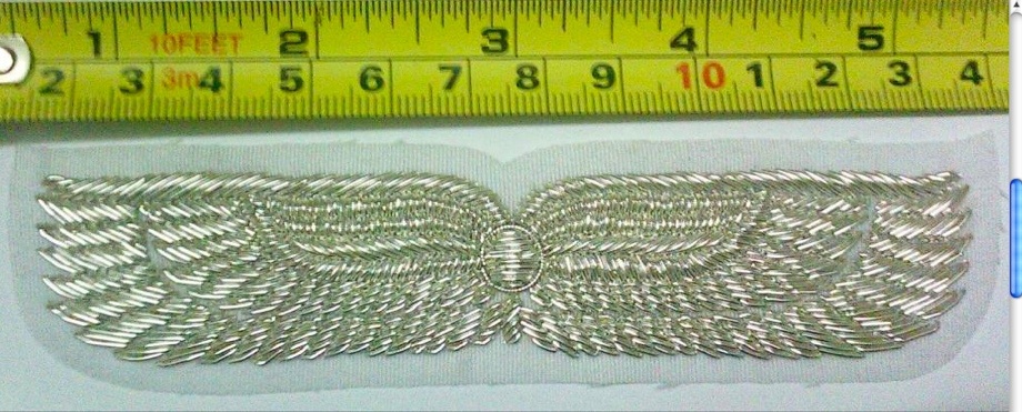

Then, after spending hours reading through this very thread, I learned that almost a decade ago merliner made a run of 25 goldwork embroidered wings:
Merliner's wings:
View attachment 1343726View attachment 1343727

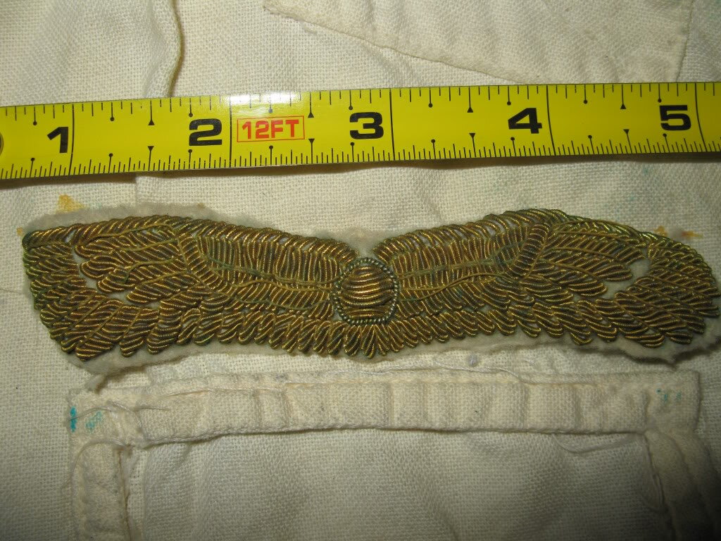

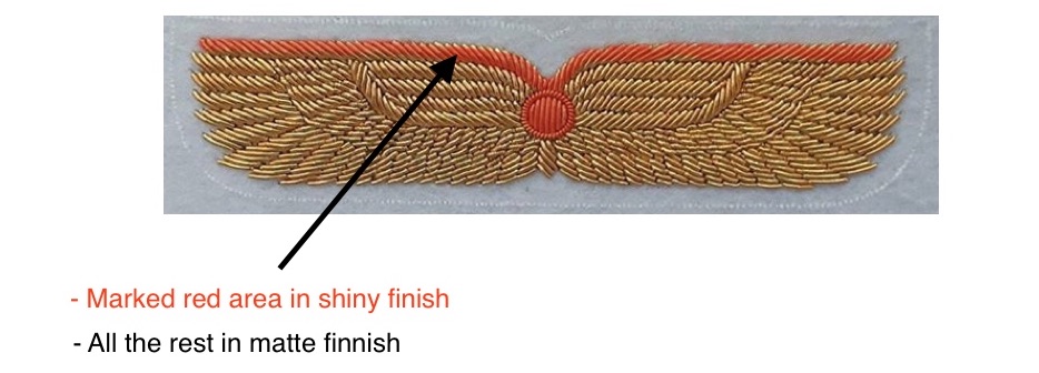

And as they are stunningly beautiful, I couldn’t help but notice that his wings were made from one type of shiny finish metallic thread. Whereas the on screen wings used a combination of shiny and matte finish.
As illustrated here:
And can clearly be seen here, here and here:

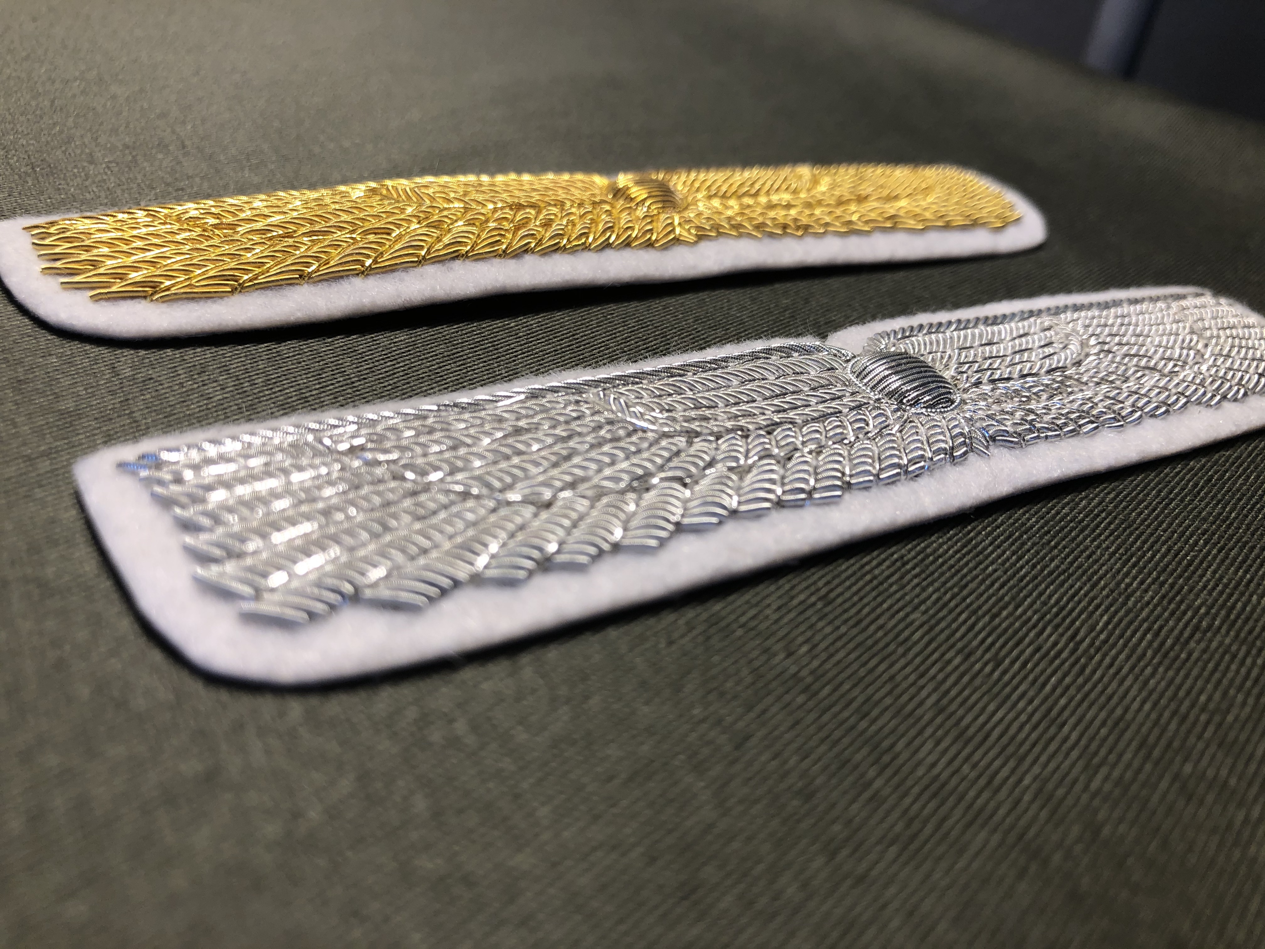

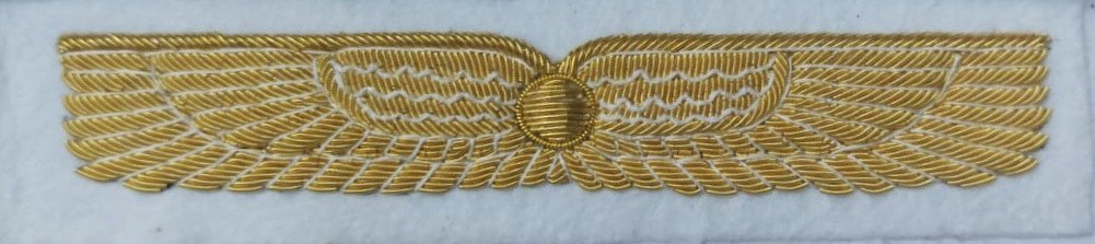

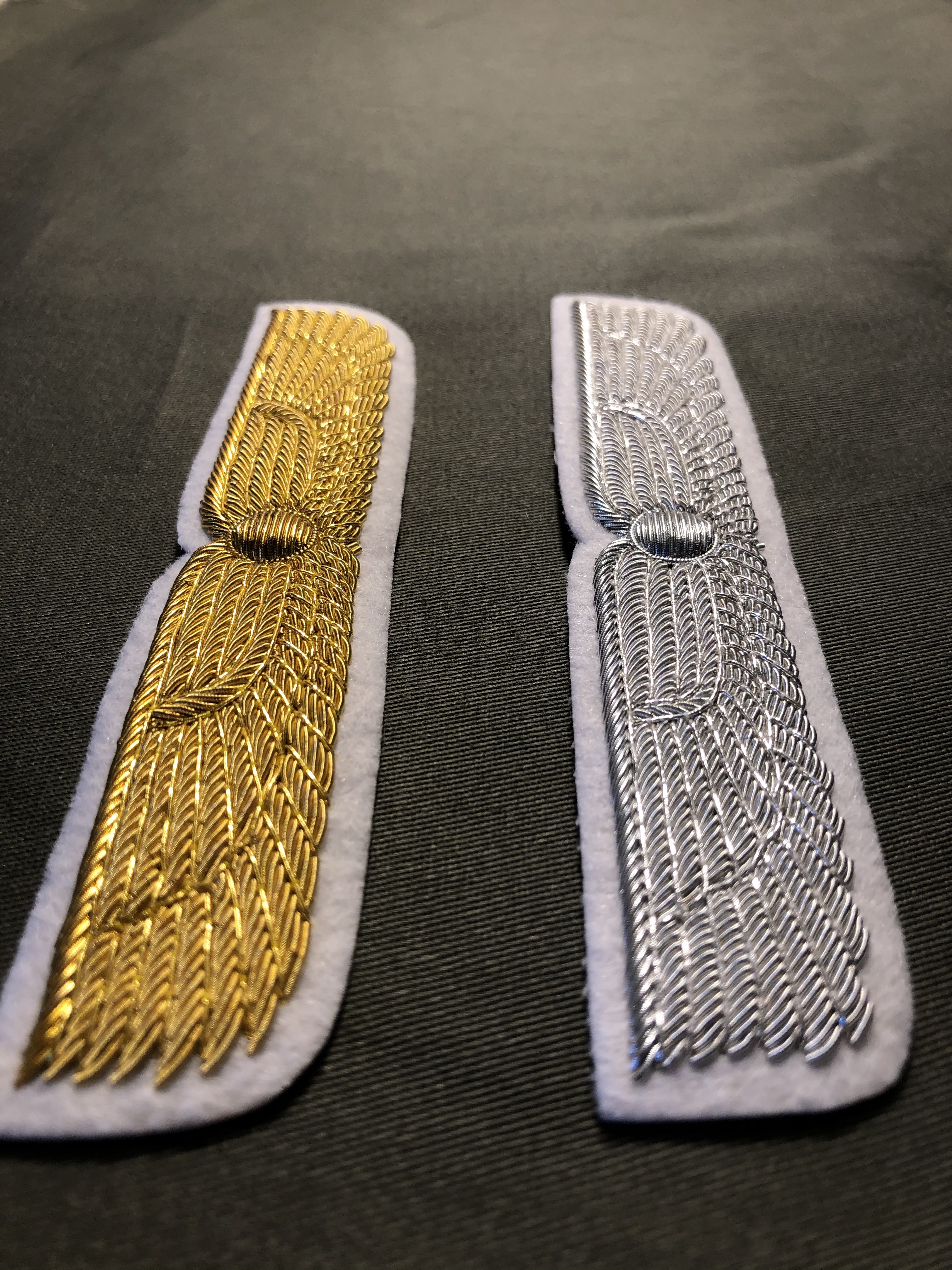

I then went to work, perfecting and improving my goldwork skills and working with a professional artist. I ended up with these samples:
First proper attempt, but still not quite there:
Further attempts: (with this one I was very happy, as it was very true to the original John Mollo design)
View attachment 1343737View attachment 1343453

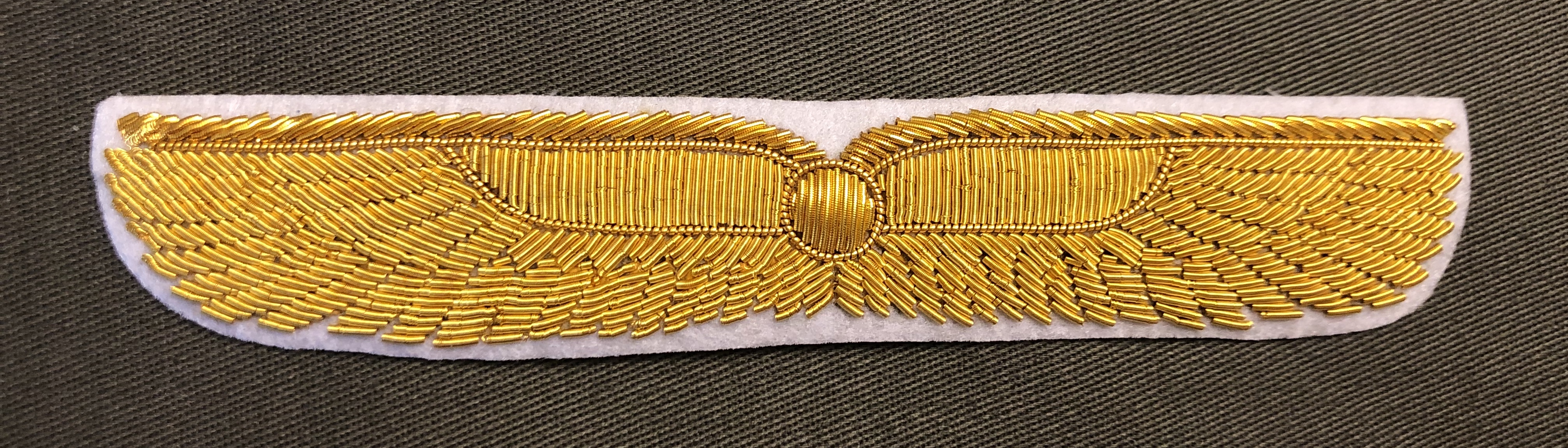

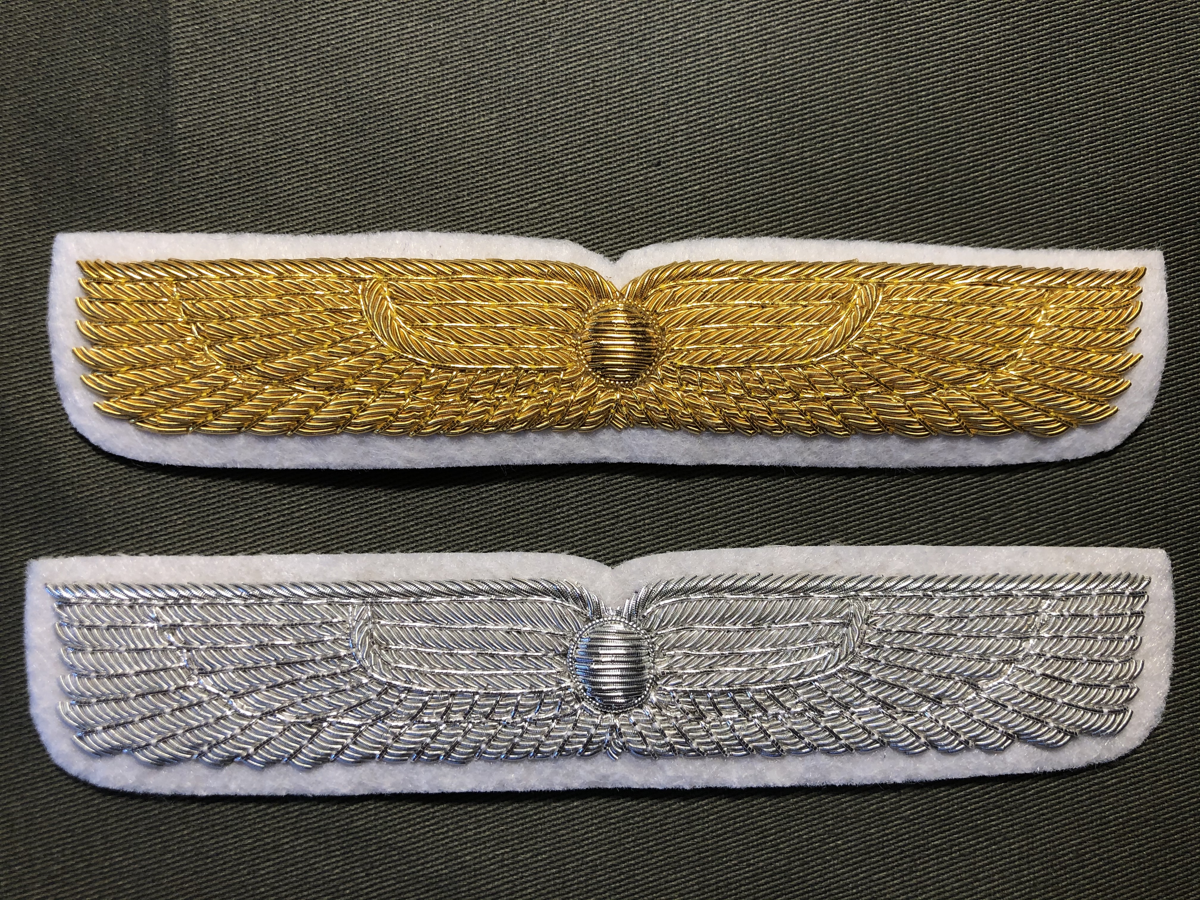

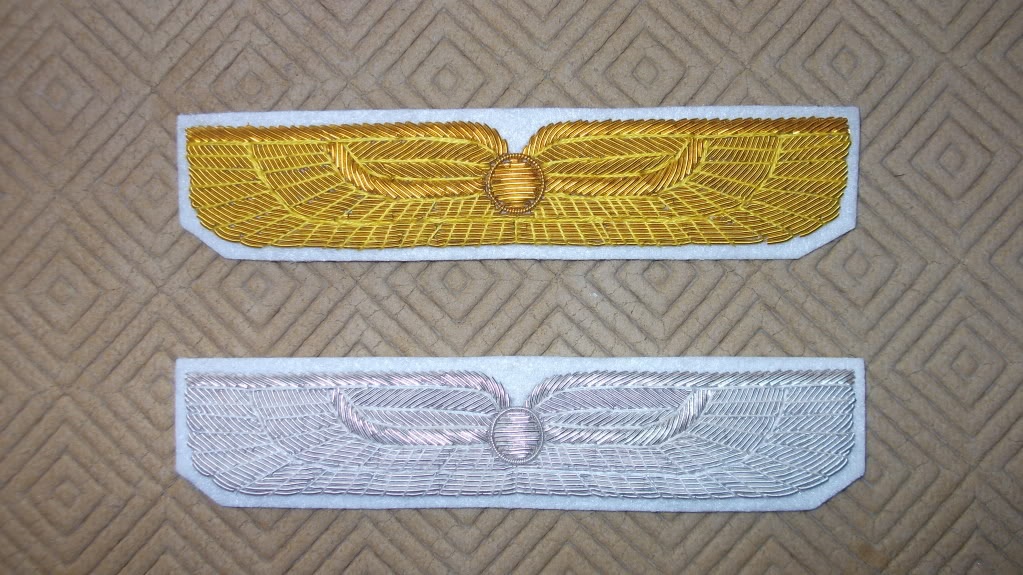

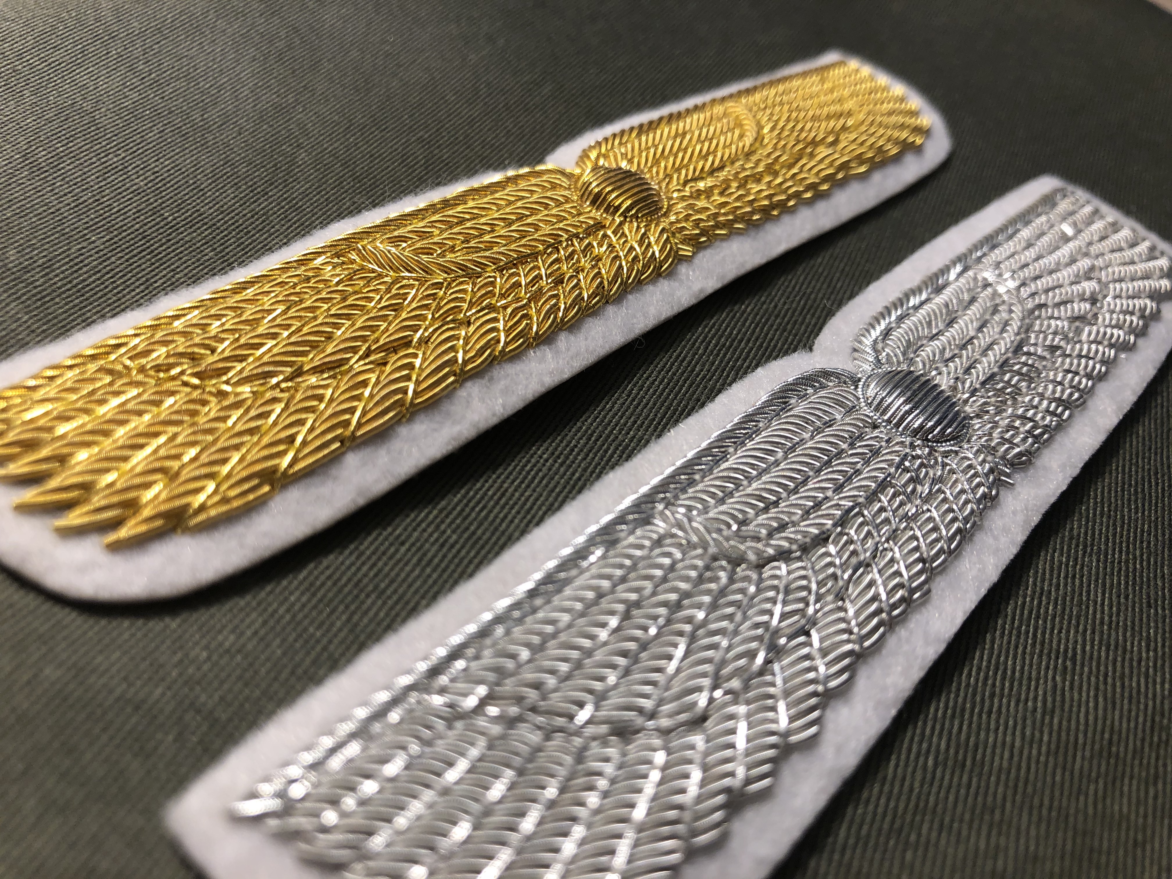

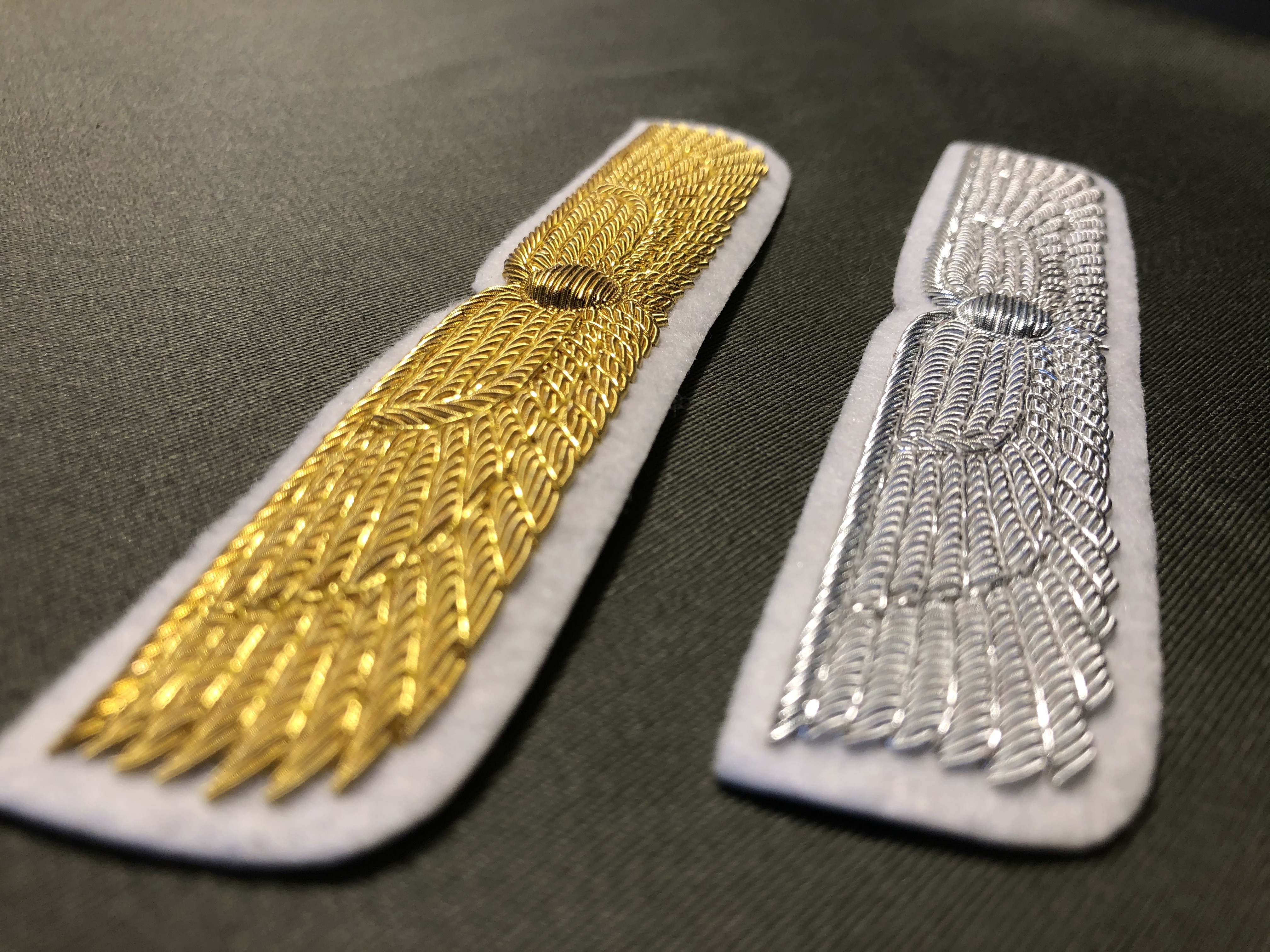

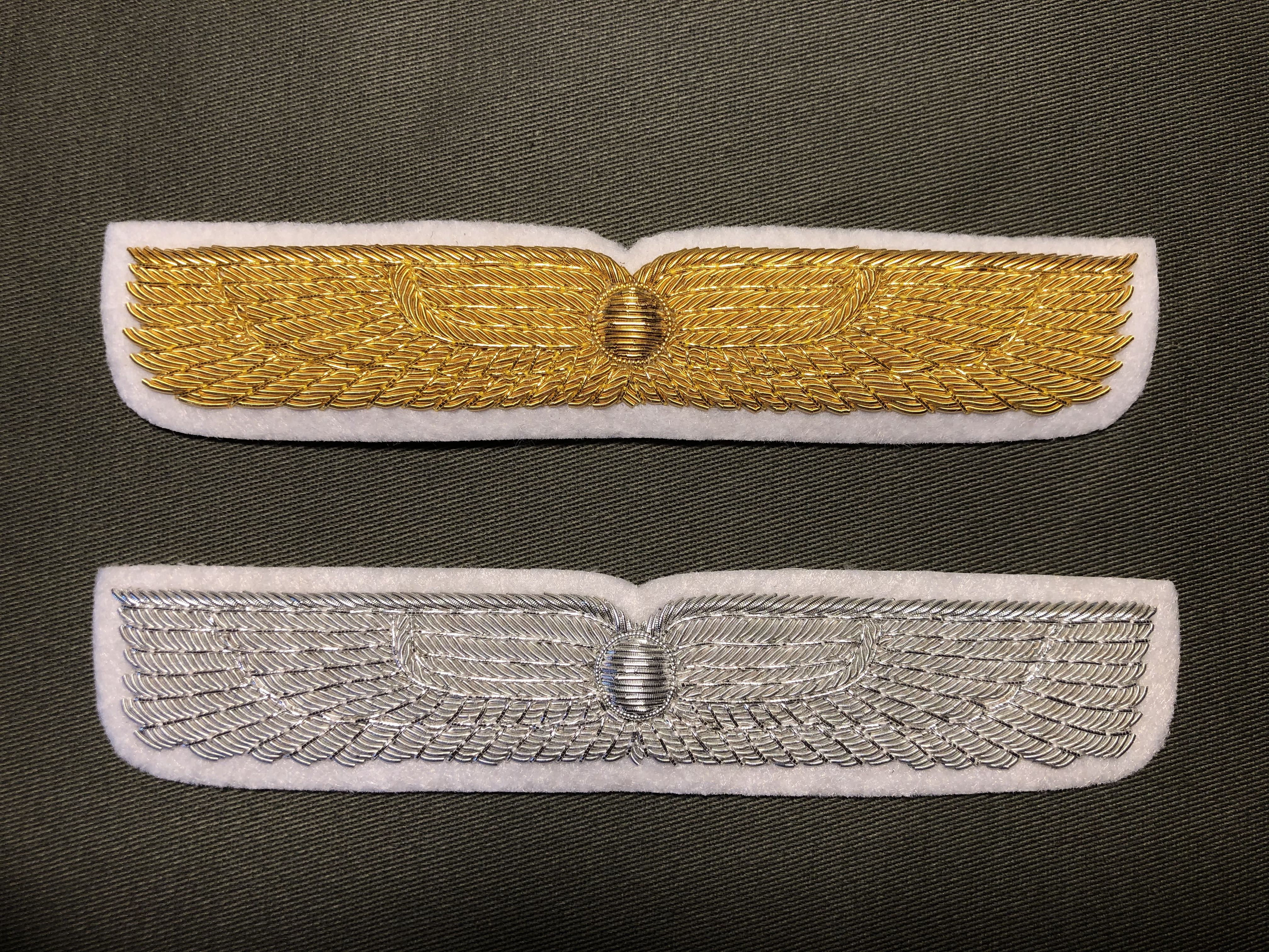

But, alas, it is not the version that ended up in the movie, so I had to remove the wavy inner part of the wings. I eventually ended up with these two designs. I feel like these are the most true-to-screen and true-to-the-original-patches in both design and production process:
View attachment 1343739View attachment 1343743View attachment 1343742View attachment 1343741View attachment 1343744View attachment 1343740
In conclusion, I have spent a tremendous amount of time and effort trying to perfect these wings. it also adds to my appreciation of the creative process that went in to the production design of this film, it is truly mind blowing! It also just goes to show how far Ridley Scott's layer upon layer approach to movie making went. I am a bit biased, but I couldn't be happier with the end result. Hope you like them ;)

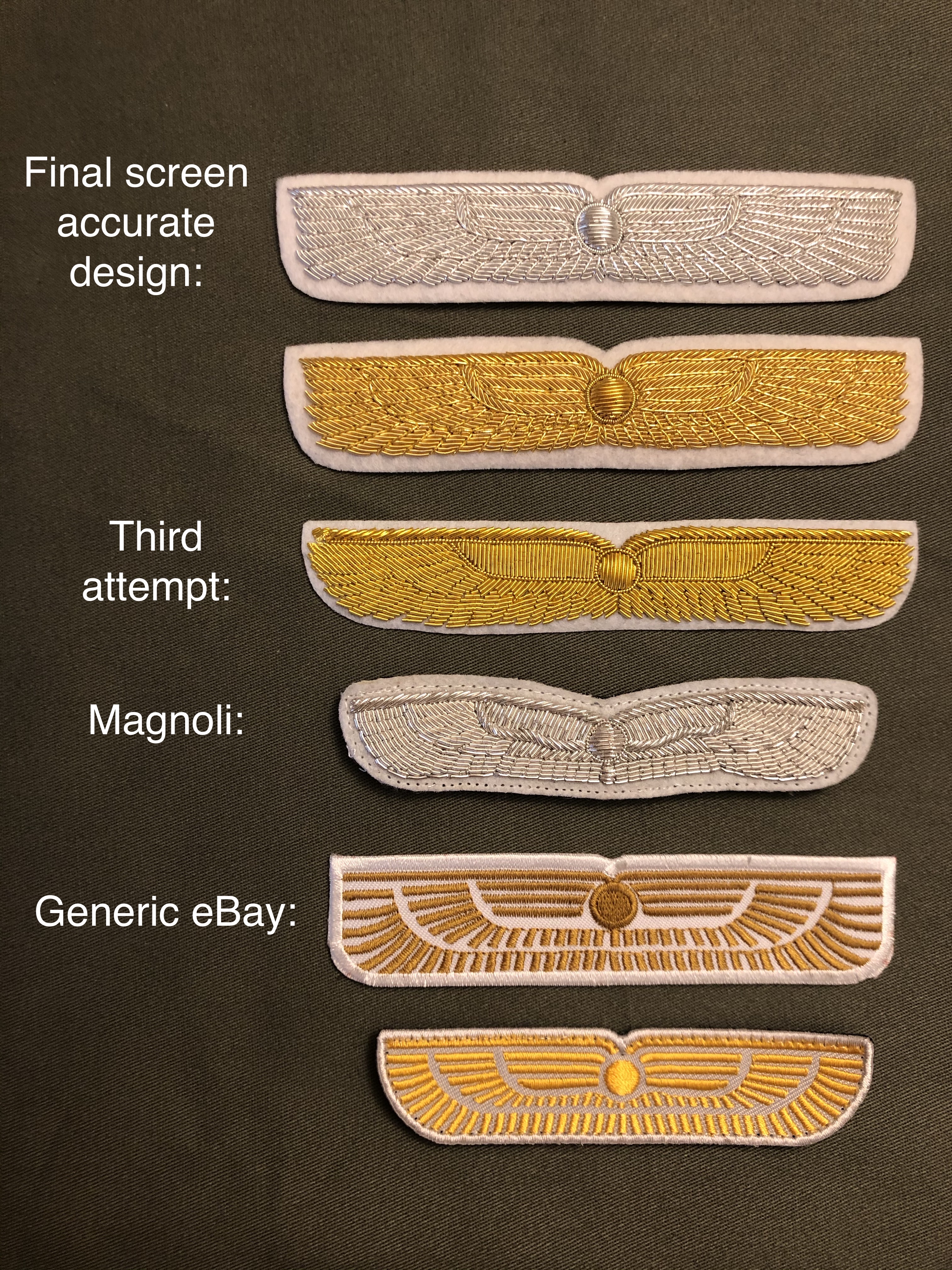

Some comparison pictures:
View attachment 1343821View attachment 1343820
