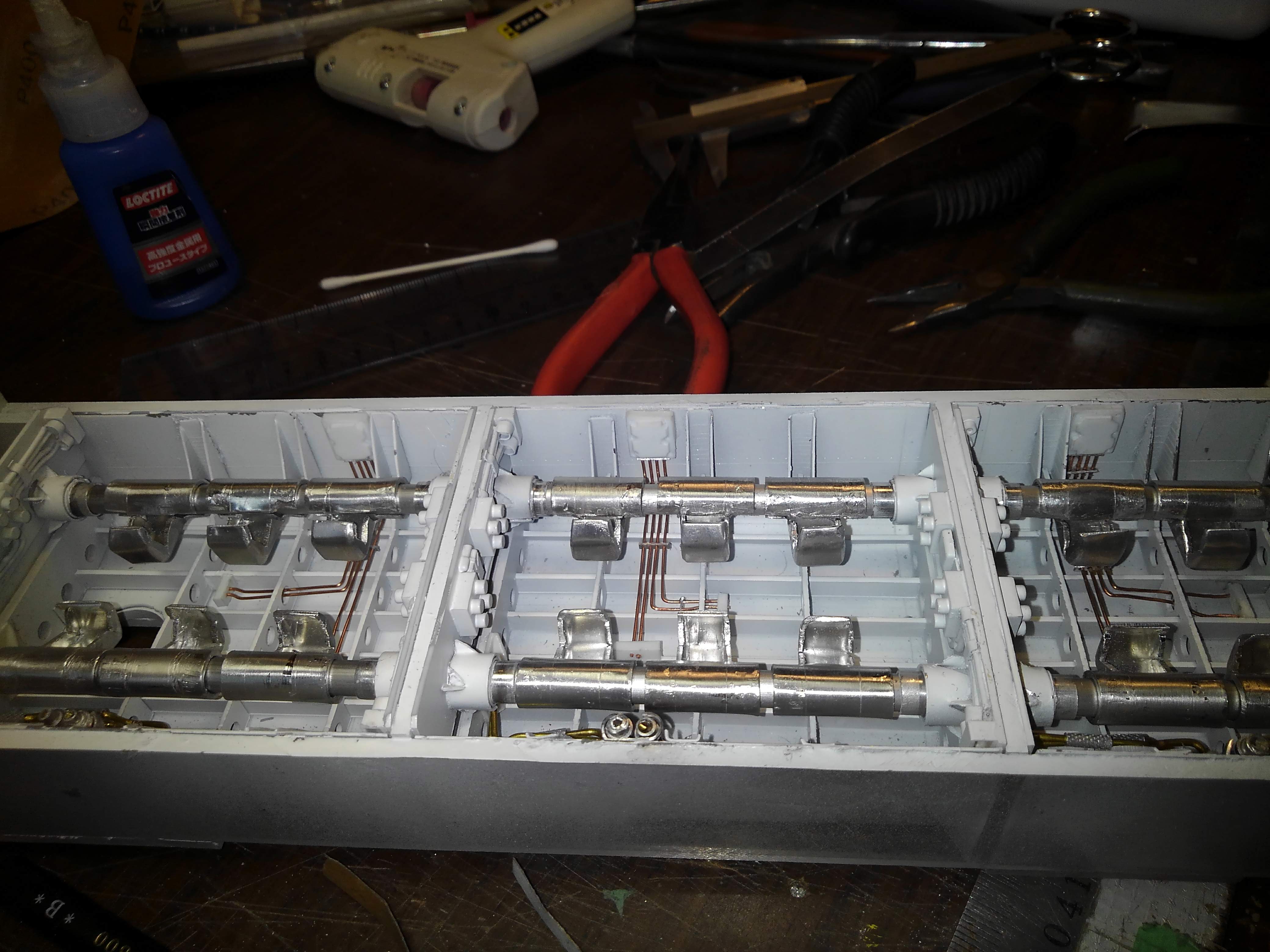

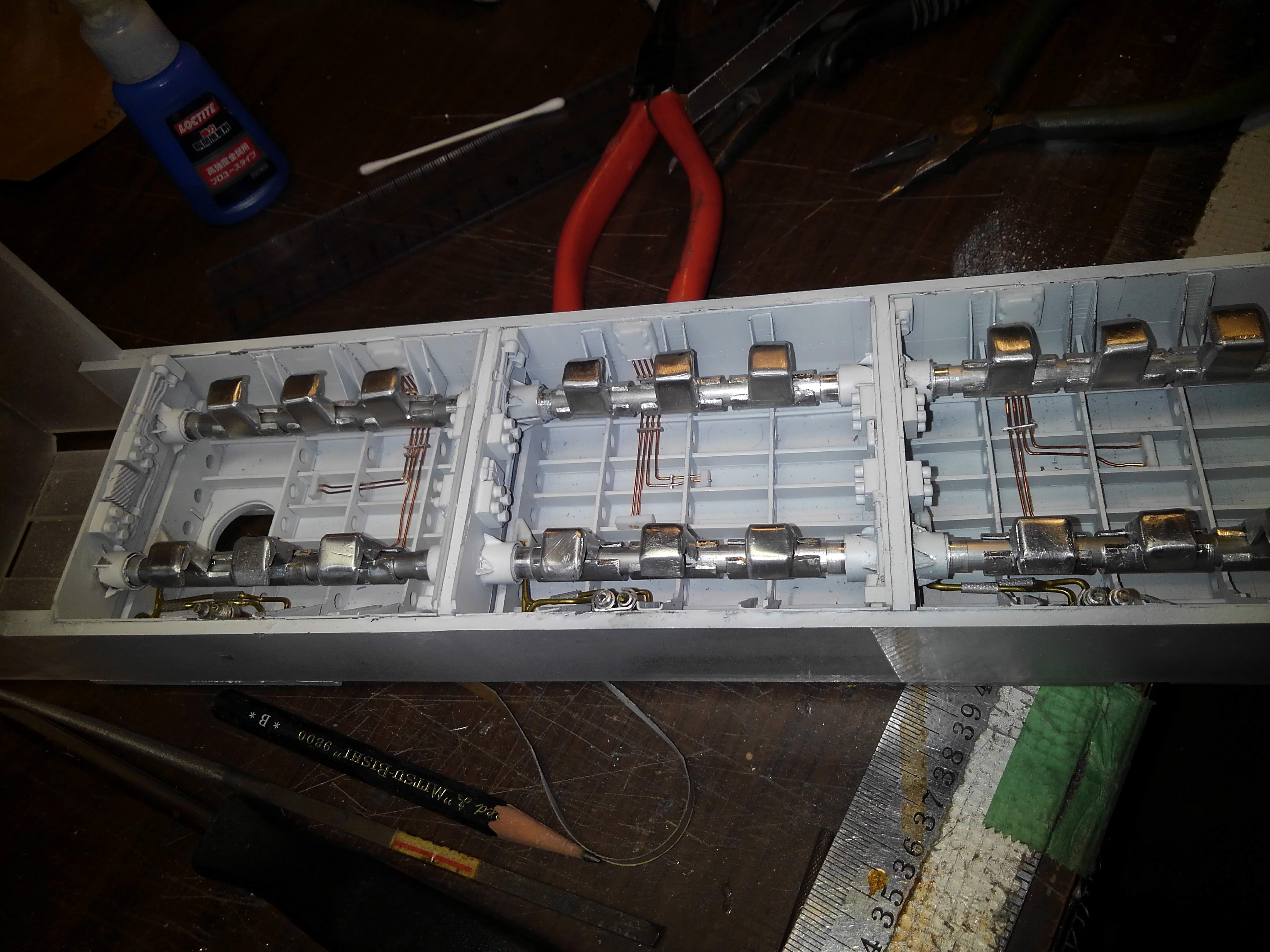

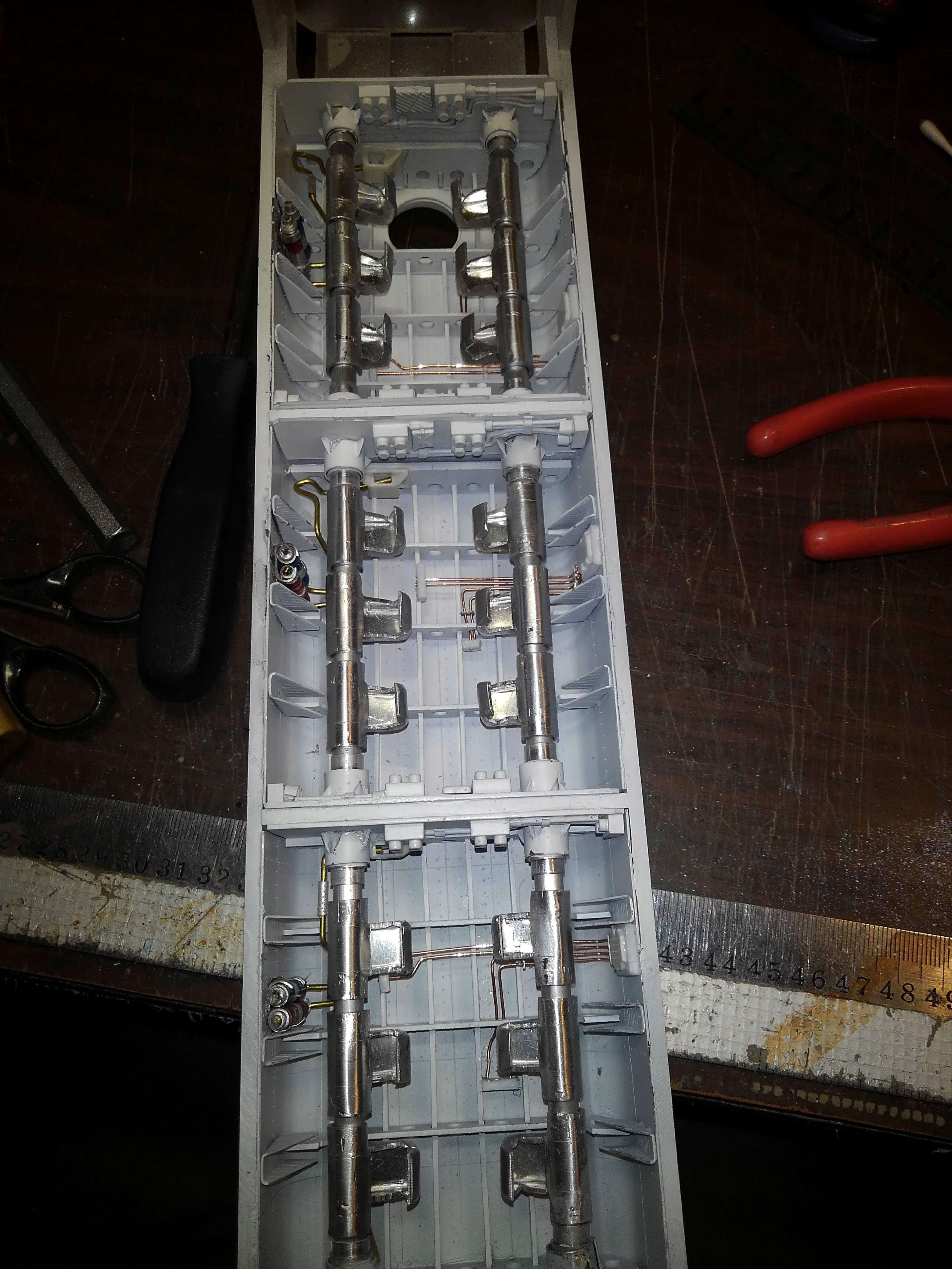

I've finished to built all the claws and trimmed them and polished.
Now here is a problem.

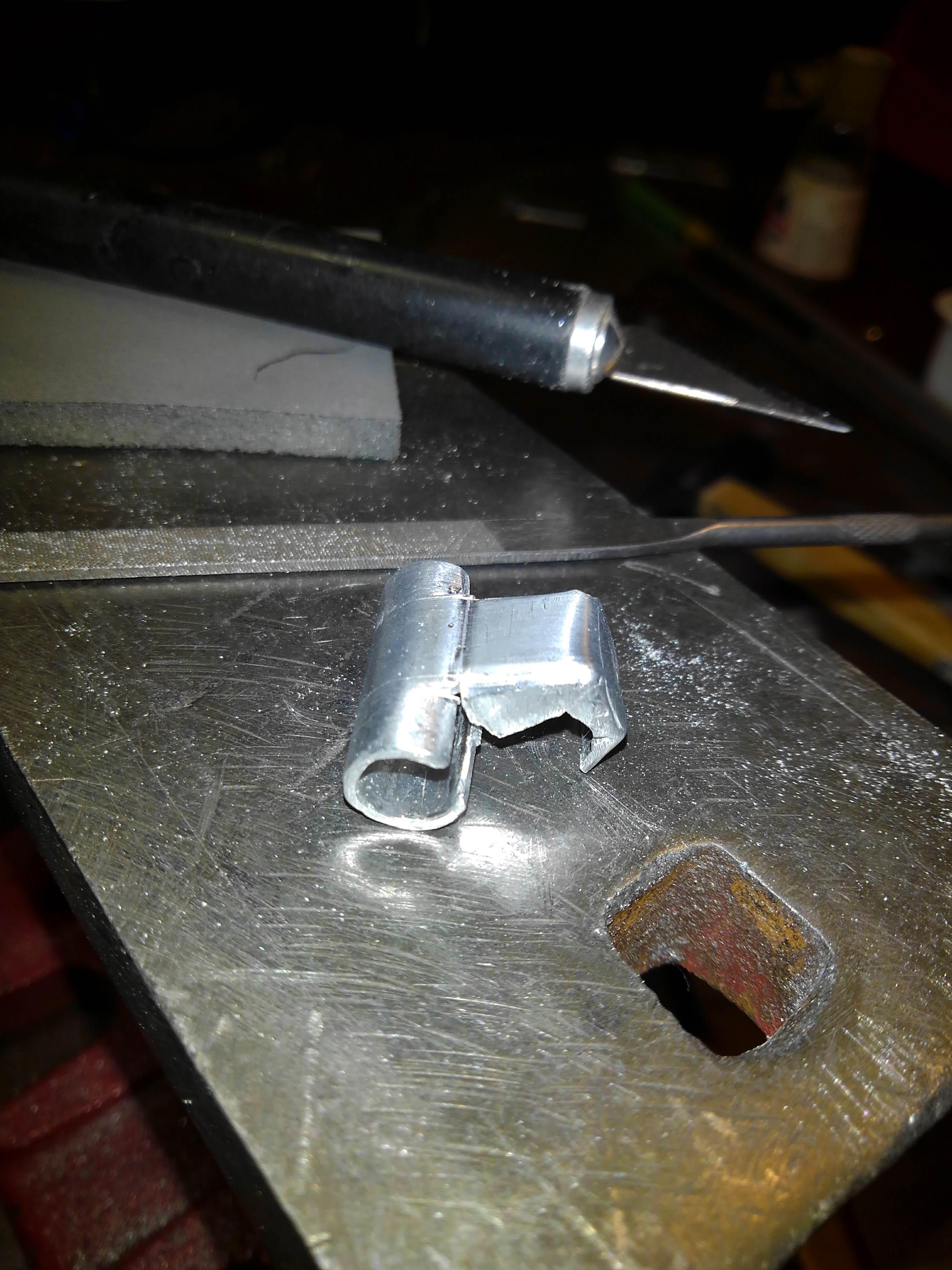

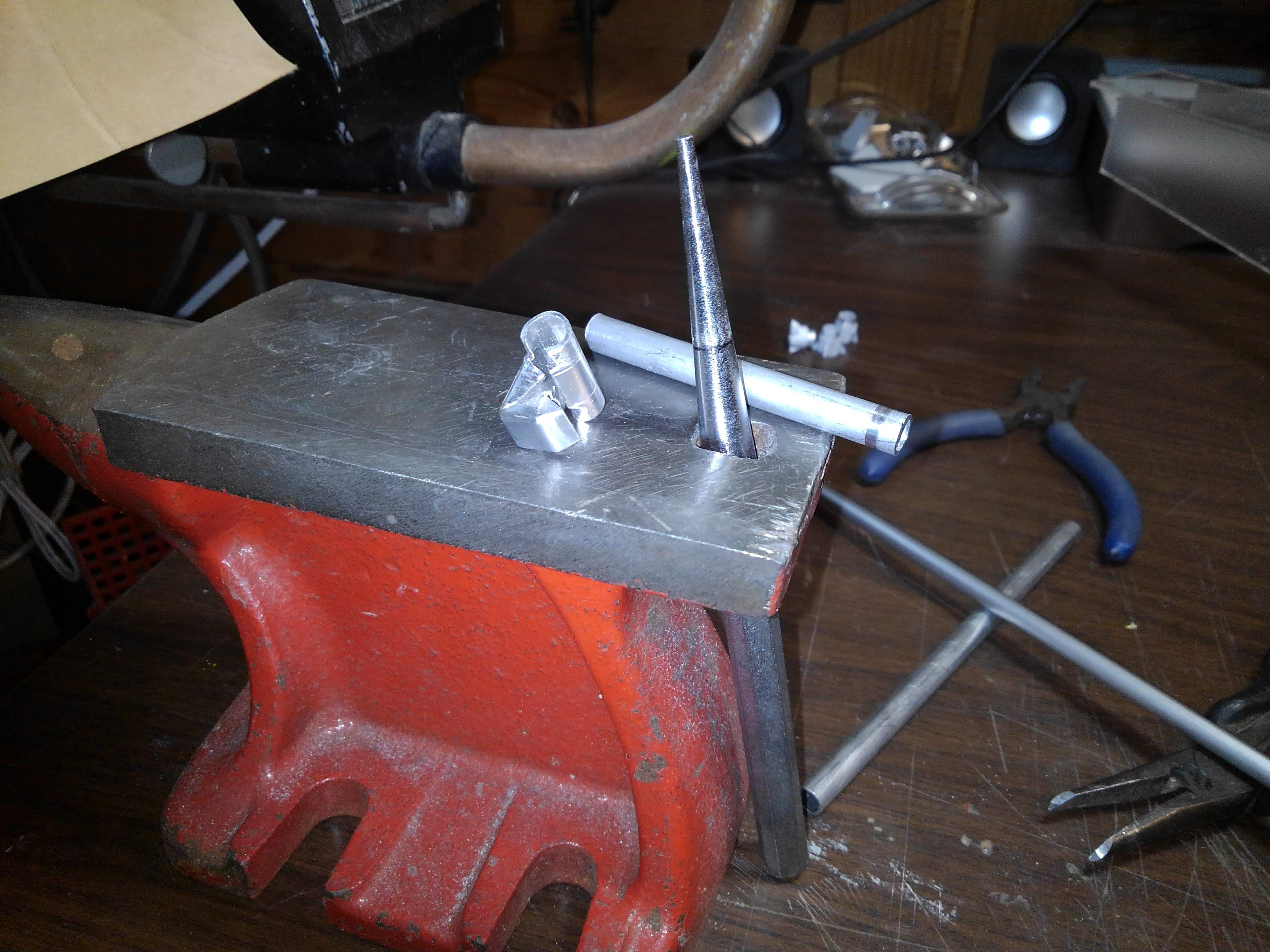

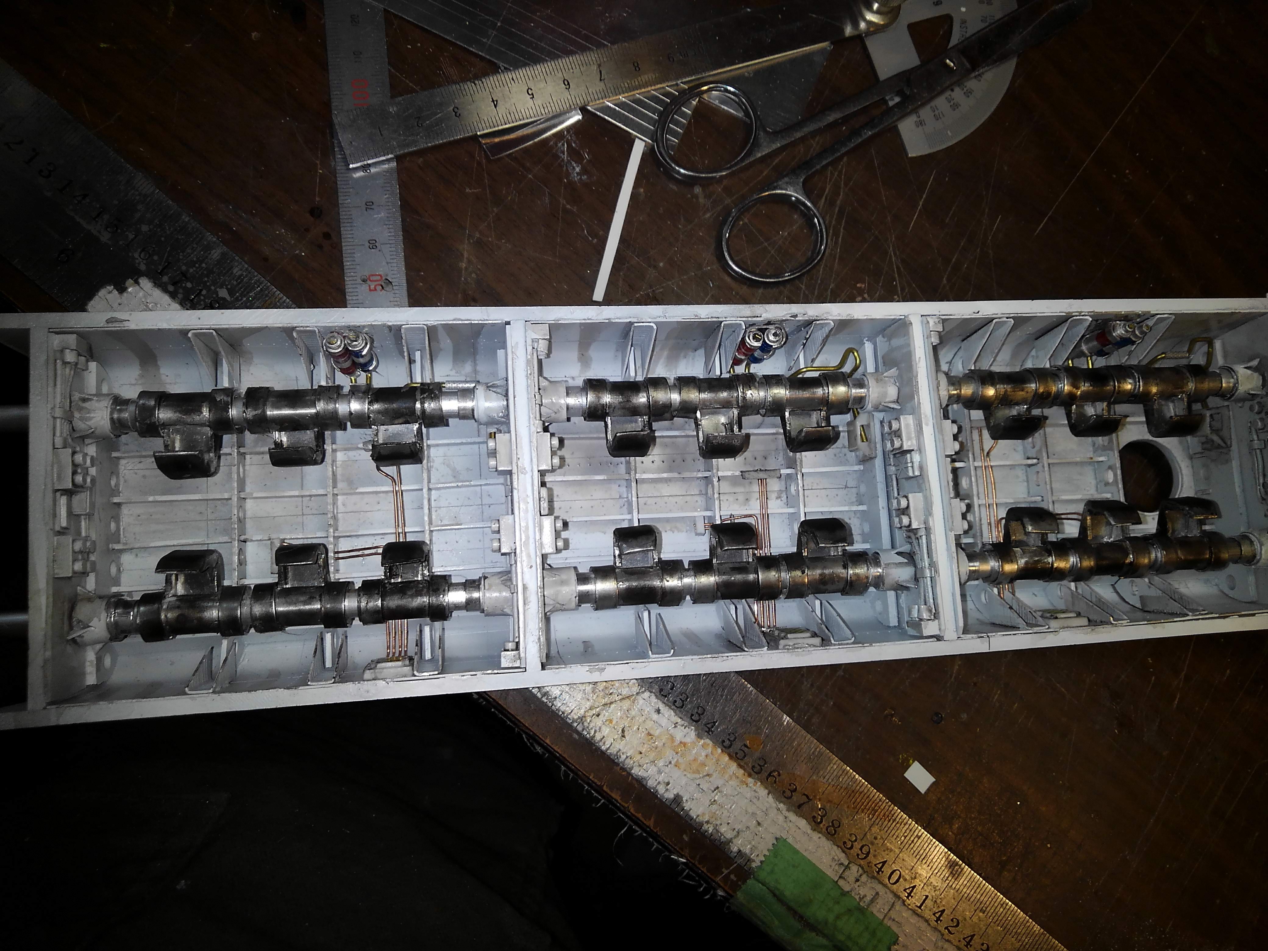

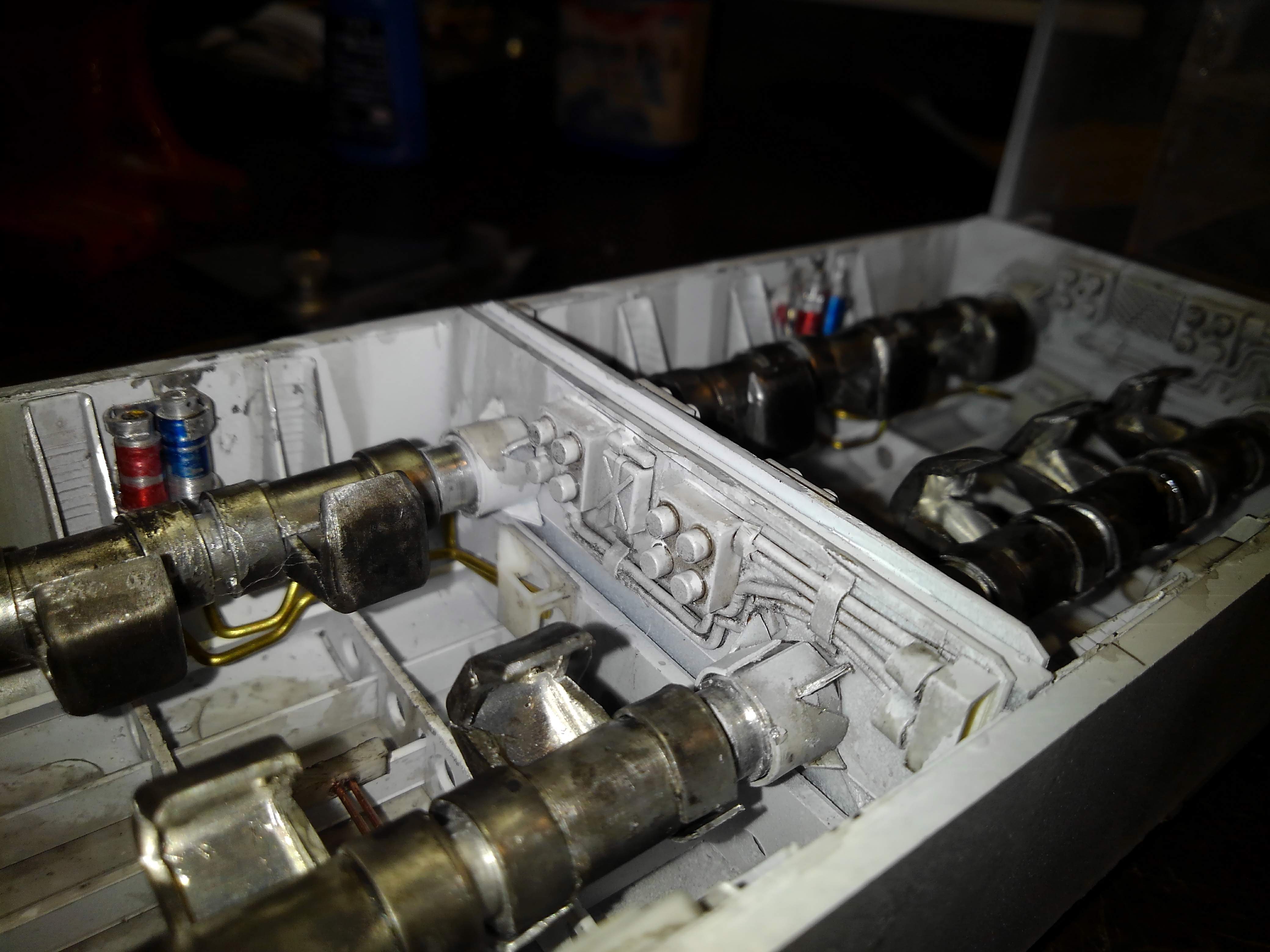

Both shafts have nine claws and go thru three bulkheads. If these claws are too tight for the shaft, it will be very difficult to make them thru smoothly. -Actually, they were- But if you make them too loose, it must be very hard to tighten up these thick aluminum again after you set it up. -Actually, it was- You need an appropriate friction to hold them.
Since these claw pieces are hand made with flat aluminum sheets, it is very difficult to make each pieces completely accurate. So I made them rather a bit narrow for the shaft to put thru. Then I widen these to be the exact diameter to fit the shaft like this. You see the marker line around the punch. Set each pieces on to this punch and hammer it until the pieces reach the marker around the punch. So that I can get the exact diameter to fit the shaft.
Setting them up was a kind of a long shot - If I messed, it will be very difficult to do it again - but fortunately it worked.

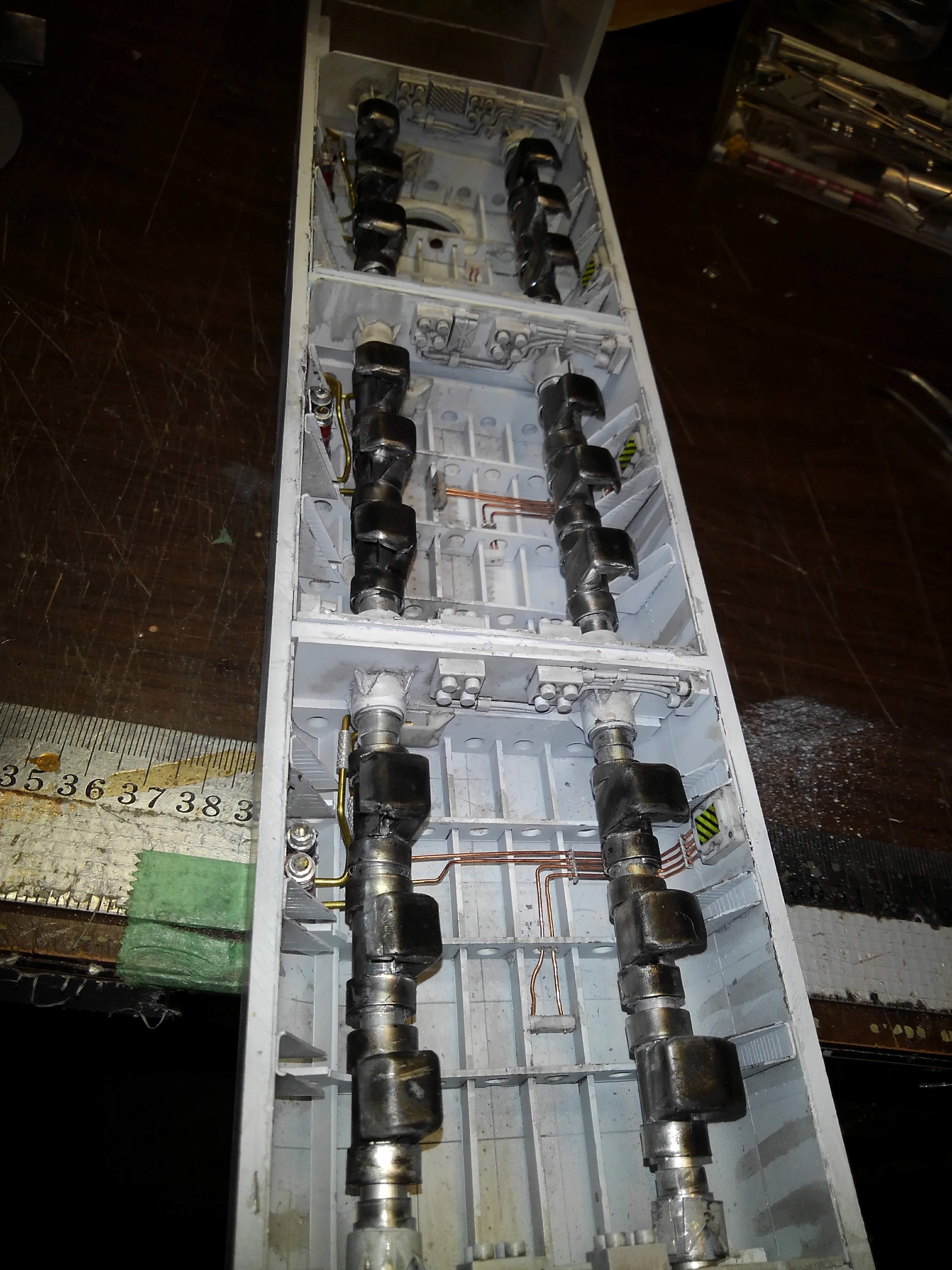

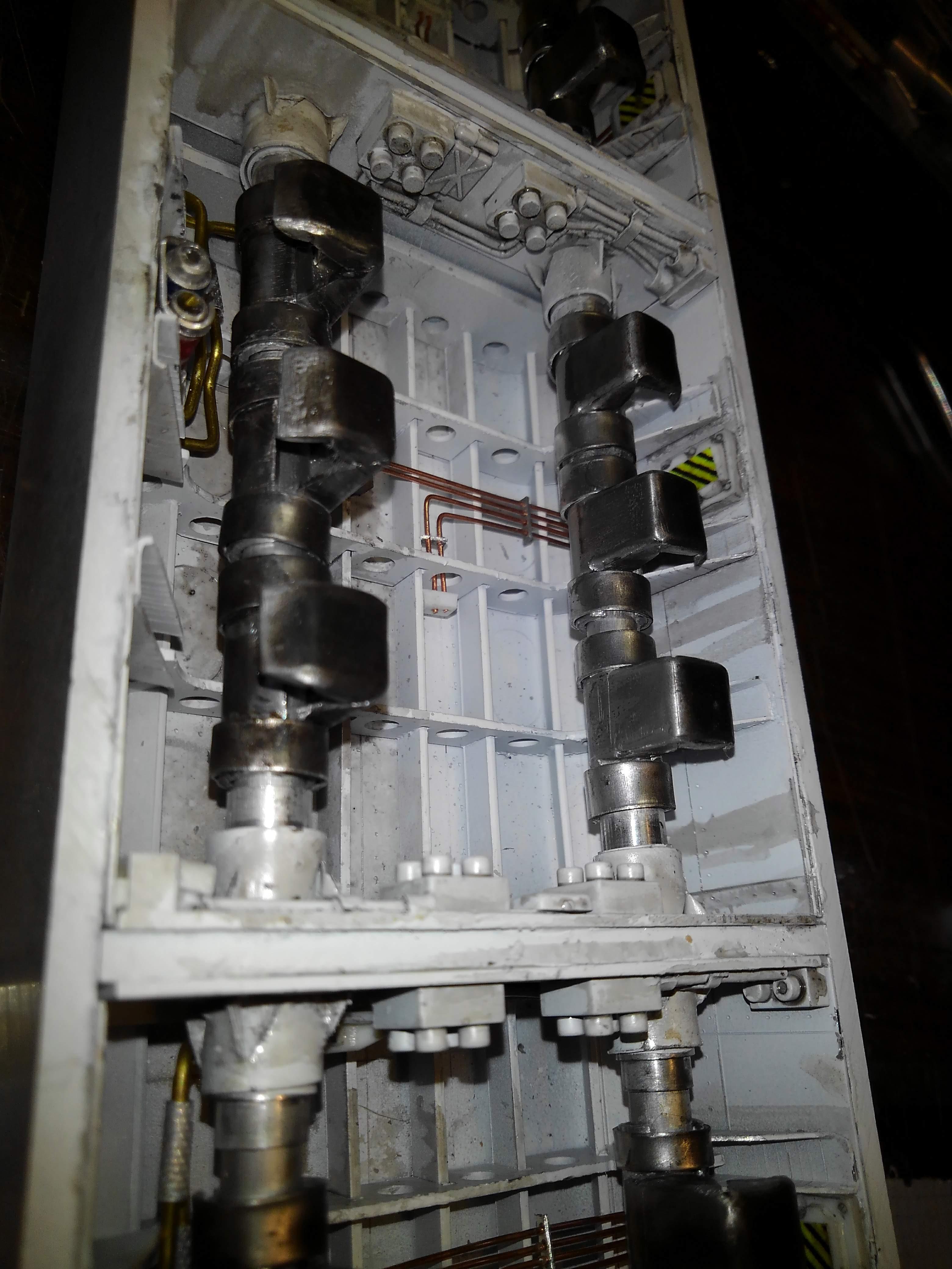

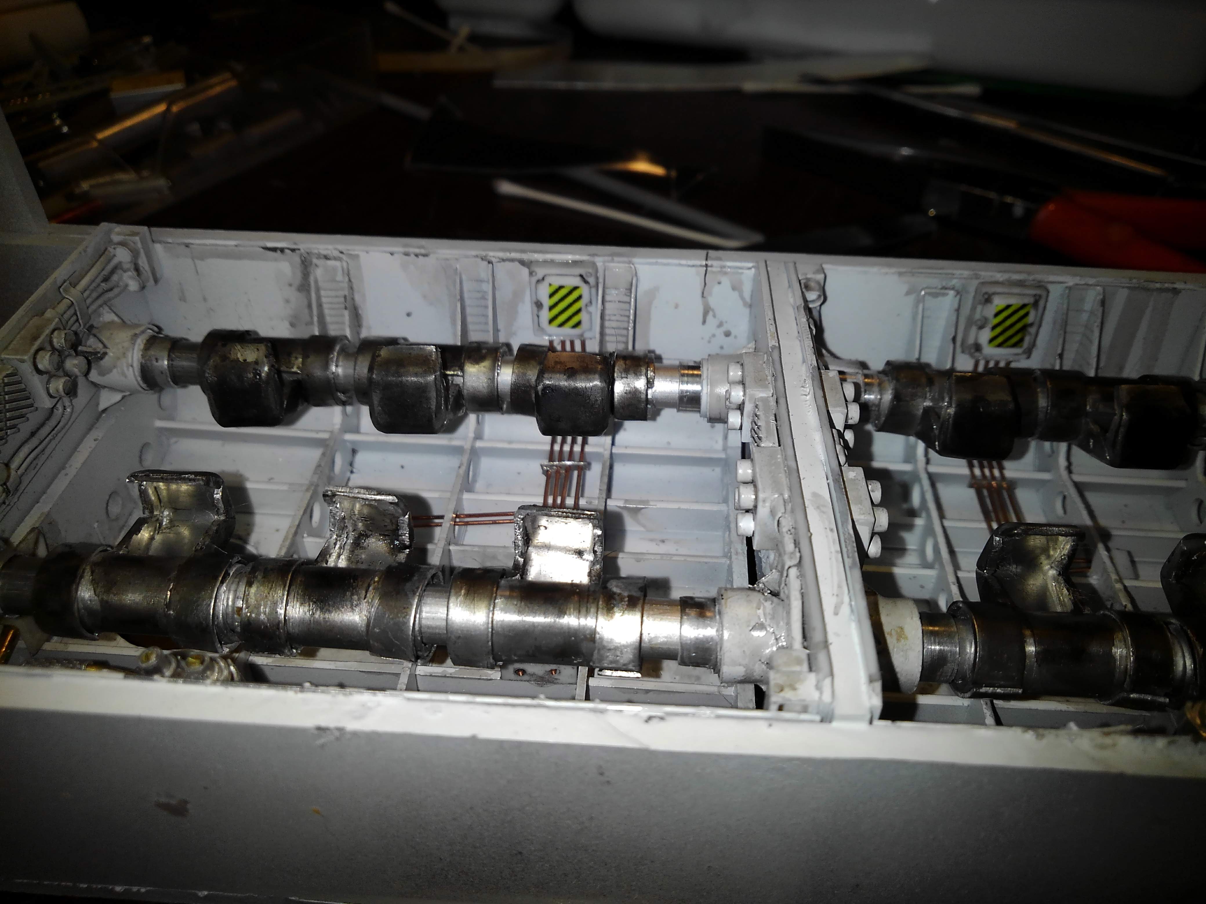

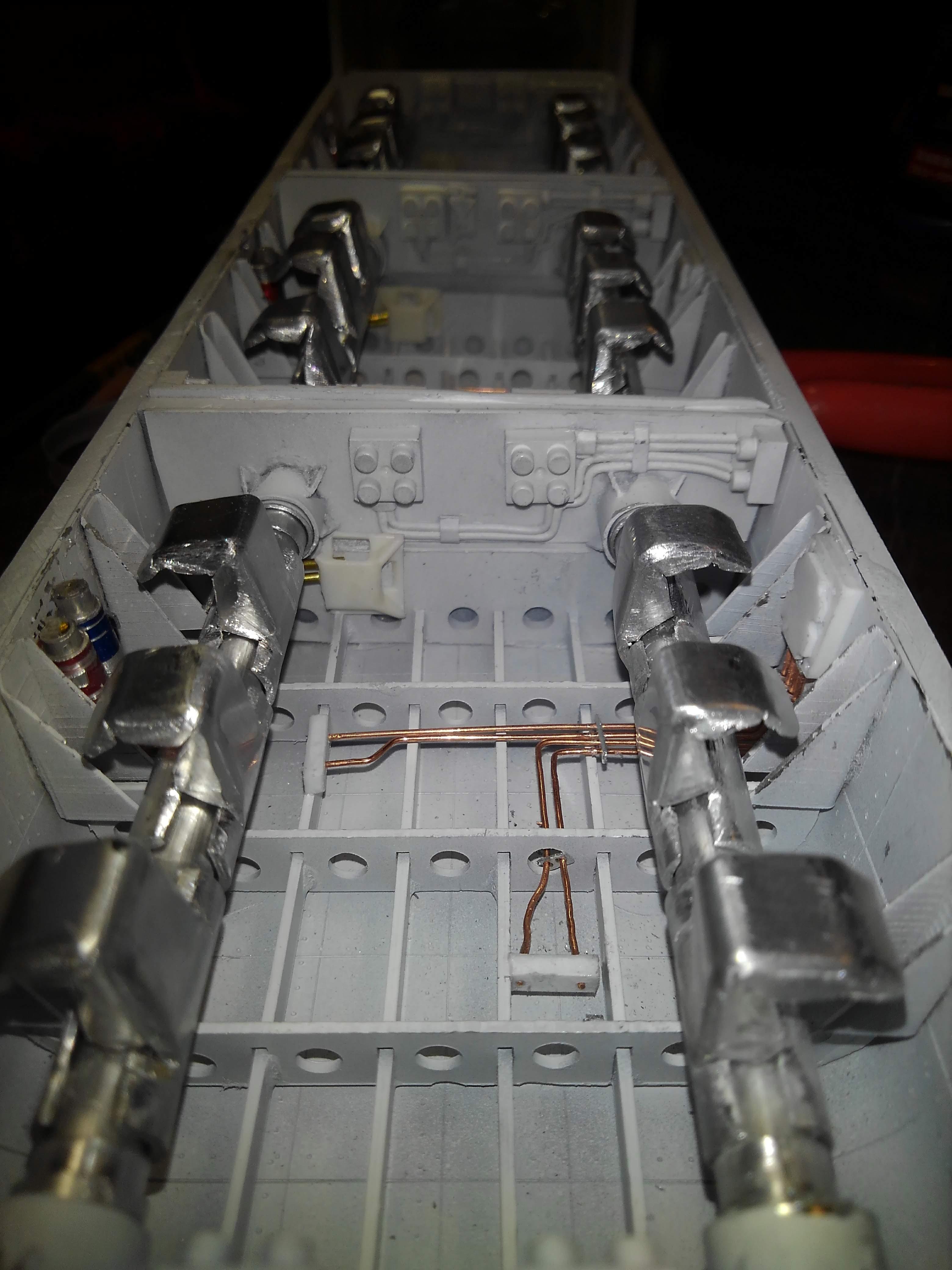

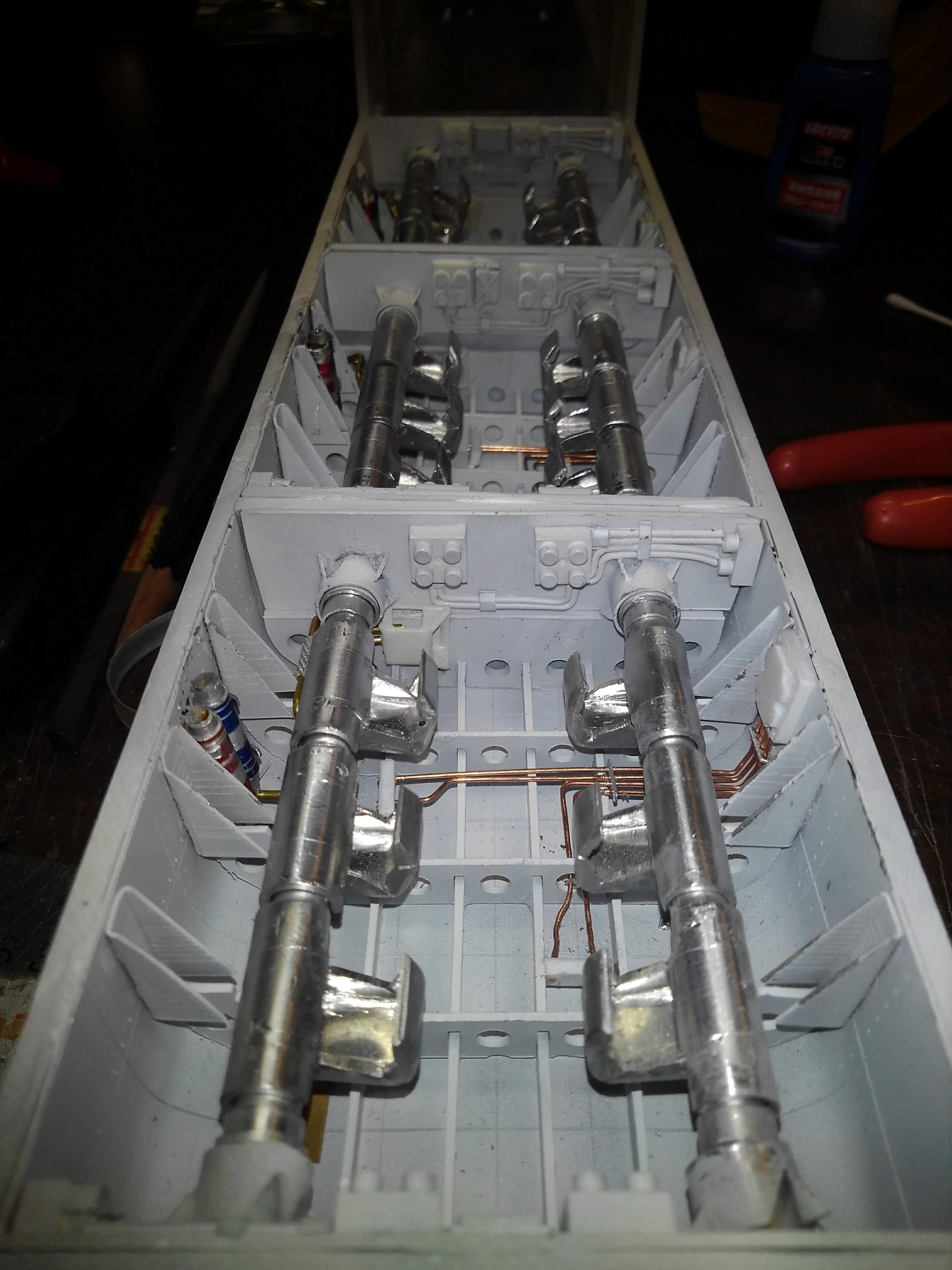

Hooking position.
Release position.
I can't say it is completely accurate about uniformity.
But I should accept the limit of my ability and should be compromised.
Bla bla bla.... Heck, I just wanted to say ' That was a tough part! ' :lol:

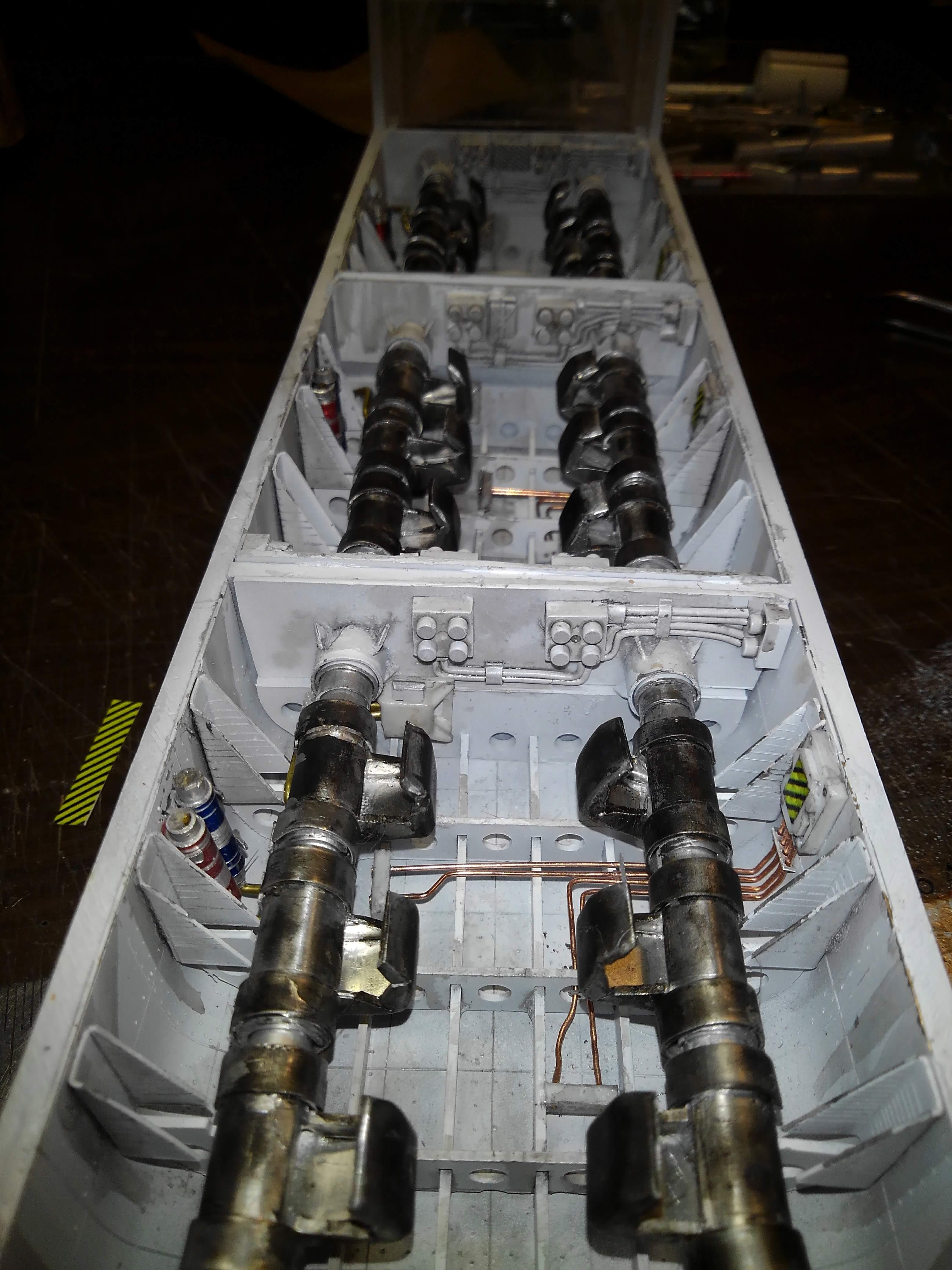

A few more detailing and touch up including some weathering, then this part will be finished.
Thanks for looking,
Katsu

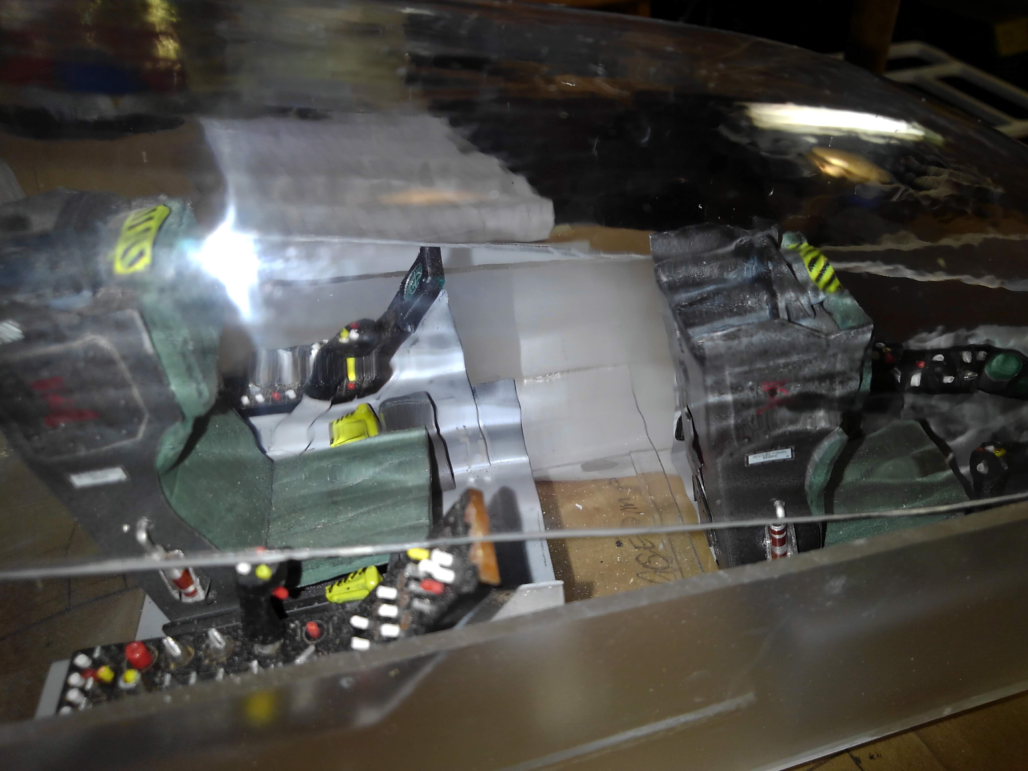

Canopy

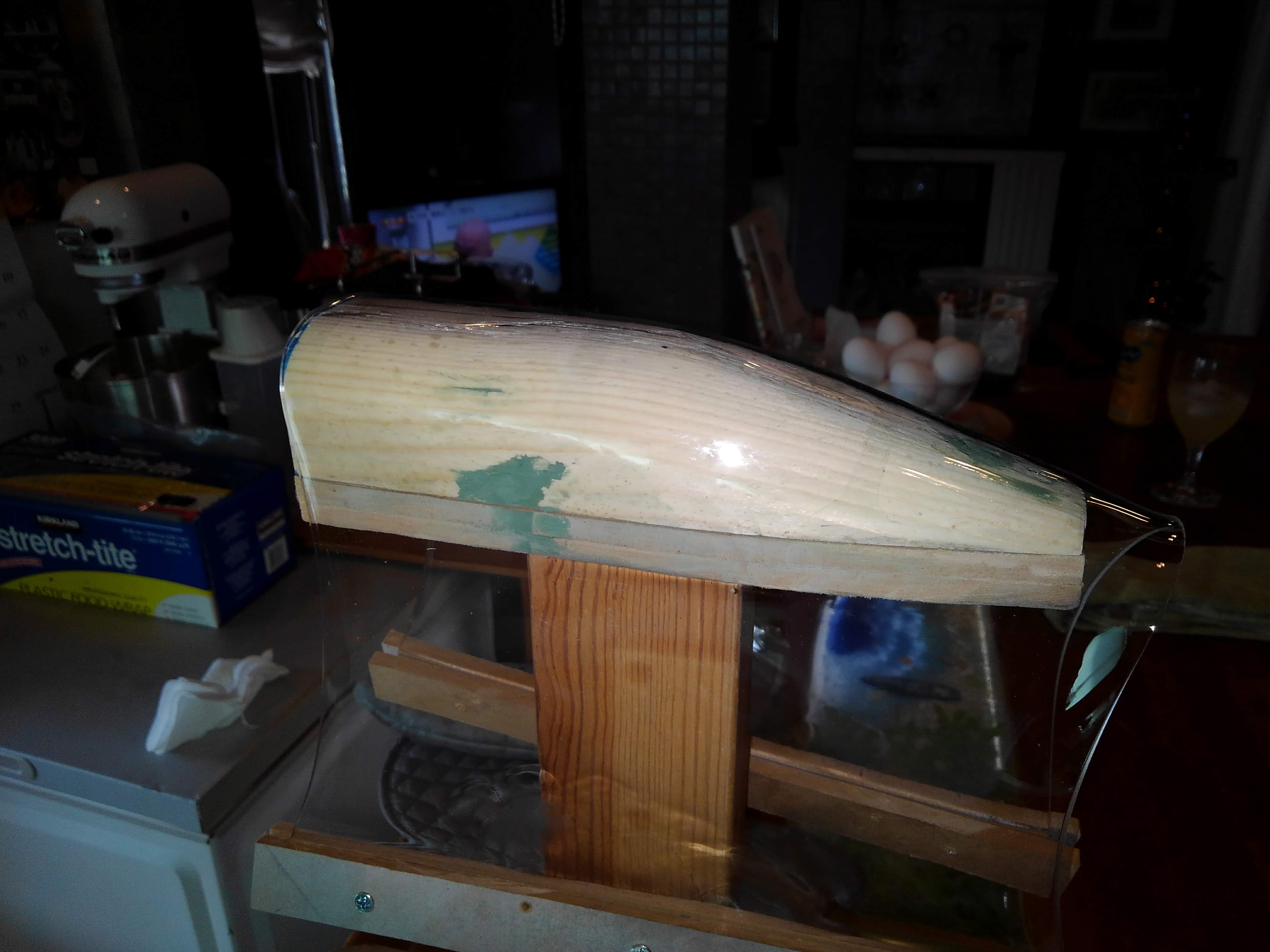

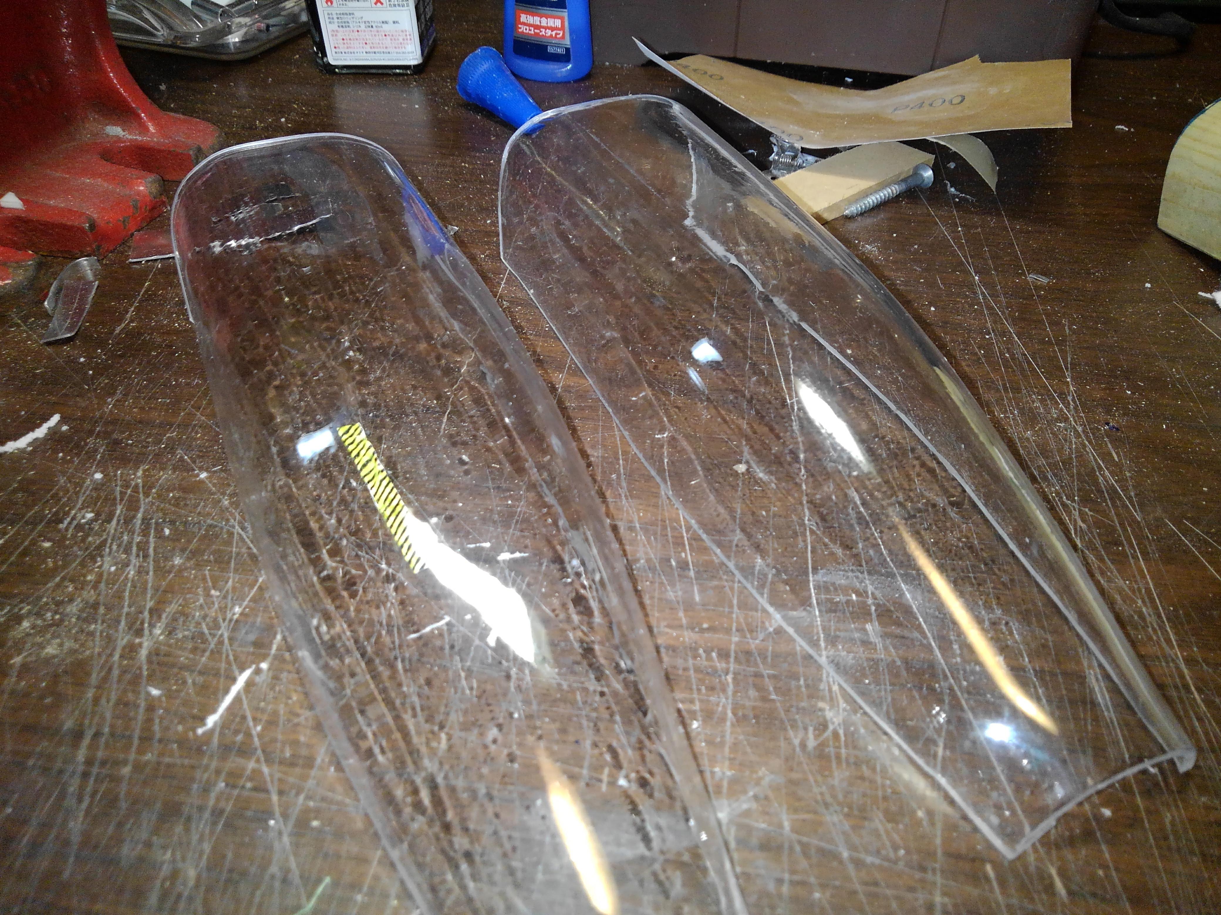

I said I'm gonna vacuum forming for the canopy but while I taking a nap, A thought came up that the vacuum forming might not the optimal way. Because,
1. I am gonna use 2.0 mm thick clear acrylic sheet.
2. I have a long experience that thick acrylic sheet need a very high temperature to be softened.
3. If you raise the temp so high, there always a risk of bubbling inside.
4. On the other hand, If you heat up the sheet up to an appropriate temp,
that 2.0 mm sheet will be too hard for shaping with the suction power of the home vacuum cleaner.
5. Since the canopy is simple shape, I thought another easy way might work as well.

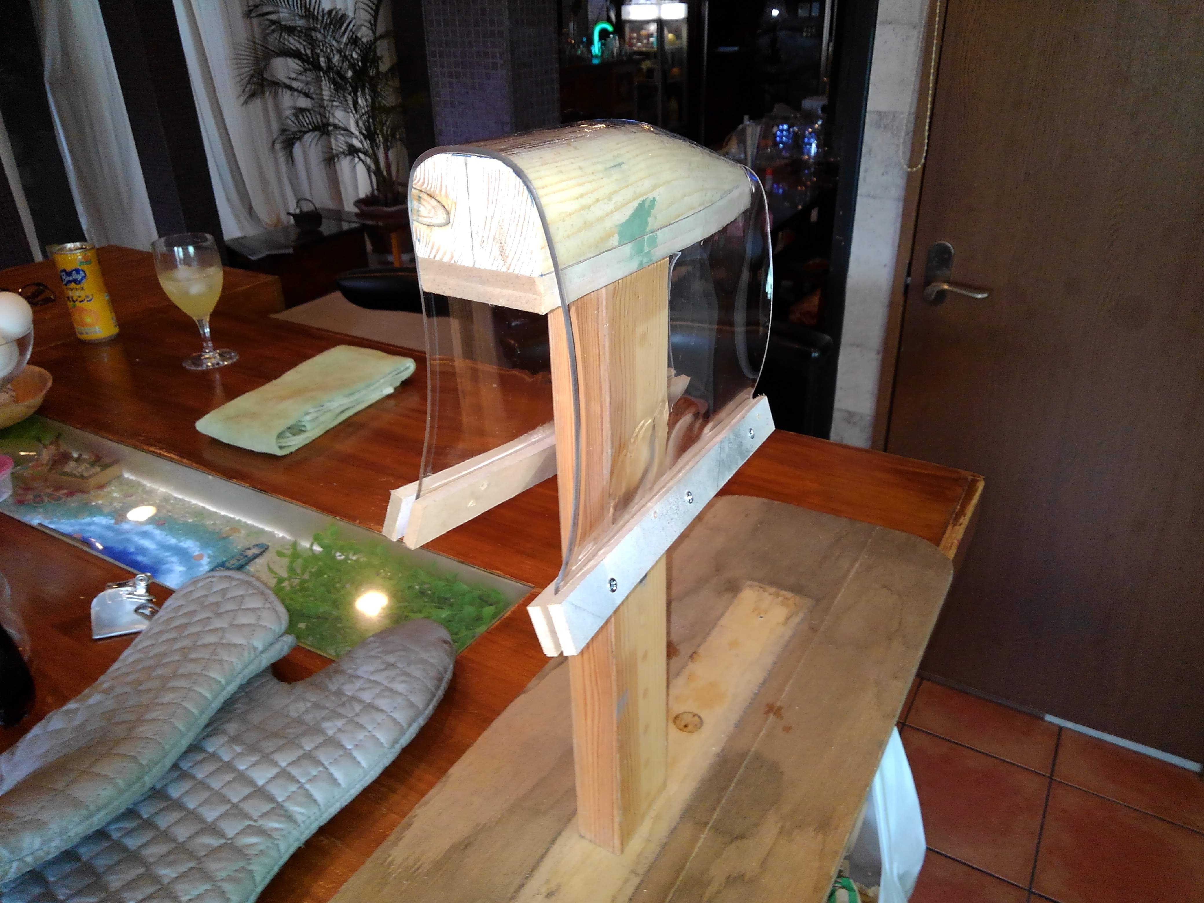

So I tried a heat pressing.
Lately, I often feel I am making a long excuse.
In short, I always hate doing vacuum forming.
Heat up my oven up to 200 degree C.
Attach a pair of pull handle on a both side of the acrylic sheet and put it in the oven and wait for about 2 minutes.
Then put the sheet on a plug and press by pulling a both handle very hard. You don't forget to put on a pair of oven gloves.
I think it's an acceptable quality.
That means I want a better one.
I'm gonna fix a plug a little bit and make it a few more.
Thank for looking!!
katsu

I’ve never tried vacuum forming, it looks difficult and I’m worried about using my oven to heat up plastics ...., but what you’ve posted may change my mind down the road.
What do you use to cut the styrene so ‘cleanly’ after it’s shaped Katsu-san , especially considering the thickness (2mm) of the piece, and the fact that it’s also clear styrene ? :unsure:
