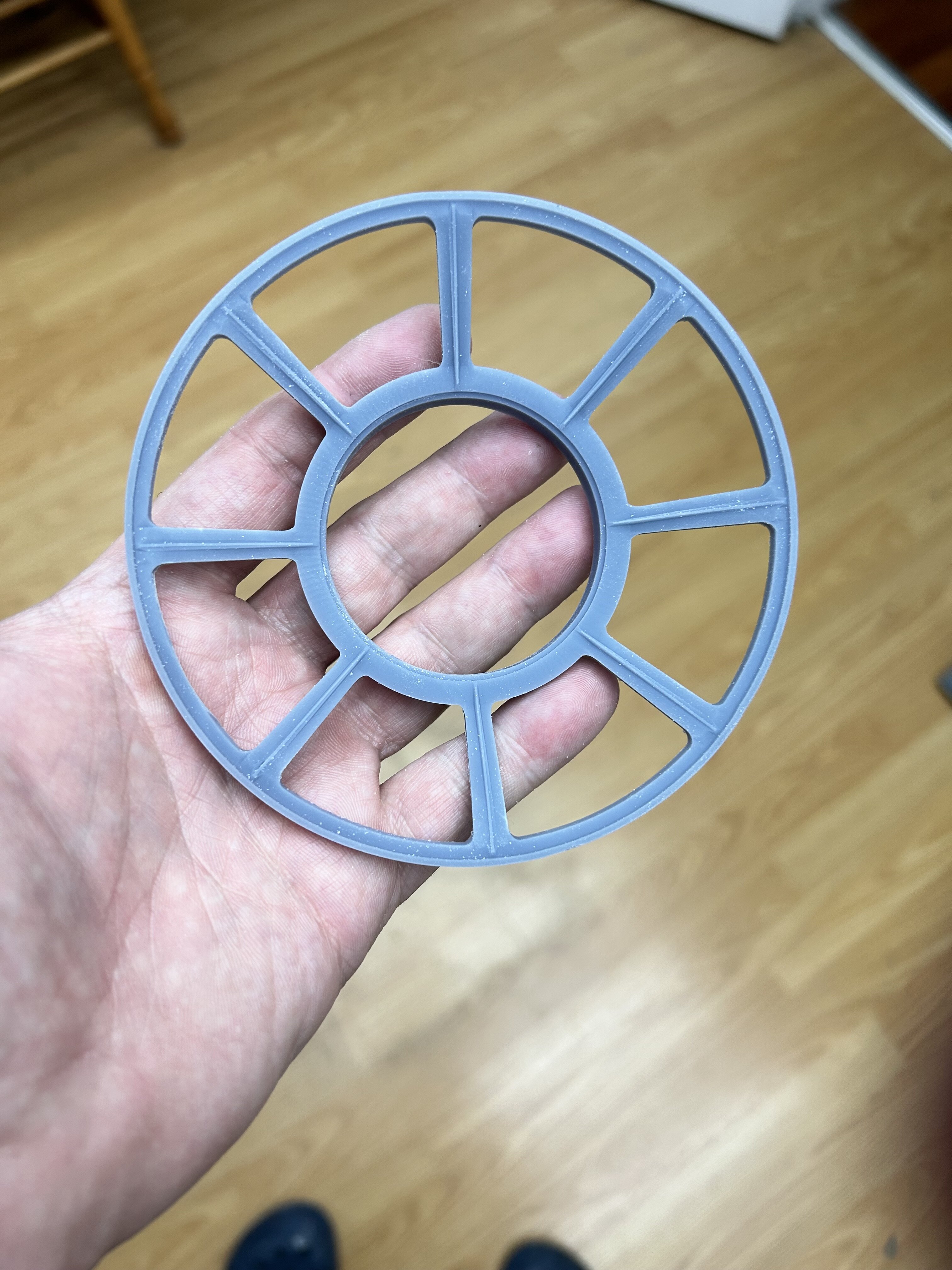

Printed 2 docking rings yesterday. Printing them both on the plate at once took about 10 hours, and then another hour of clean up. 3D Printing is great, but honestly these two parts would have taken me about 30 minutes on my lathe and a block of MDF. Sadly, I no longer have access to my lathe, or anyplace to put it if I did.
Anyway, a bit more cleanup and they should be good to go.

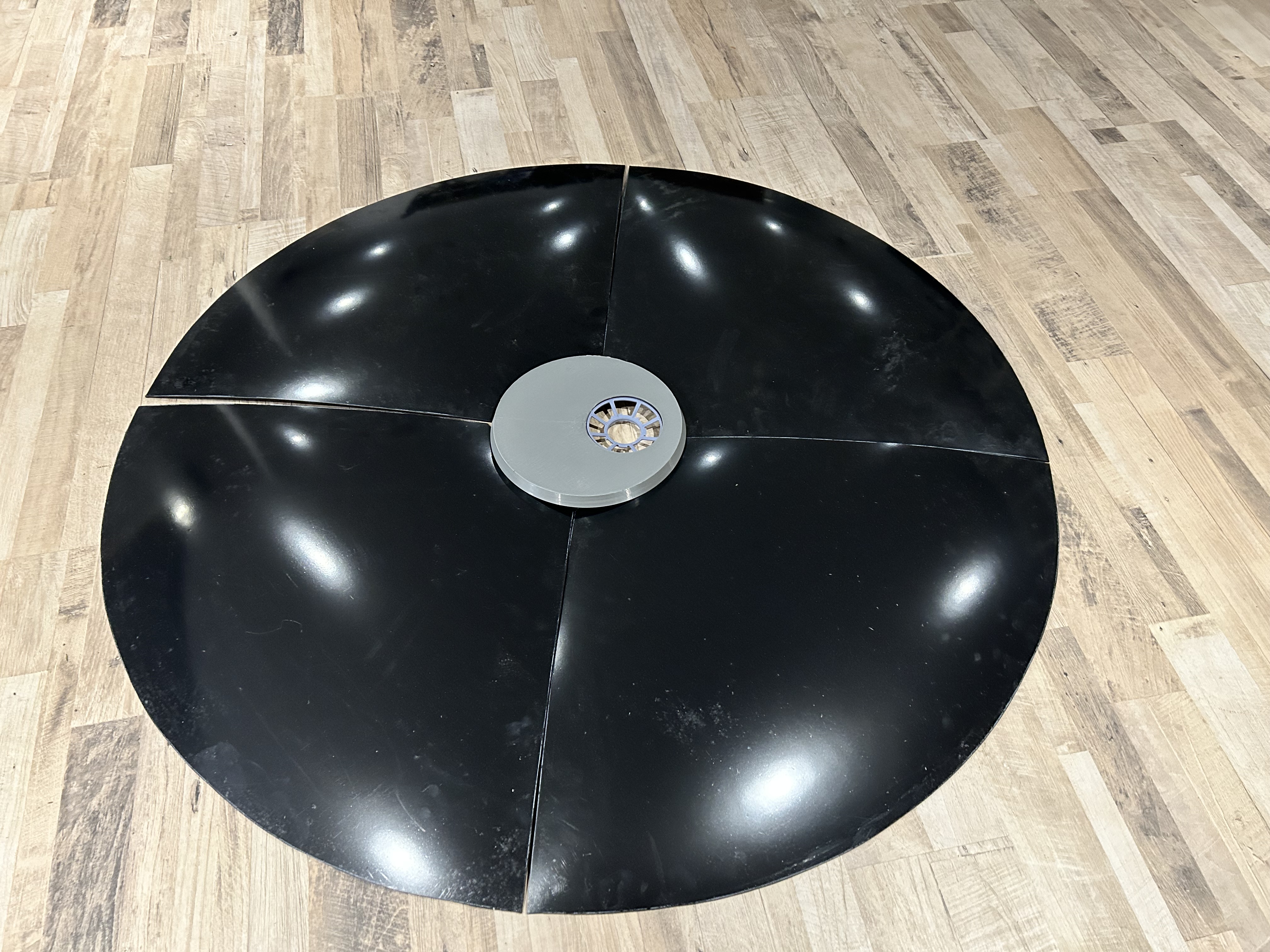

Well, thanks to Stu (eagle1) I have a set of 5' Falcon domes ready to go. I'm almost finished the thing at this point...;)
I really didn't grasp the size of the thing until I started putting parts up against my 32" build for comparison... wow.

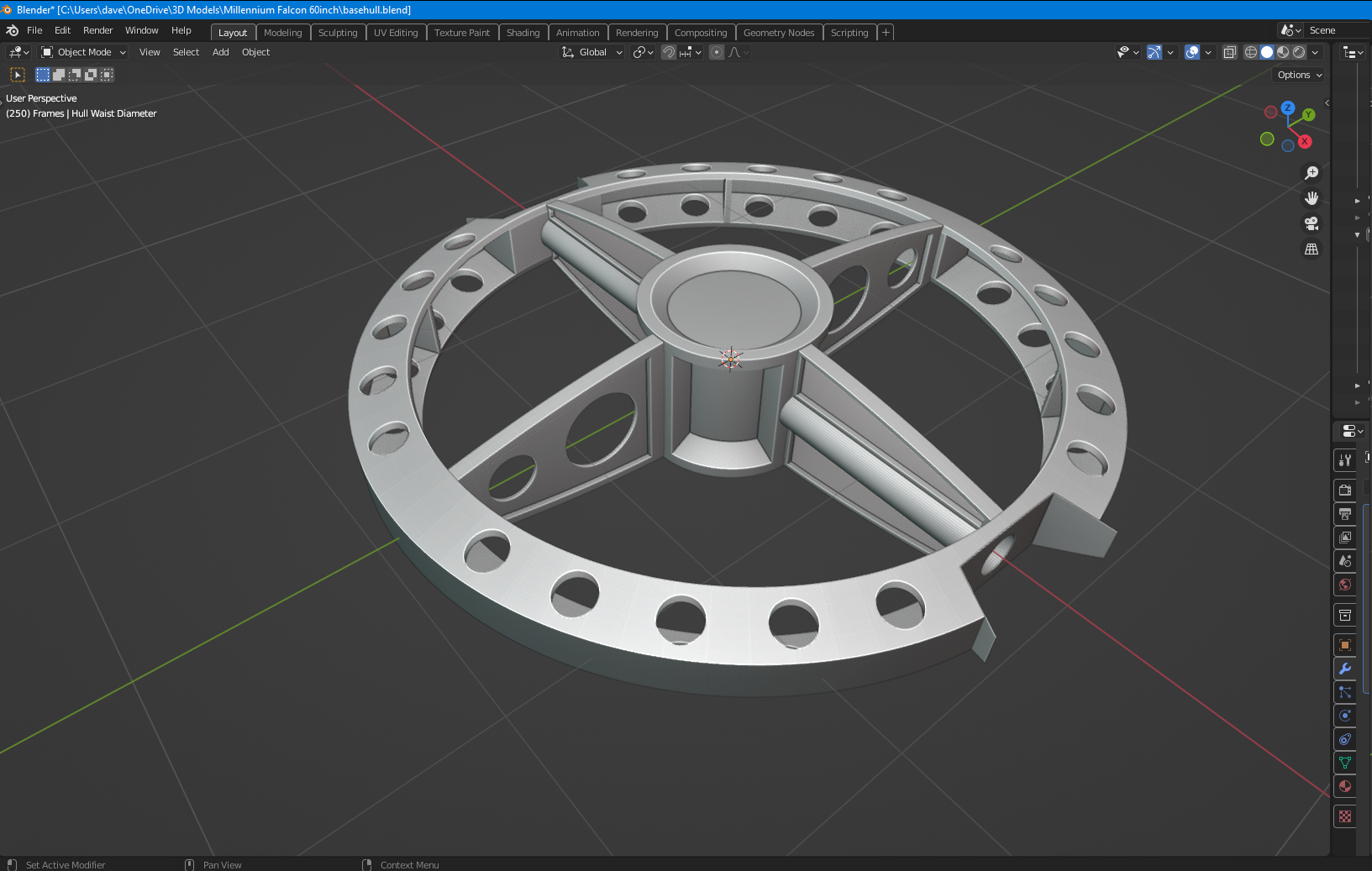

When I purchased the hull domes from Stu, he included an MDF frame template. Unfortunately I no longer have a shop capable of working with wood so I'm 3D Printing my hull frame. The concept is something akin to a spoke wheel, with frames radiating off a central hub. Anyway, last night I printed my PLA test version of Stu's wooden frame and it's correct to within 0.01" (0.25mm). Honestly, when you sit them besides each other and run your finger over the seam between the two, if it wasn't for the material texture change, you wouldn't feel the difference.
But just as importantly, the weight difference is massive. the PLA frame weighs about 20% of the wooden one (maybe less), and it doesn't have lightening holes yet. As a proof of concept - Can I print an accurate part? - it's a wild success.
When I set out to do this project, I had the goal of 100% accurate including internal structure. Sadly I've had to reign in those expectations and just keep to 'external accuracy'. What you can see should be correct, but the hidden stuff I can't get too fussed over because I don't have the shop for that sort of work.
Anyway, now that I've proven one of the basic concepts, I can move on with the remainder of the frame design.

My current plan for the main hull interior structure. I'm not 100% finished the design yet, I still have to do the mandible supports on the front. But generally, this is what I'm after. Spokes off a central hub that also doubles as the stand mount. I've taken a cue from the ILM model and added lightening holes throughout. Although 3D Printed PLA is already only about 20% the weight of a wooden structure, and just as strong.
For something that nobody will ever see once it's all buttoned up, I seem to have put a lot of effort into this part of the process.

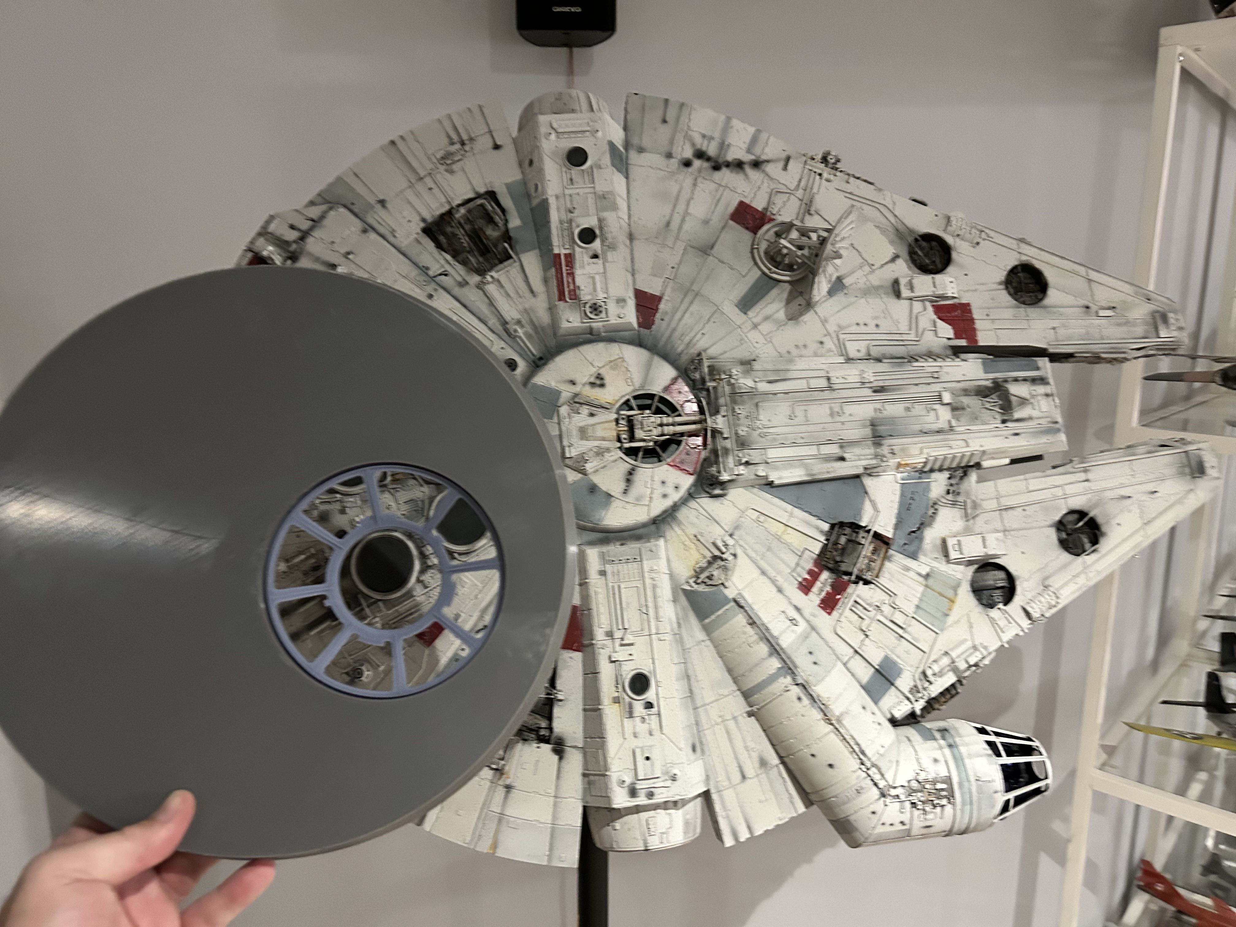

For the size comparison pic from last week....I remember earlier this year seeing a pic of someone holding the dish in their hand, which looked pretty big....and I was then working on the much much smaller MPC Falcon, where the dish is like an inch or so big....it is kinda funny seeing such a huge difference.
