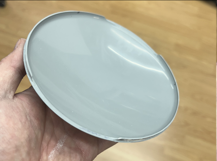

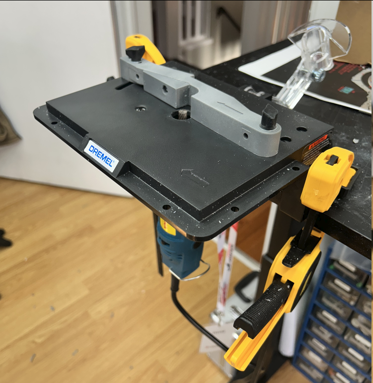

So thanks to tips from t2sides and eagle1, I've gone back and taken another stab at the main dish.
I purchased a small Dremel router table, and using a rotary file, I trimmed out the lip from the VHD600 part itself. I think I would have preferred to do this with the acrylic version of the part, but I only had the ABS. The ABS plastic is prone to melting and you have to work very slowly with very little pressure otherwise it bungs up with melted plastic.
Still, a small amount of filler putty and I think this turned out pretty well. I have a second VHD600 so if I wake up in the middle of the night with cold sweat because my first one isn't perfect, I have another to try again with.

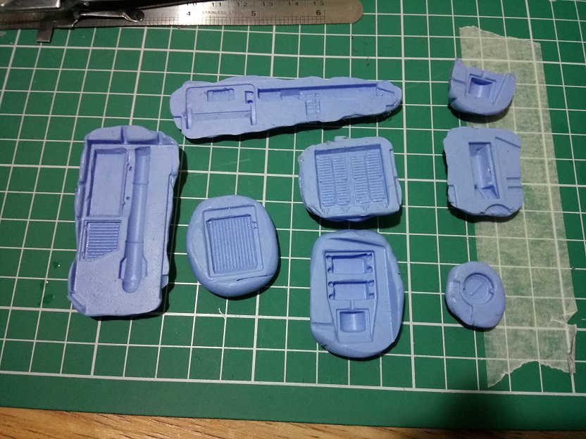

I also cast a bunch of the sealab parts to avoid the problem of having to buy 10 more of these kits. These are a bit rough around the edges, but once they're cut down and cleaned up, they'll be perfectly fine. If the Doll and Hobby reissue ever gets released (I have my doubts), and I've not hit the painting stage, I may replace these casting with plastic parts.
What dimensions did you end up with for the lip?
~roughly 3.5mm height and 1mm deep. I make no claims that's accurate to the filming model, but it looks the part and I didn't want to run the risk of damaging the dome by going much beyond those measurements. If the measurements are off by 0.5mm here or there, I doubt anyone looking at it will be able to see that minuscule difference unless you go at it with some digital calipers..
I’ve printed some copies of these Maruska GrabCad parts and compared them to my Masterpiece Models resin castings of the SeaLab kit parts and they line up pretty much 100%. I used a few, scaled down, on my MPC X-wing inner wingpits.
**Which sets off a TON of alarm bells as I understand that usually resin casting can result in casted parts shrinkage of 2-3%***
I believe the slower the resin the less the shrinkage, but I think you're looking at 1% shrinkage with fast resin that has only 30 seconds pot life. Smooth Cast 310 with its 15-20 minute pot life only shrinks by 0.025% (supposedly).
I use smooth cast 300 and 310 depending on what I'm doing and what kind of mold I am using. I see no measurable shrinkage.
I did download and evaluate the sealab STEP files and compared them to measurements of parts from my real kit and found the STEPS to be too small. Length and width were very close, but the thickness was quite a bit too small.
They're also missing details like the little torus' on top of parts 1, 1A, 4, and 4A. And obviously they're missing small things like the part numbers and any small imperfections like sink marks.
At the end of the day I can cast all the sealab parts I need in 1/10th the time it would take me to 3D print them, and they're more accurate.

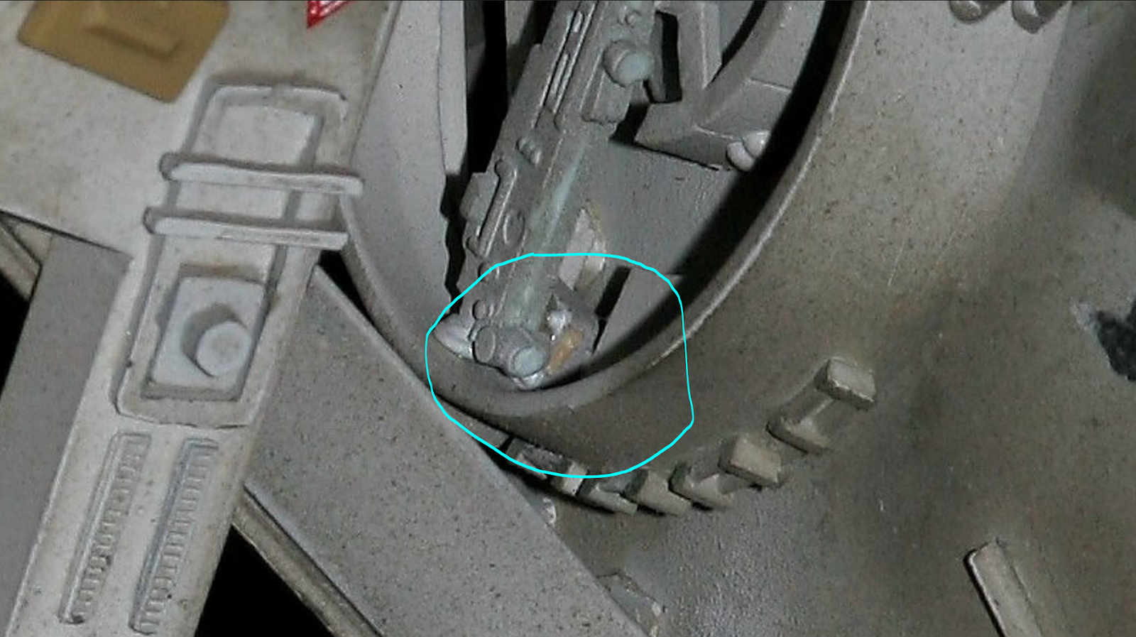

A question for the little greeblies from these kits that are used on the radar dish, do those parts also get used in other places? I just need to know if I need to cast those parts or not.
Finally arrived today. This build involves more time waiting on things to arrive than time actually building. Anyway, it'll be nice to be able to make some progress now.
Careful with Stug #D104, if I count right you need 6 on the radar (one a bit hidden) and 3 in one of the big pits. Only 8 in the kit, so you need to cast one eventually.

Sorry, no Panther G on the Radar. I'm also working on the lower port side walk way and there are two Panther G parts there that I haven't found used elsewhere, so I think I'm okay to use those two parts without casting.
Thanks for the info on D104, I'll make a cast for that bit.
