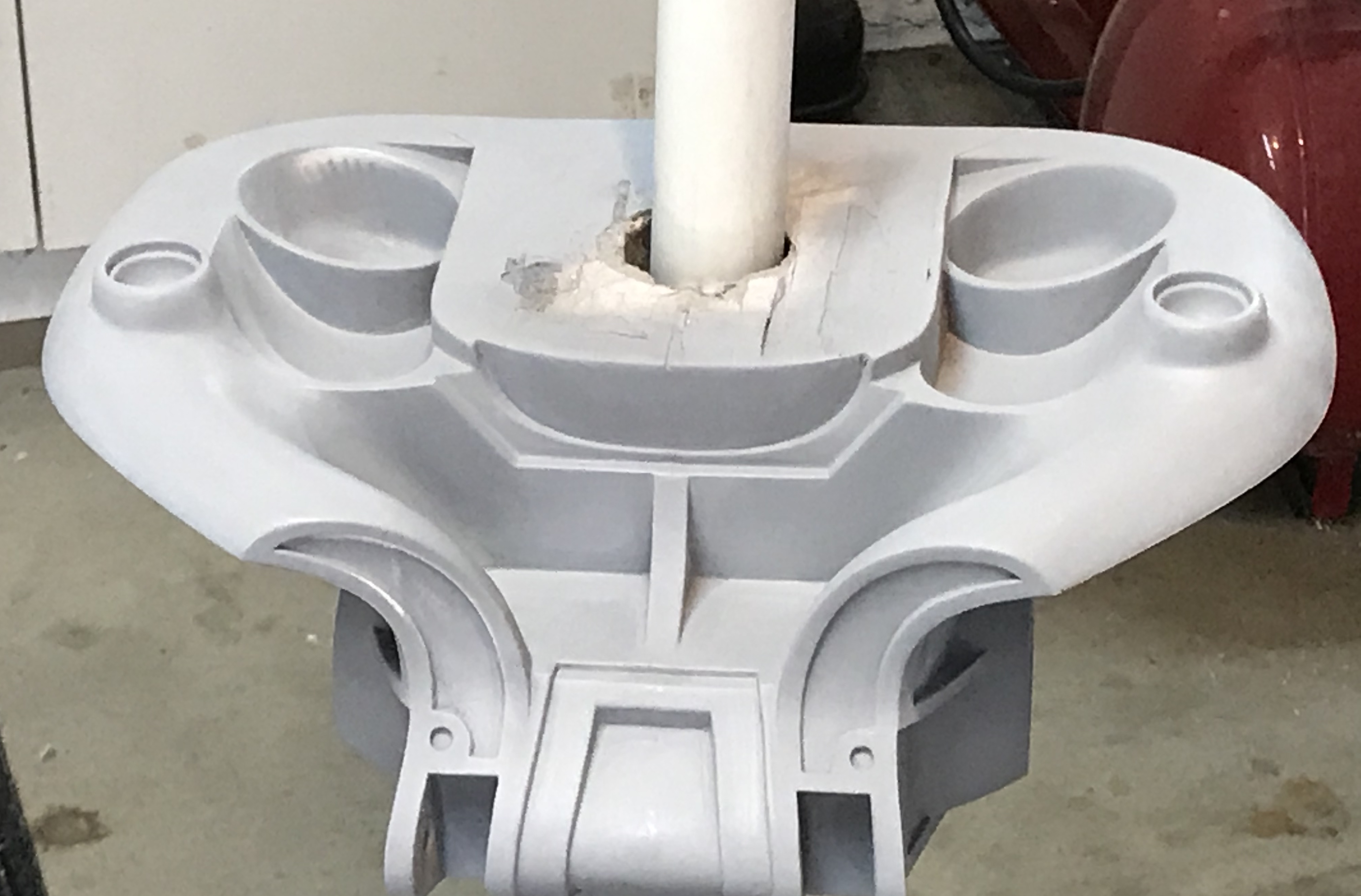

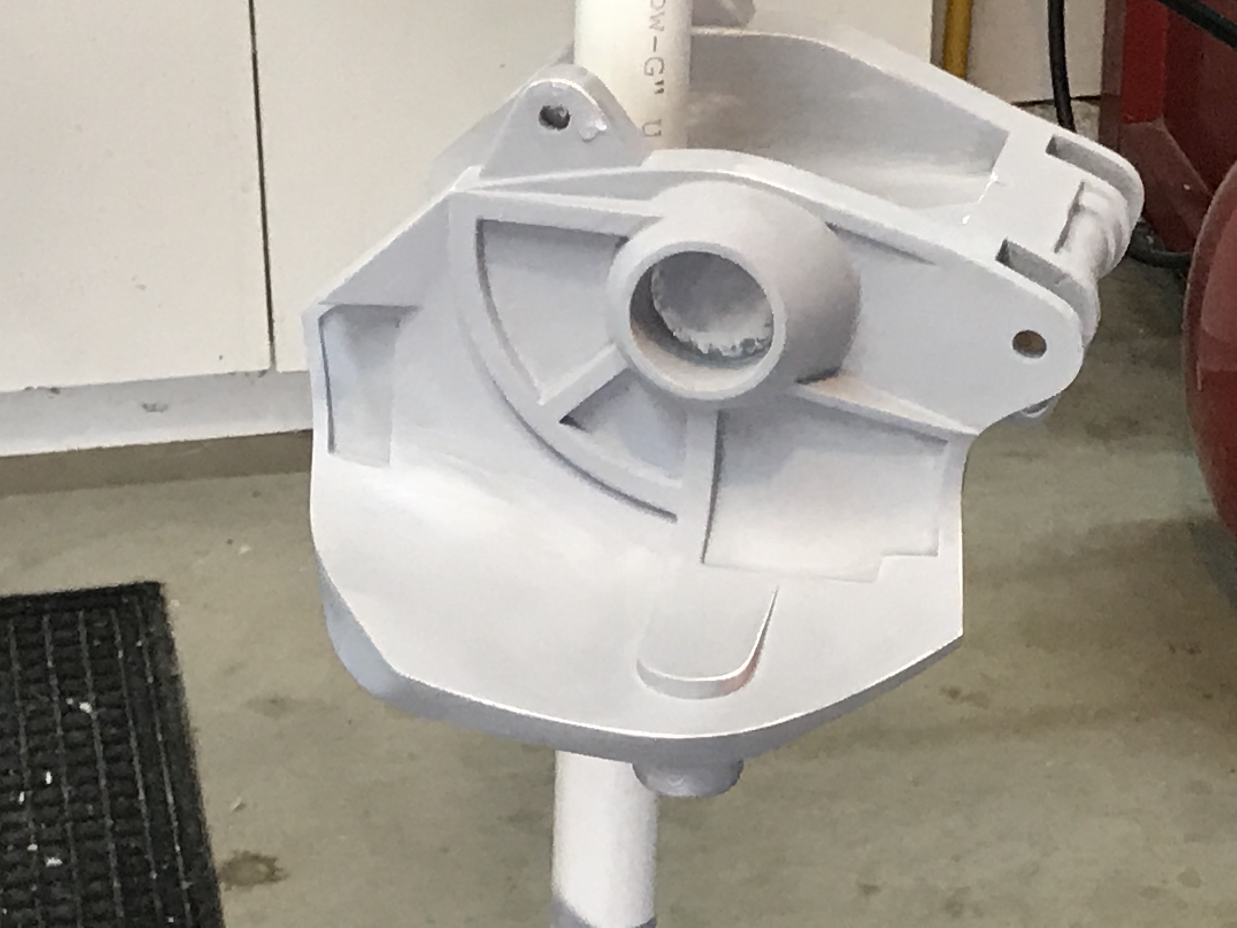

I have spent a lot of effort sanding and priming, and more sanding and more priming to get to this part.
I have the hydraulic cylinders to finish, but thus far, this model has gone together very nicely.
my big worry is fragility. If this were tipped over, all my work would be gone at the speed of gravity!
but here is the current status. This has been a life long dream, and I am
finally At a point that I can look at it and see my dream coming true.
but here is the current status. This has been a life long dream, and I am View attachment 1306646finally At a point that I can look at it and see my dream coming true.

Holy Poopzilla! I am having a “Face Palm” moment!
I poured the last of the resin into the pelvis and slushed it around. It was a small amount and I wanted to throw the bottles away. The resin coated the interior of the 3D print. This made the shell thicker in 5 minutes rather that taking hours extra to print. It wasn’t solid, but I also had some left over 2# expanding foam, and added some.
The pelvis is now solid and I can work on it.
Why didn’t I think of this first?!
I should have done this to all the pieces from the start! I would not have had the worry of each piece being so fragile
here is what I have learned from this:
this model is strong enough to support itself if you backfill the 3D print with resin and foam (please be careful of expanding foam in a confined space! Be sure to drill 1mm escape holes for venting, and do not over fill)29CEF568-2A6A-4E5C-A224-B9B4EDEDD9FE.jpegAC46C0AA-63D9-4DE3-9992-87C79AB2C723.jpeg
