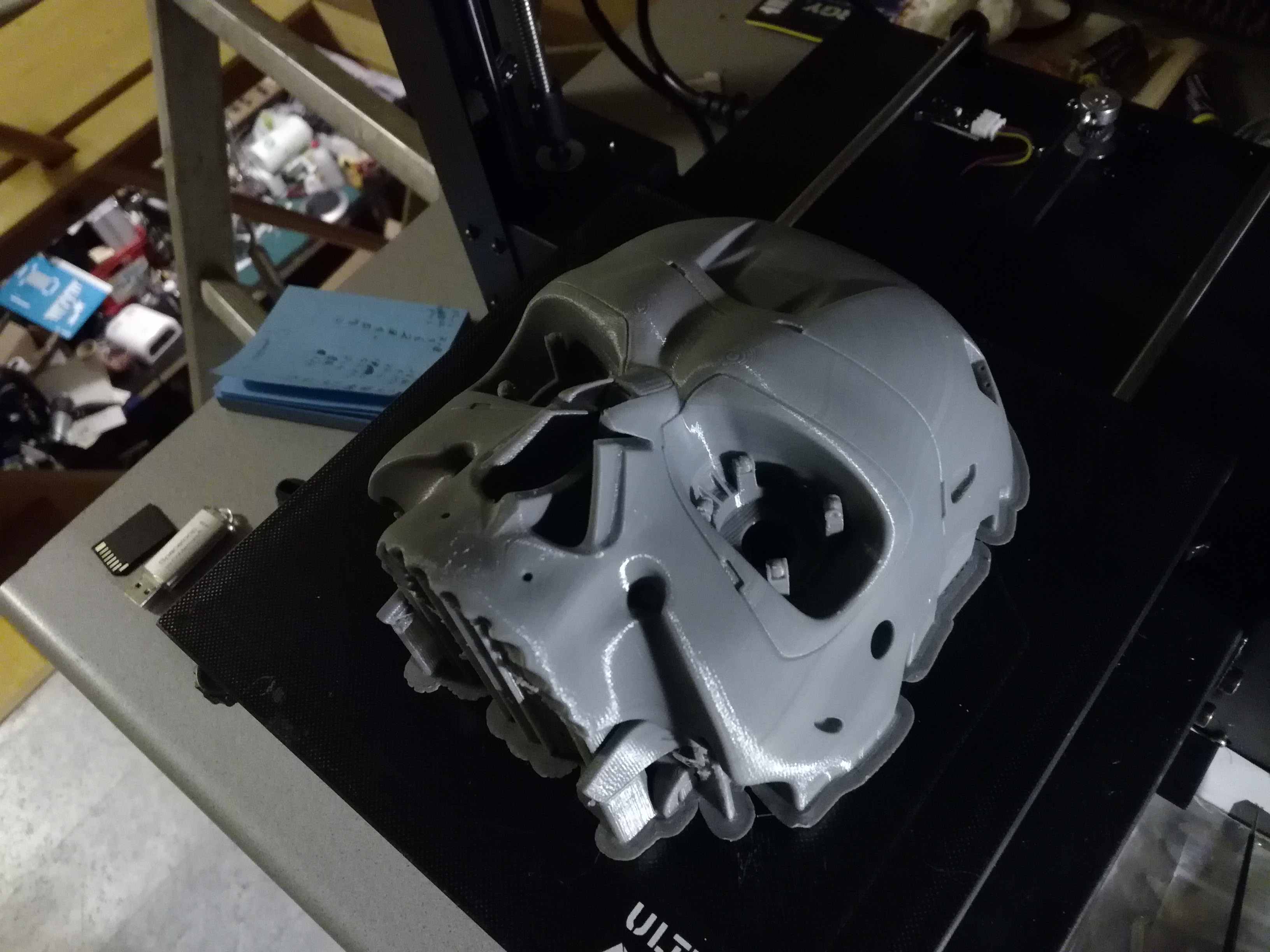

3D printing a 1:1 Terminator T-800 endoskeleton
Awesome! So you already finished the 1/1 endoskull?
Could you post some closeups of the skull? ...I'd be very curious on how the panelines and finer details come out..
Which layersize do you print this on? I'm planing on using a very fine resolution (like 0.1), but the skull alone will propably print hundreds of hours on this resolution...

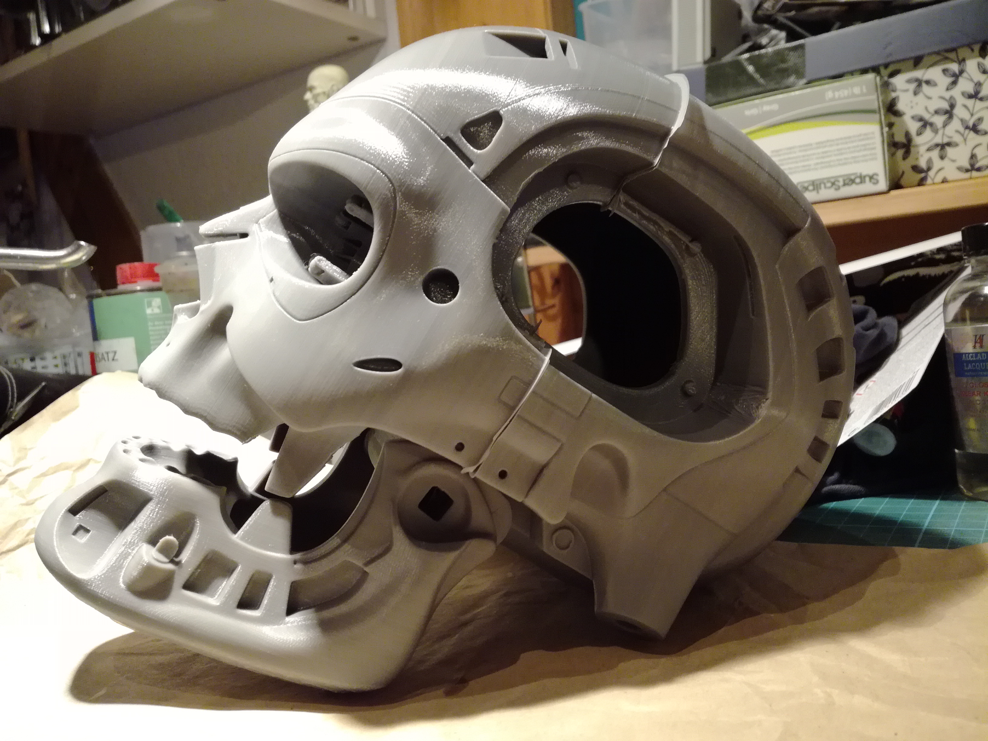

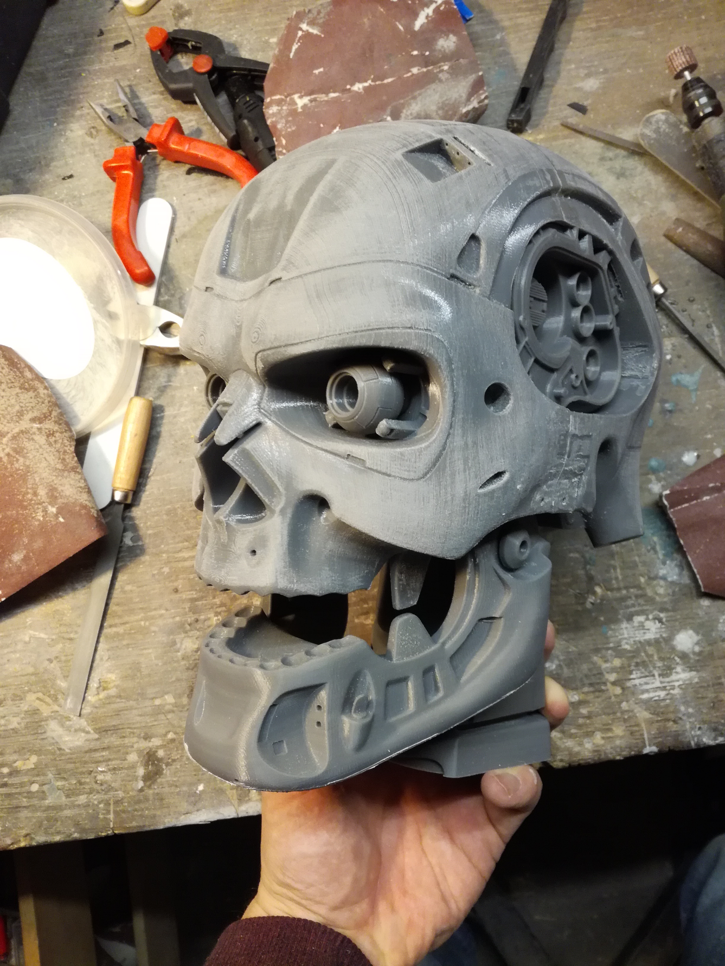

Here is a close up of the skull. The panel lines are faint and need to be scribed for better clarity, but they are there. I have heard mention of the two small holes under the ear to be reminiscent of the M1 skull.
Sure, there are things that could be made more accurate, but over all, a fine piece that is going to take some finish work, but has a large range of possibilities.

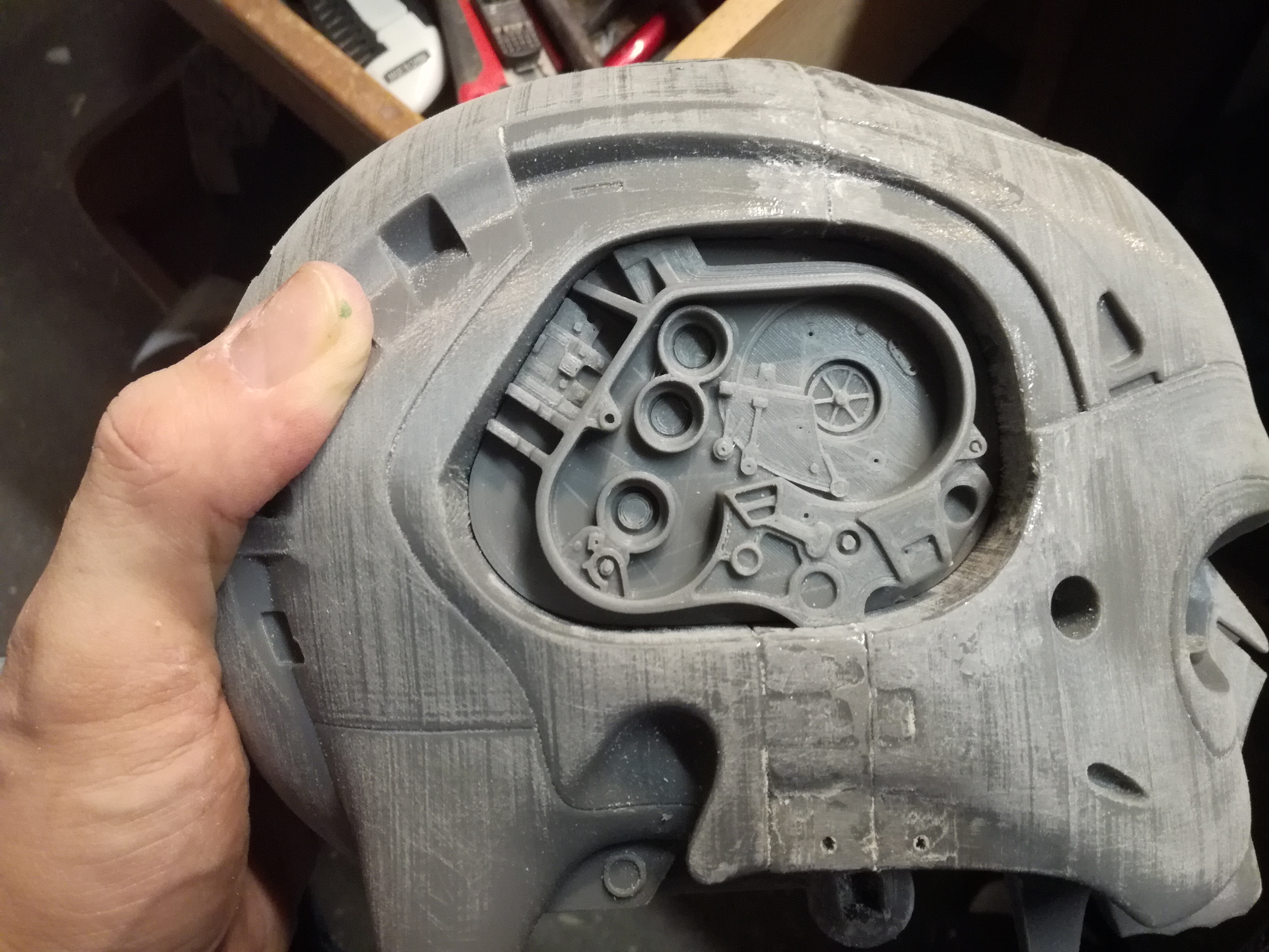

and I have a close up of the should assembly and a few questions. The outer ring of the shoulder gearbox, isn't it raised? This model has a line there that I had to use a pencil so it would show up in the photo. The other question is where there needs to be vents (marked in red) on the cylinder on the motor. I think they need to be added.
This helped a lot, actually. Thanks!

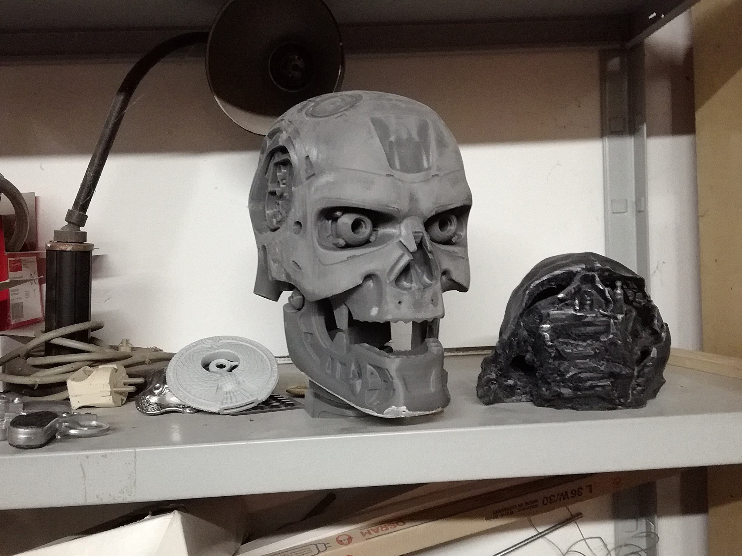

Cool. Is it just the picture or does the skull look a little narrow?
I am no expert, but as compared to my Sideshow endoskull, Yes, it is by up to 10 mm. As I complete the whole structure, I will see about making modifications. Right now, I am slowly getting pieces off the printer. The parts look very nice thus far and I haven't had any printing problems.
