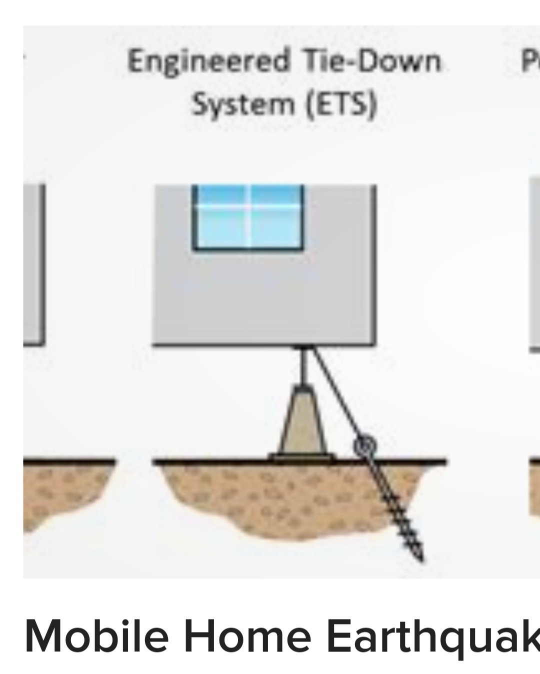

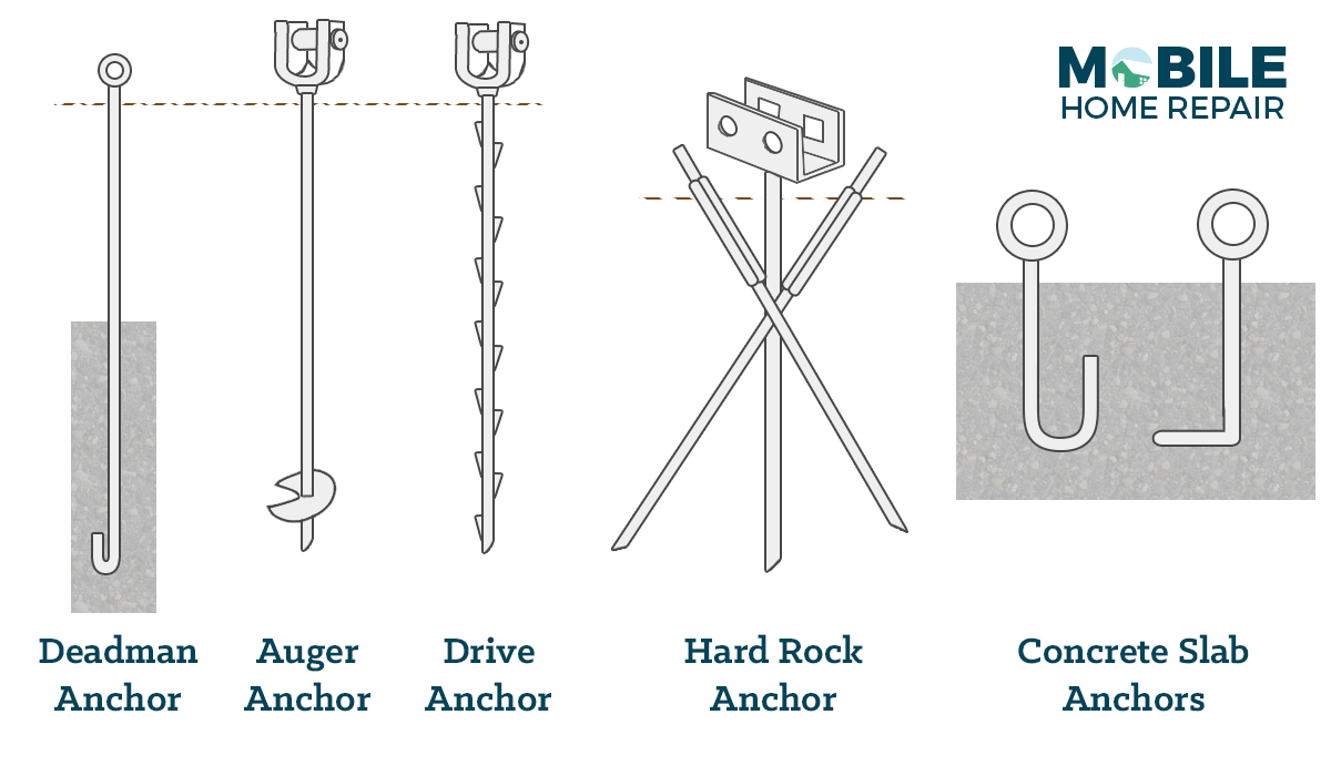

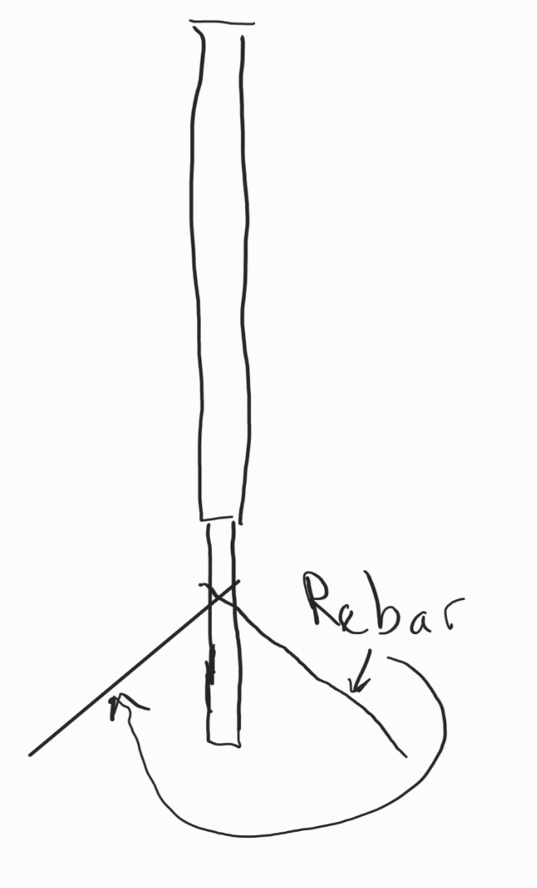

Alan, you said cheap and for me that is like calling the genie out of the bottle. Anchors are your friend. Any rebar, pipe or other that will not rot. Place at 45 degrees into the soil next to the post holes. It works well if attached as a push or a pull. Push need to be touching the post in its final position and attached to tge post with a plate, wiring or similar. Pull is using that common telephone pole guide wire method. Dollar tree dog yard stakes are ridiculous cheap compared to how strong they are. Screw them into the soil and then cable the head to your posts. Also Dollar tree on heavy metal dog lead cable for dog runs. All of these ideas should be able to be submerged completely and attached to your posts at a below ground level. I'll try to get some pics.
Also, more trees or less cutting of the surrounding trees is going to be another wind deterrant but you likely already had that in mind when you picked the spot.
I would like to see a photo of artwork showing your design
The pull style is the same for telephone poles and homes. The stake, the plate and the cable. Yours will need some form of tightener.
The types of steaks vary but the dollar tree has several variants on the cheap. In pets they have the screw type yard stake for dogs. In seasonal, there is the twist in stake for yard flags and the twist in stake for anchoring garden weed barrier. You are looking for any of these:
or this
A tightener (turnbuckle) like this for adjustments but not totally necessary:

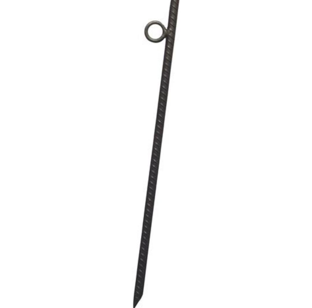

The push style is just driving a rebar or similar past the post at 45 degrees but leaving enough of it snugged up against the post to fasten directly to the post.
Something prebuilt like this is a few dollars at lowes and home depot but can be driven past the post and bolted directly to the post through the welded loop.
Both are very secure but neither makes the post itself any stronger so any wind strong enough to snap the actual 4x4s will do so regardless.
Usually called earthquake or hurricane kits, all the parts are just stronger versions of pet yard anchor systems:
Hurricane kit:
dog anchor kit:
So for something much smaller than a home, the dog kit should suffice if secured from the main loop and not that silly side link.

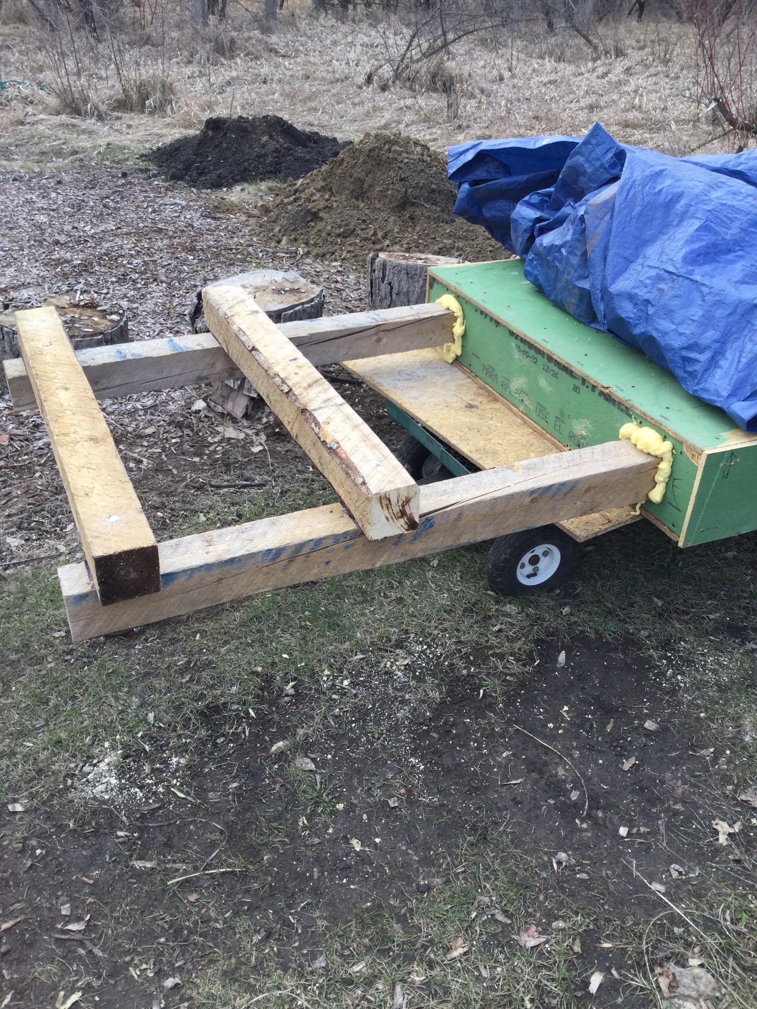

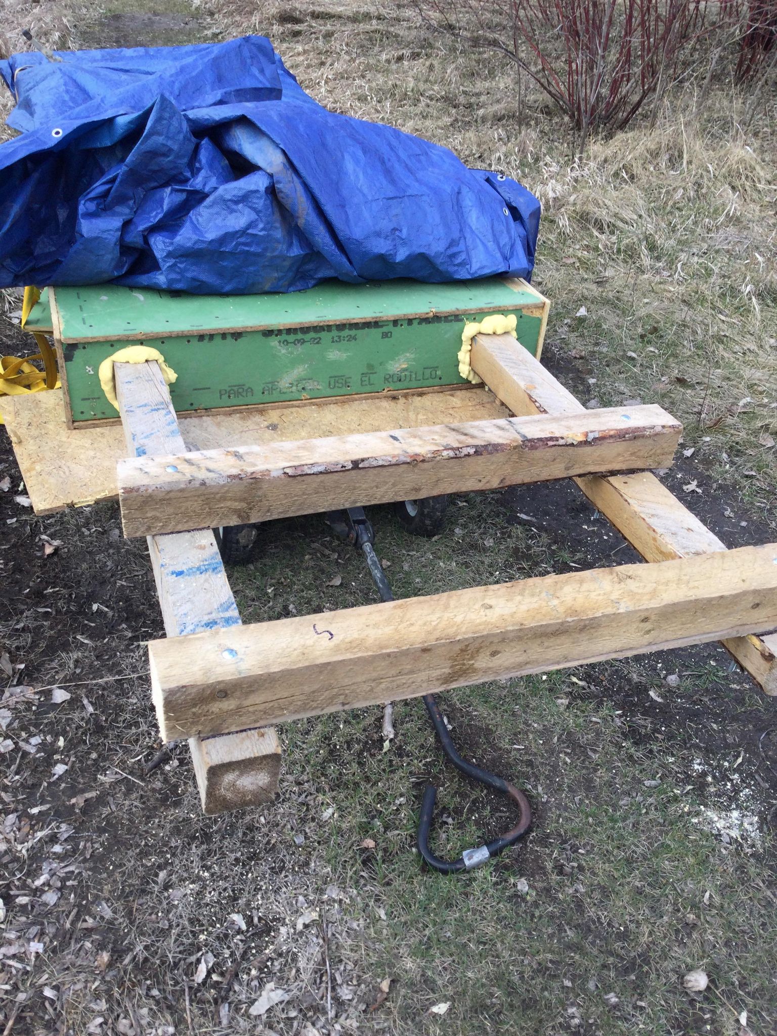

Today I bolted two 4X4s to the "legs" as a means to hold them in place while the whole Monolith is standing on the legs as the cement is added .

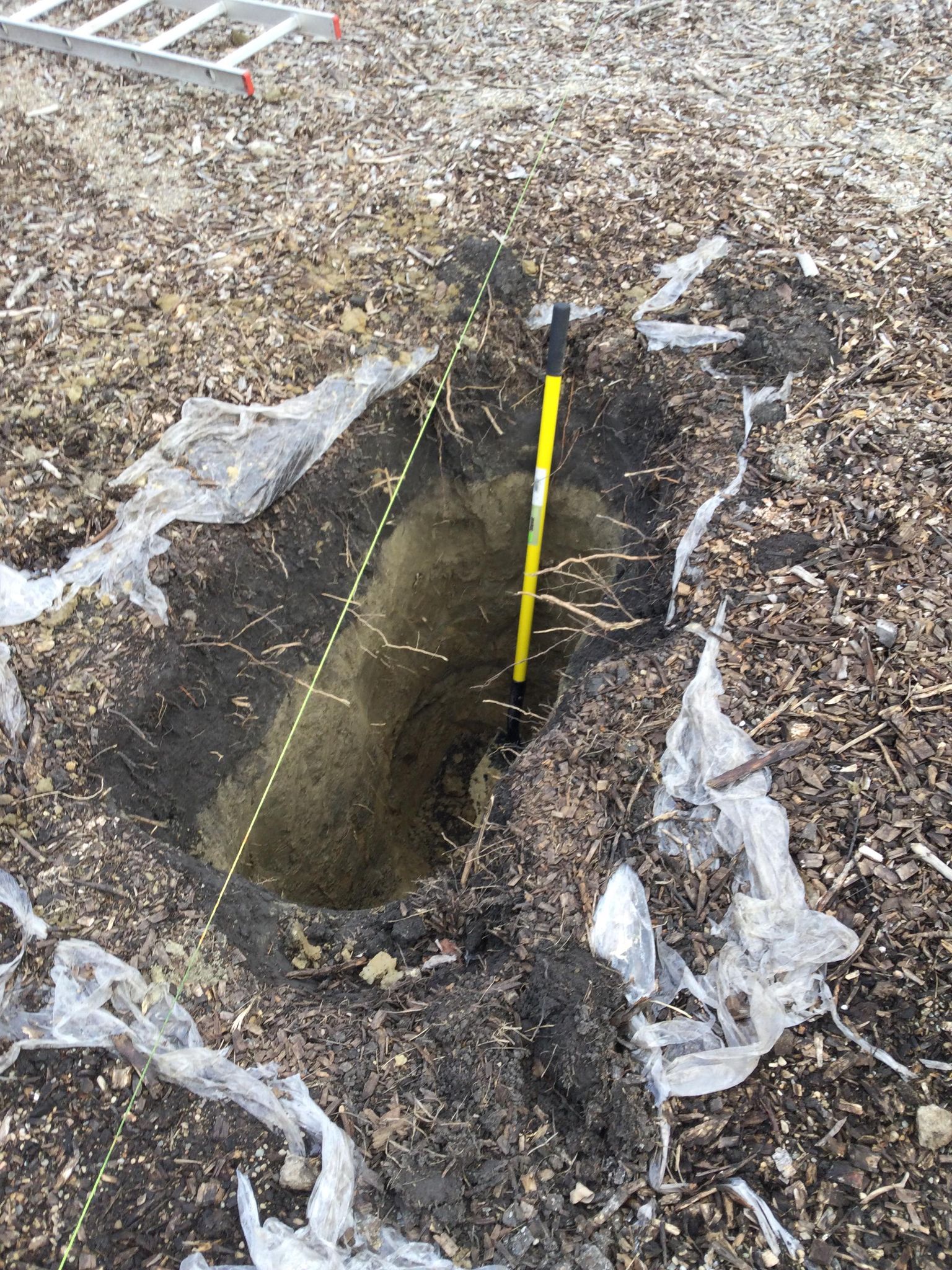

But Before the rains hit here I was able to get the trench dug to a depth I needed.
its about a little over 5 foot deep....and a little over a foot wide.
My brother was able to mark with a string the angle that the Monolith will be positioned.
The string represents the direction where the most wind comes from in my part of the State.
This will mean that the Monolith will have the narrow side faced into the wind.
Everything is wet, and so Im not about to jump down into the trench and finish digging the trench for a while.
