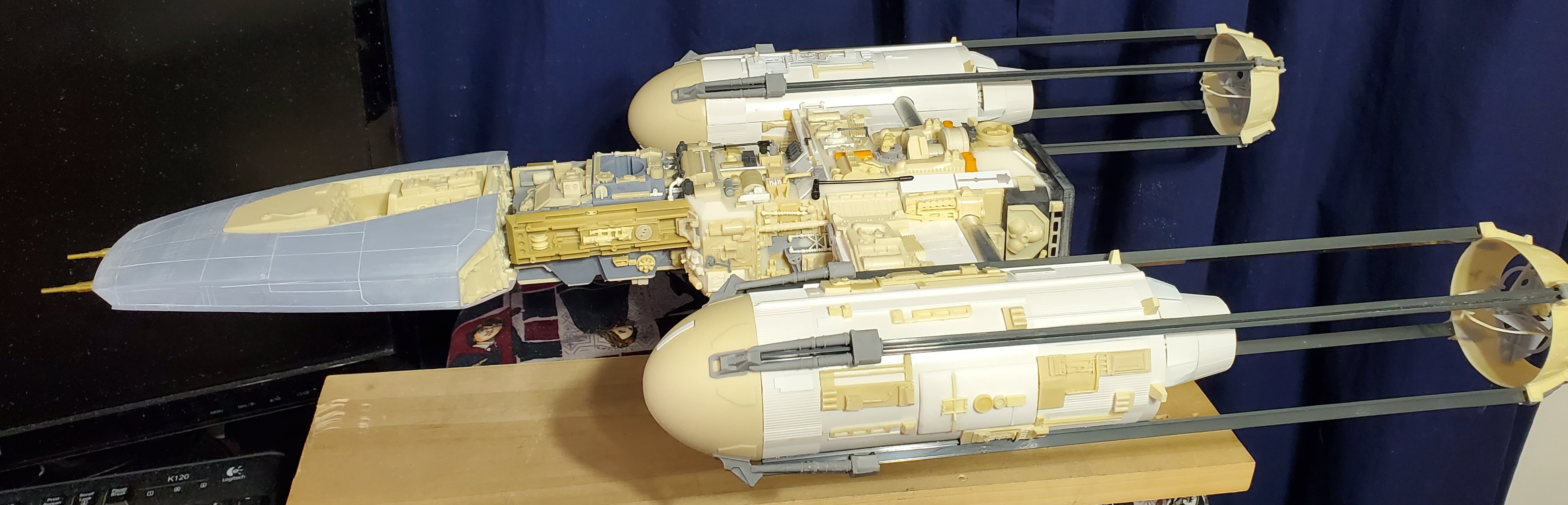

Y-WING 'Gold Leader' Studio Scale Build by dtssyst
It has been redone...
The back end (battery cover) is a lot closer to the Gold Leader version now.

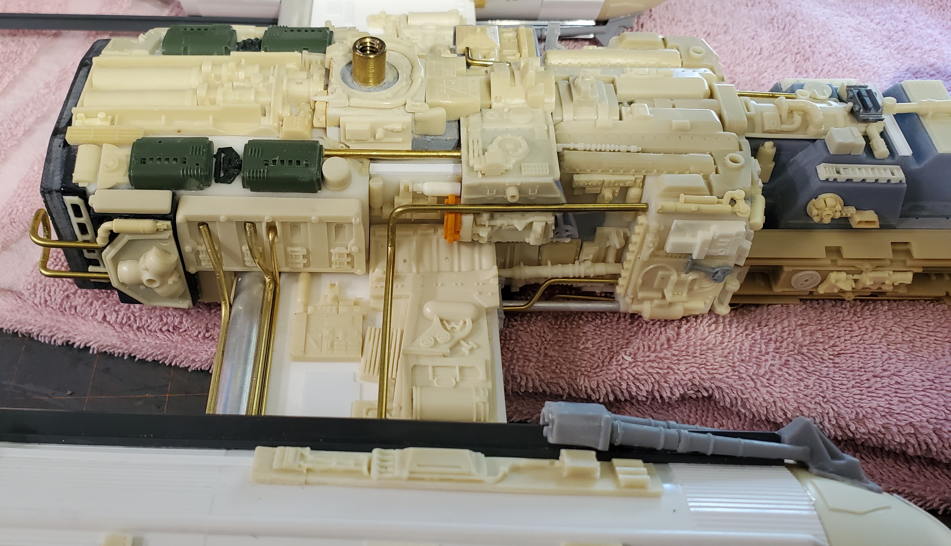

Guns made and installed. I tried to make them exactly the same as seen on my red jammer build.
Took a lot longer to do than I originally anticipated.View attachment 1663467

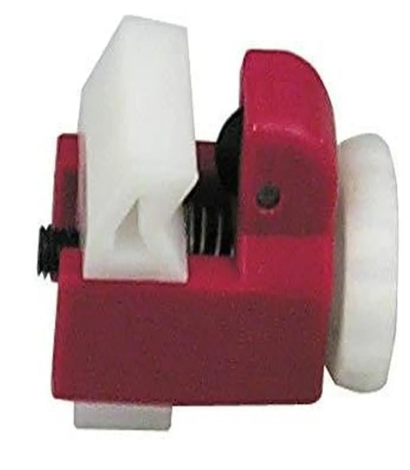

This is looking good! How do you cut your small brass tubes? & can you recommend the best glue to use on the sections?
I'm making some of my first brass guns at 1/148th scale. My hack saw is not gonna work! My dremel is not the best solution. I need a new tool to make very clean square cuts of small brass tubes with no scratches & no clamp marks.
Xacto knife. Kinda roll the tubes back and forth under the blade.
Jkirkon I blade cut 1/8" brass and it worked better than I expected. I cut plastic tube that way but assumed it wouldn't work on brass, but it does. Thx. swgeek Perfect, like a mini plumbers pipe cutter, and they cut 1/8" / 3mm diameter. I'm getting one!

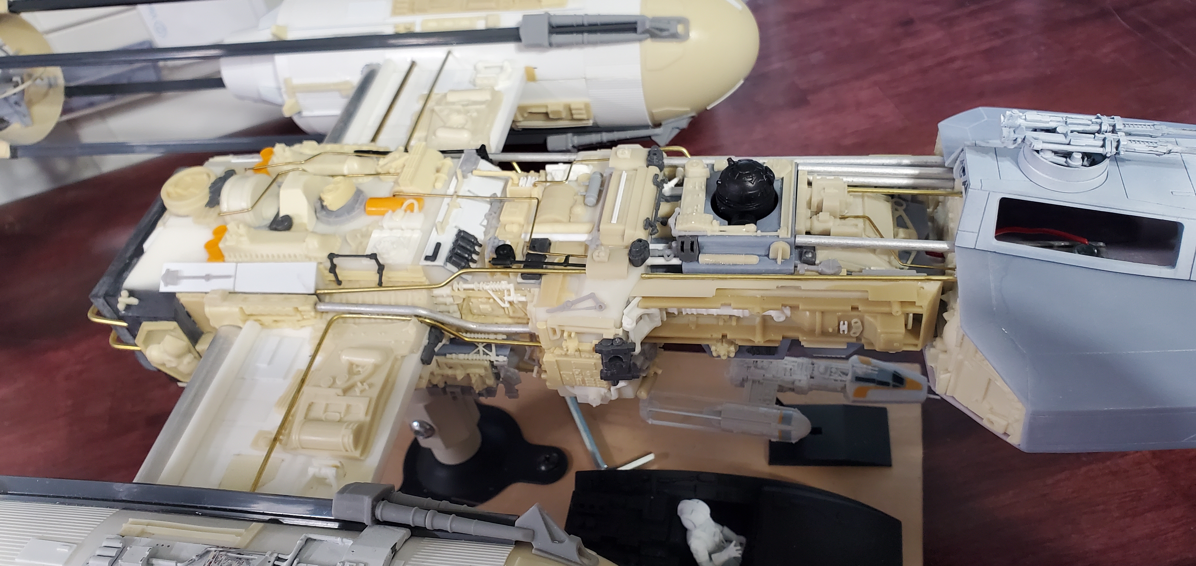

Pipes in process.
Still loose not glued...

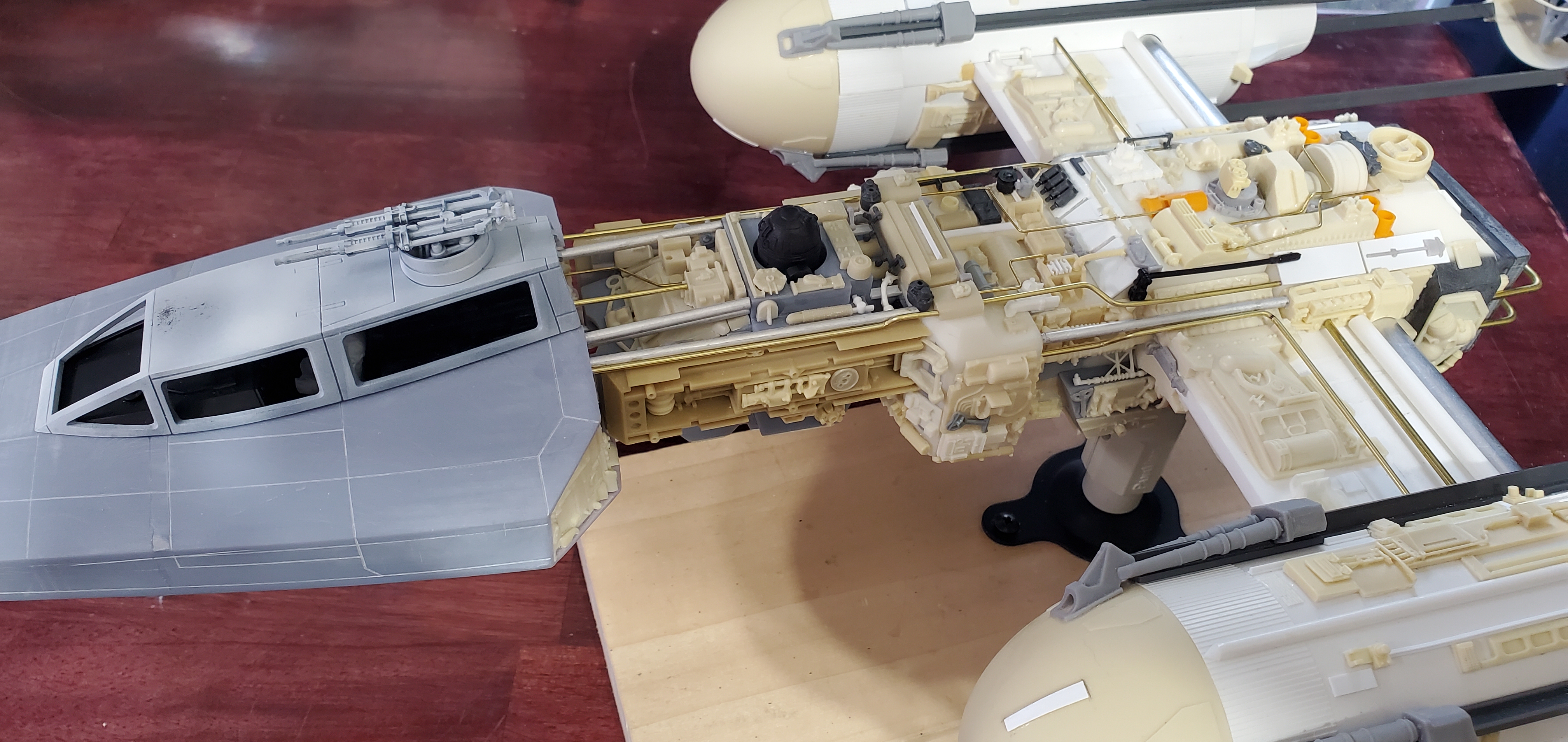

Gun assembly attaches to canopy using a small magnets.
Cockpit in process of lighting.
Droid in progress of being painted.
