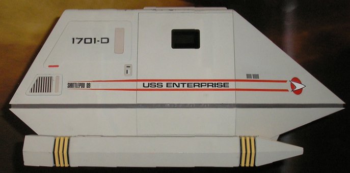

Type-15 Shuttlepod from Star Trek TNG
Can anyone identify the source of the isolinear chip storage unit in the aft of the shuttlepod? This was only seen in The Minds Eye. It does not appear to be scratch built but something commercially manufactured that has been redressed.

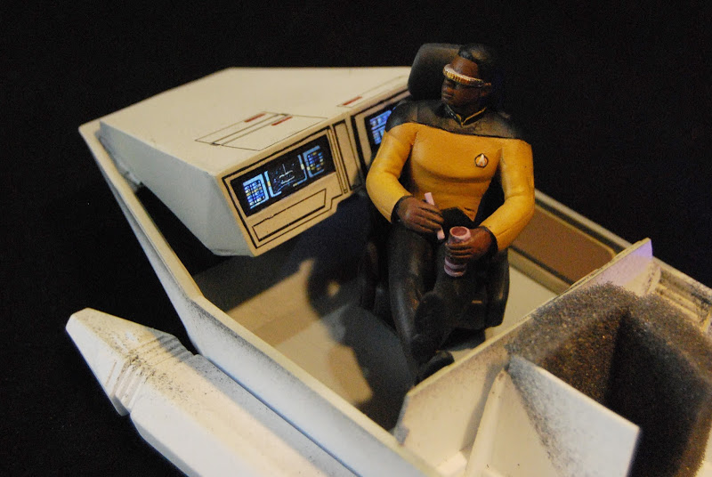

Regarding my LCARS, I see they have been used by a modeler called "The Eye of Error". (He didn't give me direct credit but did say that they were "great" LCARS he found online. I'll take the complement.) He did a fantastic job with his build and the LACARS look outstanding backlit in his model. (I hope a preview of things to come)
Shuttlepod_Finished_11.JPG Shuttlepod_Finished_10.JPG Shuttlepod_Finished_08.JPG Shuttlepod_Finished_15.JPG Shuttlepod_Finished_16.JPG
You can check out his build blogs at All Scale Trek or Tyken's Rift. Well done The Eye of Error.

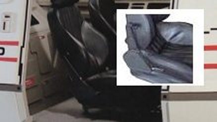

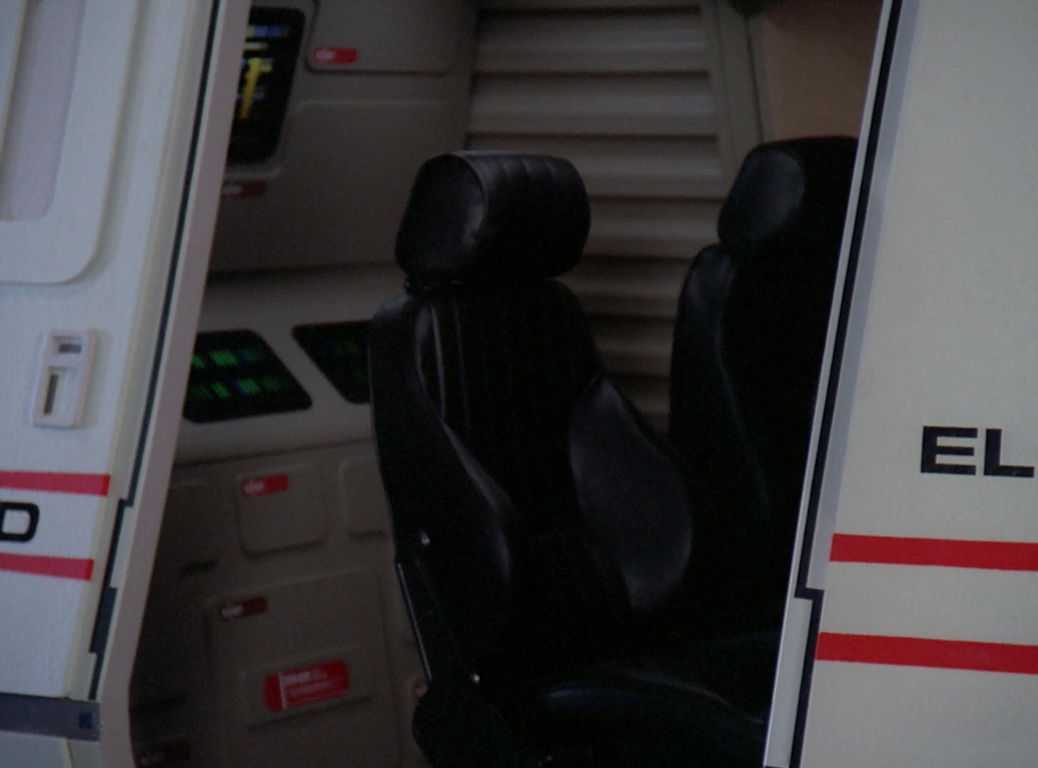

After an extensive web search of images I manged to positively identify the seats used in the mock-up.
They are Procar Rally seats from Scat Enterprises.
One of the identifying features of this seat is the unique reclining mechanism on the side.
The good news is that Scat Enterprises is still in business. The bad news is that they no longer produce this version of the Procar Rally seat. I contacted them and was told they changed suppliers. The current version no longer has the unique reclining mechanism.
There are some subtle dimensional differences the previous and current versions, but I don't think they will be noticeable.
Aside from the absence of the unique reclining mechanism the most noticeable difference is in the vertical seams. There were originally seven vertical seams in the original seats used in the mock-up and the current versions only have six. The vertical seams in the current version also appear wider. Unless I can find a better solution I may have to settle for the Procar Rally. Apparently this style is trademarked by Scat Enterprises.

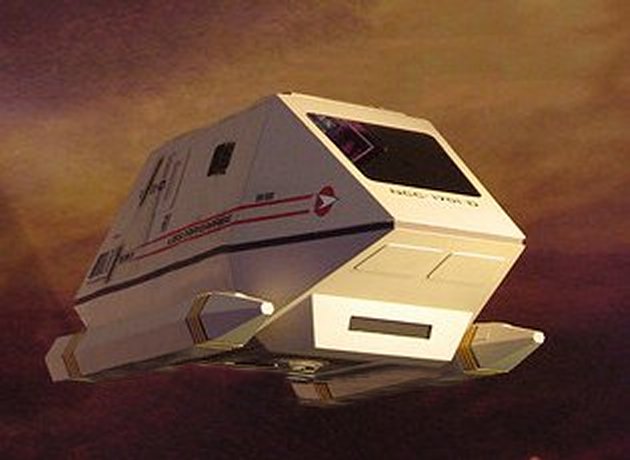

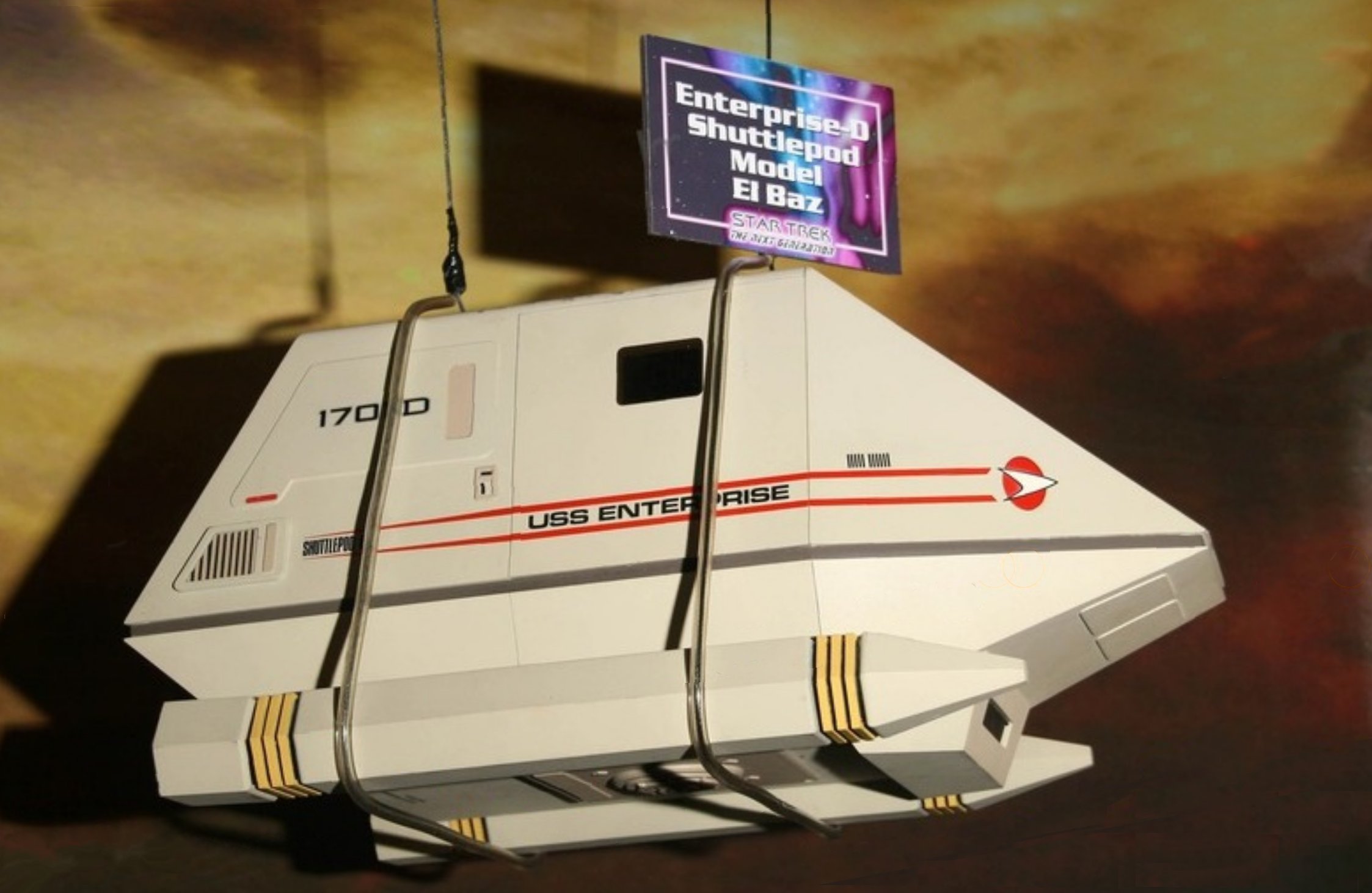

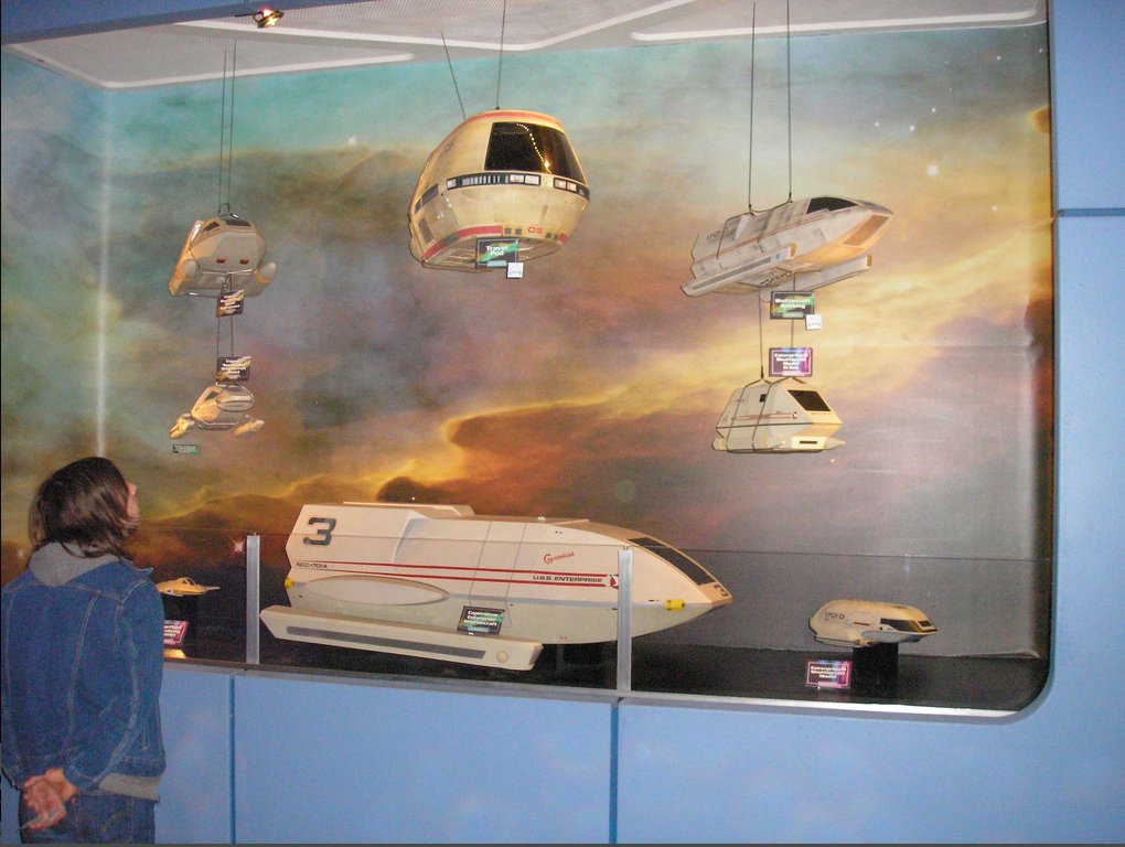

I have located some additional images of the filming miniature. The best ones so far are from when it was on display as part of "Star Trek: The Tour" in Long Beach, California around January 2008.
My first impression was that this is a terrible looking display. The way the models are suspended with vinyl coated wires and foam-board signs looked amateurish and not museum quality. It did however produce a fair view of the underside of the model, except what was obscured by the wires.
I was able to edit out most of the wires and get a few good images.

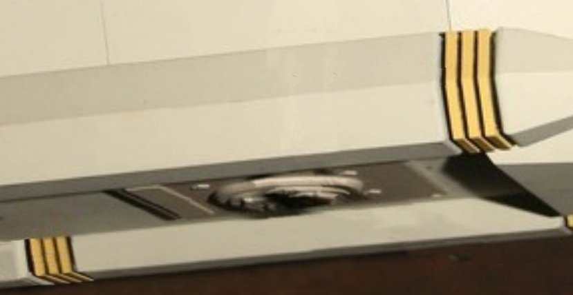

Keeping in mind that the original mock-up was in 4 separate pieces, the fuselage, the two nacelles and the wedge under the bow that was an afterthought to hide the casters under the fuselage.
For whatever reason the stage crew did not always assemble these pieces in the same configuration. The nacelles of the mock-up had no physical connection to the fuselage, they were simply laid next to it. The nacelles did have left and right hand versions which were sometimes reversed during assembly. Their position along the fuselage was not consistent either, sometimes they were placed further forward, sometimes further back. The bow wedge was sometimes placed upside-down compared to others. The miniature has a fixed configuration for the nacelles and the wedge. I am using this to eliminate any ambiguity during the assembly of the mock-up. Sometimes there would be variations in the same episode, i.e. Times Squared where both the wedge and the nacelles were reversed later in the episode compared to the beginning.
The miniature also shows how the nacelles were to be attached to the fuselage using pylons.
The miniature also has a detailed underside which shows a plant-on similar but not identical to the one on top and it shows the backside of the bow wedge.
It is assumed that the original full size mock-up no longer exists, so I consider the miniature as the de facto standard for any external details that can not be established from existing images of the full size mock-up. I am using this to establish which nacelle is the right and left hand, the position of the nacelles and the configuration of the bow wedge.

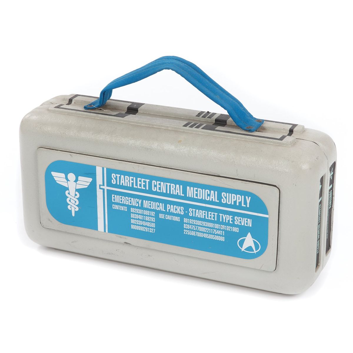

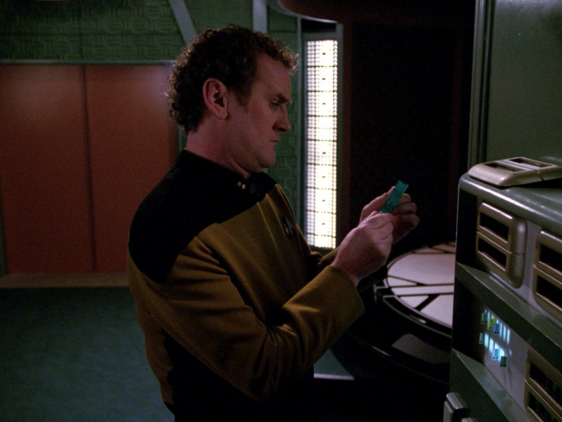

PyroJockey. I was doing research for the star trek medical case. The cover was the end piece of the cause. The iso cover was used in the transporter room on TNG. That area where the iso where in the transporter room. Was originally used in TMP as a medical station. The case where put in there. (If you look in TMP before ilia breaks the door, while Kirk Spock and decker are talking, in the background you can see it.
anyway...the case below was used and it not a found case it was made for the movie. Its fiberglas. Message me. I have more info that can help.
Hi Joe. I managed to get a reply from Rick Sternbach on trekbbs.com about this and he wrote:
Rick Sternbach said:
the rounded-corner "cover plate" actually goes back to ST:TMP, as one of the longer pearlescent silver storage cases that I made blue labels for (CTYO STORAGE - ANDROMEDA STRAIN). You can see people carrying those cases in TMP and maybe WoK. The storage cases would slip into racks, and only the ends would be visible. Somehow, the ends of the original big cases were "mis-identified" or deliberately modded into cover plates for chips and other widgets.
I assume he was referring to the same case as the one you pictured.
Thanks to your tip I found instances in TMP and TNG where they were used on the same prop, just repainted.
I don't believe these came from any commercially available product and were probably vacuum formed. I don't currently have access to a vacuum former but they are easy enough to make. I do have access to a large industrial laser sintering type 3D printer.
Thanks again for the tip!

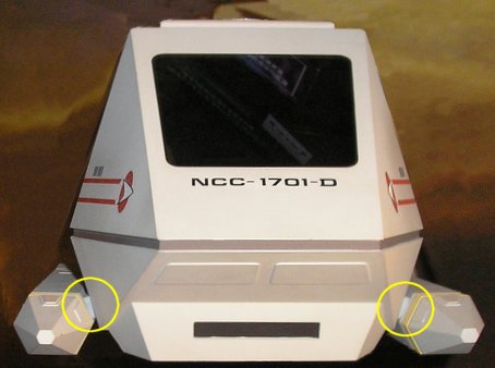

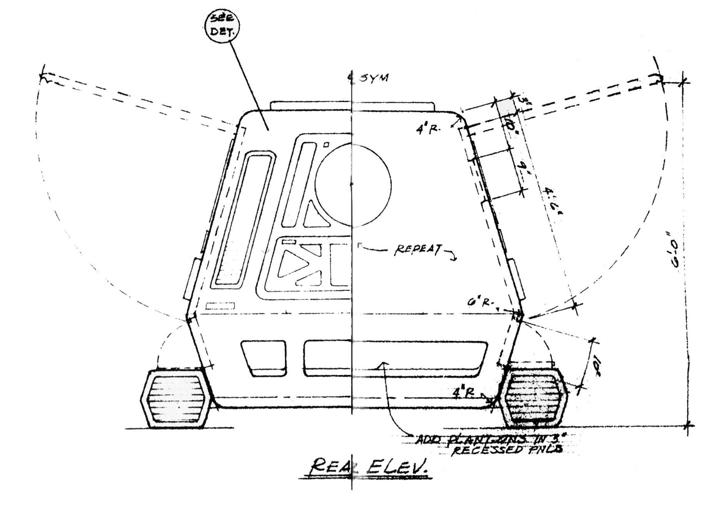

I'm not sure what the link is supposed to show, but you are correct in that the hinges on the port and starboard upper hatches are not as depicted in the concept sketches. In the sketches they appear to have a continuous hinge (piano hinge) the same as the lower hatches do.
In the actual mock-up they used a more complex hinge arrangement. I have taken great pains to reverse engineer this hinge design and it will be incorporated in my replica.

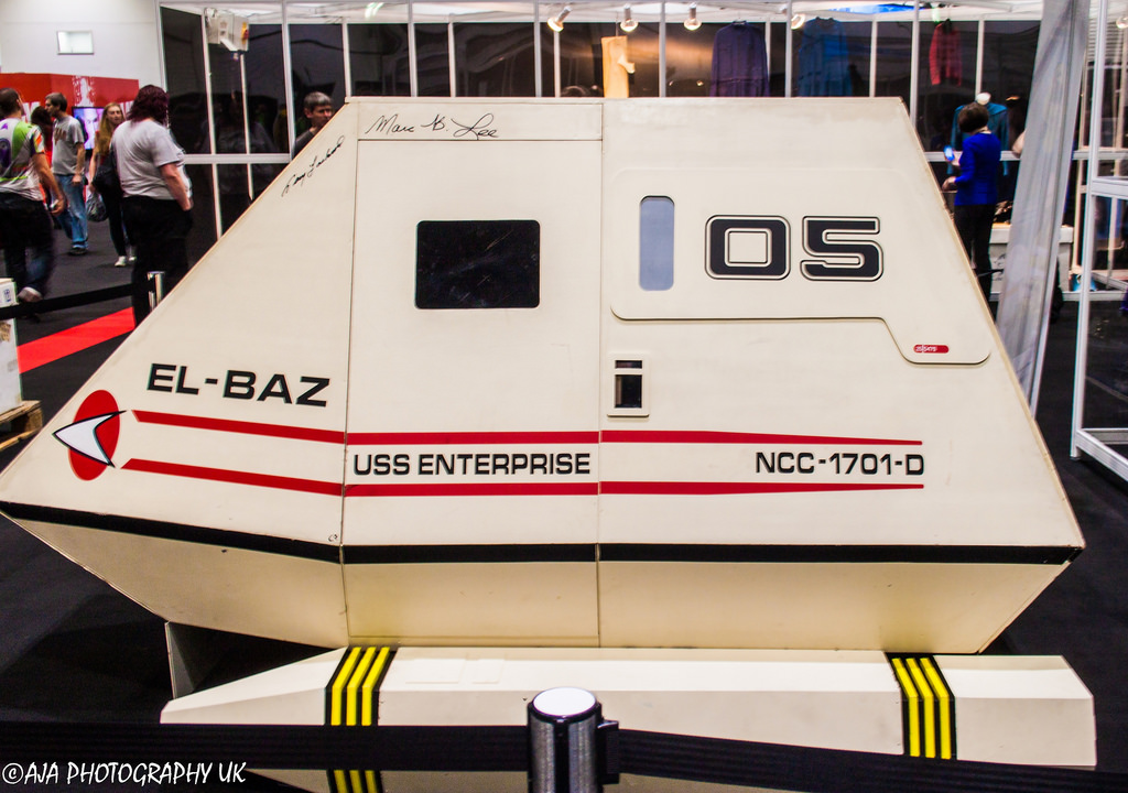

The original shuttle pod seems to be in Germany, owned by uber fan Martin Netter
Photos: Cosplayers of Destination Star Trek 3 + More Pix From Around The Con
scroll down about 1/2 way
This is his site, he may be able to help with references
Filmwelt Star Trek Shop
I have seen this mock-up before and I can guarantee you 100% it is not the original, just a replica of the outer shell. There are lots of missing details and general dimensional errors.
I have seen a few other replicas, such as the Beignet, but I can still tell at a glance it's a replica.
Martin Netter does appear to own one of the original shuttlepod mock-ups from Enterprise.

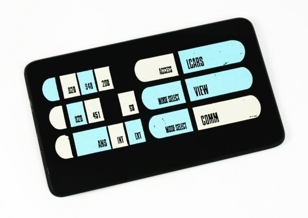

I found this image of an LCARS panel on the yourprops.com web site. It's reported to be a used on screen prop from TNG.
I know many variations of these non-illuminated LCARS plant-ons were slapped onto various sets. This appears to be the same one, or at least of the same design, as the one used on the isolinear storage unit in the aft compartment of the shuttlepod as seen in "In The Minds Eye".

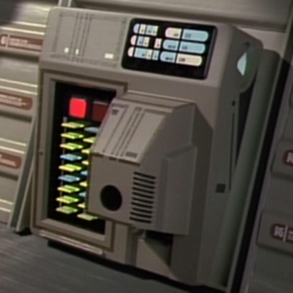

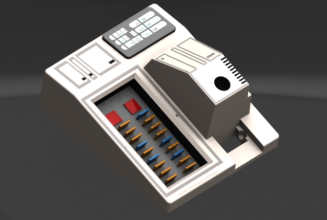

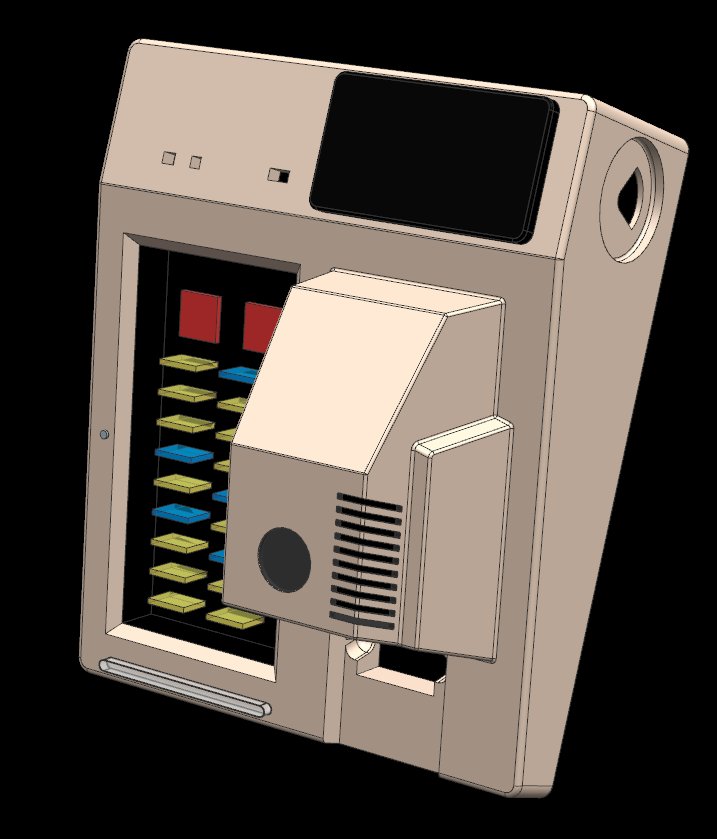

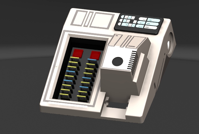

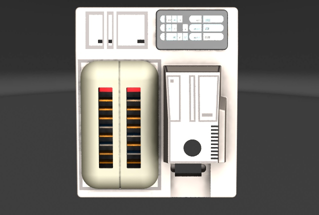

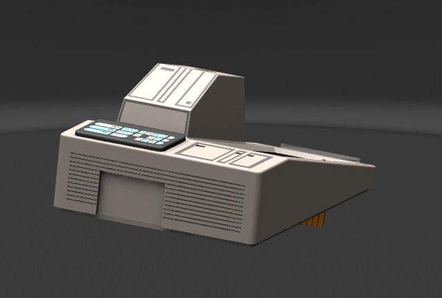

I've made some good progress in creating a 3D model representing the isolinear storage unit as seen here..
This prop was obviously kluged together with whatever odds and ends were available at the time. Esthetically I never liked it, but it is cannon. I did take some license with the cover, extending the bottom slightly so it actually covers the entire opening.

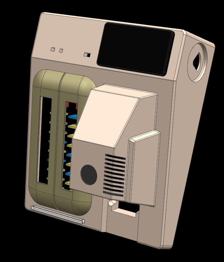

This is what the unit looks like with the cover off.
One of the things that's not obvious from this angle is that the two rows of isolinear chips are not centered in the opening. I may change this in the final version.
I haven't textured it yet, but I'm not looking to make a pretty model. This model is destined for a 3D printer. The others will be used to create the fabrication drawings.

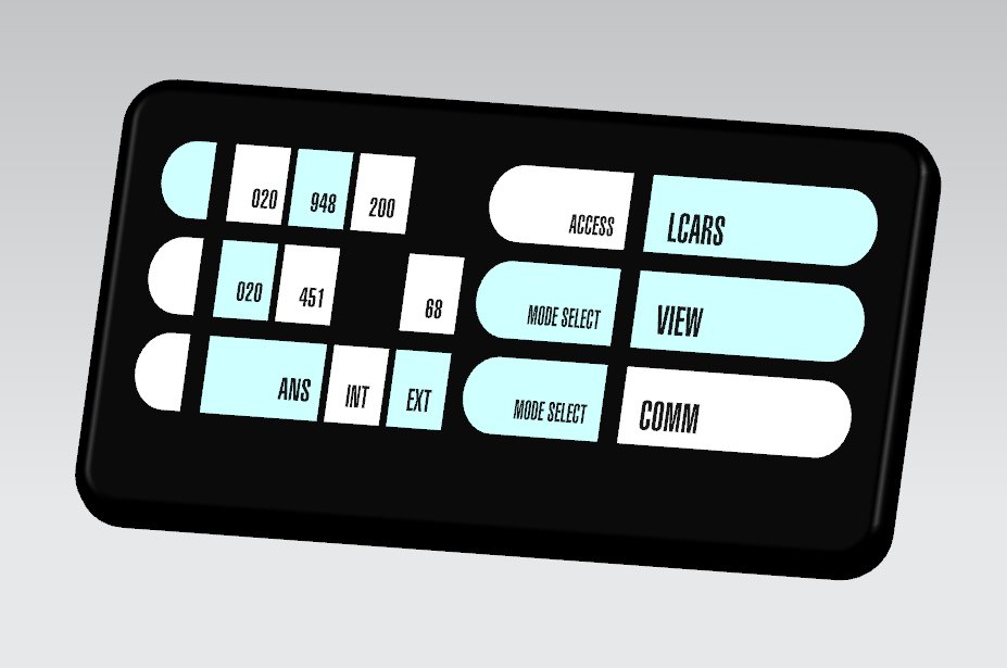

I've done some work on the small LCARS panel too. Below is an original.
Here are my graphics for the LCARS panel on the unit.
And the rendered 3D model.

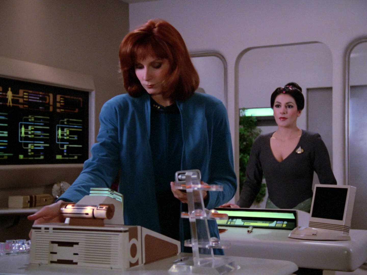

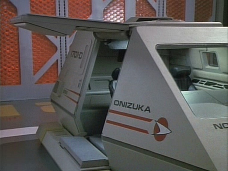

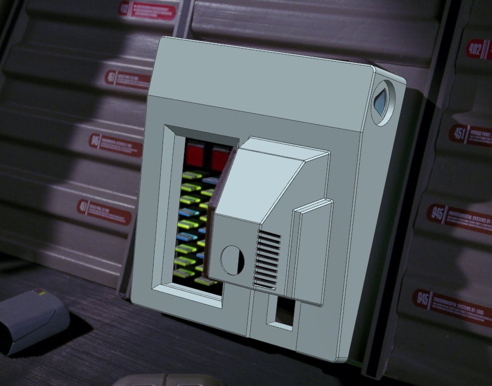

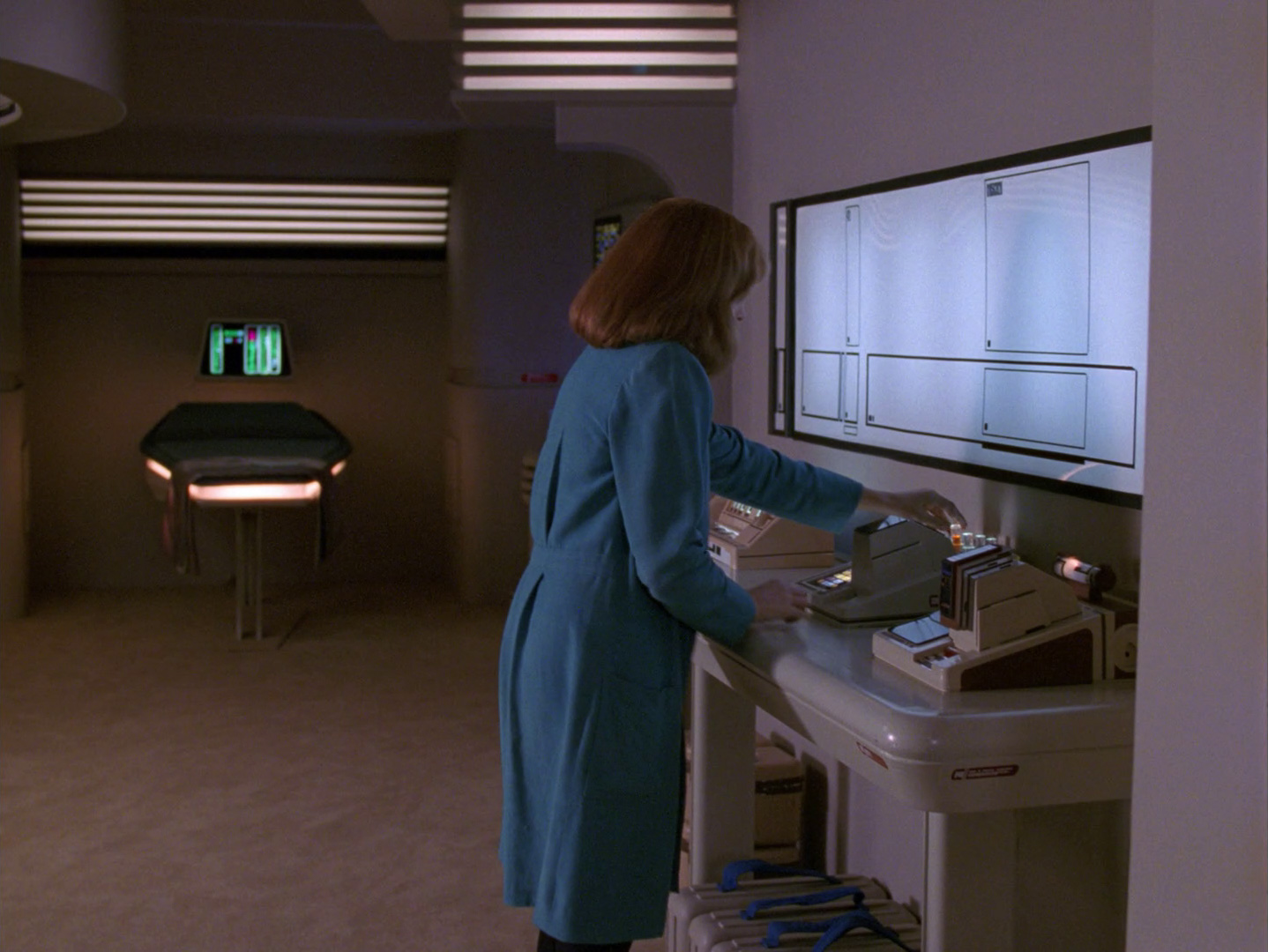

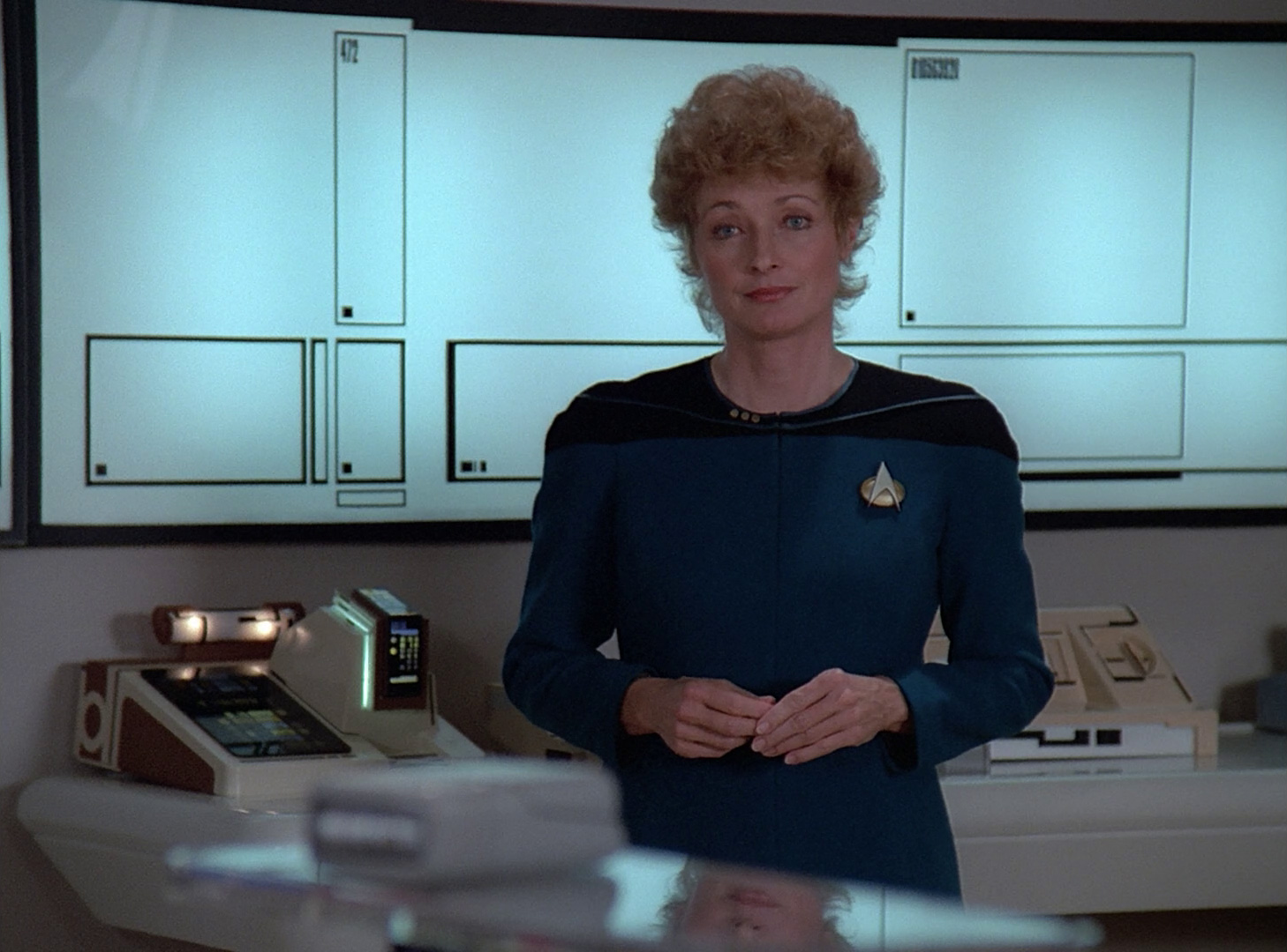

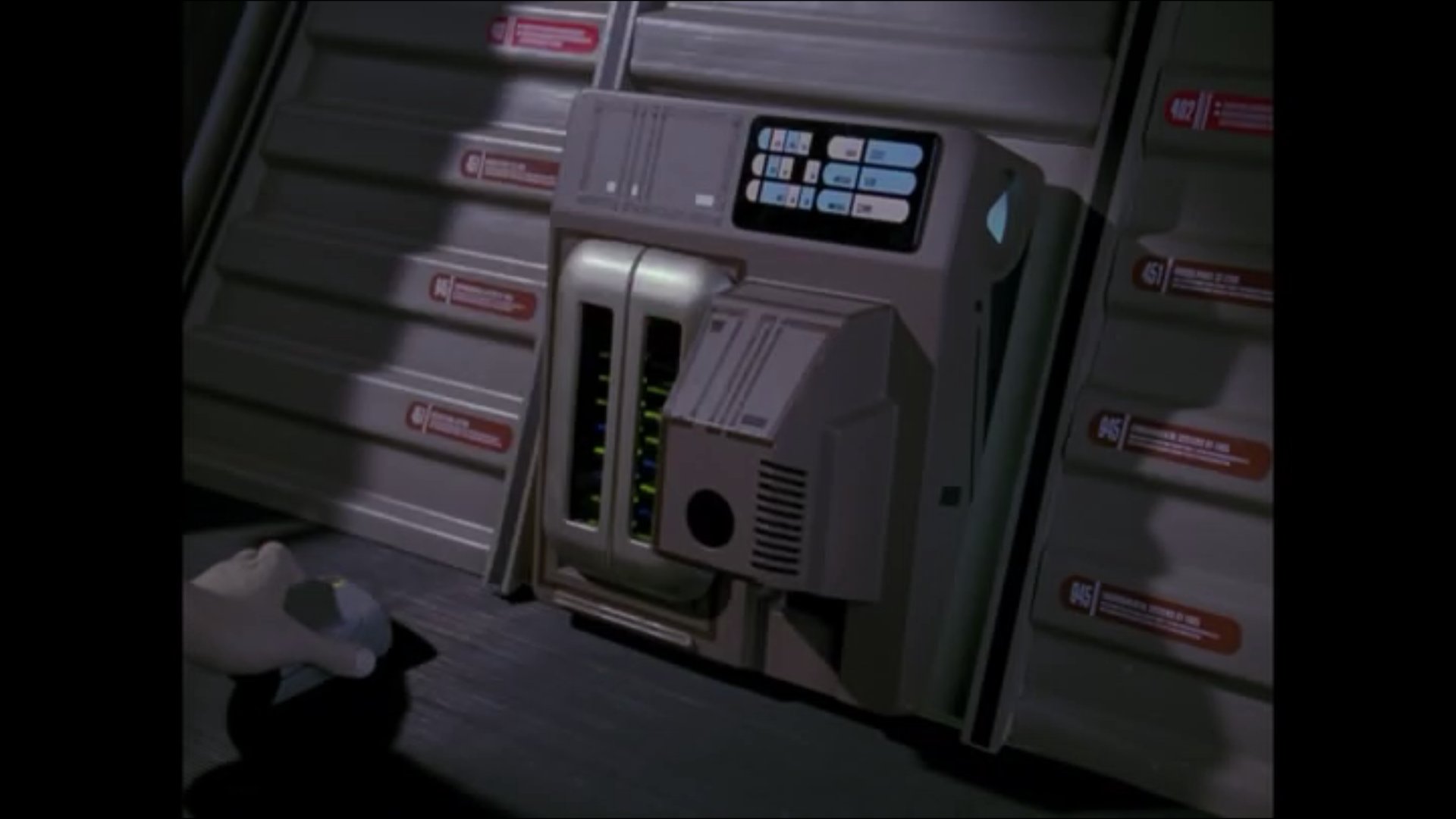

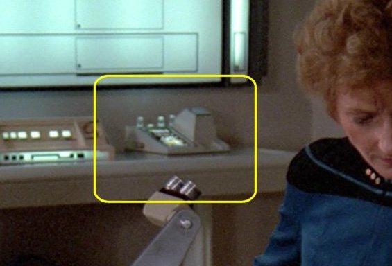

I have found two variations of the object used for the isolinear storage unit. Both of them appear in sick bay. Both variations cover the large rectangular opening with a piece of black acrylic, presumably an LCARS display. One variation has a piece of black acrylic on top of the large protrusion, while the other variation has some additional component(s) attached to the top of and down one side of the large protrusion.
The episode Unnatural Selection shows the variant with the additional components(s).
The episode Times squared shows the variant with the black acrylic.
The episode Transfigurations shows both variants.
The episode Shades of Gray shows the variant with the black acrylic.
The episode Starship Mine show both variants.
These additional images helped me to refine my extrapolation of what the hidden portions of the prop may look like.

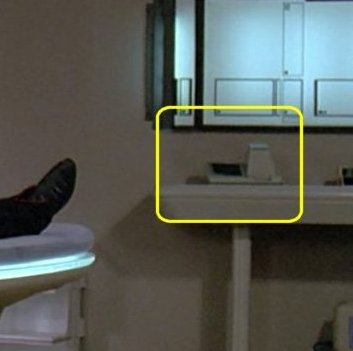

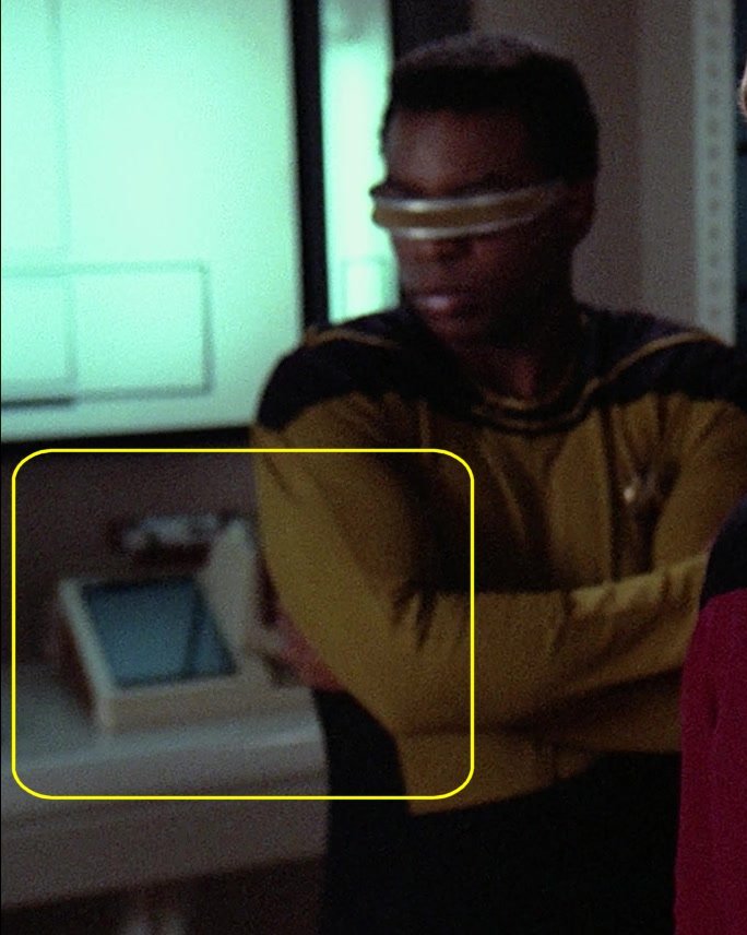

From the geometry and the sharpness of the edges I believe this is an injection molded part form some commercial product.

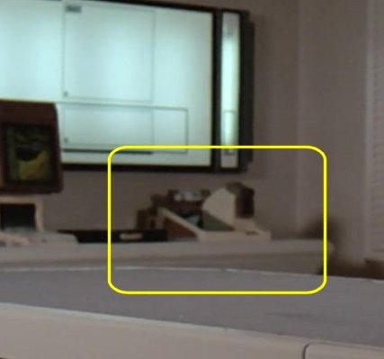

Does anyone recognize the shape? One theory is this may have been the top panel of a circa 1980's thermal printer with a roll of thermal paper nested in the rectangular opening. The round hole on top of the large protrusion may have been start or power button. the small rectangular holes on the top may have been status indicator lights.
Does anyone know of any other on screen appearances that may provide a higher level of detail?

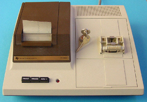

Y'know, it really looks like it is something related to a thermal printer/printing calculator/cash register component in some way - something related to the HP PC-100: PC-100A.jpg
It occurs to me that due to the number of those pieces they had (let's say at least 3 - maybe they moved a couple from set to set), and knowing how set dec and props depts. find their stuff, some company somewhere had to have gotten rid of a bunch of them at once, meaning they had a bunch in service at the same time. That says it's likely not a really specialized item that a company would only have a single one of (like, say, a single plotter for the entire engineering department). I know none of that is specific or helpful, but maybe it will trigger someone else's thought along a path that ultimately bears some kind of fruit... Good luck.
